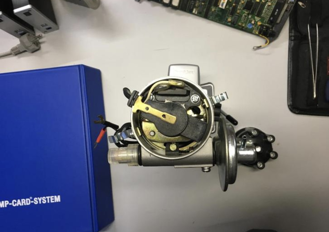

Someone offered me this compete ignition as being OEM. I have doubts because I don’t see a single mark on it.
Is this OEM or aftermarket and which engines would it fit?

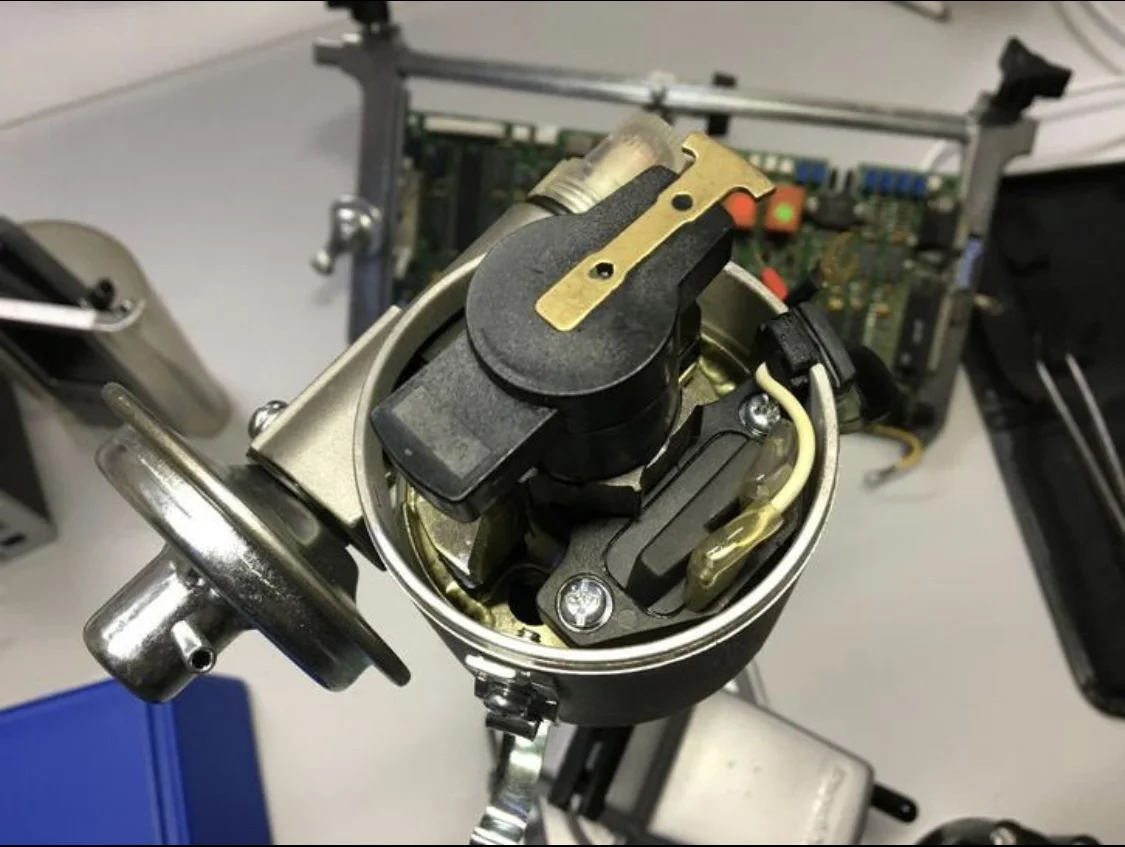

that does indeed possibly look like a OEM TOYOTA Genuine NipponDenso UNIT ?
- however , it has a PERTRONIX aftermarket kit inside in place of points
- my conclusion so far is based on 1 simple facts topic : the plastic cap , that covers the white adjust dial , please REMOVE the clear cap , and photos of it and the white dial too
- we can tell the difference if aftermarket or Genuine NipponDenso also here too
- the Diaphragm on the side , the flat face , does it have any numbers on it or the letter
s ND on it ?
- hard to tell ? if its blank and plain , then its a aftermarket NEW vacuum advancer ,,,
- but show photos of it please
- oh , also , close up clear crisp photos of BOTH the bottom FLAT end , and also the gear too ,
several photos here is better , i can tell from these 2 perspectives , the PIN drive in the gear too please

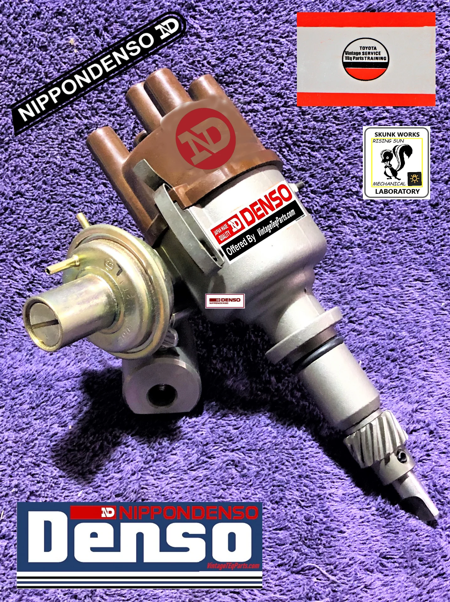

- this might sound like a lot of photos and stuff , but if you want a Verified Professional Opinion , that can also be agreed with by others such as @4Cruisers , who is today's state of the art innovator and creates world class real world Genuine NipponDenso Ignition Distributors using only and ALL OEM Japan Spec. parts , and is the Land Cruiser Communities most single source benchmark of all things NipponDenso Ignition Systems on the Vintage Land Cruiser as a whole ....then
THIS IS THE WAY ...
- this IS a OEM unit below , note the stamped numbers and letters of the face of the DISC. diaphragm advancer ....

I feel like no markings means aftermarket. Usually Toyota and their suppliers definitely like to stamp their parts.

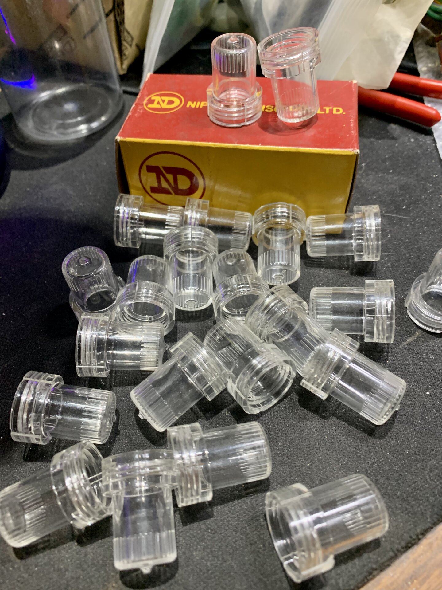

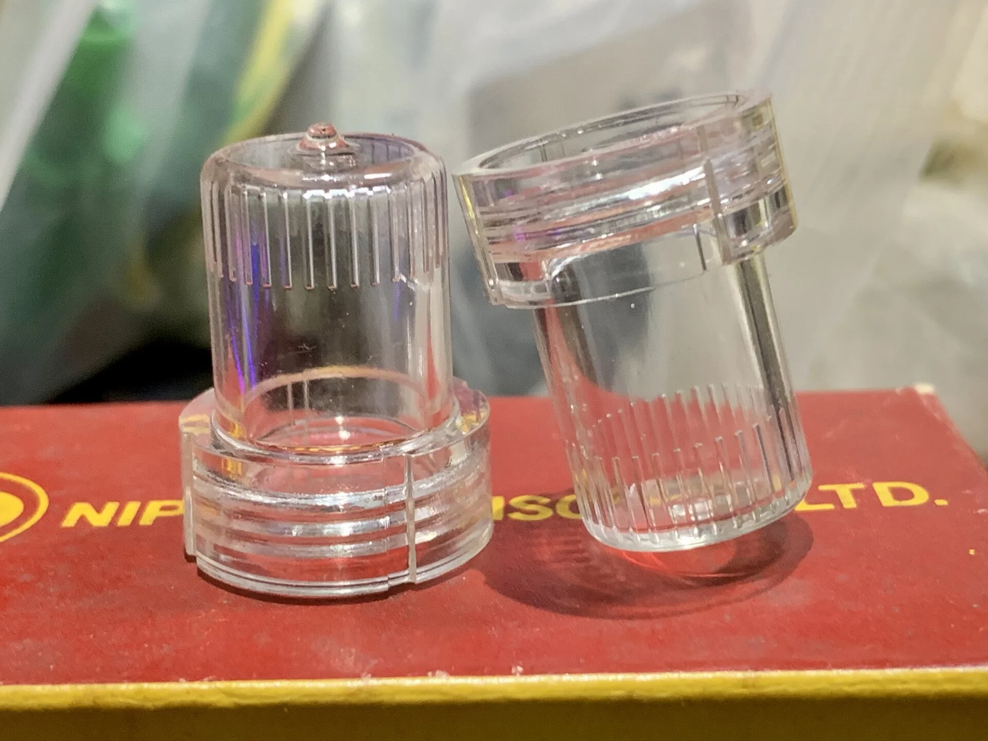

There are OEM toyota NOS Advancer Adjustment Dial Caps , if your cap matches these EXACTLY , then this is some varity of a refurbished unit , ?
if NOT ?
then @red66toy is correct and it's aftermarket all the way .....
i have seen refurbished OEM units such as this NEW Aftermarket advancer diaphragm and all , down to a Pertronix type igniter substitute , but the GEAR is NOT usually replaced , and the BOTTOM of the shaft either , BOTH will show witness marks , or normal wear and tear foot prints , if that gear it spotless and new , that wouod also point to a Chairman Moe made unit too , as that gear cost of a NEW one is pretty significant , not sure you can buy aftermarket ones , but anything is possible in today;'s new age of Kopy Kat Kloners who instead of stating the truth , its a aftermarket product , go one step further , and pon this type of unit and this type of situation as oem toyota parts ,

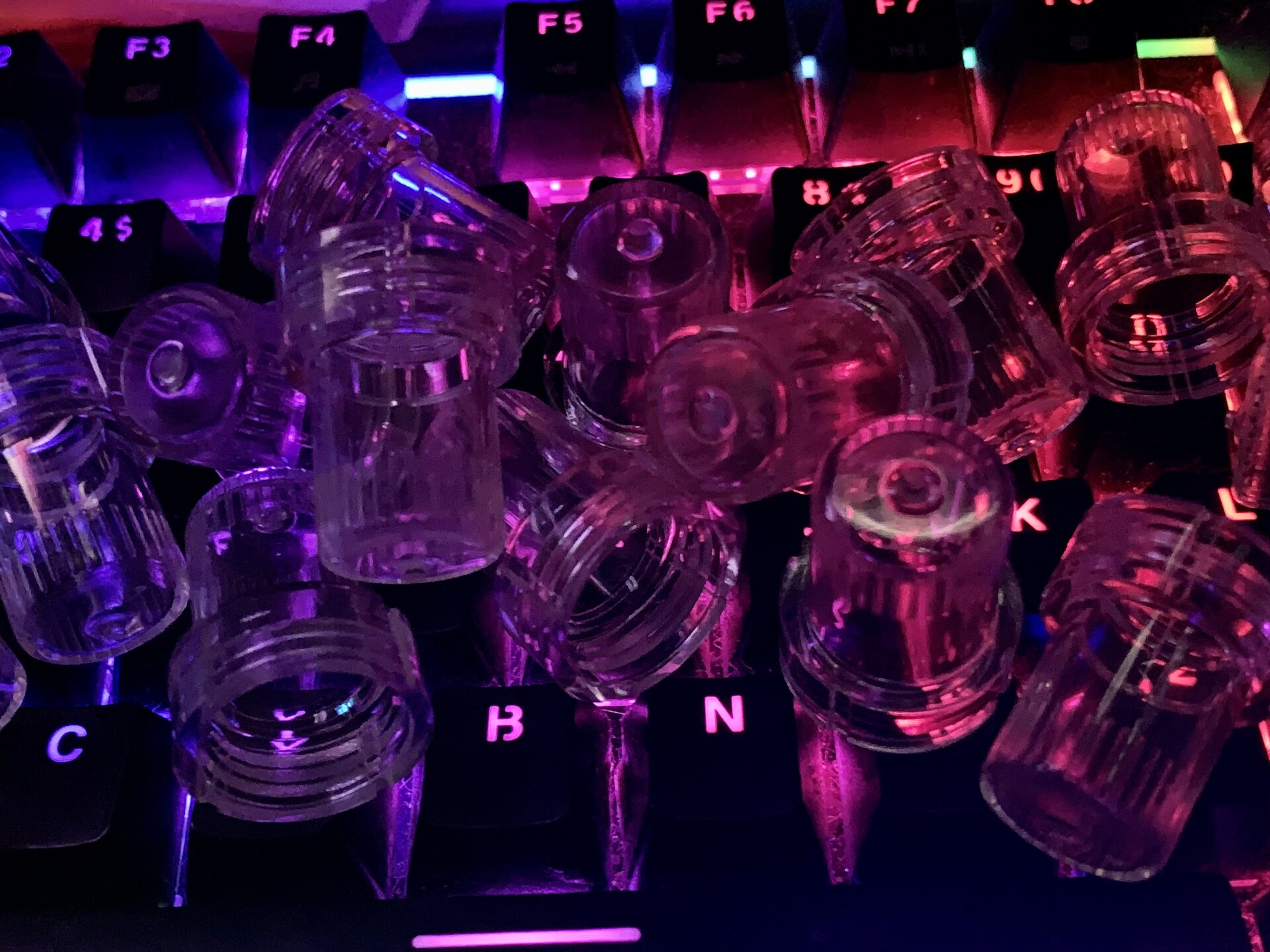

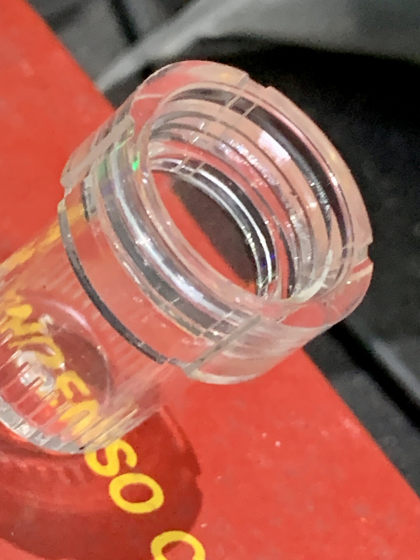

These are 100% OEM TOYOTA NOS Timing Adjust Dial Caps , because i purchased them myself from TOYOTA back in the day while still working for them , otherwise i really could not be that sure myself without a verified OEM original of some kind Pre-owned or NOS ......
- the O-ring on @hdjtachtig 's unit is NOT OEM , its PHAT and round , a true OEM one if FLAT and has a Sharp 90' outside corner from the flat to the side transition .....
