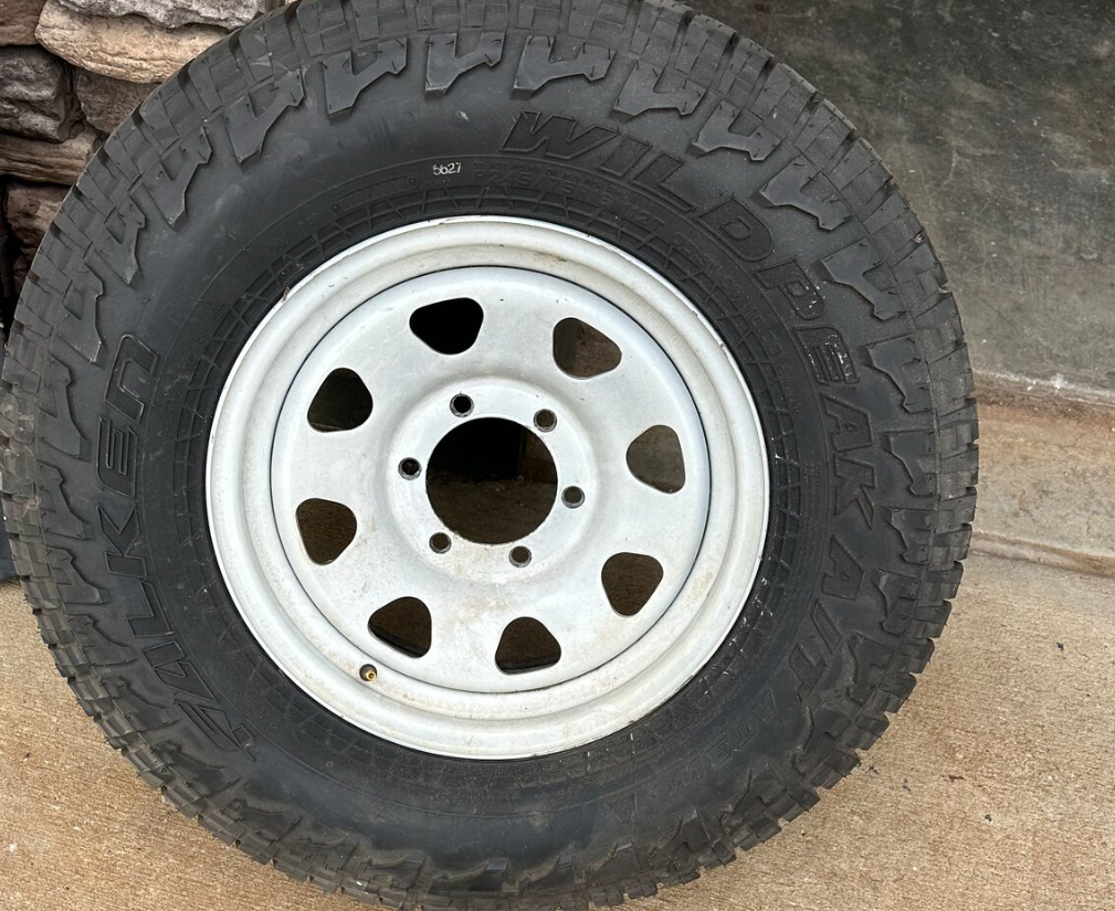

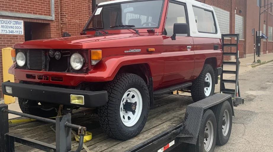

These came on my 73 series. They look new, front and back; and I assumed they were the Toyota part number 42601-60262-03; however, @lynchmob just taught me to count the openings and duh.... they are something else. Anyone know if these are OEM or aftermarket?
They kind of look like the aftermarket models popular in Australia, though those usually are black.
They look a lot like American Racing Wagon Wheels or something similar aftermarket. The cut outs have a tip that makes them look a little more triangular than the factory 16" ones.
The white wheel that @coldtaco showed picture of is manufactured by Chuo Seiki Japan aka CMW "Central Motor Wheel". Major Toyota wheel supplier.
I am pretty confident that the wheels on @2fpower 73 series are not Toyota issue from the factory. Perhaps dealer installed maybe.

They are aftermarket.
OEM steel wheels have six trapezoidal holes.
Aftermarket wheels with triangular holes are common.

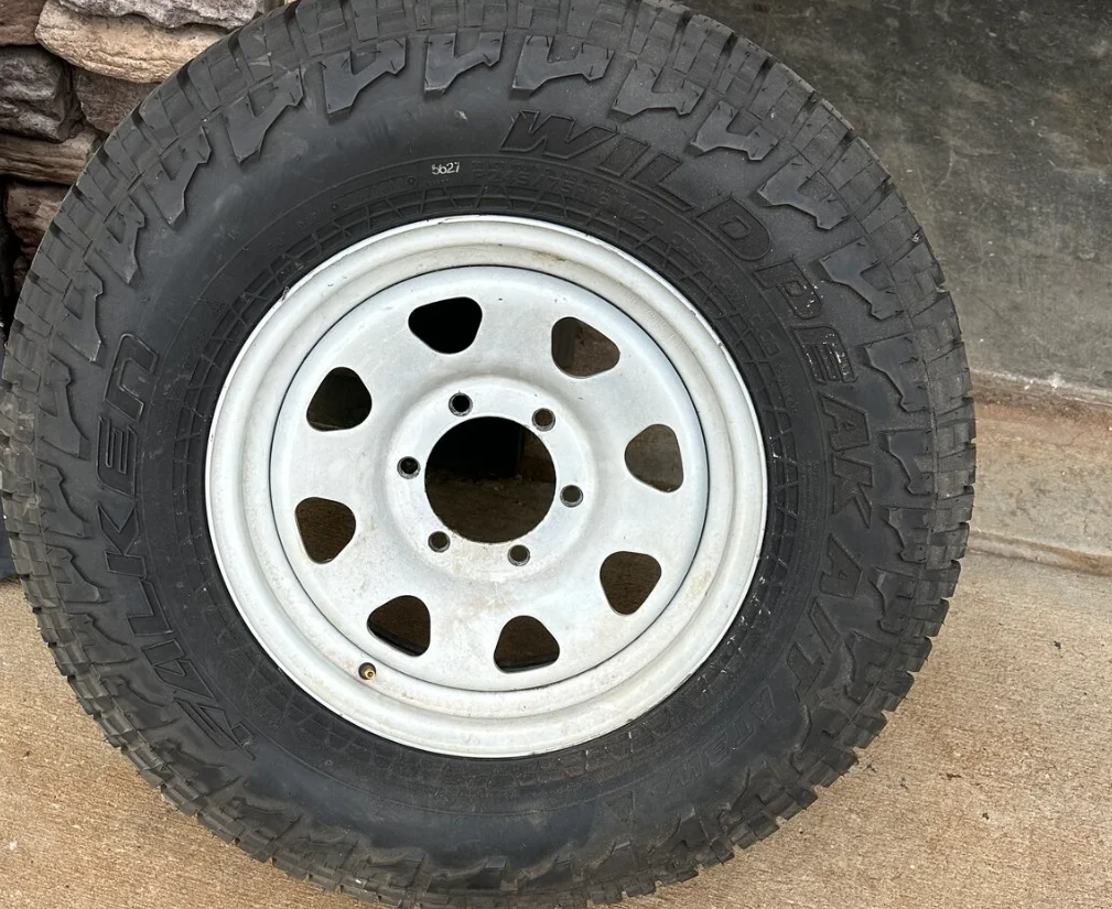

I took some pictures of the numbers, stamped in the rim, front and back.
i think you are onto something @FJBen .. google popped all these out....

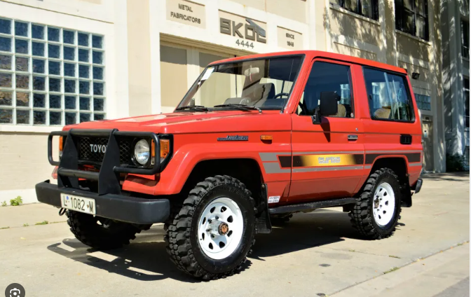

Any of you guys know what is the offset for these (Brazilian made?) steel wheels? or the actual Toyota part number for them?
It does not seem to be the 42601-60262-03, which is supposed to be the white 6 spoke ones you've shown in this thread.

If you refer to the wheel I share, no the part number you mentioned is not for the made in Brazil one (there is an OEM one beside on the second pic to compare). If I recall they have a bit more than the 3.5 inch BS. I can measure it, they aren’t yet installed.
But they fit right, PO travelled around South America with them. They weigh about the same as OEM too.

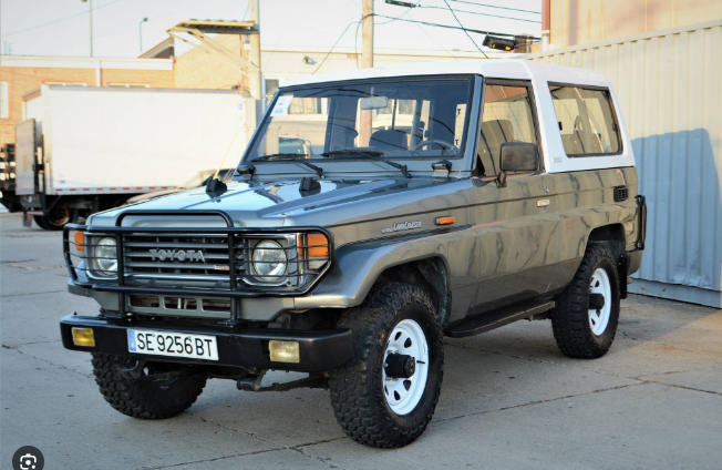

They seem to have been popular in Europe, many of the old landcruiser seen here (Canada) as tourist from overseas, have those wheel. Also, the 40 & 70 (6 lug) in Australia seen in picture have similar wheel.

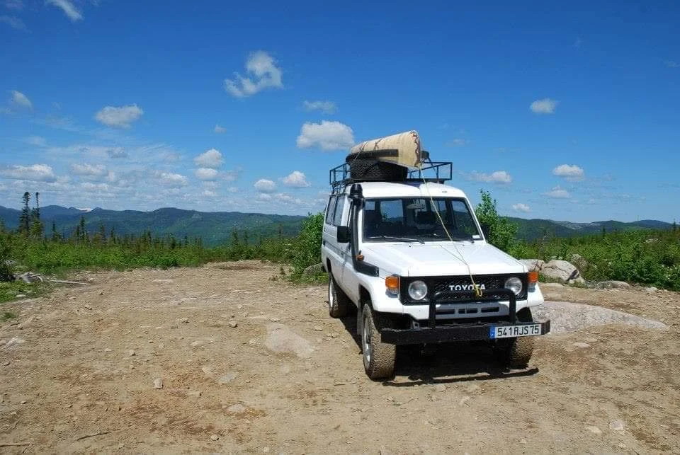

Here is my 70 with those wheel on
I will measure the BS
I know these, they are made by several aftermarket companies, also for jeeps and other American vehicle models, however they do differ from the ones in the original post from @2fpower.
The ones from the first post do seem to be oem toyota but I could not find their part number.
