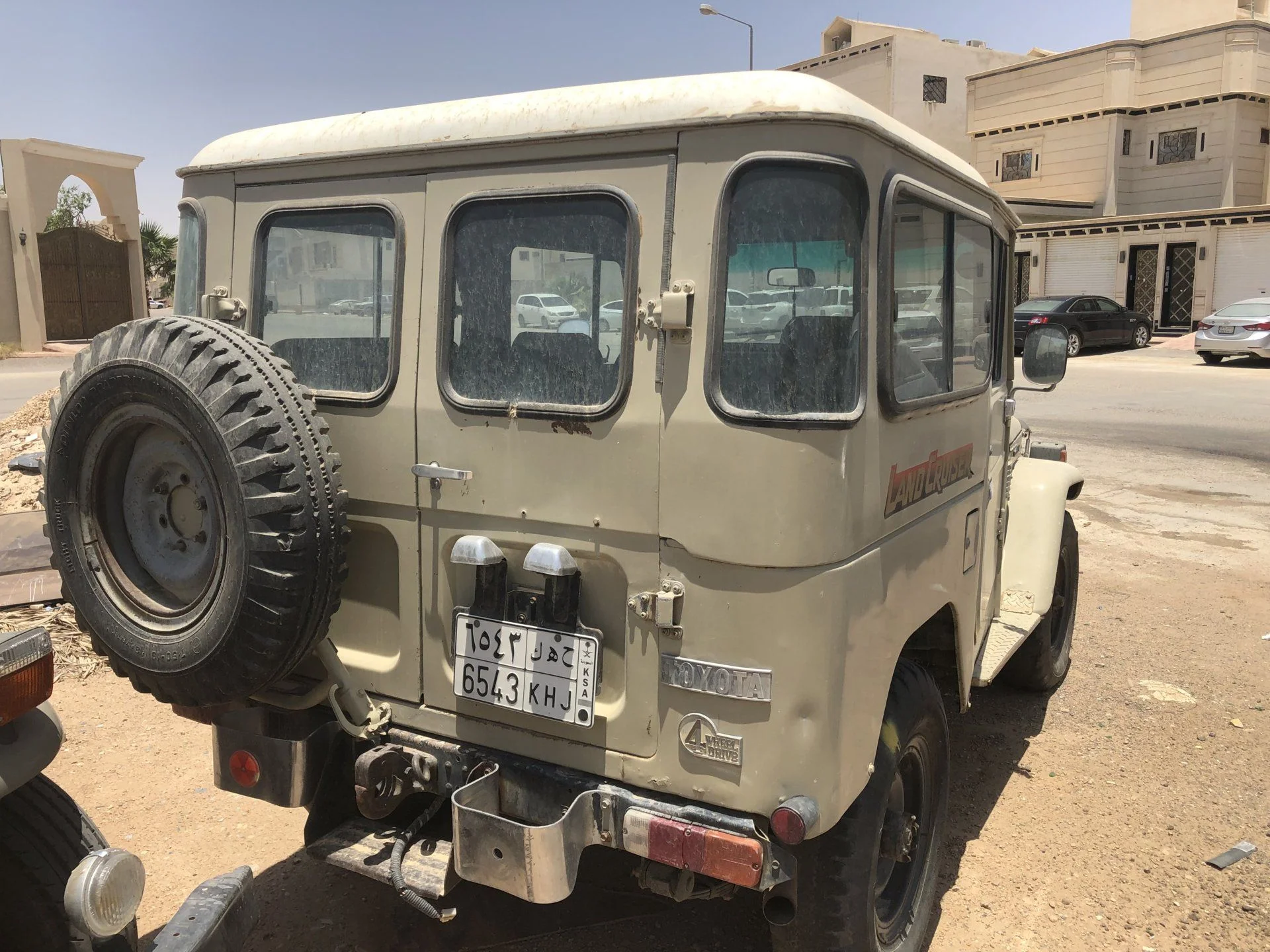

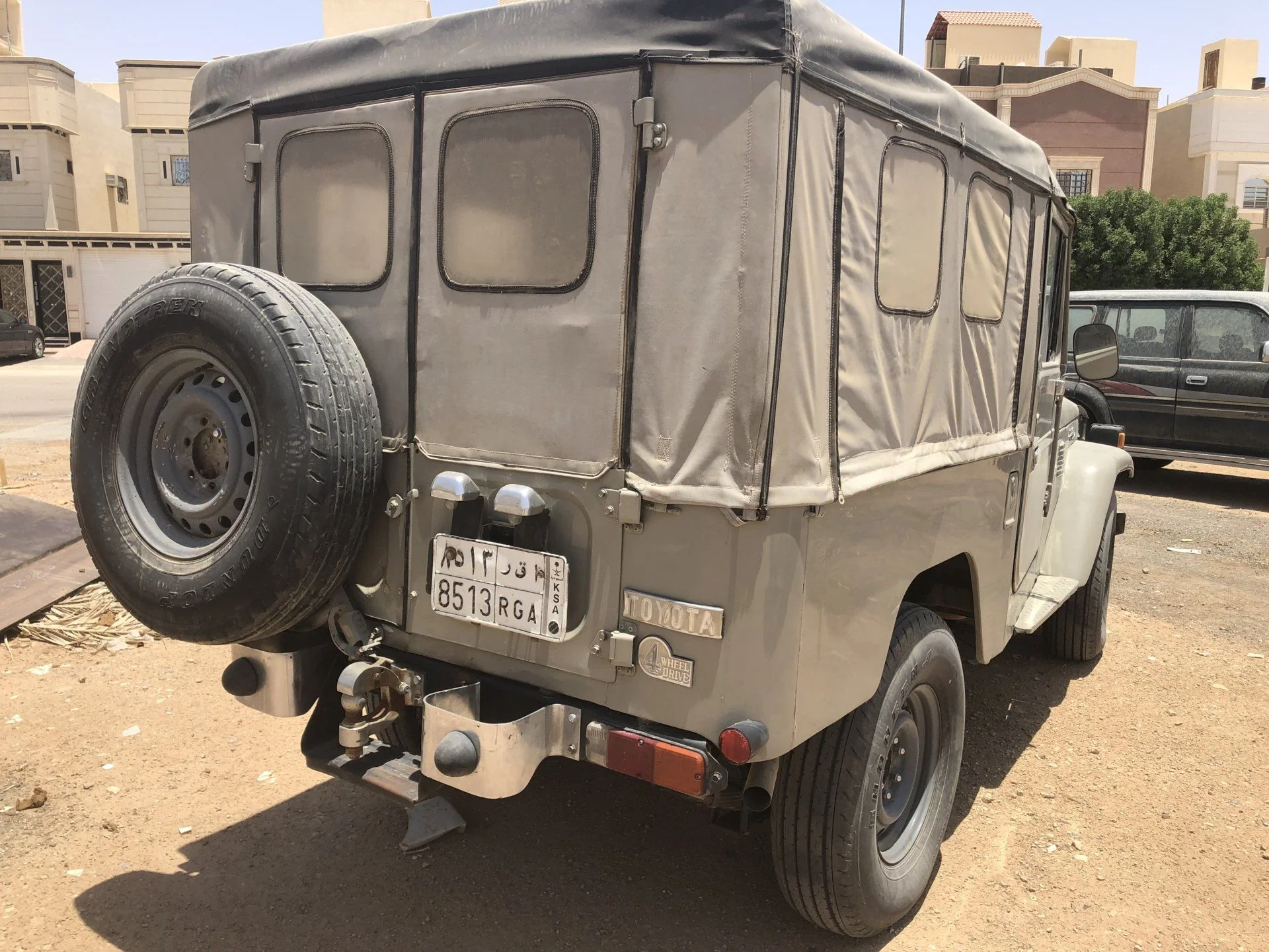

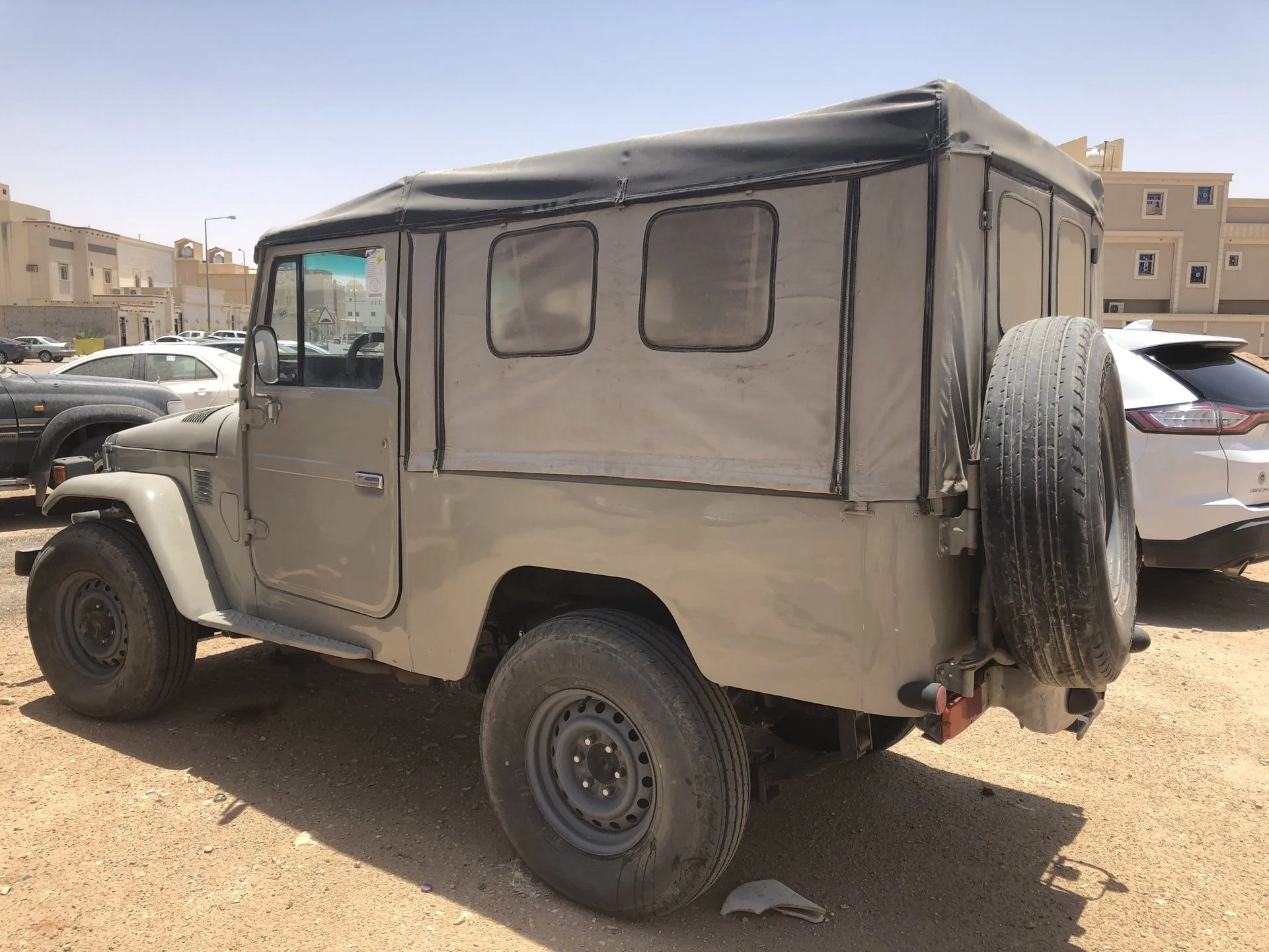

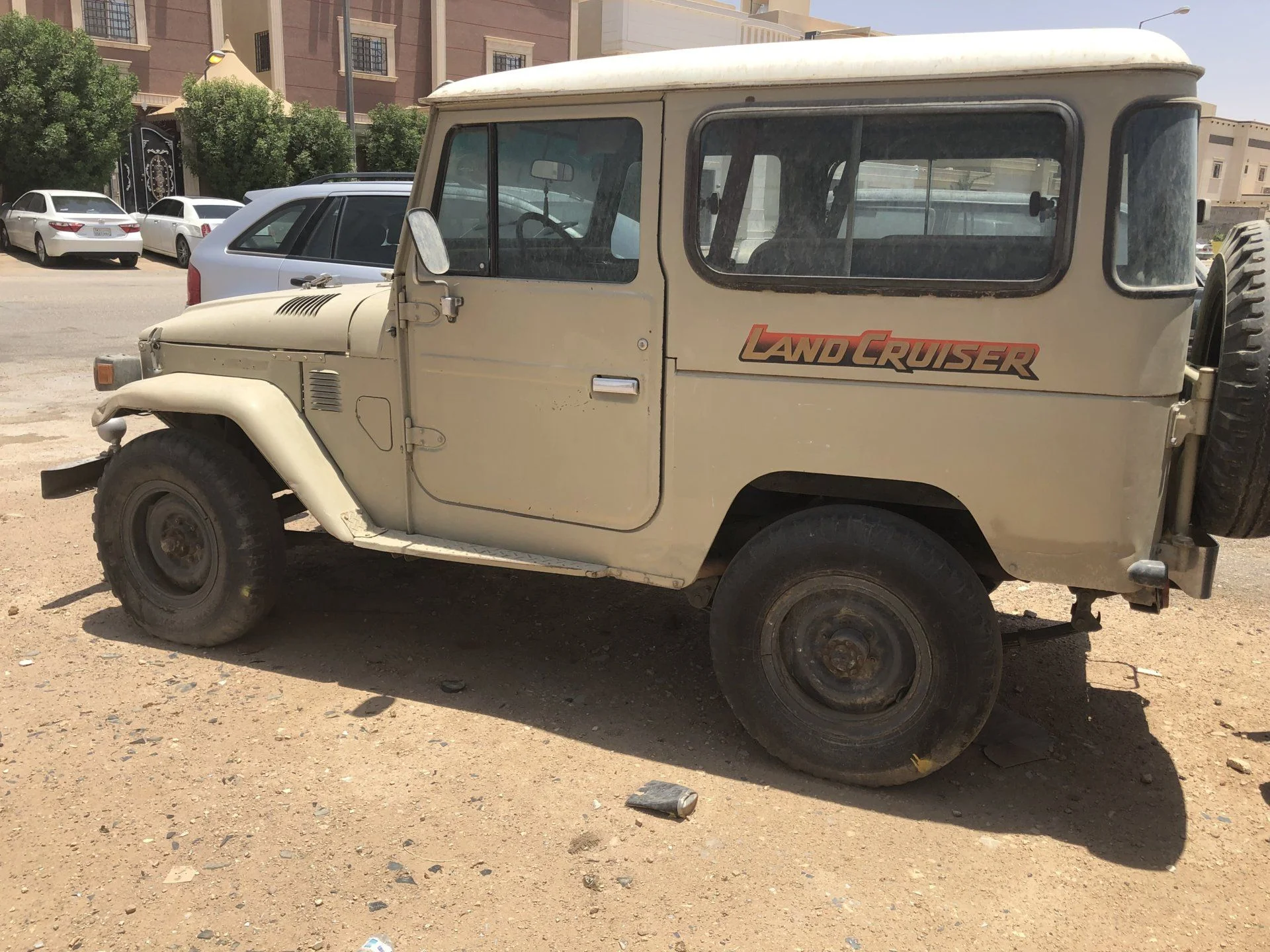

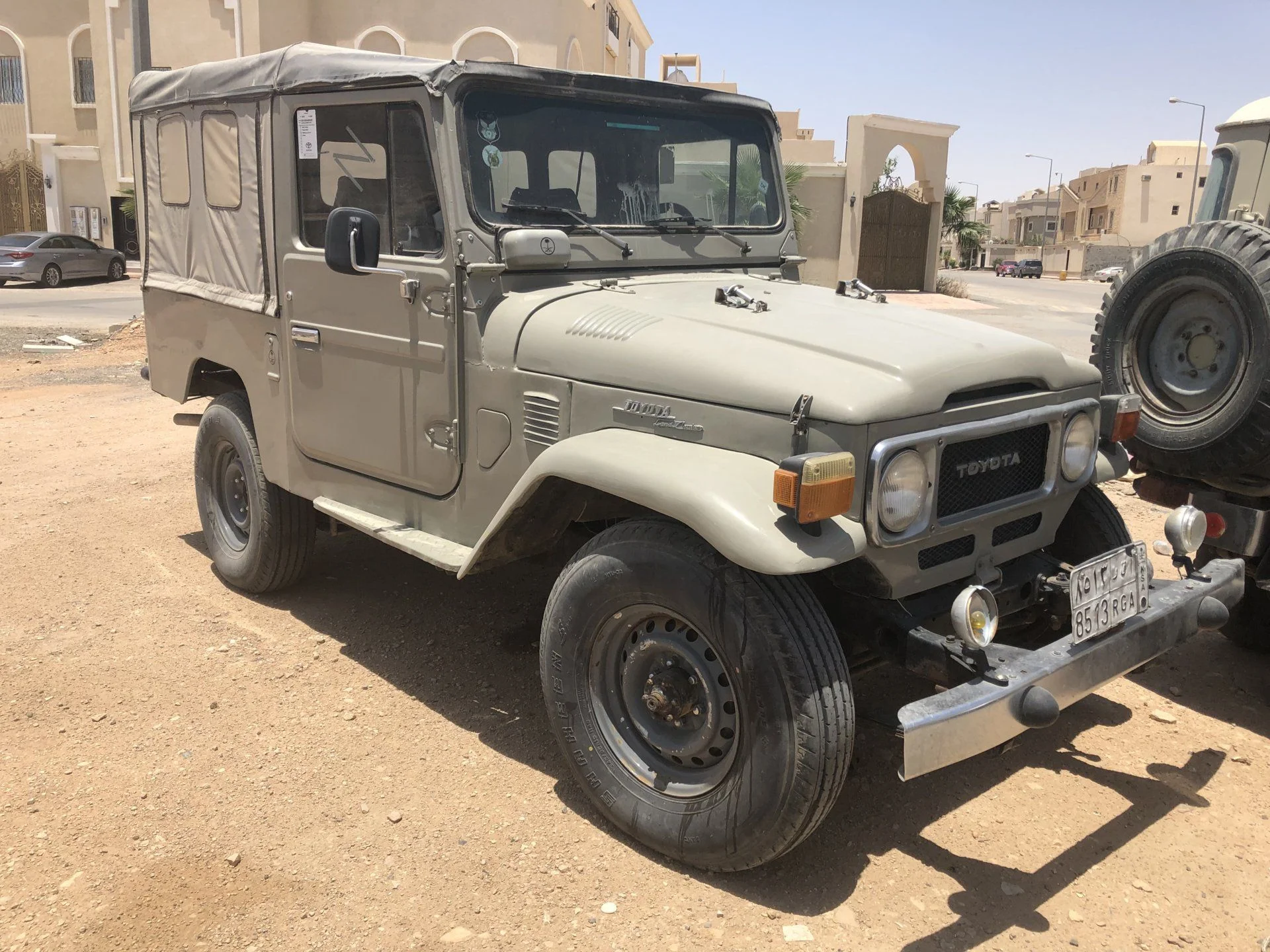

Greetings All,
My name is Eric and I am currently working in Saudi Arabia and have found some FJ’s that I may ship home to the States. I don’t know much about Land Cruisers other than I loved them growing up.
I have the option of purchasing a FJ40 and/or a 43. They are 1978 models and have matching numbers, all original.
From what I can tell the prices are pretty cheap but shipping gets steep and tricky. Ideally I restore at least one for myself but I am not sure which.
My question is, am I getting in over my head?

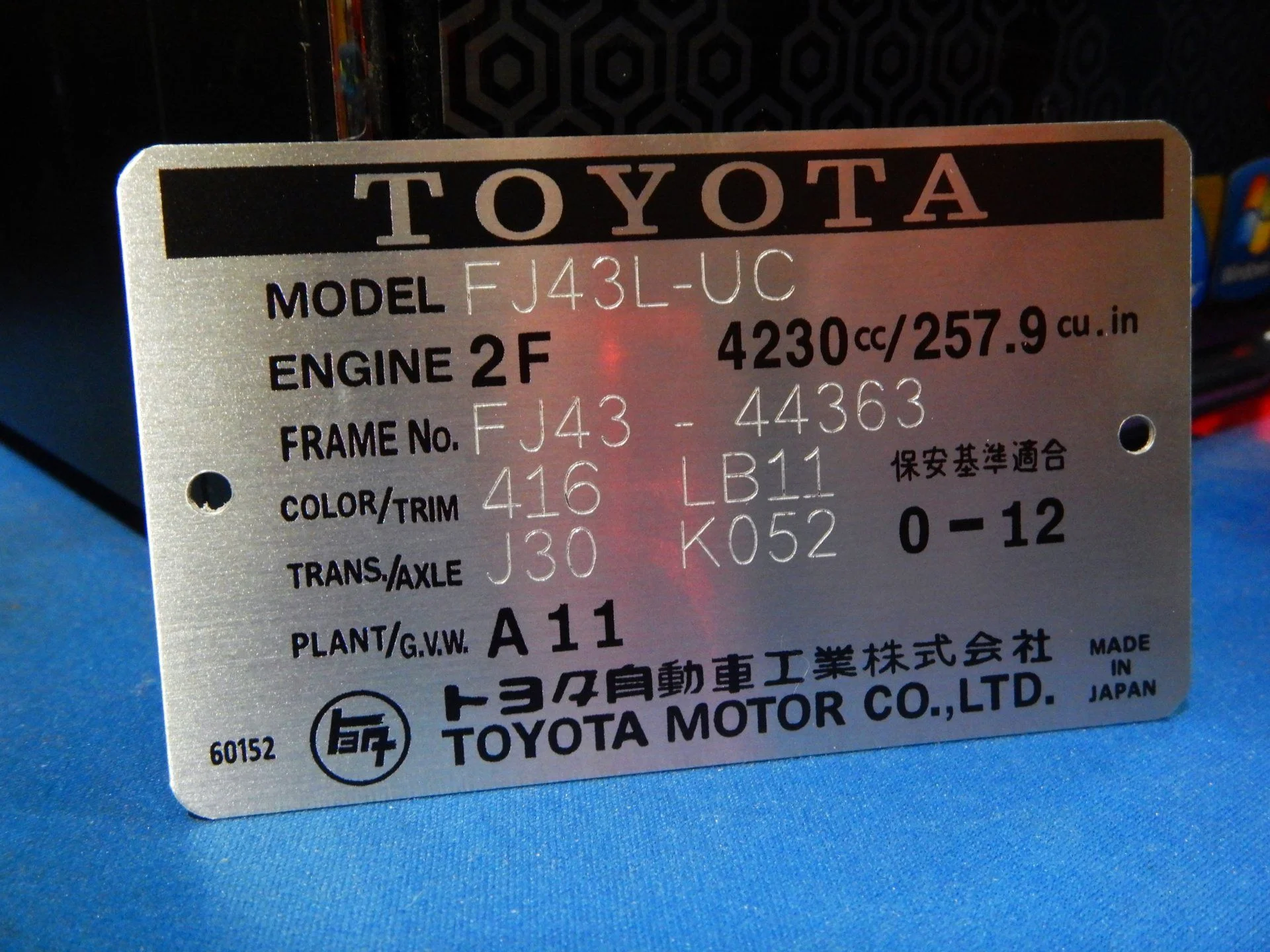

- one last word of wisdom , make
SURE you have the Original Aluminum DATA ID Plate from TOYOTA under the hood / engine bay , held by Rivets or screws , without one your importing will that much more of a challenge
Like Really
That Much More ...............
they will look Something Like or exactly like this Egyptian Spec. FJ43 1976 2F with a 3-speed J30 Transmission
take note the LOW production # 🦄
SURE both have the Original Aluminum DATA ID Plates from TOYOTA under the hood engine bay , held by Rivets or screws , wothout one your importing will that much more of a challenge
they will look Something Like or exactly like this Egyptian FJ43 1976 with a 3-speed J30 Transmission

I question the all original part. The 43 has a 1979-newer front bib and bezel on it. The 40 is 1979 or newer. Check the serial numbers on the frame. Data tag and title very carefully before proceeding.

I see your point. My phrasing was incorrect in that aspect. I am saying I he body, engine and frame all match and appear to have minimal modifications.

Good catch on the FJ40. Didn't really pay attention since not looking to add another FJ40. Without doing some searching believe the spare tire carrier added the extra brace around 5/80. Gas door is hinged on the front but that just confirms past early 79. 8/80 would be split transfer case and hand brake on the rear axle. FJ43 is pre 8/80 with the A Pilar style. Finding a new bib bezel in the same color would be easier than one in a different color in that region. Not sure the cost to restore one in that region but not sure the FJ43 as is would sell for enough to cover it. Would say the same for the FJ40 except what it really is is in doubt. Very likely doesn't have a five speed but having a full floating rear axle may have a four speed. Still looking at $9K just buying and shipping to the US. And that a estimate on shipping customs costs. Guess I would talk to a few members who have restored cruisers in that region of the world. Get more info on the two for sale. Then go from there. I have always lived well within my budget. Even if I sold one to pay to restore another would want at least 50% above the estimate available. There is enough stress in life without adding some that could be avoided.There is a reason insurance companies will total a vehicle even when estimated repairs are less than the value. Very common to have extra costs arise once work has started. Same with restoring any vehicle.
