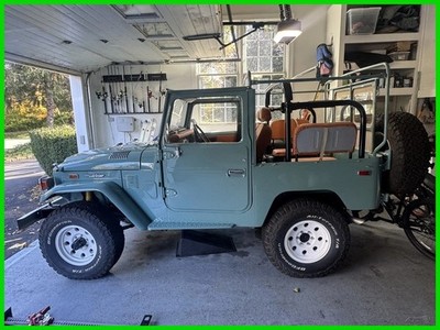

If anyone has a second and can look at this listing and give me your thoughts, I’d really appreciate it.

It mentions a 4.7 V8 like 10 times in the ad, but it very clearly has 1fz… a 4.5 inline 6 so that’s kinda worrisome.

7 pics that aren’t that good, calls it restored when it’s not, doesn’t know what engine. Anything with paint that fresh, I’d want lots of pics.
I've never seen a vin# like they posted. They say 5 speed, then later say 4 speed. The engine isn't a V8 and not stock. Don't get caught up with all the bling. They say it has a hard top, but it has soft top bows. The fender aprons with the yellow marker lights are from an earlier 40 along with the badging. You need to find out where it was restored. Theres no pics of the driveline and frame. South American 40's typically are lipstick on a pig. It's missing the heater. Be careful. This may not be a US spec 40. There IS a difference in value. Have looked in the classified section on this site. You can usually find honest vehicles there.

I didn't look act the actual add but merely title. I have learned that the phrase " fully restored" and "completely restored" means something different to every body. But going by what I have read from the comments here. I would say that this one is a SCAM if there are only 7 pictures and conflicting information as to what motor it has or even the transmission. I would say turn and run away as fast as you can.

One of those rear end pictures is not even of the same vehicle…

Little to nothing in the ad lines up with the vehicle in the pictures. Also, when it comes to the phrase "restored", you have to be careful.
