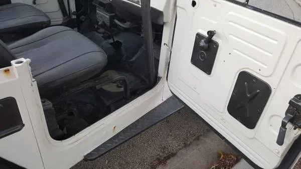

Is it possible to tell about how close the engine is mounted in the craigslist pic?

Hard to tell - it certainly looks further toward the firewall than my engine is, but generally the passenger side head is only about 2 inches from the firewall when mounted properly. I believe mine way mounted in such a way that the previous owner could simply reverse the front and rear driveshafts without modification (although I've never measured to confirm).
You can always ask the seller for a few measurements:
1. Distance from front crossmember to engine mount (should be about 19")
2. Distance from rear of passenger side head to firewall (about 1.5-2")
3. Have him take a picture of the shifter location inside the cab. For most older conversions, there will be a slight bend at the base of the shifter to clear the stock heater. I have a MASSIVE dog leg in mine which should have been a dead giveaway that something wasn't right.

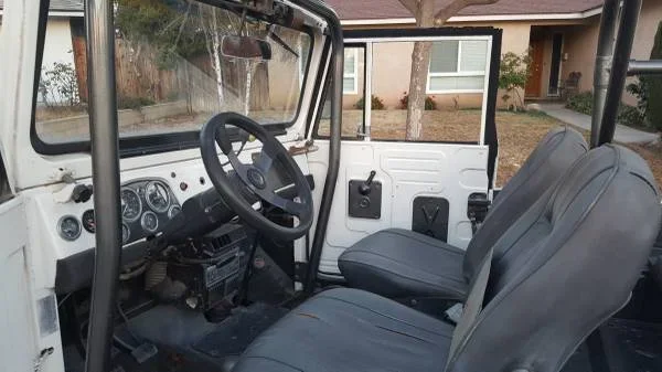

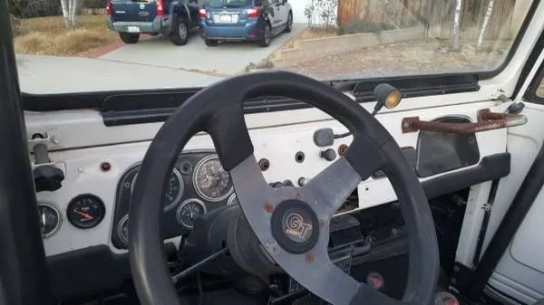

Does this show the bend you were talking about, RW? Looks pretty straight to me
Holy crap, is that in neutral?
He means, if it's in neutral, you won't have room to shift into 1st and 3rd, assuming a 4spd.
It's not normal for the gear shift boot to be "under" the heater.
I'm guessing @RWBeringer4x4 will say his is currently set up in a similar fashion, except his gear shift is dog legged to bring it closer to the normal knob position.

Sorry - late to the party and I know it was sold (bummer) but that isn't half bad. Generally speaking the bend added to the shifter will be covered by the transmission boot. That's not too far off of where it should be. Mine is far, far worse (completely behind the heater).
As long as it could get through all the gears I don't think that particular conversion would be too problematic.

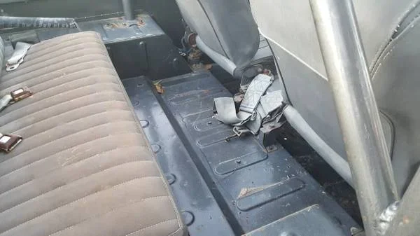

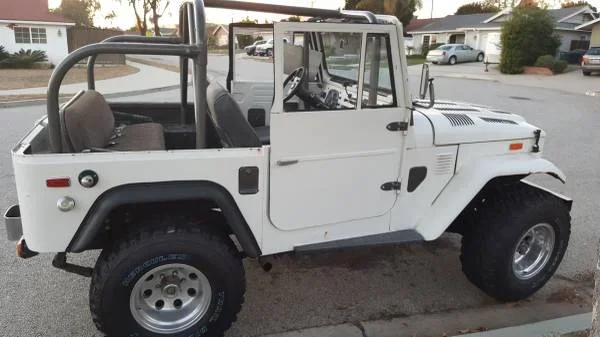

The other three pics of frame/wheel wells look similar
Am I missing anything?
(Besides the top/cap)

Is this a lipstick on a pig situation? [emoji14]ig:
Whereas @RustyNailJustin's is a butterface?
You've got it. All the hard stuff is done with @RustyNailJustin s rig. Research some of his builds on here and pirate. You wouldn't be getting a clapped out rig from the 80s that will drive you nuts fixing rust and undoing poorly done "mods" but one that needs a little polishing and cosmetics. It would be worth a call to discuss specifics.
If that one doesn't work out, keep looking at as many 40s as you can and you will be able to spot the pigs.

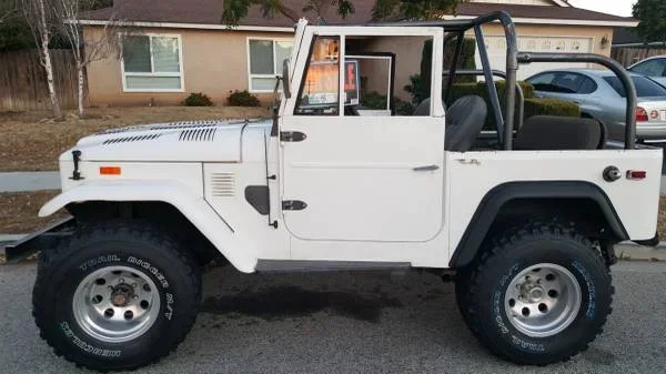

Is this potentially getting into the same engine wall/space issue RW?
The engine looks located pretty much correctly on that one. Space appears to be an issue because it's running headers that set the exhaust outside the frame rails. Most conversions you see run the stock "Rams horn" manifolds that allow the exhaust to run inside the rails. This is mostly a matter of preference but most folks believe keeping the exhaust inside the frame adds a measure of protection against crushing it on a rock.
There's a lot "not stock" about the rig posted. It's all a matter of what you're looking for. I would definitely check out the bodywork on that one. I'd bring a magnet if it's local and check for bondo...
I think 8k is ambitious, particularly if it needs a clutch, a top and has some "dry gaskets" (which means leaks) - these are not necessarily "little things," depending on your skill level.
