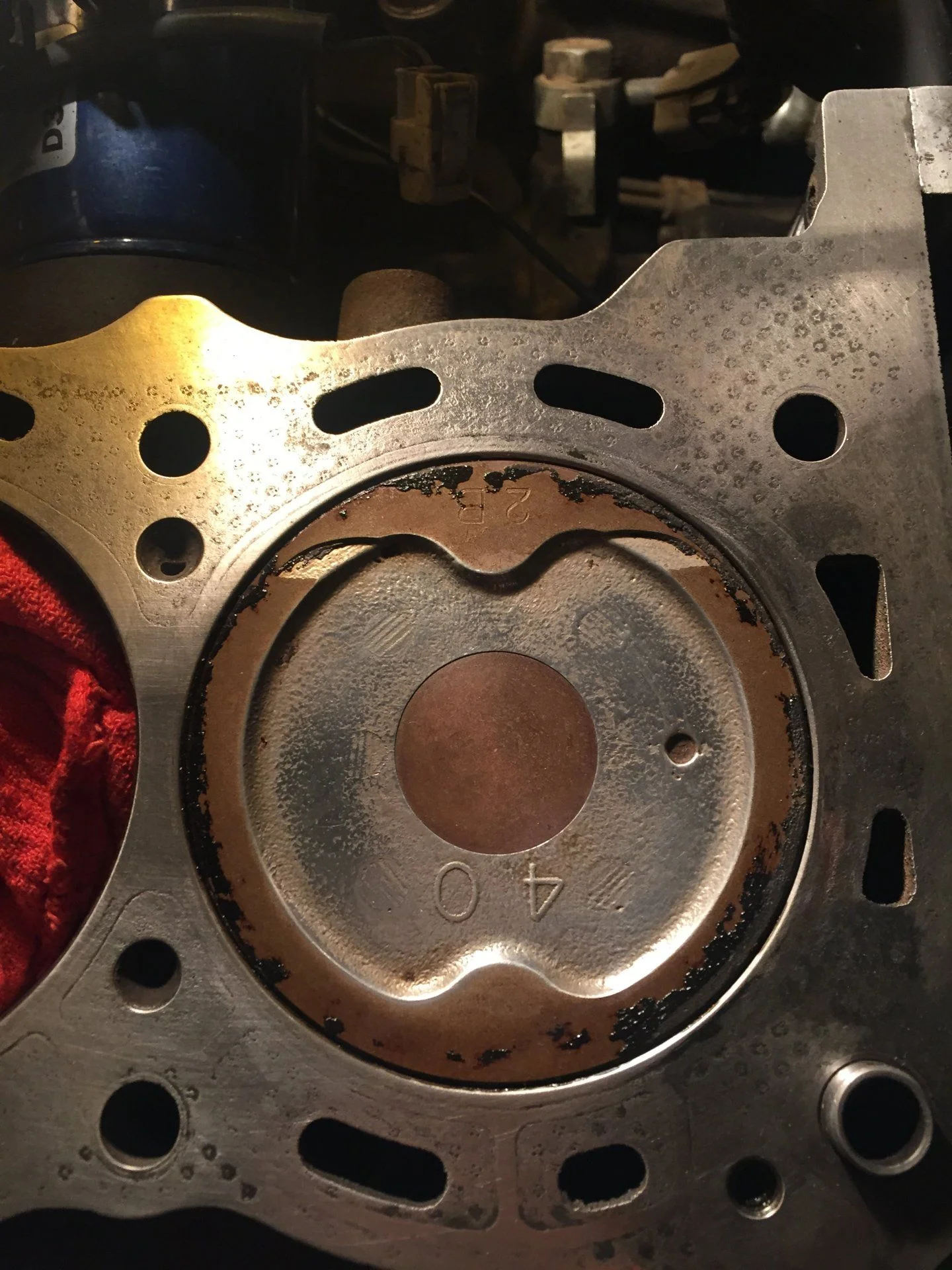

I don't know how you guys are cleaning the piston tops but I find it very very frustrating. I followed Robbie's advice (again) and went ahead with cleaning of them with wire brush and carbon cleaner or brake cleaner. I put the piston in TDC and start to clean. This is after two and half hours when I got only one !!! piston little bit cleaned:
Well it seems inevitable to have carbon falling down the piston even when I coat the ring with a lot of oil. I heard guys putting also grease to have nothing falling down. What worries me most is that actually I clean the piston while the piston is wet with brake cleaner as the carbon dissolves much easier and I am afraid that the fluid with carbon will just go down the cylinder. Anybody has some good tips how to proceed ?

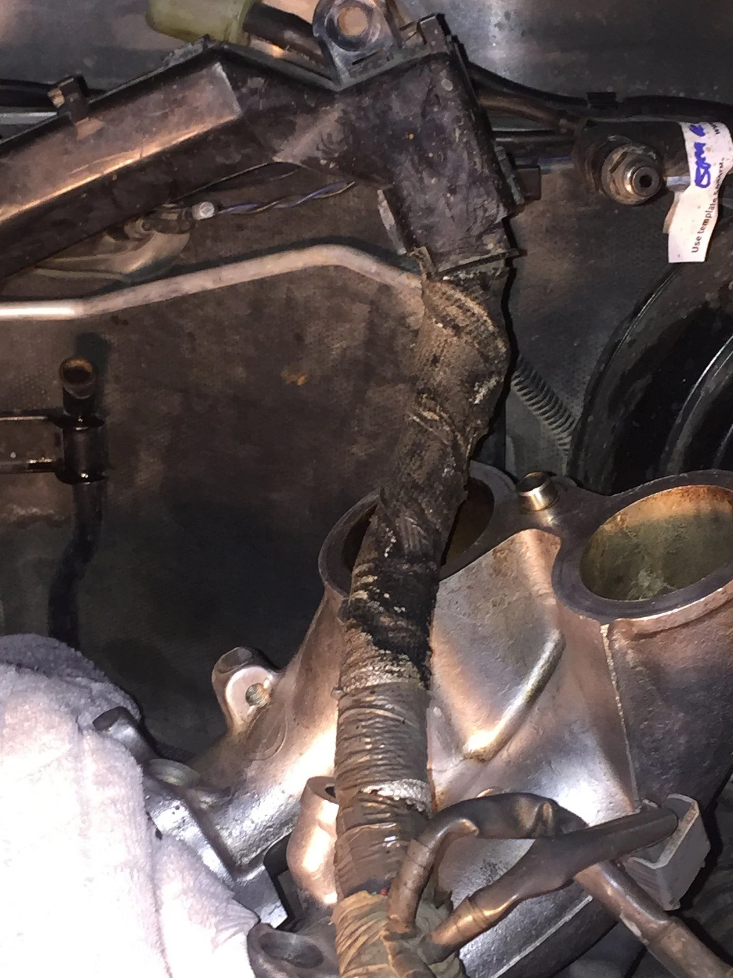

Another question I have is regarding the engine wire, I would like to put some heat socket or something to shield the heat from EGR. Question is - shall I unwrap the current wrapping as I am afraid to tear down some cables in process, I would rather just leave the old wrapping and put the new on top of it. I don't see anything wrong with that.

Hang in there. You have done a lot so far that should boost your confidence. I would remove the factory heat wrap so I could inspect the harness for heat damage. Mine had three bare wires. If a wire is weak enough to be damaged when you unwrap it then it needed replacing anyway.
That piston top looks pretty good and clean to me. You might try a hard plastic scraper if you want to remove the remaining little bit of carbon.

Hard plastic just doesn't work with this carbon which is really cooked to the pistons. I am now using the razor blade as the wire brush is dissolving from the brake cleaner fluid. Also using the red scotch pad but it is really time consuming.
No need to get 100% of the carbon deposits off.
I agree with @Pin_Head and @baldilocks don't worry about cleaning the pistons.

I would NOT bet money on it! Also be cautious with the razor blade on the pistons...the razor blade is fine on the cast iron block but pistons are a softer material
