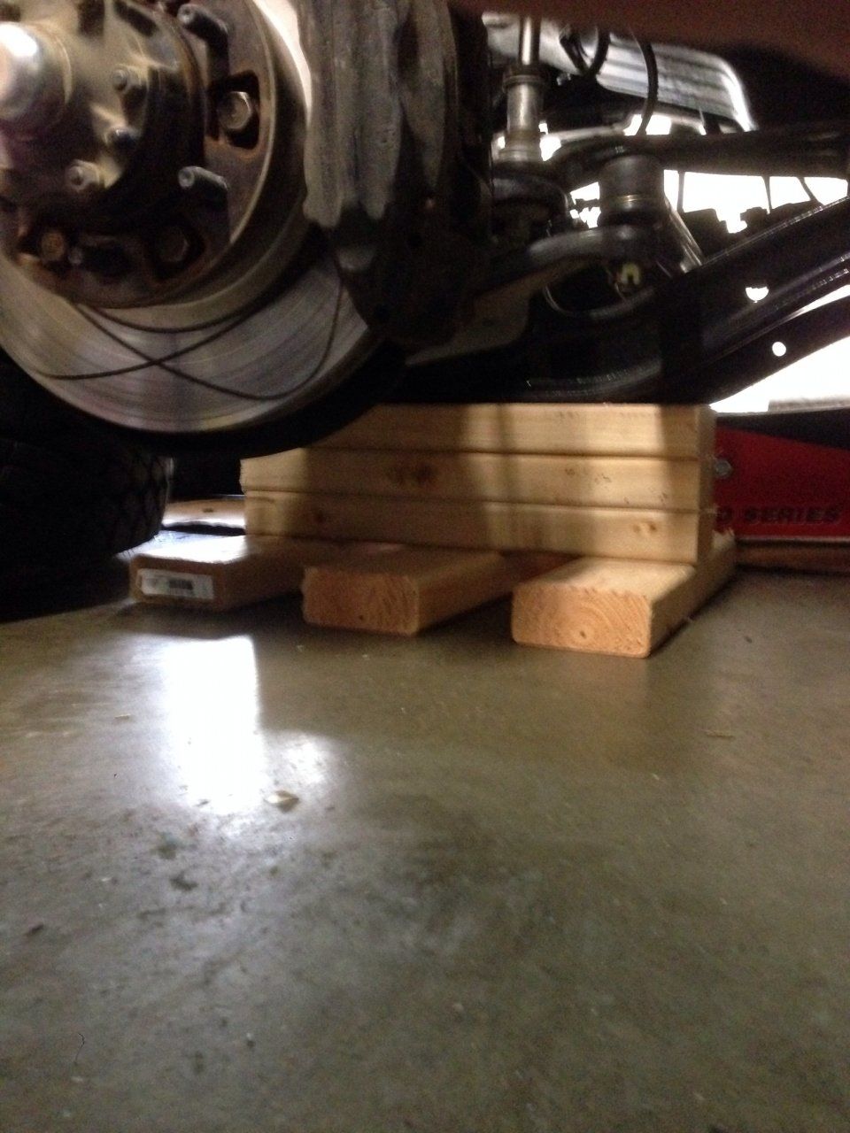

Just a heads up. I did mine this past year. What helped my back a lot was getting some 2x6 wood blocks and screw them together. Then jack up the front end remove tires and place the wood under the control arms under the axle. You can probably go lower then I did.

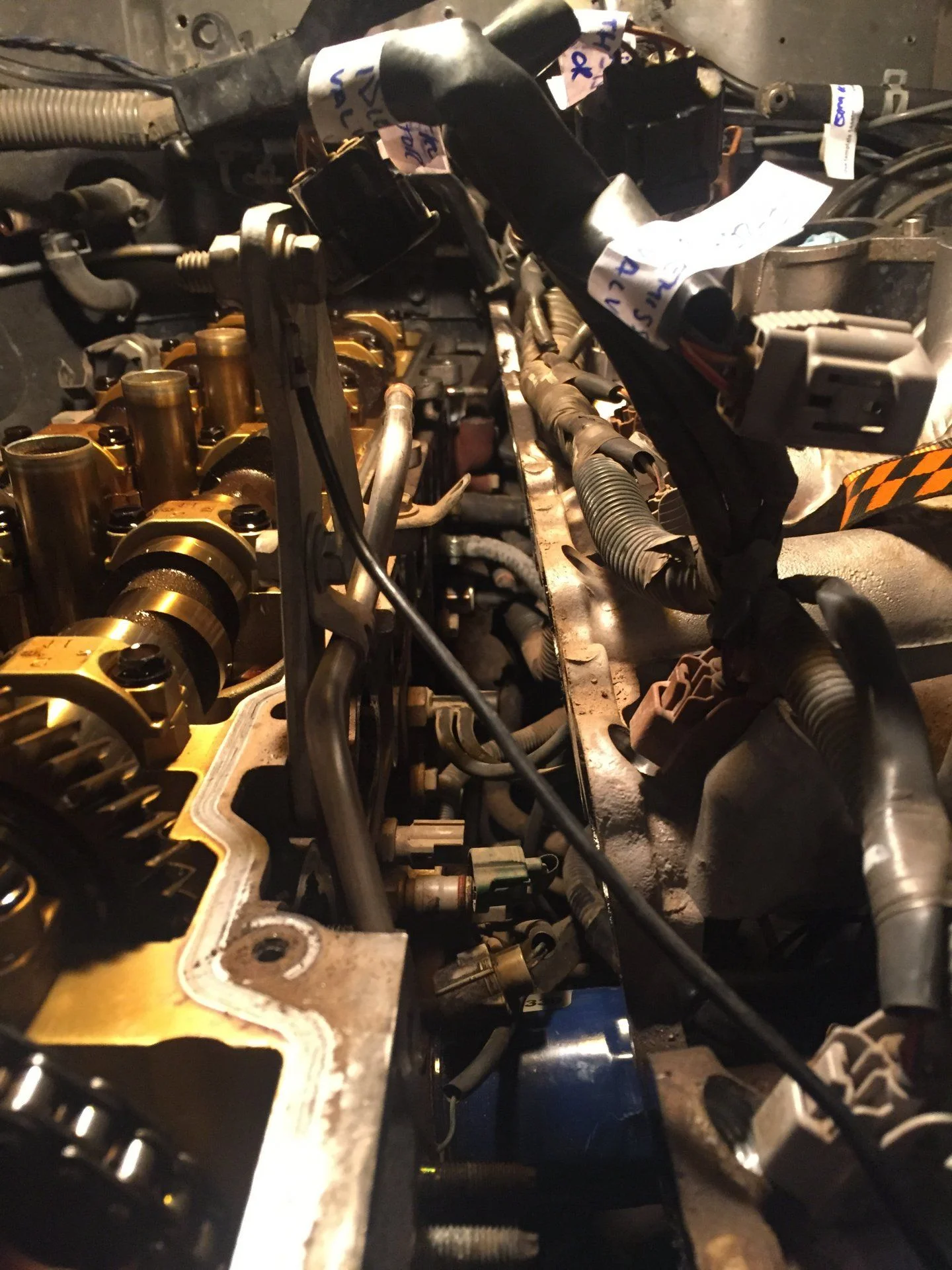

I pulled the manifold to the side as suggested by many on this forum and also as Doug suggests it in the video. I went to buy Motororcycle strap and also one x6/1 16mm.

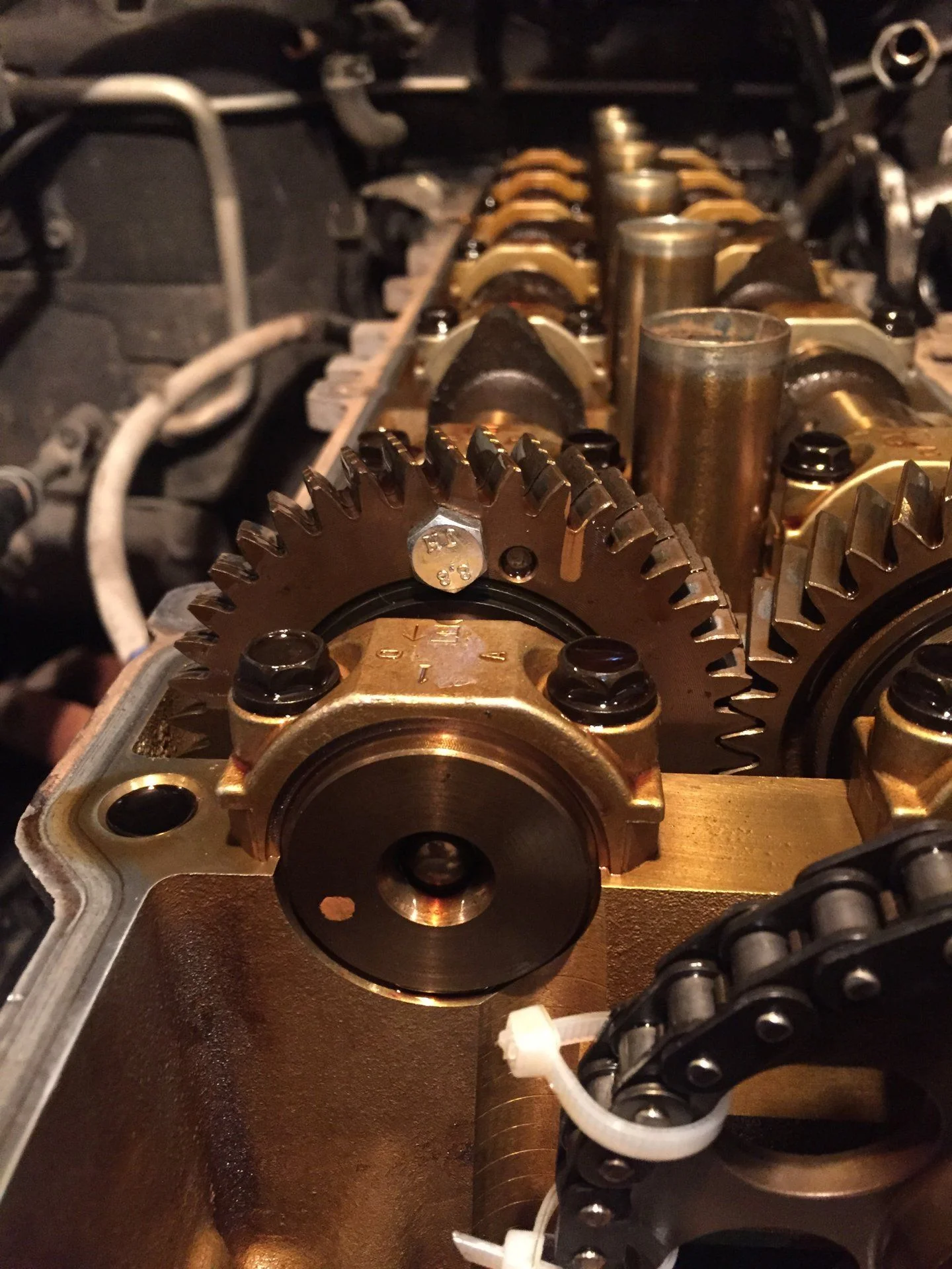

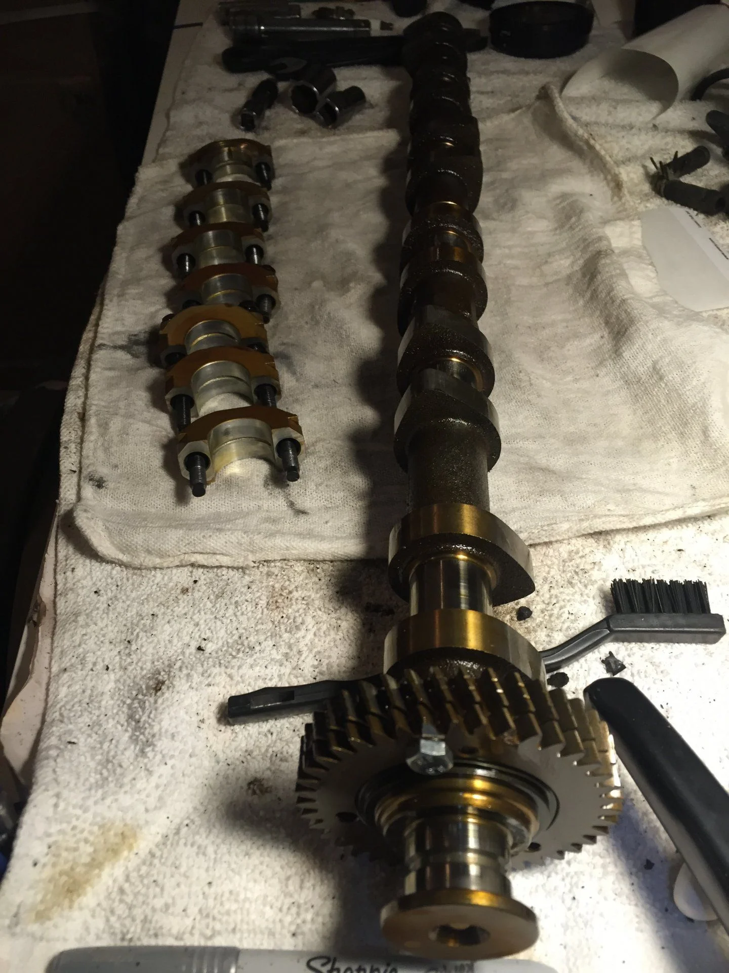

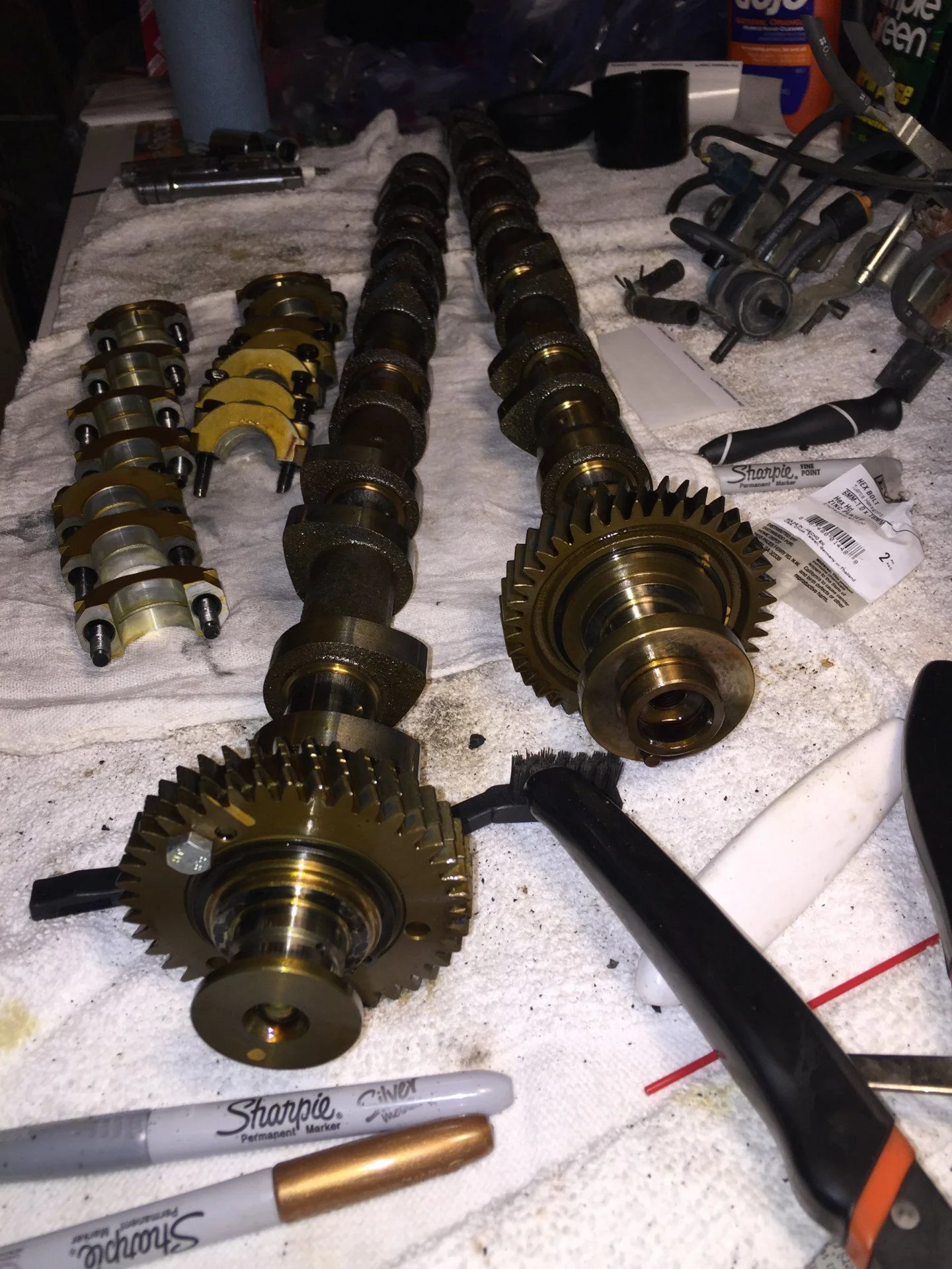

I put the zip ties around the chain and took the chain tensioner out, then I had to take the distributor gear out with the nut which gave me some issues. I ended the day by removing the camshafts which at the end was not so difficult.
