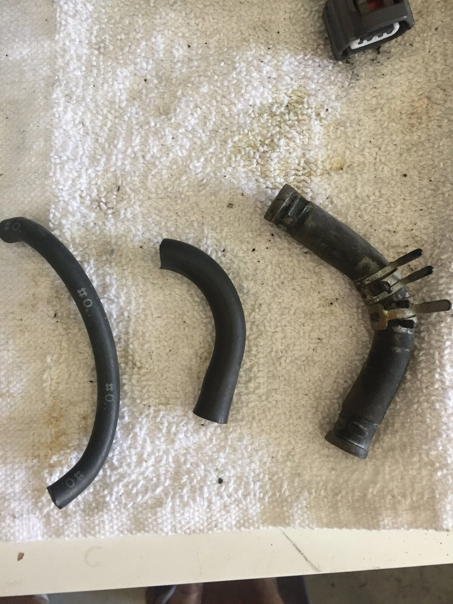

Question about the vacuum lines: There seems to be three sizes of vacuum lines under the manifold. I already ordered the smallest one which is the most used from CDAN. Not sure what are the sizes of the other two lines there , one is probably 5/16 ID vacuumhose (as taken from the P0401 Defeated - with pics) thread. And I am not sure about the third one. Anybody knows that ?
Those vacuum lines are 40 dollars which seems to be overkill , I already purchased a set of 5 90999-92003 which will cover all small vacuum lines. Btw, here is the list of what I purchased:

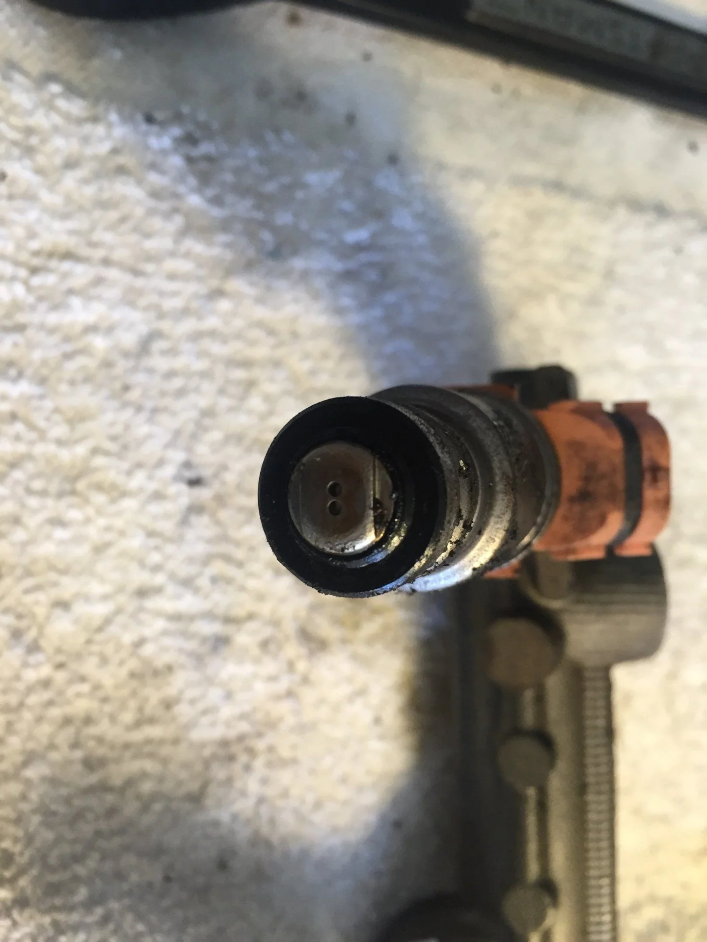

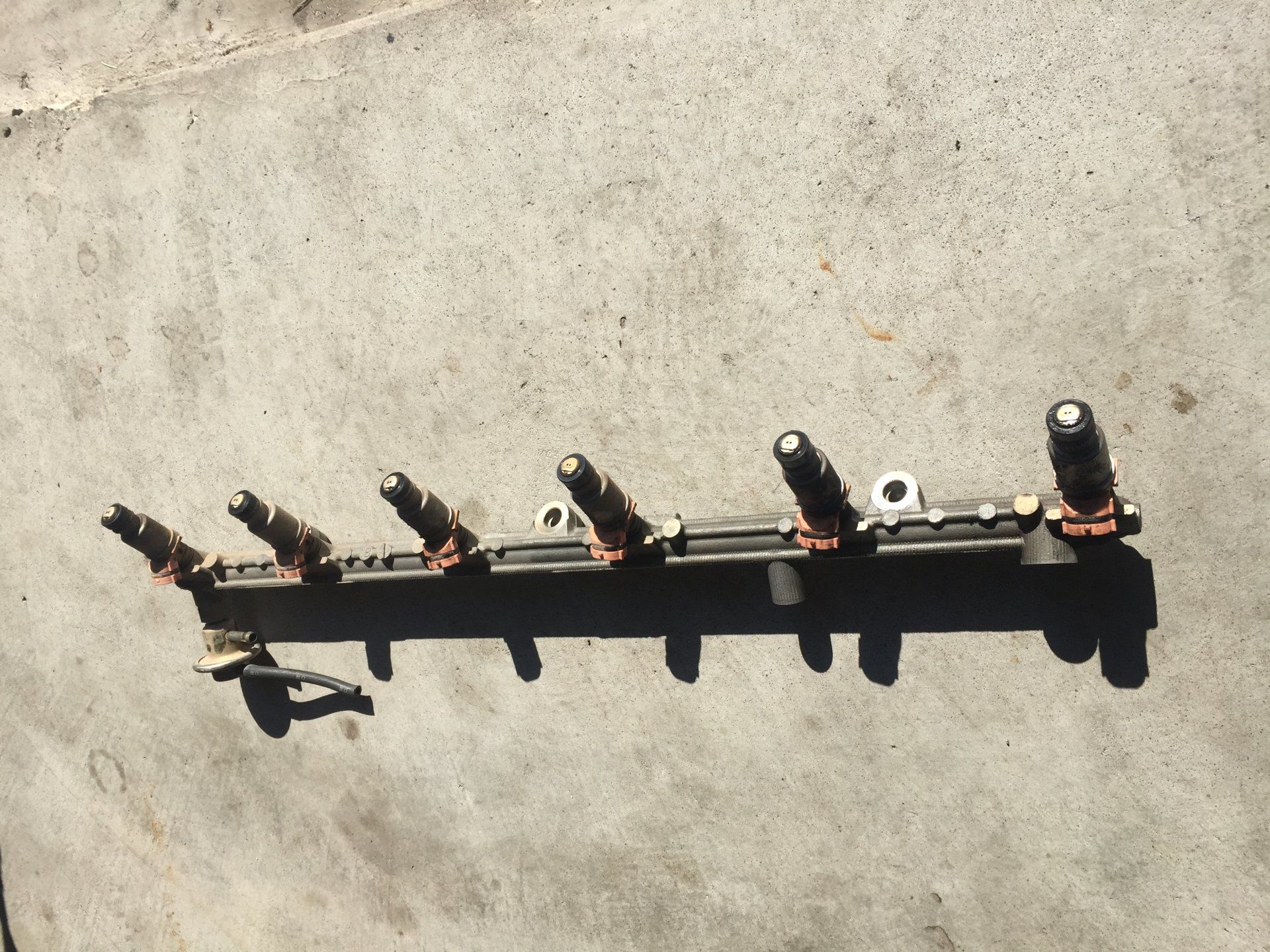

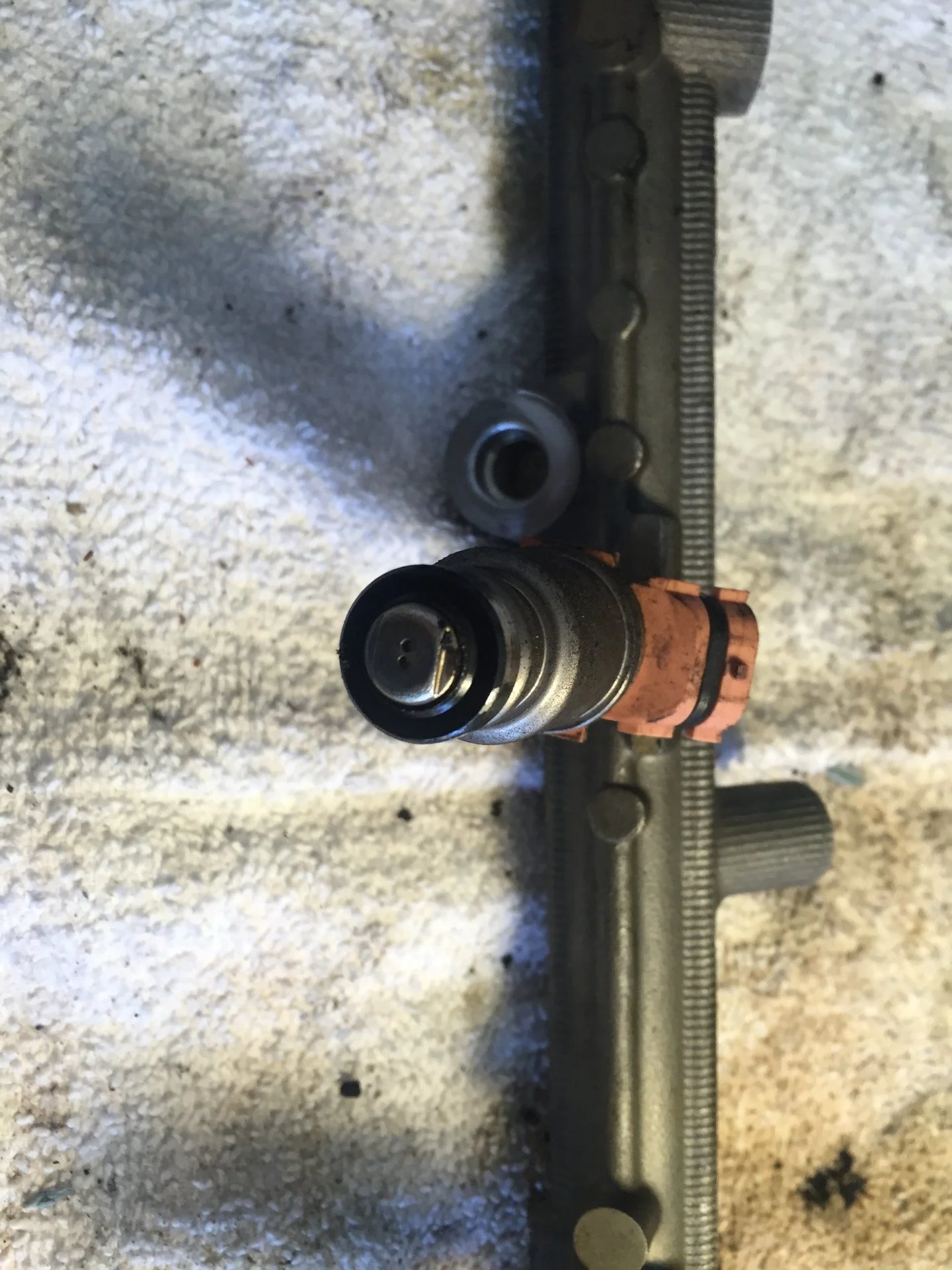

Took of the fuel rail and as suggested I made sure to take of the spacers first. It is little dirty around #6 , I suspect in the past there was probably valve cover leak..
I also found this under the car, probably it is EGR gasket.
Any suggestions where should I send the injectors ?
Jorge
