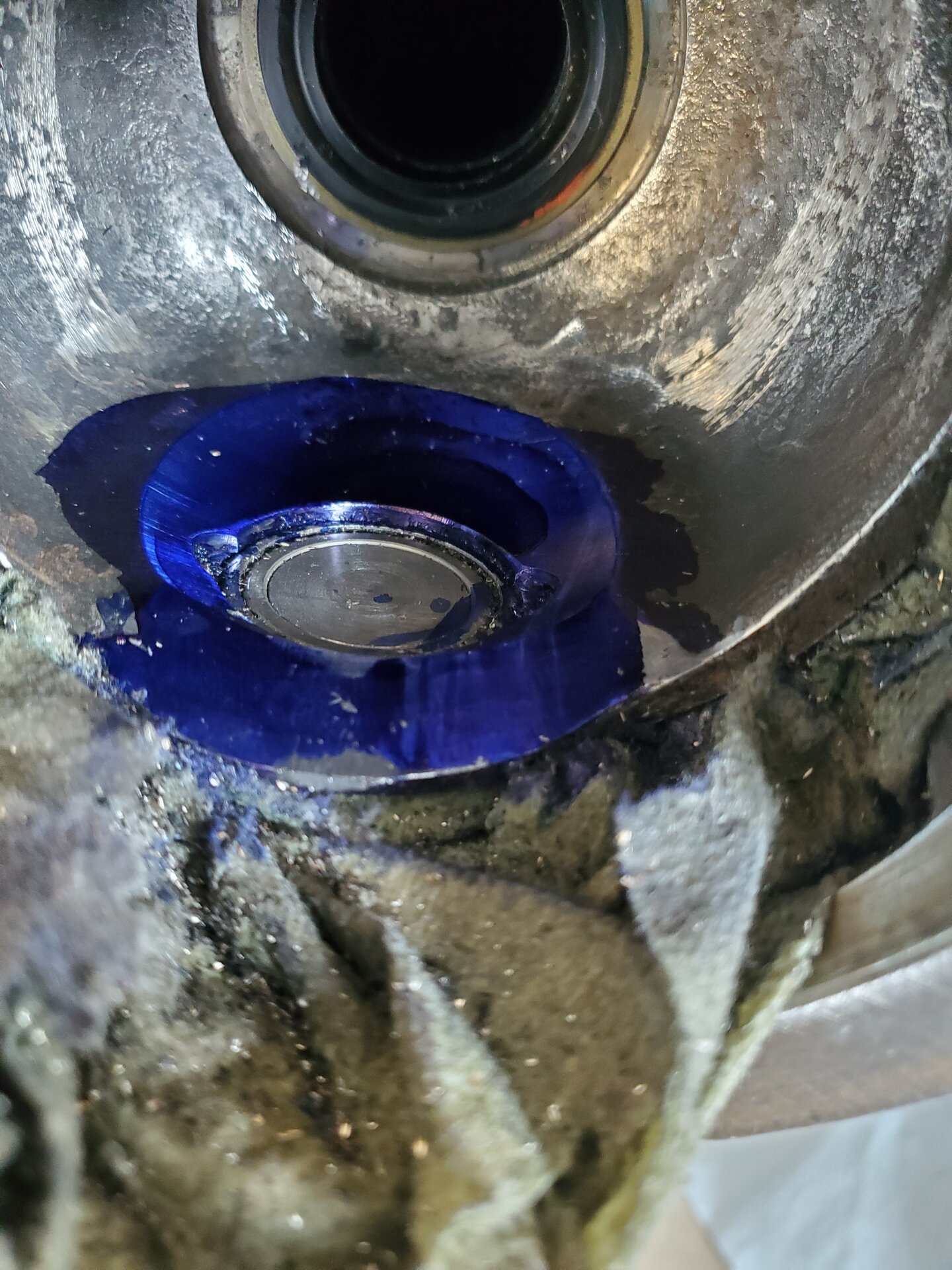

Yes, earlier frt end housings balls need to be clearanced to fit later model larger birfs. I didn't realize this hasn't been done or what yr you're frt end is.

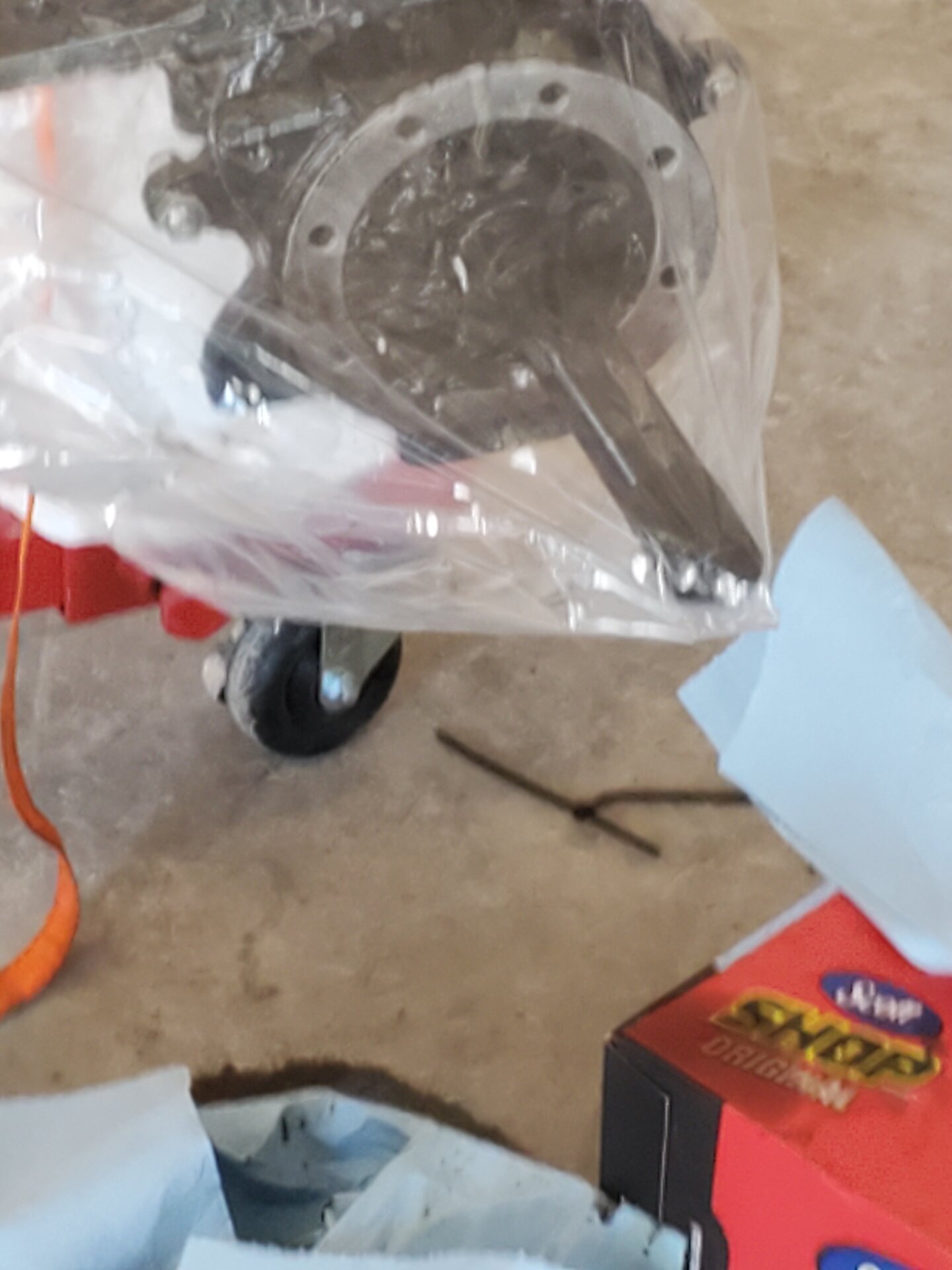

That was intentional. I am installing a big brake kit that has an adapter flange for the new calipers. The new calipers wont fit the lugs on the knuckle because they are longer for the 13.3" rotors.The bad news is , your knuckles are on the wrong side , L and R
The caliper go on the back of the knuckle , not on the front
The new Birfields were already assembled and packed with grease when they came in the box.Did you test fit just the birfield first w/o the axle attached? That's the only way you can tell if there is sufficient birfield clearance, and what you may still have to grind. When grinding, most of the removal will be from the lower flat. Only a smaller amount from the top flat if I recall correctly, about 80/20. Also, if this an elocker, and you did not lock the locker when you removed the axle, the collar may have moved into the way and the inner axle will not be able to go into the carrier. A broom handle or piece of plastic tubing will work to relocate the collar. Ask me how I know.
Also, know that once you torque down the upper and lower knuckle arms, you squish the knuckle ends a little bit and can loose a bit of clearance the grinding created. You may have to grind a bit more to overcome that. I had to.
You def need to push down on the birfield to get the inner axle to raise up. It's a game of patience, if it feels like it has gone in a bit, then I use my foot to rotate the front driveshaft. That usually does. it. Good luck.
That's usually the case. A 3 foot piece of 1.5" schedule 40 pipe will easily separate the birf from the inner axle to be able to use just the birf for fitting purposes without dealing with the inner axle. Just keep several snap rings for the slot on the outer edge of the inner axle for the refit when you have fully ground the knuckle and are ok with the birf fit. I keep a lot of moly grease to regrease the birf and to shove into the knuckle following the insertion of the birf/axle. You want to fill the knuckle about 3/4 full of moly.The new Birfields were already assembled and packed with grease when they came in the box.
