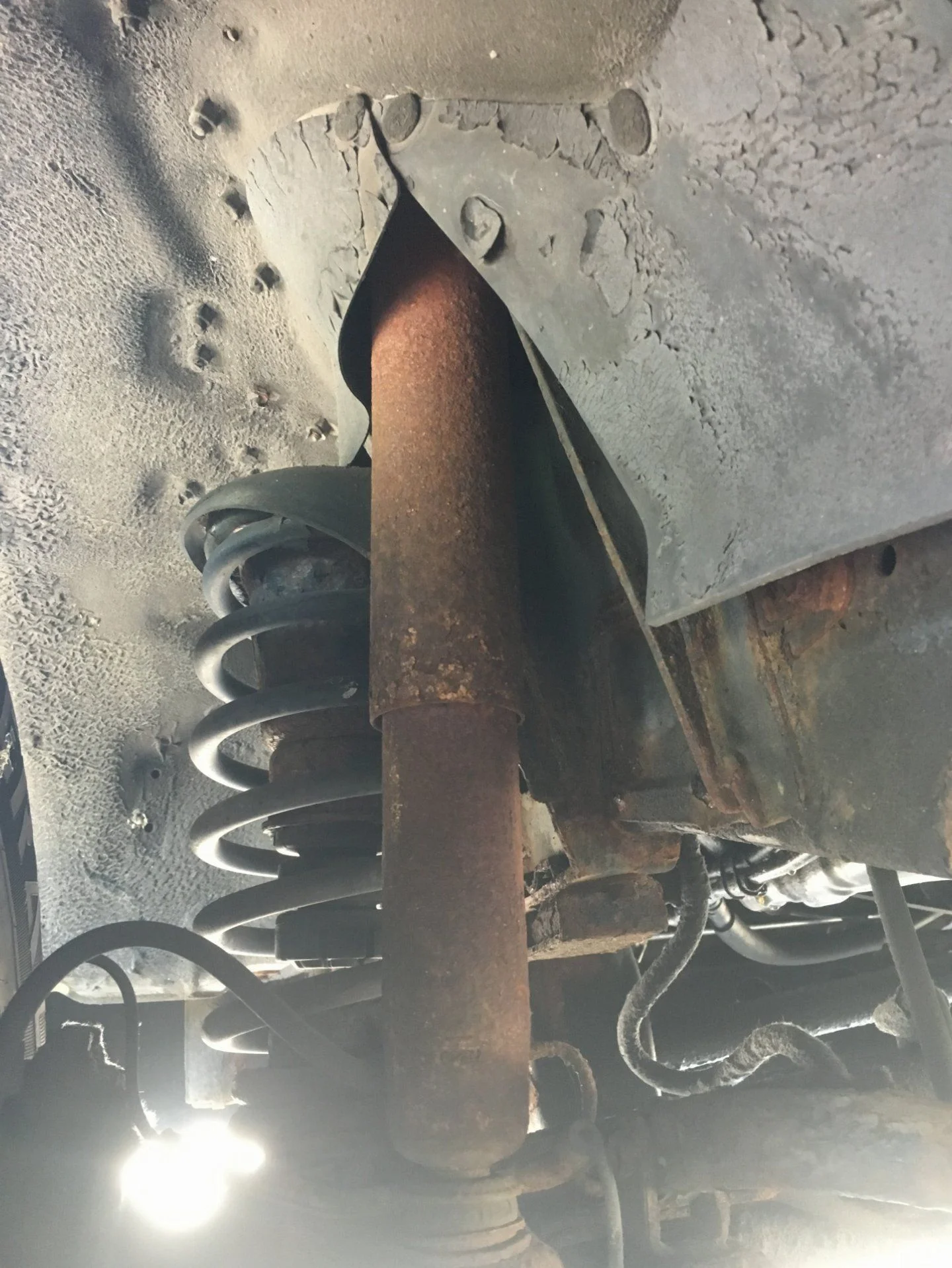

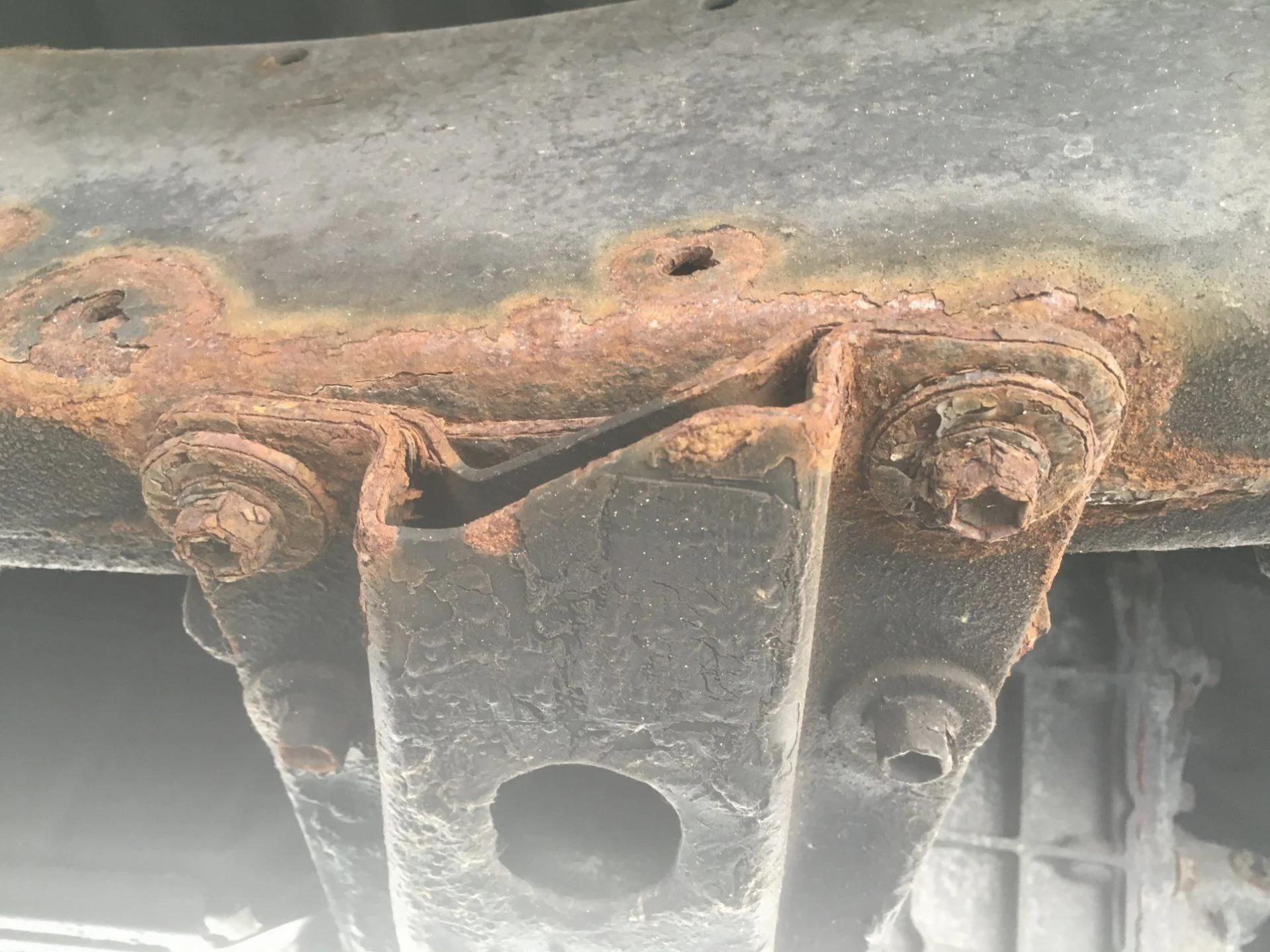

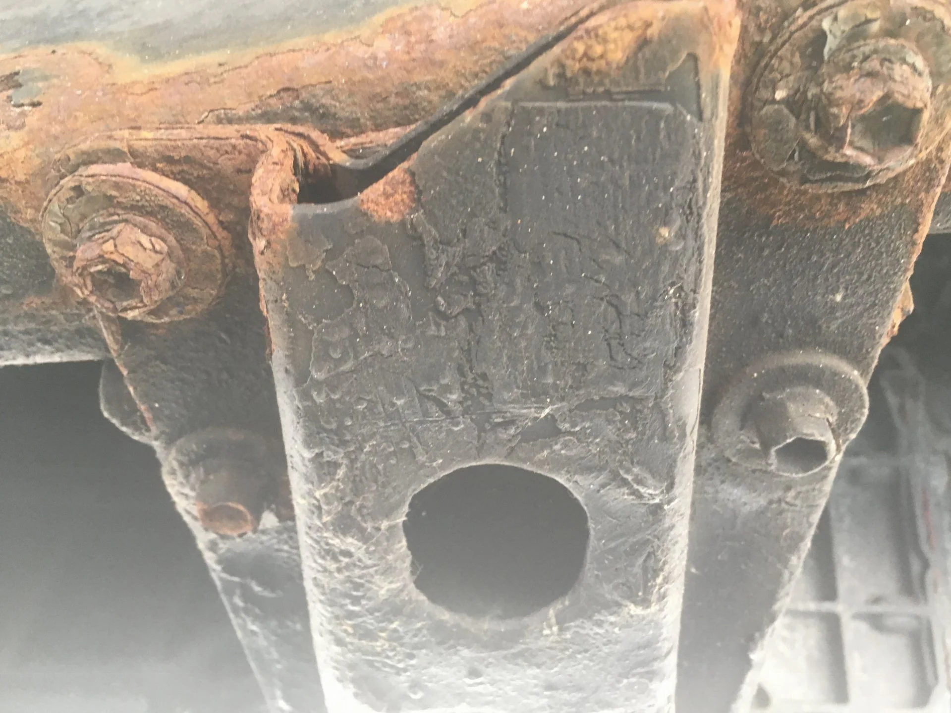

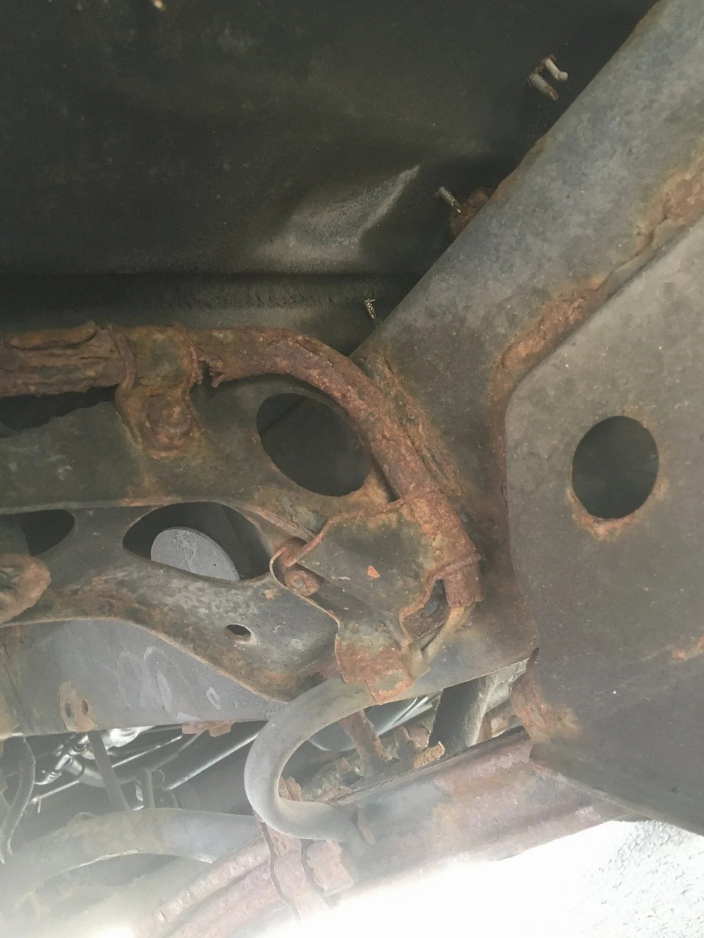

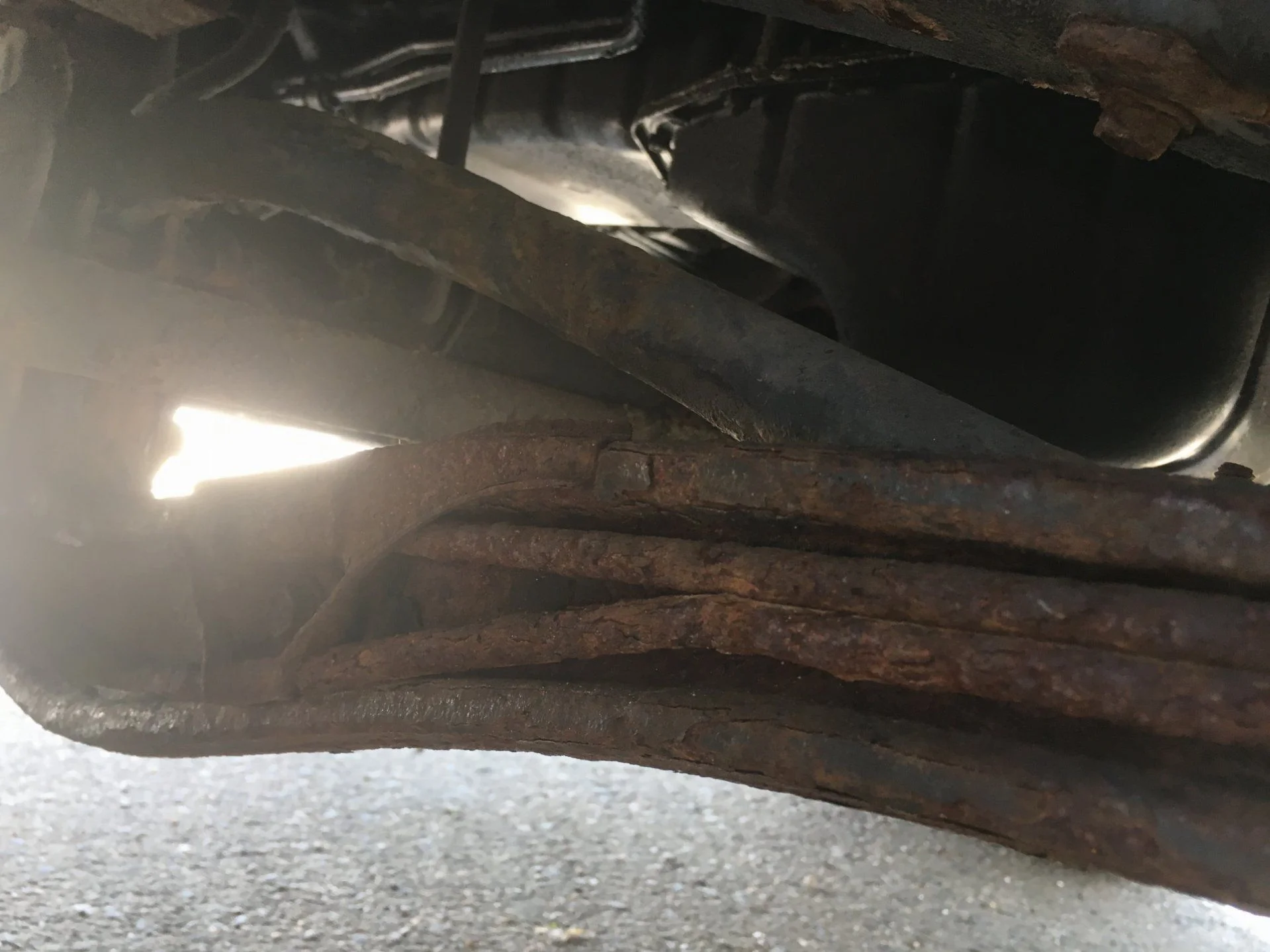

Is it to late to turn this beast back into its former glory? It came from Illinois, land of the salty roads that breed rust on metal. Pics aren't the best but you get the general idea of how bad the rust is underneath. Surface rust doesn't look to bad although it has been repainted so who knows what lies below. What do you think? Cost estimations?
For $6000, you can buy any number of clean Western trucks in Colorado. There are worse looking trucks out there, but your pix don't show some of the bigger trouble spots. I wouldn't touch it simply for the reason that there are plenty of better/other options.
The problem with rust is that every single thing you ever do will take forever. Need to remove that crossmember? Look forward to seized bolts, broken bolt heads, drilling it out, and maybe not having enough steel left to maintain threads.
If that were an FJ40 and it were cheap, I'd consider it. Not an 80, though. You'd literally have to give that to me, and then I'd just drive it until it broke down or broke in half.
I'd pass and find another, rust like that just makes everything you do that much harder.
Beyond your base purchase price of 6000 dollars, you could be looking at 1000's of dollars, and lots of labor if you want to repair all that rust damage. Plus that's not counting all the pain and aggravation your going to go through finding, and replacing those parts. At my age, Not having to deal with that kind of aggravation, is simply priceless!
$2500? Maybe, if mechanically it was sound and things could be used as organ donors when the rust finally wins.
$6000? Not a chance. That rig has less than 3 years left before either a major rebuild or junkyard.
YMMV.

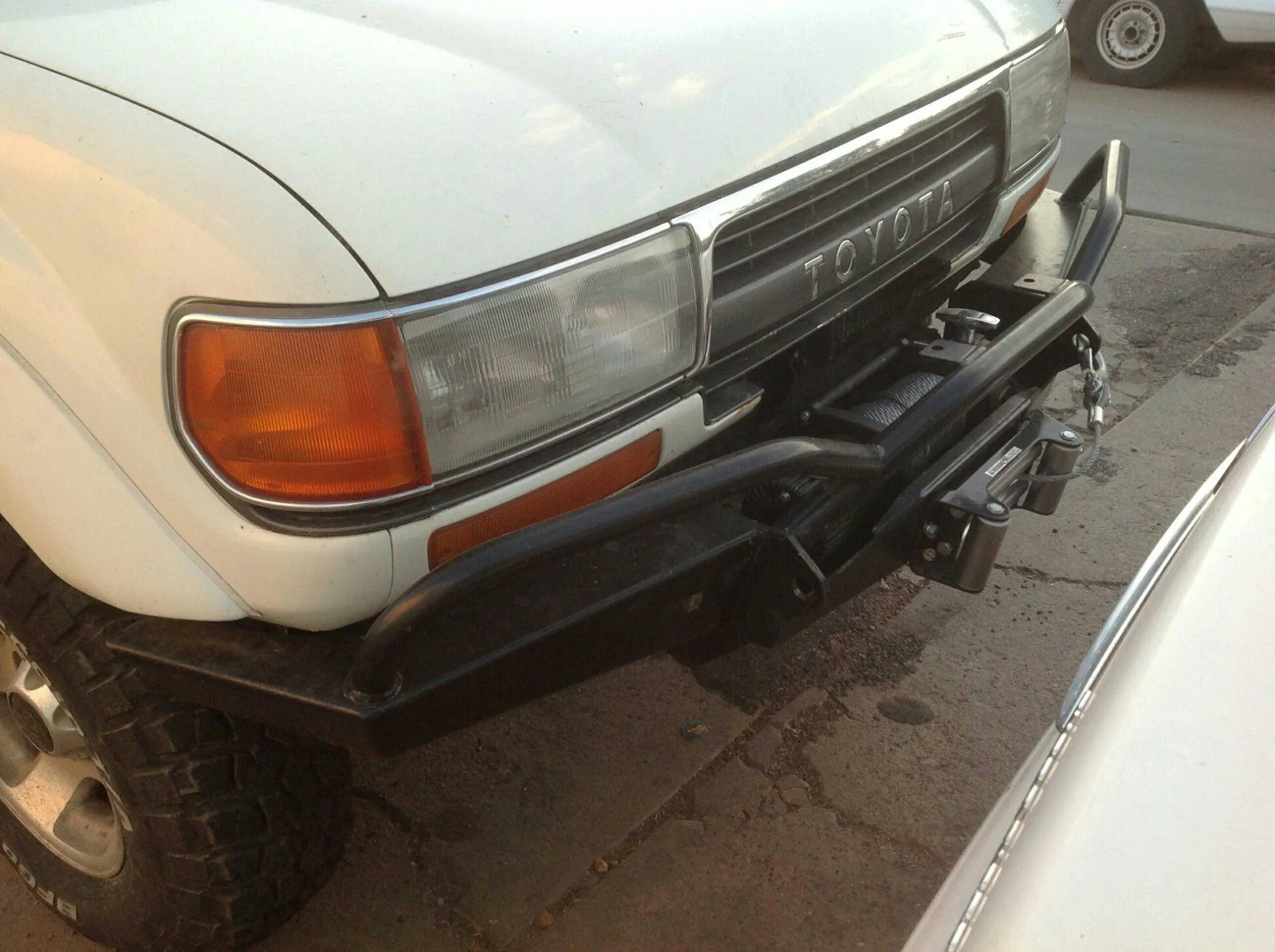

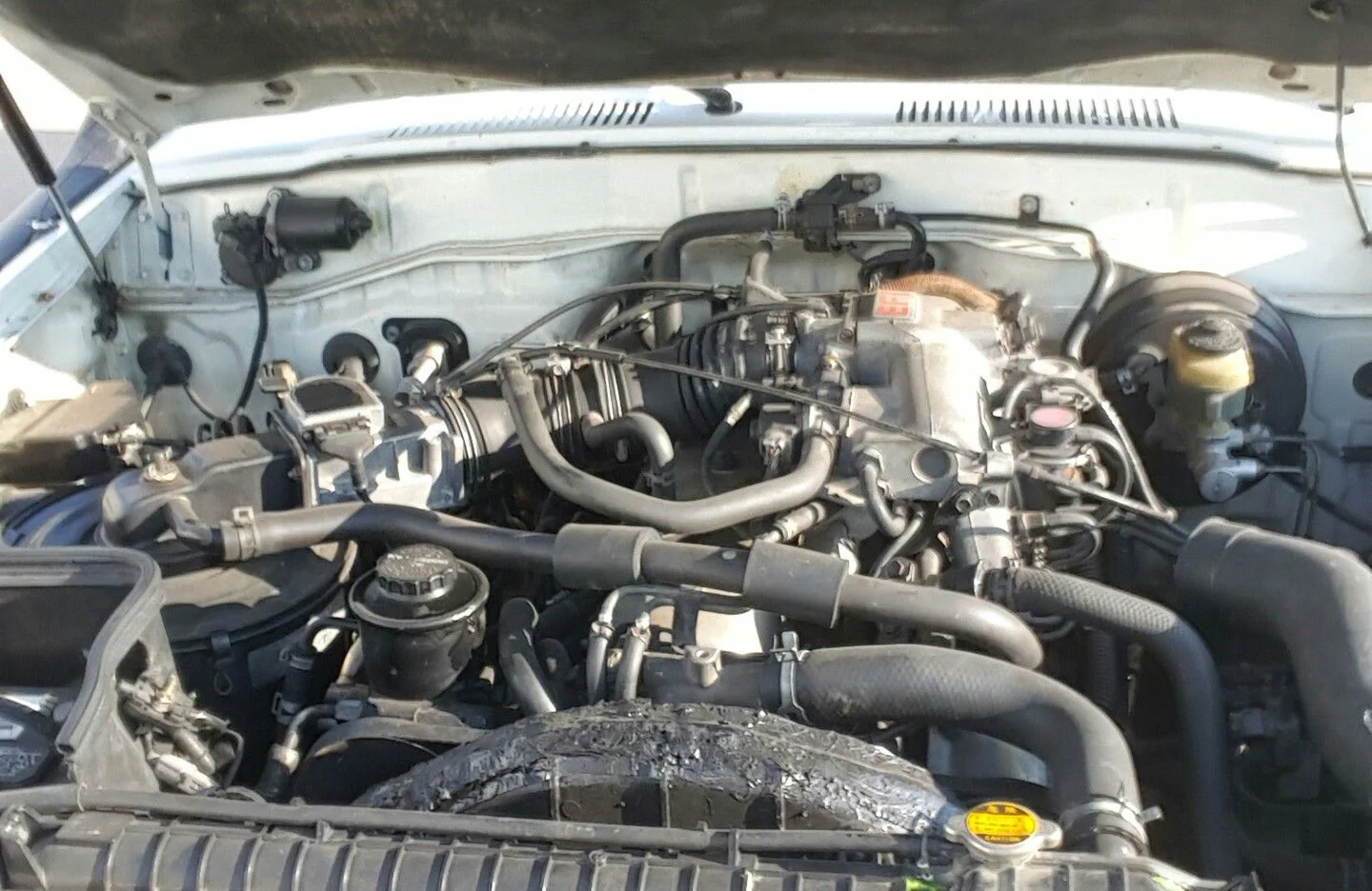

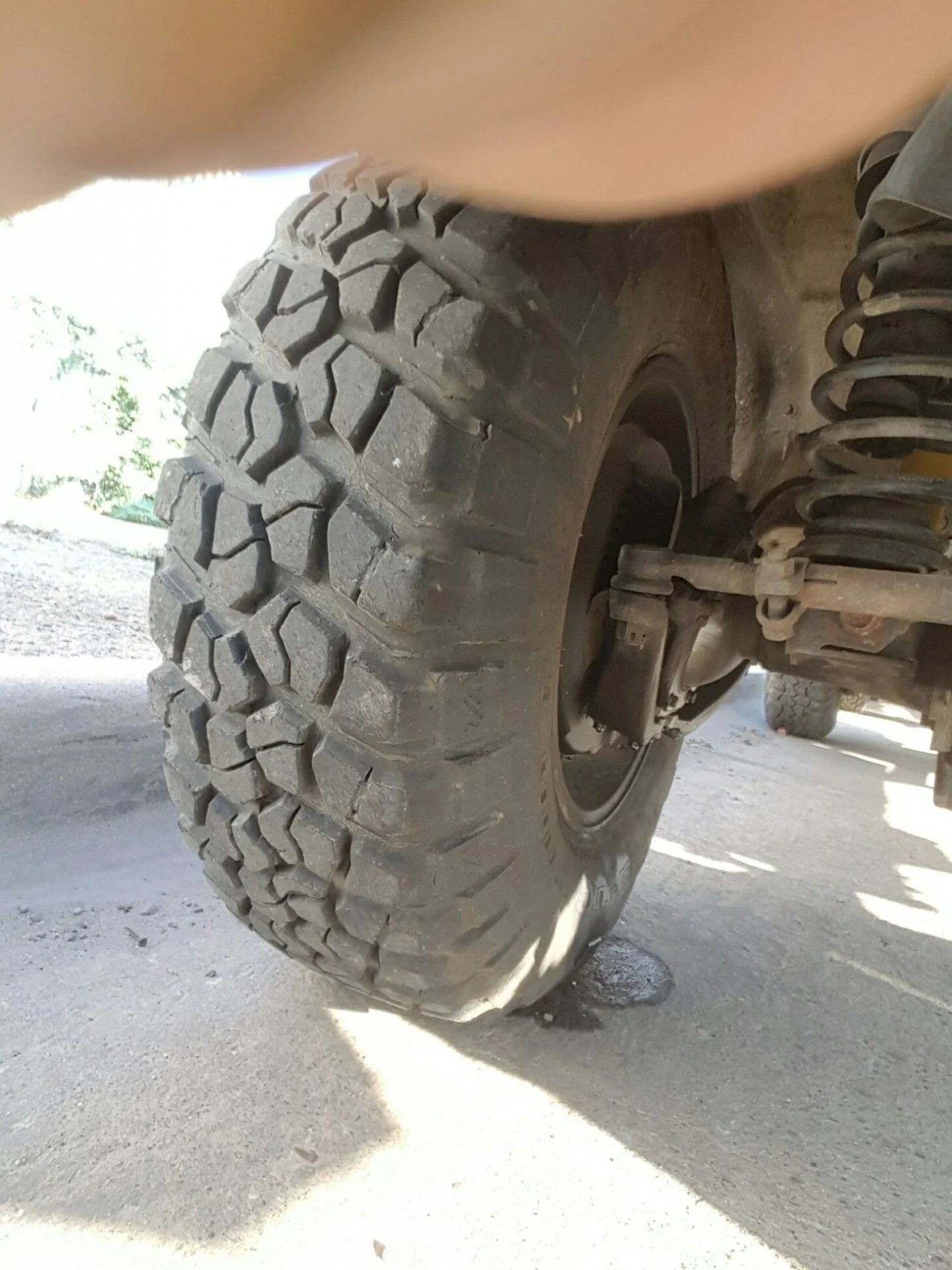

That is a 91/92 FJ80 with a 3FE engine. And what the hell happened to that fan shroud??? The AFM also looks like it's been cut open and resealed. Hard to tell from the picture, but there appears to be a gap between the knuckle and the lower steering arm.
Yeah 91 with 3FE. Thinking it might be a better option for my first cruiser. Easier to wrench on and more durable. Owner said it overheated on him in the mountains a month ago so he replaced the fan clutch? What other issues can arise from it having overheated?
Parts are getting harder to find for the 3FE. I am not sure if it's easier to work on, but I don't think the 1FZ-FE is hard to work on. Anything that has over heated could have problems, but the head gasket on the 3FE is less prone to failure. Depending on what happened, there could still be a number of issues with the motor and the cooling system for sure should be overhauled if it looks like that and has spent it's life in the desert.
Ask @Golgo13 if his has that much rust. I think his may actually be worse.
If it's in Phoenix you could have it sent to Camelback Toyota and pay for an inspection. The service manager and some of the techs are cruiserheads, they know what to look for and could even get it repaired correctly so you could fly in and drive it home if you decided to purchase it. I do almost all my own work, but this is the one shop I have had perform service for me on my land cruisers.
Is that brake fluid on the tyre and ground or lil dog pee on inside of tyre?
Pee Lol, I think @jonheld is correct, loose knuckle studs and it's leaking gear oil, but could be blown caliper seal.
