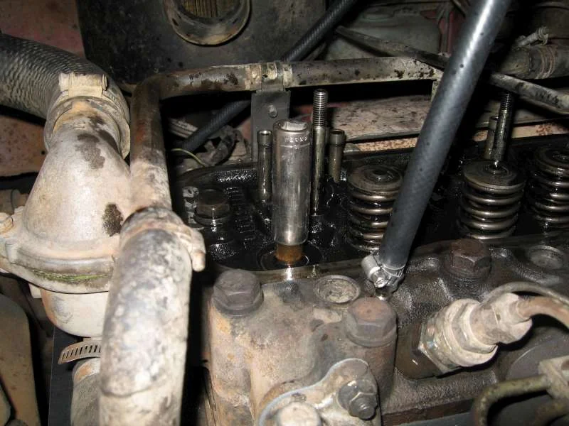

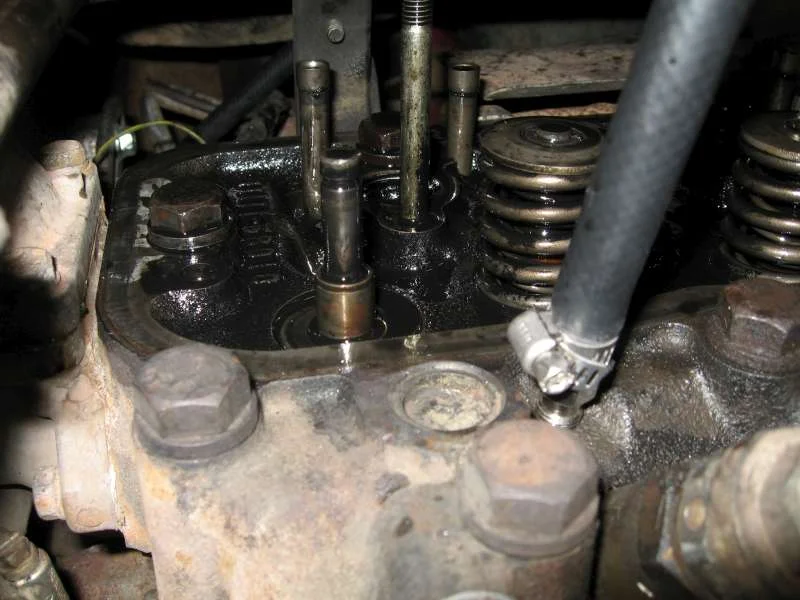

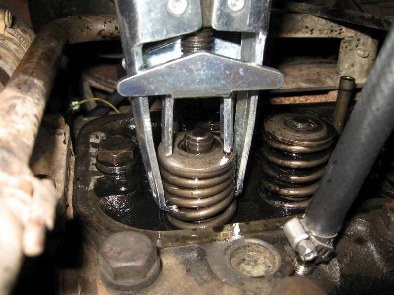

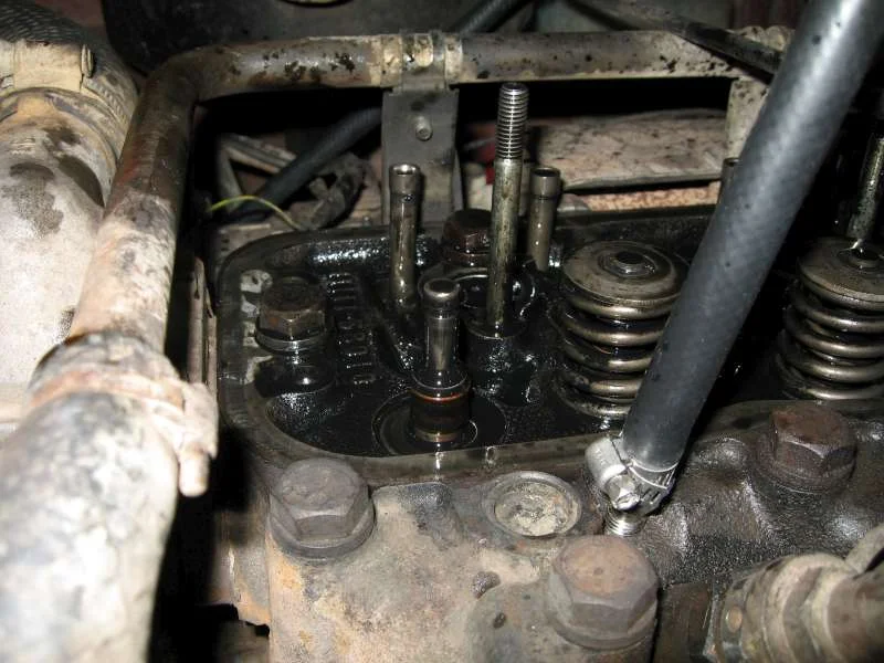

I don't see people talking about valve seals on 3B's much, but I found that 3 of them were loose, and 2 weren't even seated on the guides anymore, they were just floating up on the valve stem!!
Sadly, I couldn't get my hands on 8 seals, SOR only had 6 and I couldn't find ANY suppliers. I replaced 5, ruined one, and reused the tightest fitting of the old ones. :hillbilly:, I know.
Here are some pics, its an easy job...

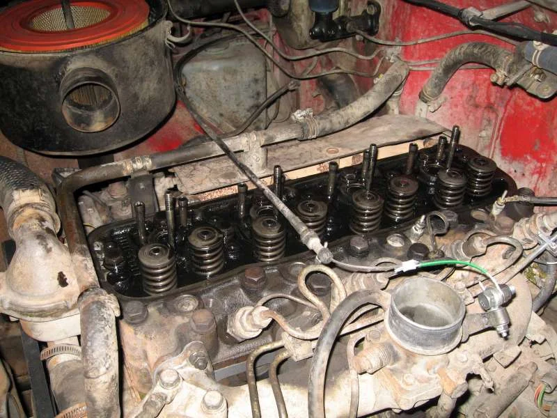

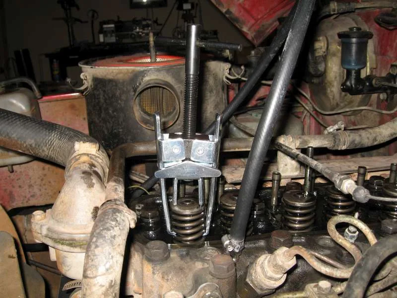

#1 remove rocker cover and rocker ass'y.

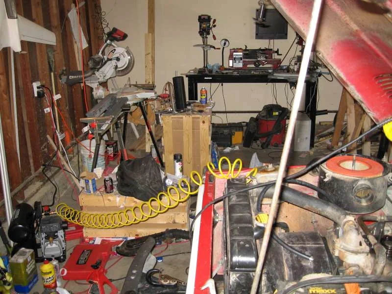

#2 rig up a hose from your air compressor and set it to 90psi or so.

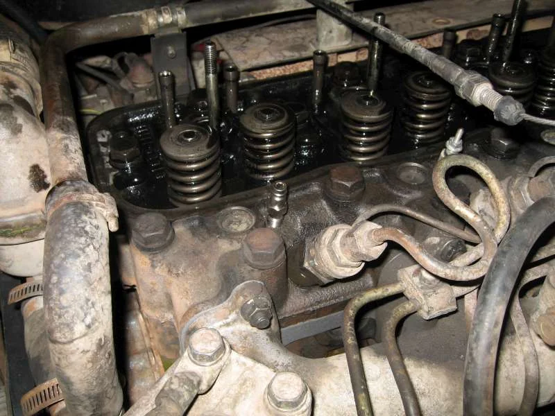

#3 i used a spare fitting from my compression tester set, if you do so, remember to drill out the schraeder valve inside it though.
#4 attach the compressor hose to your fitting with a clamp, and apply valve spring compressor
#5 tap the spring compressor to break the keepers loose and remove them
#6 remove the springs

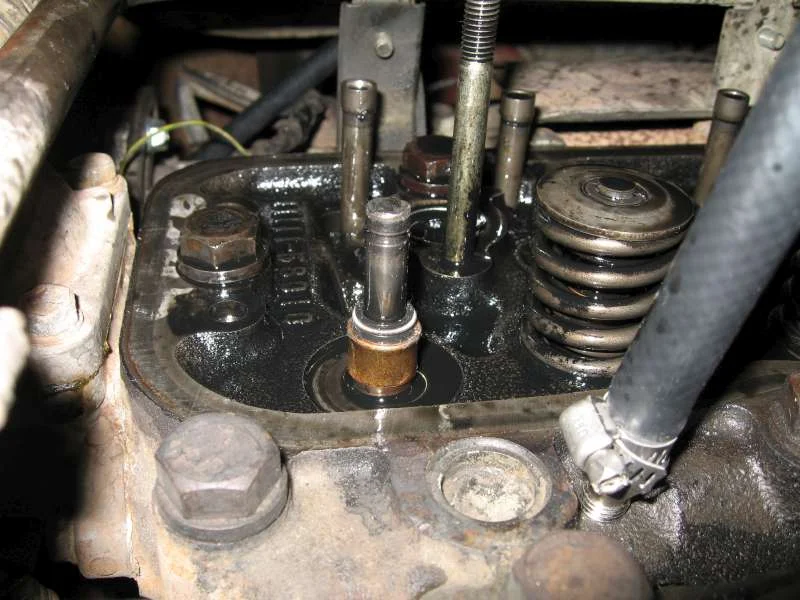

#7 remove the old seal, just pull with a twist.
#8 install the new one. I used a socket to help push it down easily... they're TIGHT! so careful hammering is needed. I ended up ruining a seal by hammering it on cockeyed, beware!
#9 Voila! rinse, repeat.
