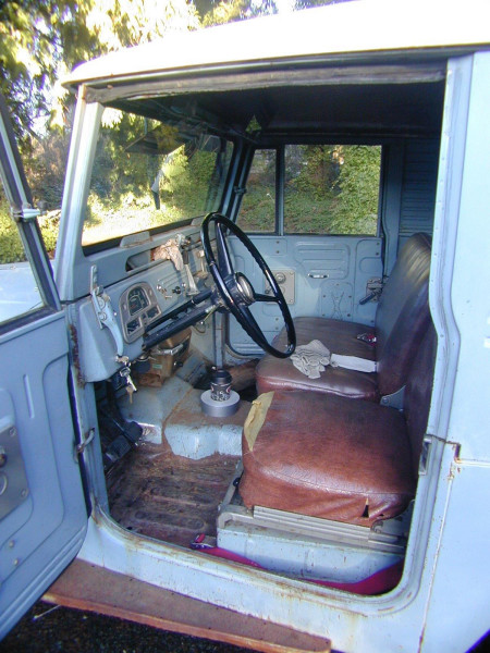

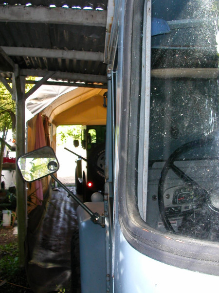

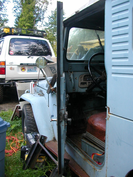

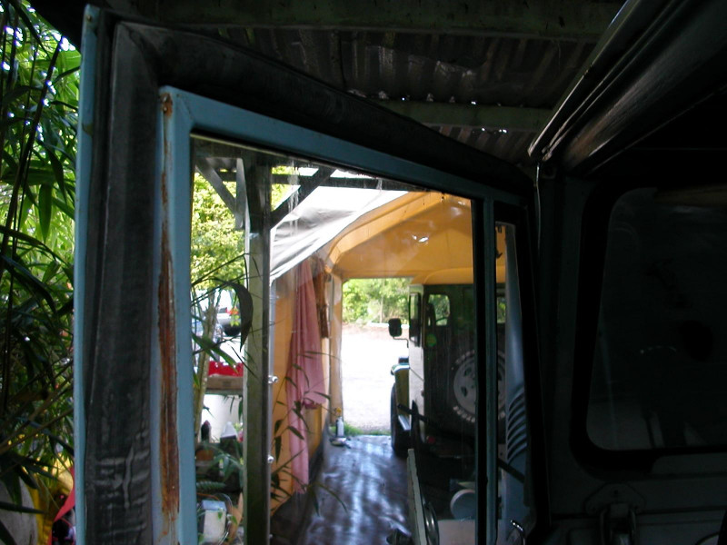

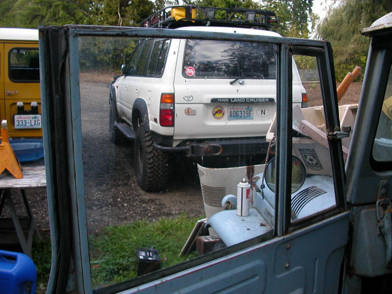

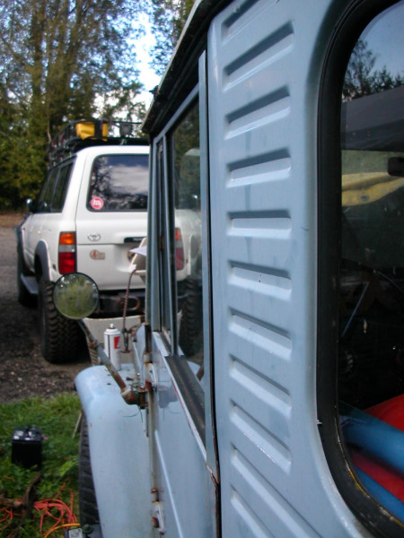

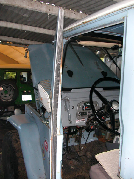

early doors are different, think 66 was the change
this is a 65 door on a 65 hardtop(so same as your hard doors), you can see its much more straight up and down at the upper portion. also the upper bar is much smaller than on the latters
this is a latter door(66 in this case) you can see the upper is curved inward and the top bar is thicker
someplace I have pics of the 65 doors in the 66 and they make it very clear what the issue is.
