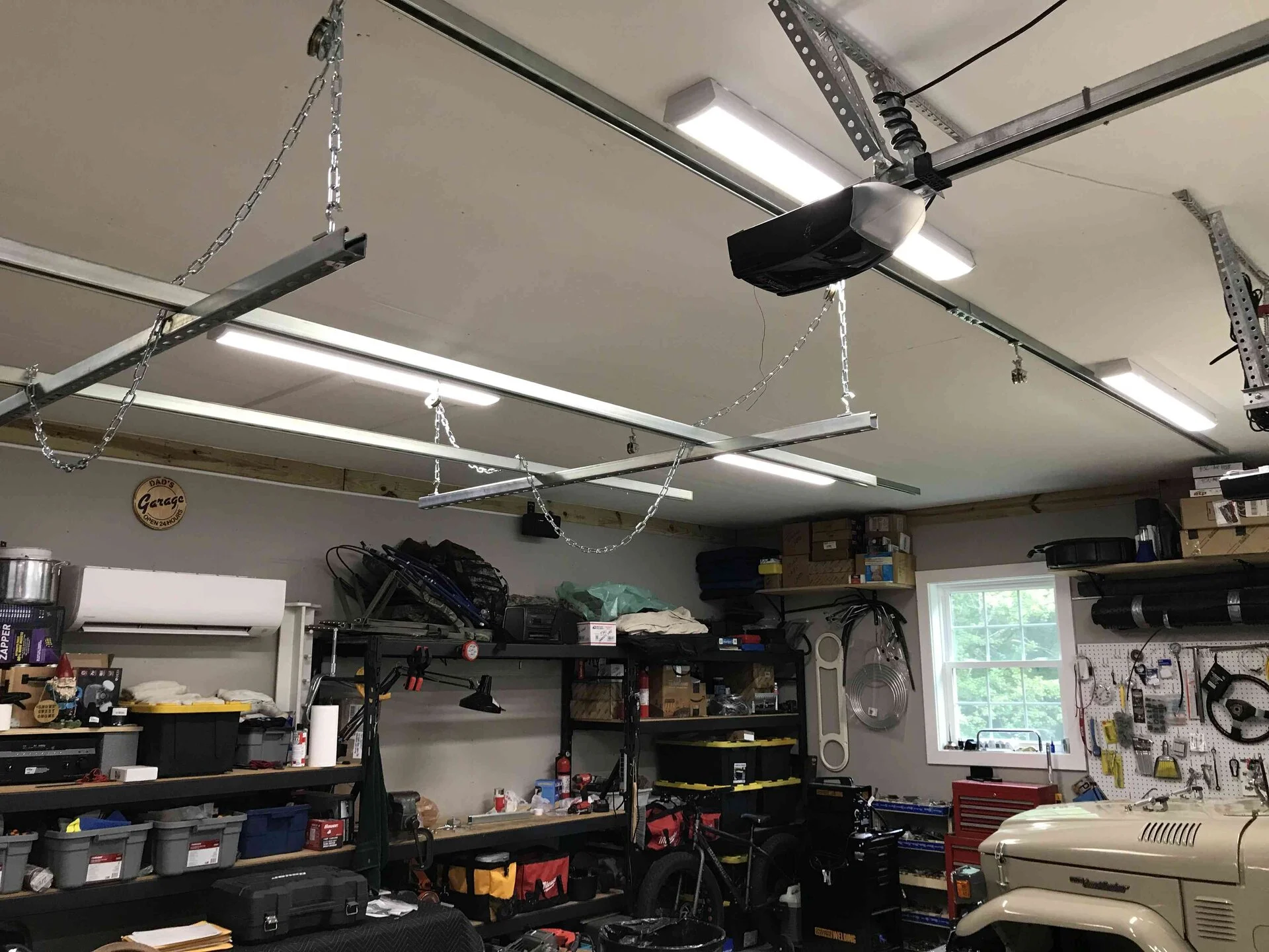

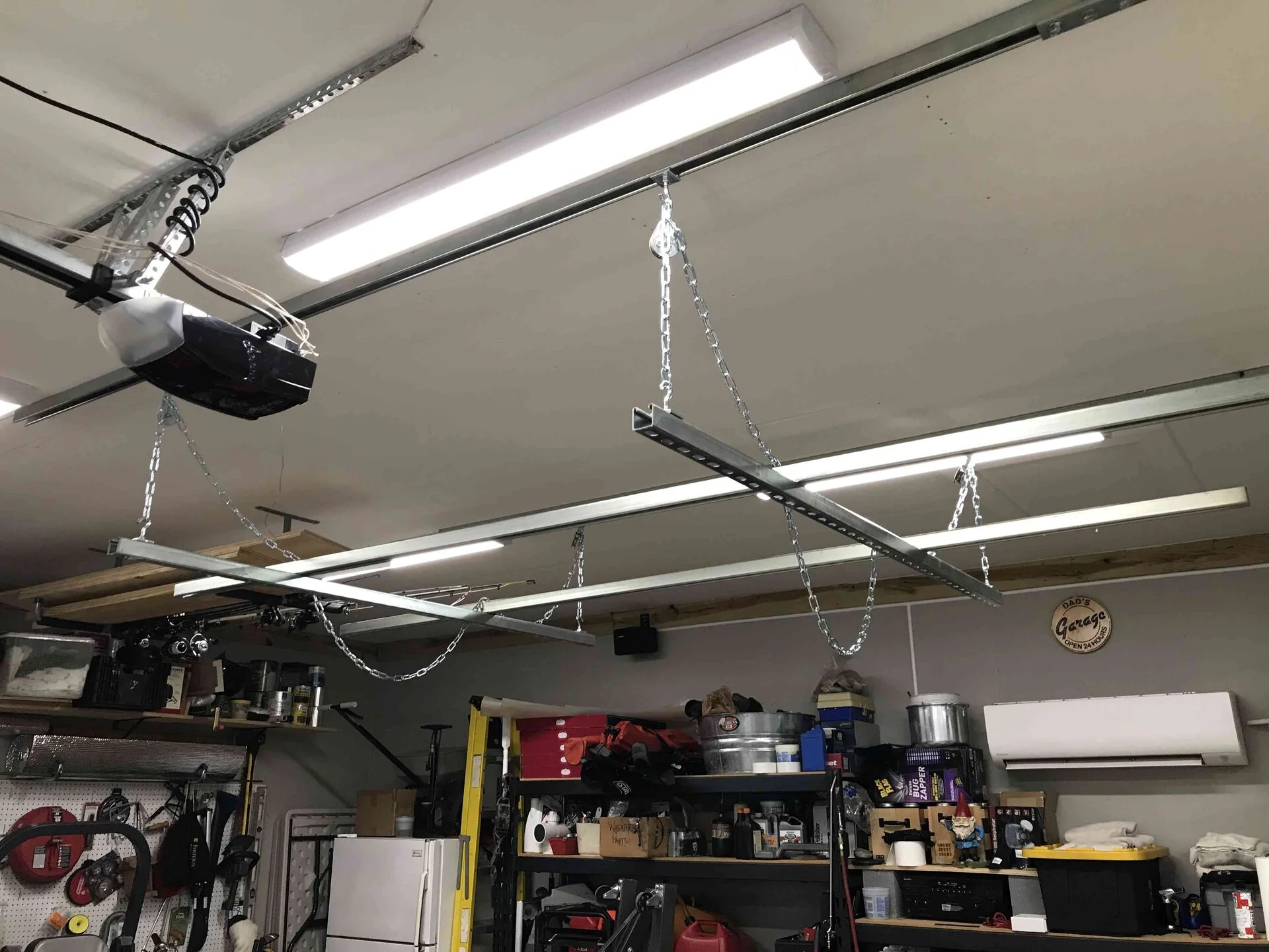

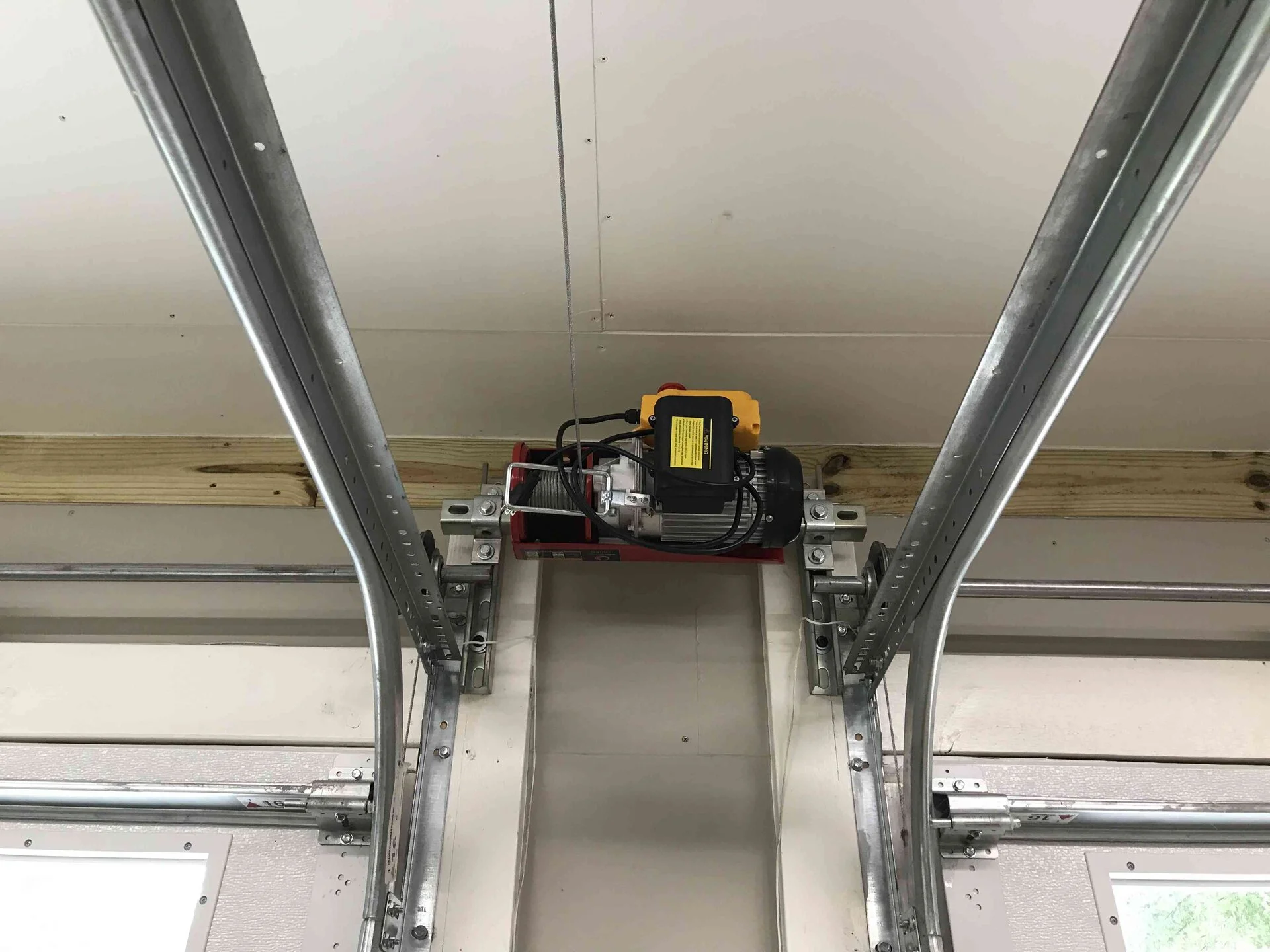

Finally got my unistrut & hoist installed...plan to take the top off this weekend. The ceiling mounted unistrut is hung using U-bolts over the roof trusses. The hoist mounting unistrut has six 4.5" long 3/8" HeadLOK screw into the LVL. The unistrut frame hanging by the chain will hold the doors and the other section of the ceiling mounted unistrut will hold the roof.
