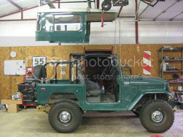

Storage from the rafters
I just took mine off yesterday. I just unbolted everythig ,tied a rope up to the rafter above the front and rear ends of the hardtop and hoisted it up one side at a time. You can use a couple of 6 foot ladders to support each end while you snug up to the right height. I did this without any help, so it's doable. I just hope the roof trusses can handle the extra weight.
