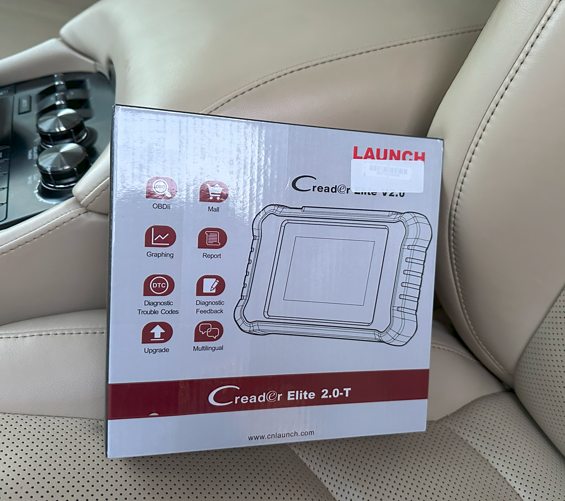

This thing is legit. Thanks to @Boston Mangler for creating the thread. I was able to easily customize settings as well as make AHC offset adjustments.
The one thing I didn't find was AHC pressures. Perhaps I just need to play around with it more. Did I just miss the parameter?
Mine arrived on Friday. Programmed seat belt chimes off and windows down from fob. Brake bleed procedure will be useful too. Thanks for the info!
Got mine in a few days ago, hoping to try it out today.

Glad ya like it!
Real credit goes to @misteracng that mentioned it. I had never heard of it and was in process of acquiring bits for techstream and already irritated how much of an ordeal it is. This is MICH easier

The AHC ECU only has one pressure sensor and doesn’t try to help you with front/rear pressures like the 100 series did. It’s not a super useful metric on the 200 series, as far as the data Retrieved from the ECU is concerned.

Tried to program a key fob in my 13 LX and my wife’s 17 GX. No luck on either. I could see that the LX had 1 spot available and the GX had 2. It would start the process and recognize the original key, but would not find the new one. Also, I couldn’t find a place to manually input the PIN on the new key.
Can this techstream alternative run things like the active fuel pump test or dynamic compression test? I have techstream, but can't run the active fuel pump test.
I have this unit and Techstream. Have not tried this test or done any type of comparison but my bet is no. I doubt it's going to run anything above and beyond Toyota's Techstream diagnostics. However, it's small, light, easy to store in the truck when needed.
