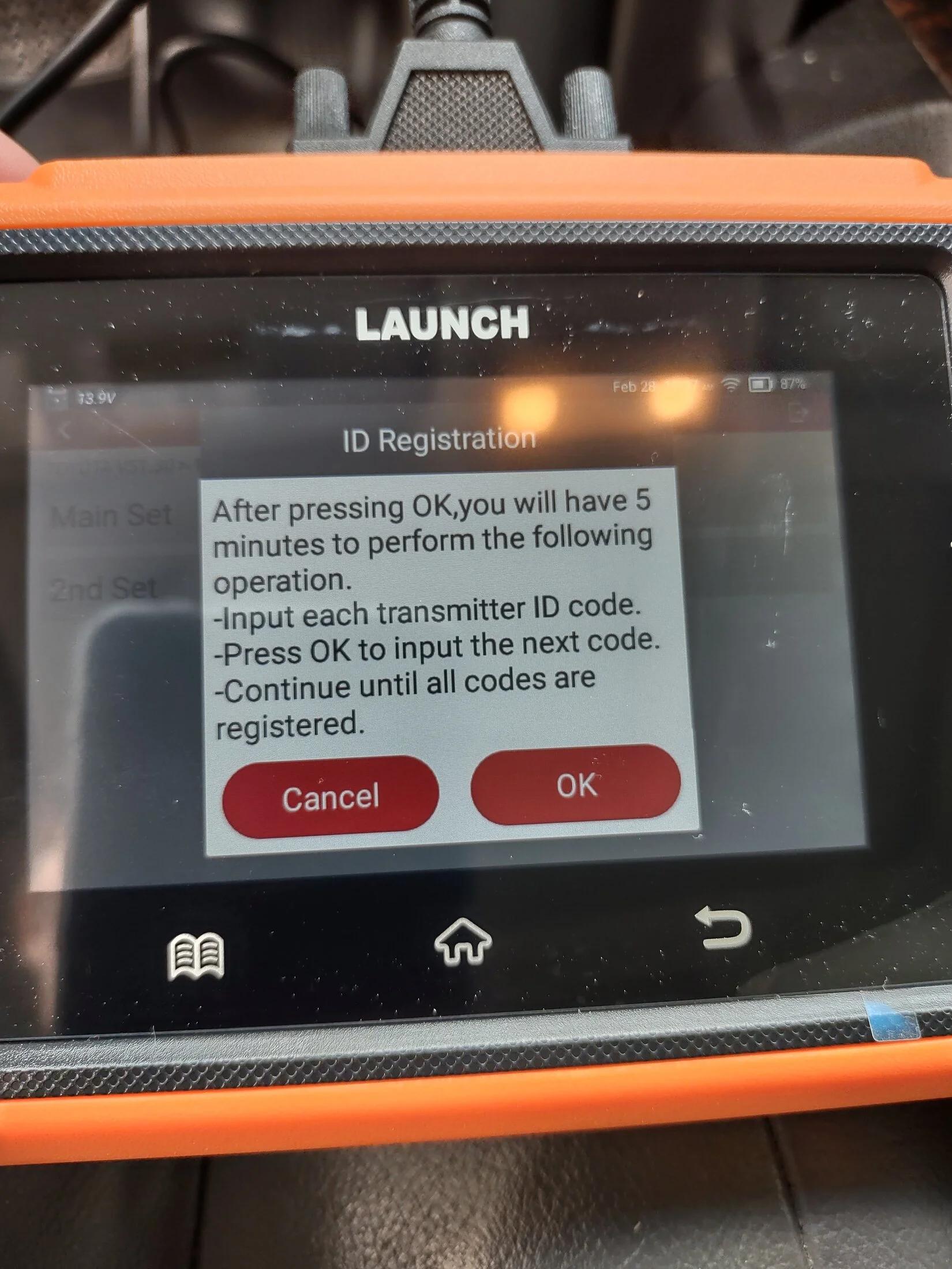

Where is the TPMS stuff buried? I swapped in some Tundra wheels but the sensors on them are always in 'checking' mode.

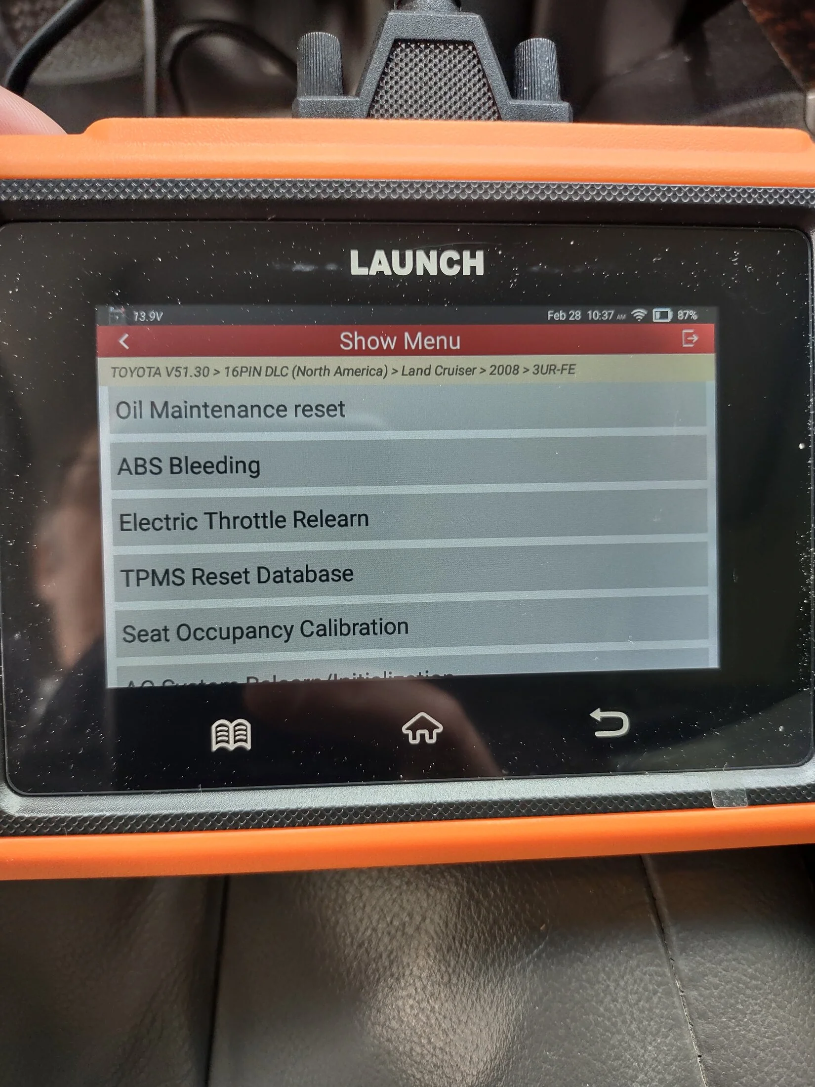

The service functions look like were you do bleeding, key programming and TPMS stuff, but I didn't dig past those initial menus. @Boston Mangler goes through some of this above

TPMS relevant info
I don't have the ID codes on my 2nd hand wheels so I guess I'm looking at a few more months of 'checking' on my dash readout.
TPMS relevant info
You can probably just drive up to your favorite tire shop and ask them to read them for you for free. Then just write the codes down or take a screenshot of their reader.
Well this makes me think this thing could read them as well, it might just be buried in some other menu.
You can probably read codes that are already programmed into your system (like techstream), but I am pretty sure you can't read a set that isn't programmed to the vehicle already. Hope that makes sense.

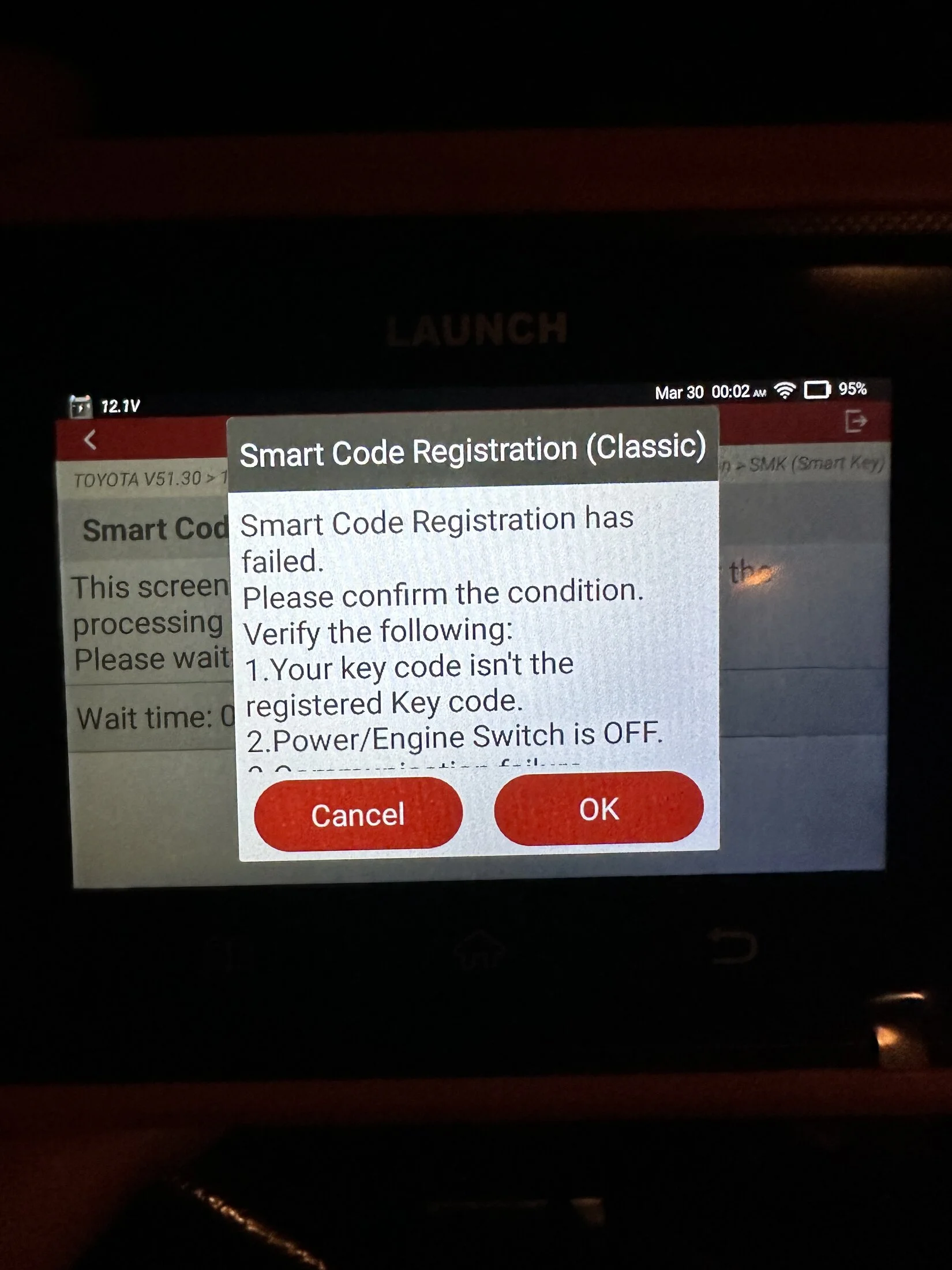

I am failing on the last step of the key fob registration:
Recognized existing key, move to next step
Recognized new key, move to next step
Per directions, set key (I assume new, tried both) to passenger seat.
Fails at this step every time.
The one thing I can't find to confirm is the "Smart Cancel is Off". No idea if this is a setting in the menus or what. I attempted with IG off, in ACC, and ON... all had same behavior. I even put a fresh battery in the unprogrammed key and I cleared all keys except master (I am not the original owner and 3 keys were registered).
This is on an '08 by the way.
Any ideas folks?

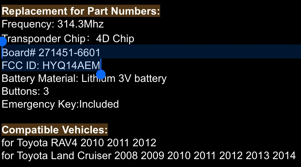

I had the wrong key fob. Got the right one for my truck from the dealer, who is 25% off right now, for ~150 and it programmed first try!
Following up on this for others… if you buy an eBay fob like I did, make sure you get the codes from the original fob and the chip inside. The seller I bought from actually double checked I was buying the right one luckily.
Edit to show example. FCC-ID and Board # are important:
