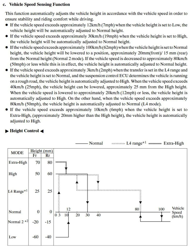

Has anyone used this to adjust AHC without adjusting the sensors? I would like to be able to set my suspension in the factory high mode and keep it there regardless of speed when driving on trails. Similarly, if I need to park in a garage with low ceiling height, I want to set the suspension to Low and keep it there regardless of speed.
I have used the height offset utility to adjust my AHC, and you can use to to adjust your baseline height as an alternative to (or fine tuning) of the actual physical sensors, but I don't think there is any way to program it to stay in high or low. Once you're moving at speed, the truck will always adjust back to N.
Some more info here:
EDIT: I just re-read this whole thing myself. Does anyone know how to enter "Extra-High" mode? Either by the ECU or manually?
Thanks for confirming. I was hoping for something like the XLifter for the Land Rover LR3/LR4. XLifter | Self-levelling Air Suspension Controller for Land Rovers Discovery and Range Rovers - https://www.xlifter.com/
Would ride like crap in high anyway, you'll be happier with a minor sensor lift, or for the best ride quality, sensor lift combined with "AHC Long Travel" <--search it if you have not already read the thread. :) For those parking garages, just keep it under 7mph. Annoying, but simple enough.
