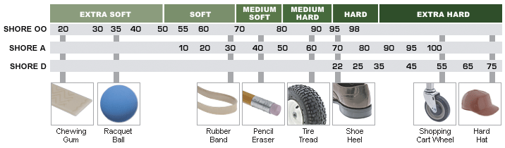

I plan on filling in the void in the back with Shore A 30 urethane to keep the mount from totally collapsing. Here's a pic of what one guy did.
Interesting, Is that the acceptable thing to do, in the diesel world. I can see where the stock one would collapse with the vibrations of a diesel.
Just out of curiosity, Have you ever heard of using window urethane? How much does the Shore A cost?
This is what i love about this website, so many people for such a diverse background. You learn a TON just by watching.
I have heard of people using that, but the stuff I bought looks to be easier to pour and the hardness is specified. I don't know what the hardness specs are on the window stuff.
I paid under $25 for the kit to do my two mounts.
