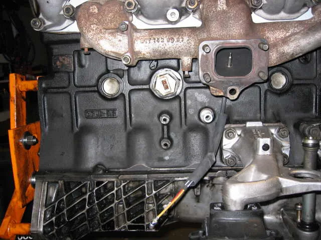

Just found a nice write up with pics.
http://www.superturbodiesel.com/std/Thread-Re-EGT-sensor-install

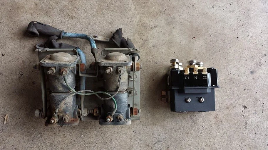

Some update on the winch. I soaked the rusty clutch bits in a plastic bowl filled with Evaporust and they came out looking rust free. I was really surprised by how well it worked. Anyway, I buttoned up the winch and filled it with oil and am now working on converting the old solenoid pack to an Albright type contactor (rated at 500A).

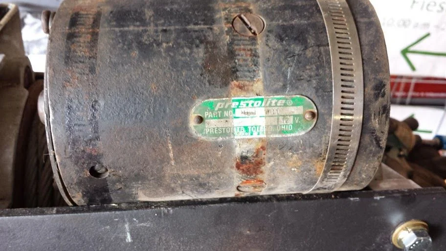

Check out the original Prestolite motor:
The new contactor next to the solenoid pack.

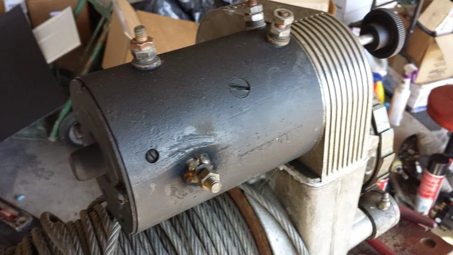

I also welded a dedicated ground stud onto the motor body. The early motors grounded to one of the two long screws that hold the motor to the winch. This will provide a better ground path since I'll be running a ground cable back to the battery.

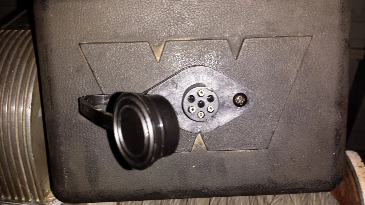

I also replaced the stock ancient 4 pin Warn socket (originally designed as a trailer light socket). On a tip from my buddy @ginericLC, I bought a Superwinch 30' wired winch remote that came with a socket. Got it on Amazon for significantly less than a Warn. The cool thing was that the plug had all the correct wires/connections for the new contactor (SuperWinch sells their own).

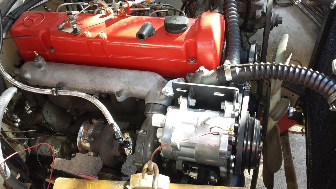

This beautiful weather we're having has got me motivated. I finished with the AC bracket and mounted the compressor. Things are really tight, but I think I can make it work.
