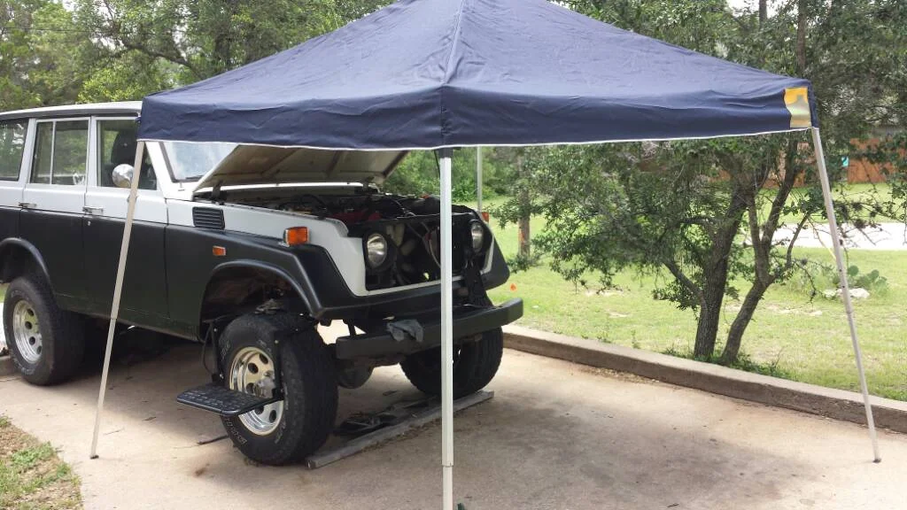

I pulled out the pop-up canopy and got some work done.

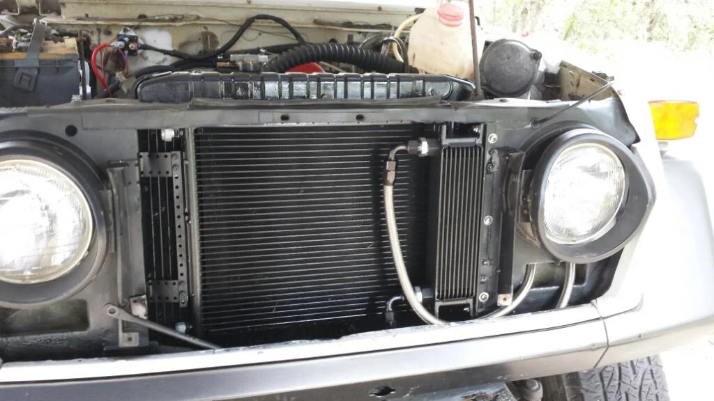

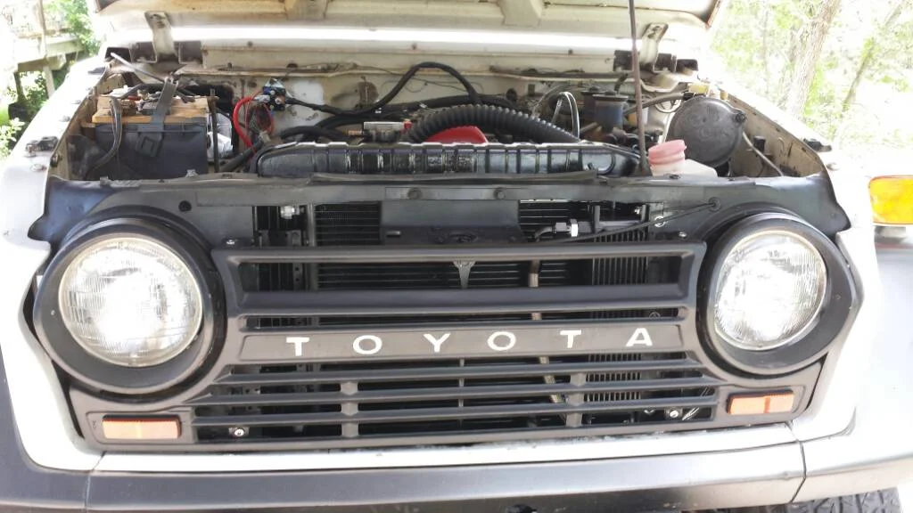

Here's the smaller condenser installed. Now I have room to tighten the hose fittings. I did end up making some holes in the radiator support bracket.
David,
Turned out nice. I've the same problem with the condenser lines, have to tighten them up, then bolt it in. Good Job!
I like the tire step, I use one on my Deuce.

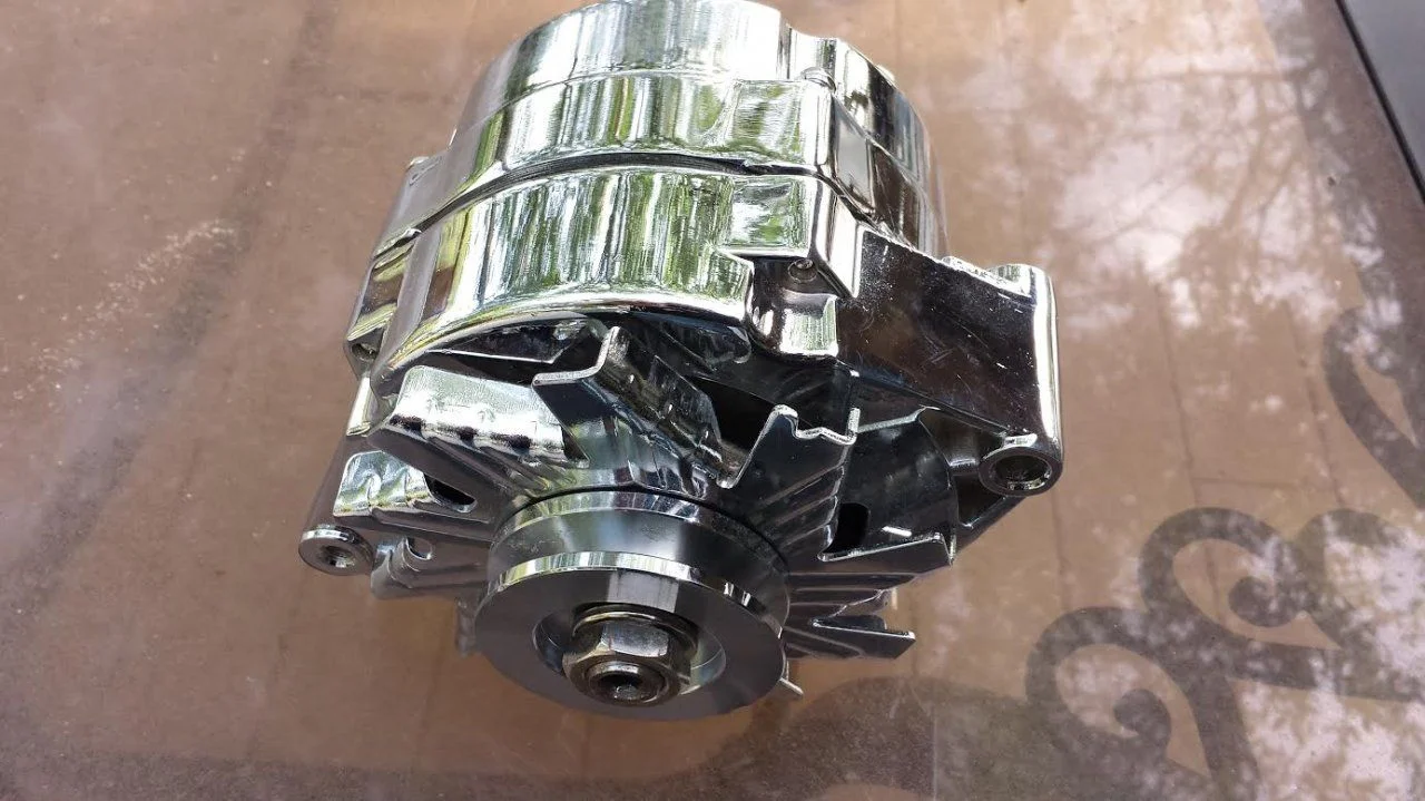

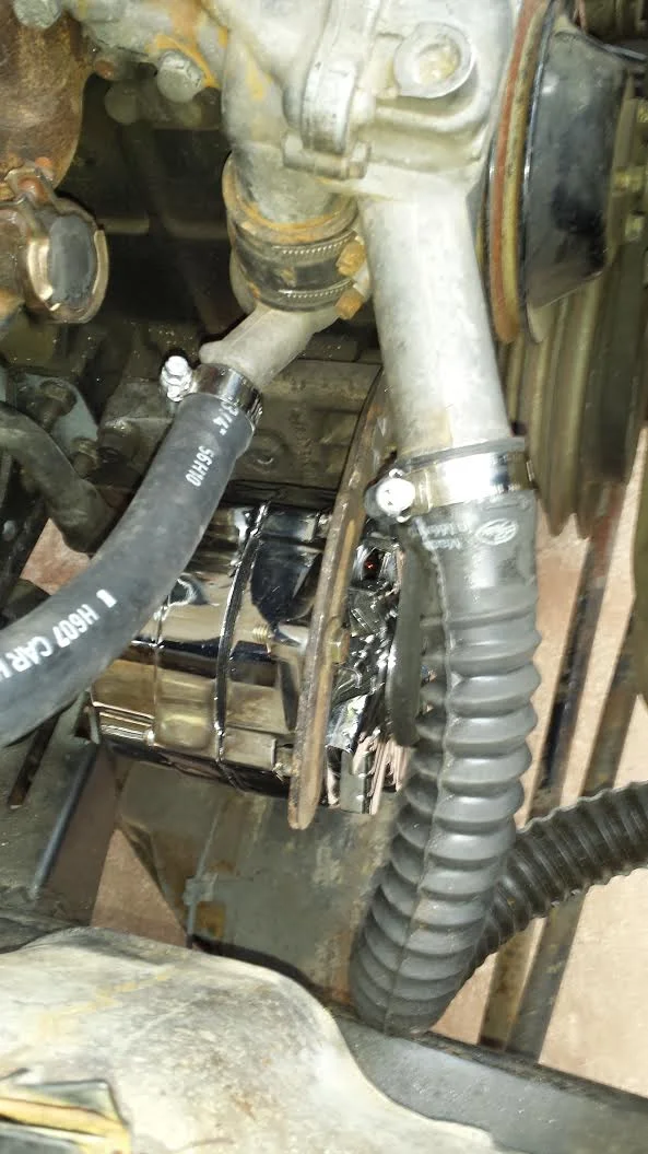

On a different note, I bought a chrome (more bling) 10SI alternator off of the MUD classifieds for $40 shipped. I got it to work with the stock alt bracket and a 2F alternator adjuster bracket. These GM style alternators offer high amps and easy wiring.
Thanks. I really should paint the 2F bracket. All the rust makes the chrome look bad :)

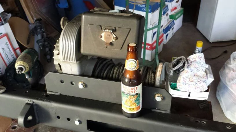

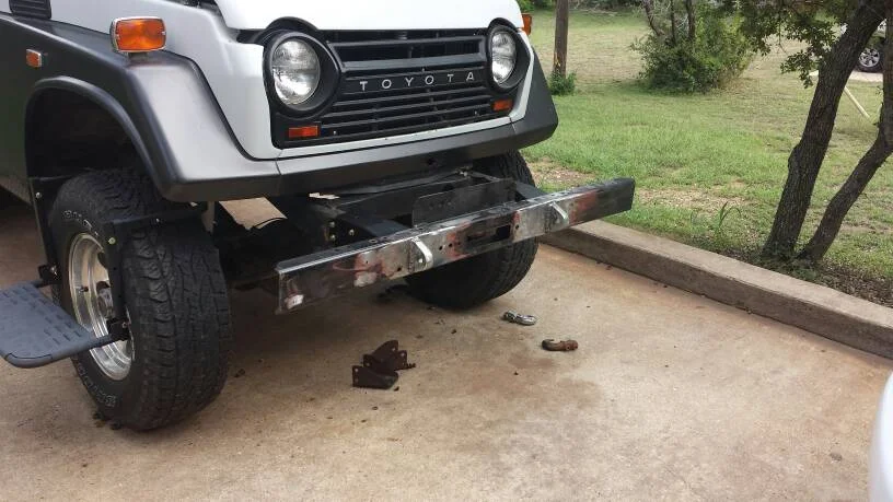

Since the weather is getting cooler down here in Texas, I got some work done. Here are some pics of a $25 winch bumper I picked up. I cleaned it up and welded up some extraction points. I also mounted an old 8274 winch.
