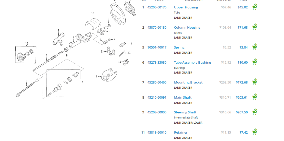

Sorry, I figured I didn't explain the swap well. On the vgrs lx, the vgrs unit incorporates the rag joint on top and attacheds to the bottom of the main shaft. The splined end of the vgrs unit sticks out of the engine side of the firewall. That attaches to the intermediate shaft that turns the steering box. On the non-vgrs trucks the piece (stub shaft) that connects the rag joint to the intermediate shaft is shorter, doesn't stick out of the firewall as much as the vgrs so the intermediate shaft has to be longer. In the LC part diagram I posted, in box #9, you can see the short shaft that the vgrs trucks don't have. I guess when they added vgrs it was cheaper to create a second intermediate shaft than design the vgrs the same length as the LC shaft.

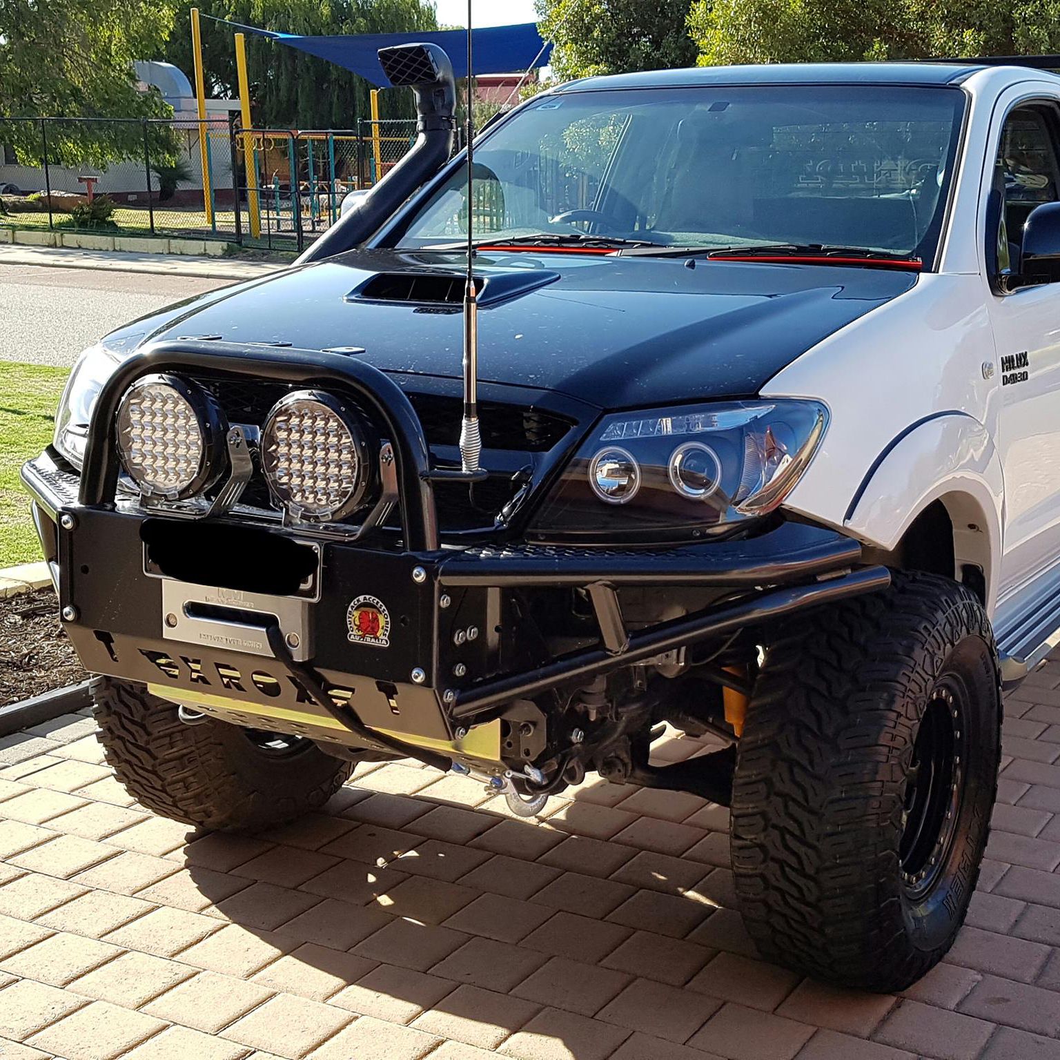

Today probably screwing around with a front bumper setup or maybe skid plate stuff. Only have a few hours so we will see what I can get done.
I'm guessing 2020 is the real wheeling season for this pile. Marshmallow has some issues I need to take care of too... I keep tearing up AT coolers... I think my core support is all wiggley
That’s gonna look amazing. Mad skills.
Thanks but I honestly doubt it will look correct. I'm sort of struggling to figure out how to keep the overall result low profile. Usually I can't visualize it right and it ends up being functional but kinda lame looking.
Looks like you’re on the right track
A little adjustment here and there and should work out just fine.
