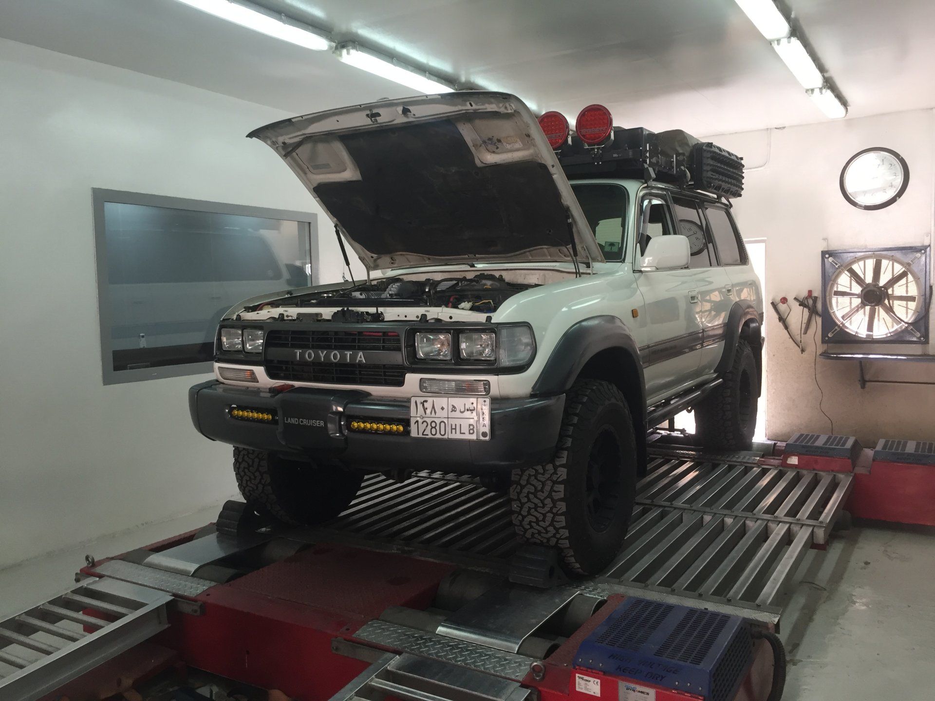

Hi just installed the Haltech Elite 2000 on my 1996 fzj 80 Magnuson supercharged cruiser.
So during the tune on the Dyno today was told the wasn’t enough fuel reaching. He showed me on the graph saying it could be one of two things. Either the fuel pump or regulator need replacing or the injectors need upgrading.
So I ordered new factory fuel pump and regulator and filter with the thinking that these are probably as old as the truck and maybe time for a new set. Hopefully that gets installed on Saturday and back to the tuner on Sunday to carry on with the tune to finish the job.
I have read on here that there is no need for a bigger fuel pump and so have opted to go with the factory pump. Let’s see.
Another thing I found out that now the second fuel tank switch light is always on and that is driving me mad. Has anyone faced the same thing and how did you fix it.
And one last thing about today’s episode is we managed to get 195 go on the wheel which are 35s.
Any help would be appreciated.

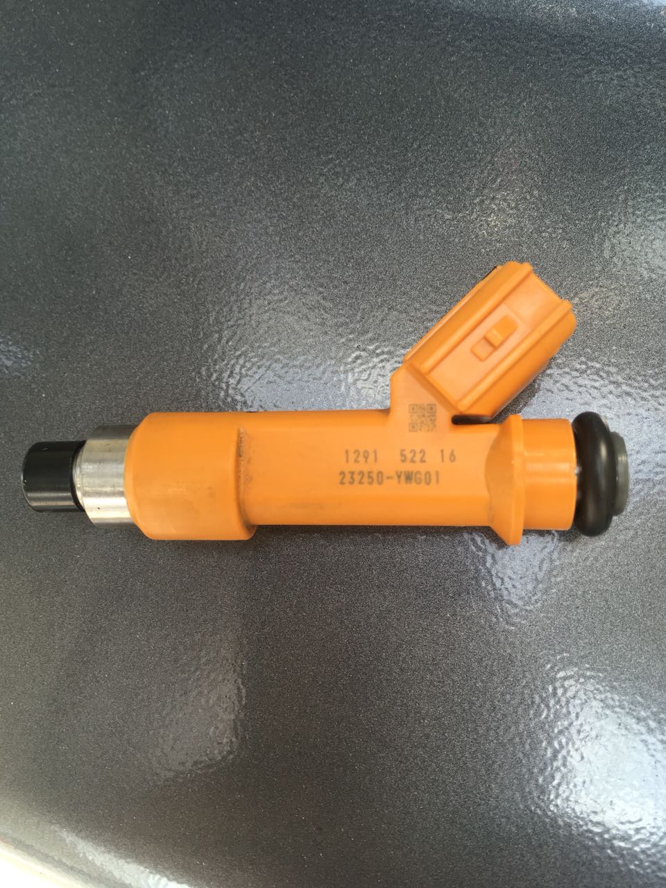

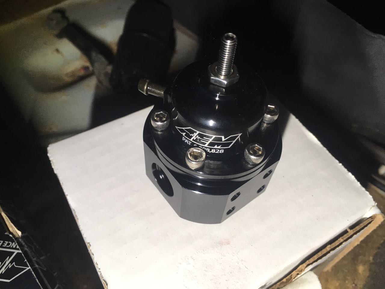

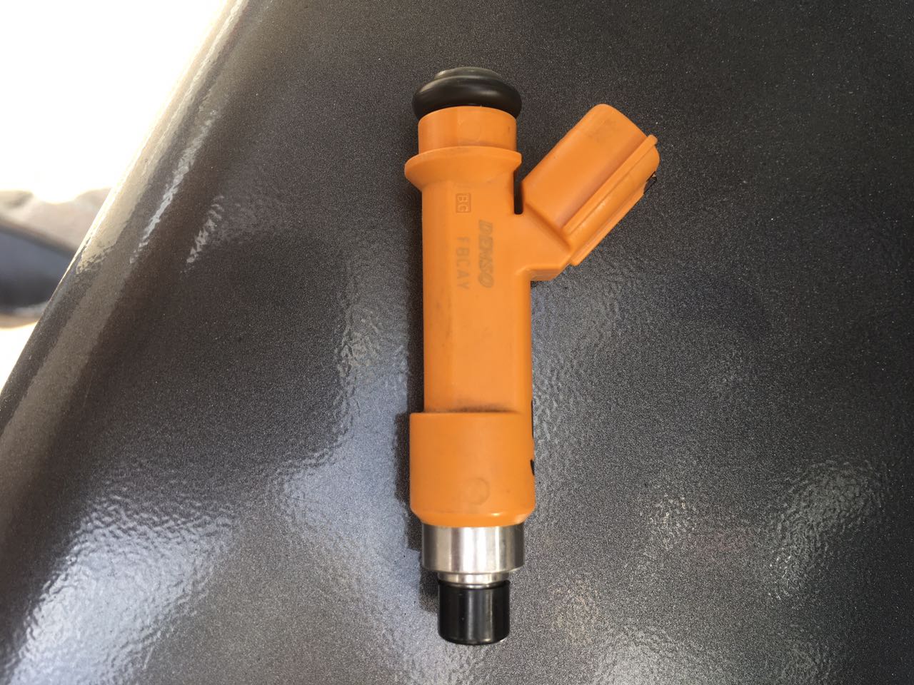

Ok, So these are the parts going into the truck.

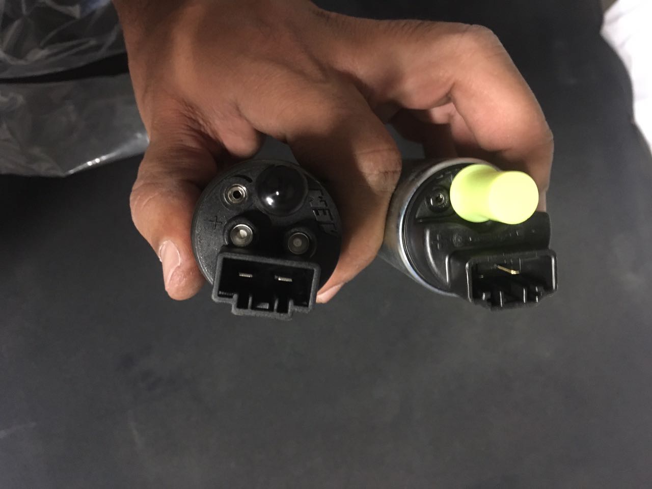

AEM Fuel Pump P/N 50-1000
AEM Fuel Regulator P/N 25-302BK
Factory Fuel Filter
Denso Injectors P/N 23250-YWG01 450cc ( they are used and reconditioned so as good as new, it turns out they came from a TRD Supercharged FJ Cruiser according to the PO they will need a spacer)
The AEM pump is exactly the same size and configuration as the factory pump
