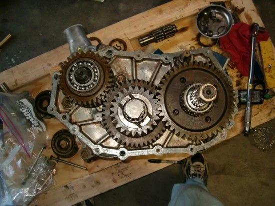

I am unfamiliar with what exactly the idler shaft / counter shaft is? same thing, correct? if one were to measure it, where would it be located and how would one measure it exactly? any pics would be helpful. Thanks for everyone's responses. I need to make sure this thing is the one I need.

Counter shaft protrudes out the rear of the split transfer case, right in the middle of it.
Put a caliper on it to measure...
If this is still foggy, I will post up pics Wed...

Here is a teaser pic. The idler shaft is the shaft in the middle. It sticks through the back of the case, and so can be measured with no disassembly.
Poser-I posted a bunch of pics and progress reports in the 60's section, but never put together a full report. I have always meant to do that, since I kept the pictures. I'm also confident now that I did it all correctly, as I have almost 15k miles on the set up and it's still all good. The hardest part of the job was getting the output preload in spec, and I had to install and disassemble the output bearing housing 4 times. What suprised me most about the gears, is that despite their 110k miles (on the doner) the gears themselves looked brand new. More proof that Toyota builds good stuff.
