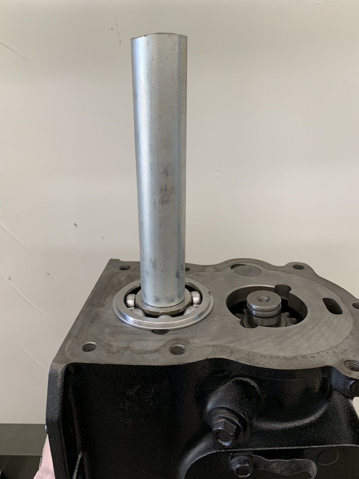

Ok, so the pipe worked great. Got the bearing pressed into the case. Pressed just far enough that everything is touching. I was worried about pushing too hard.

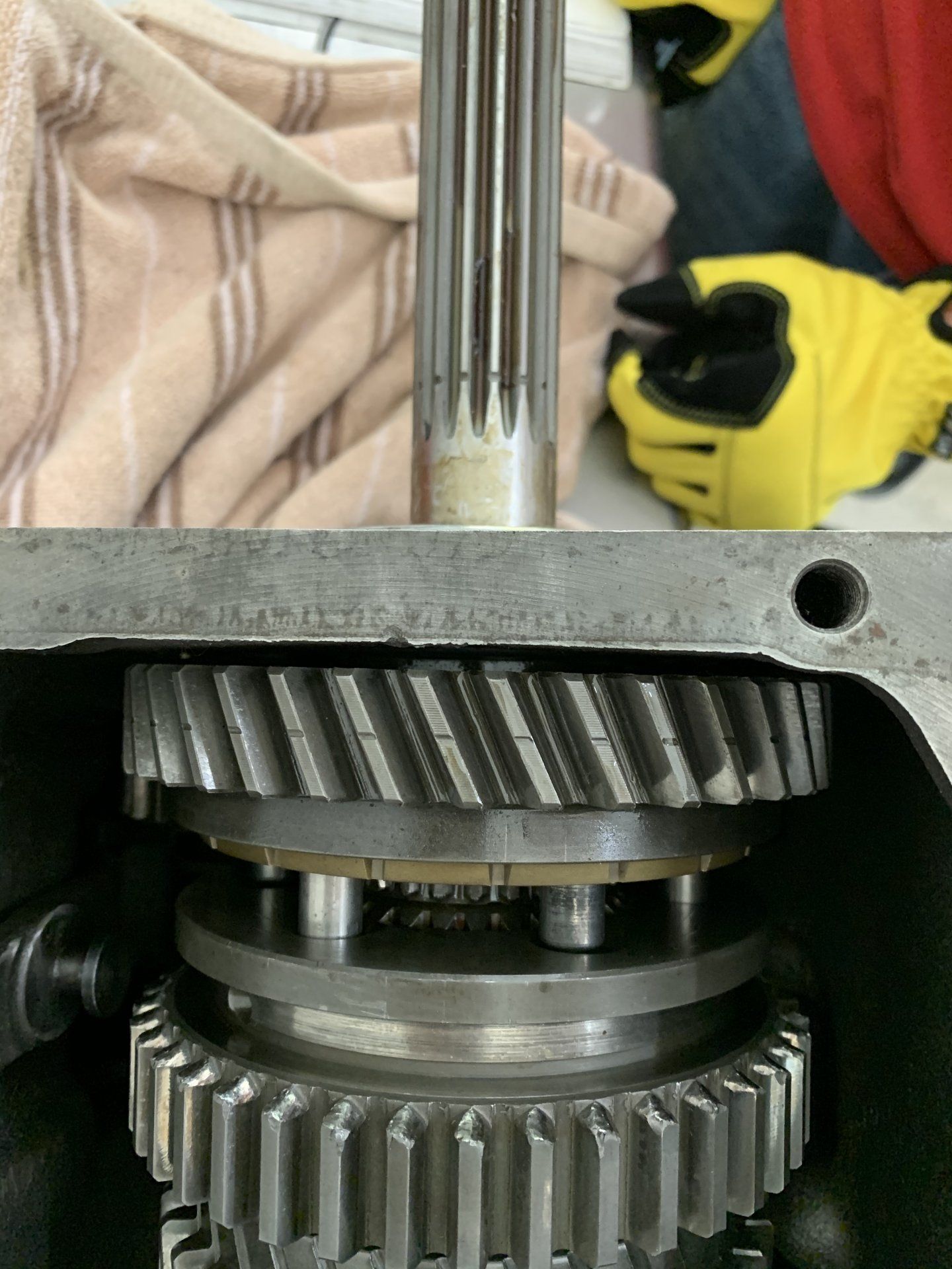

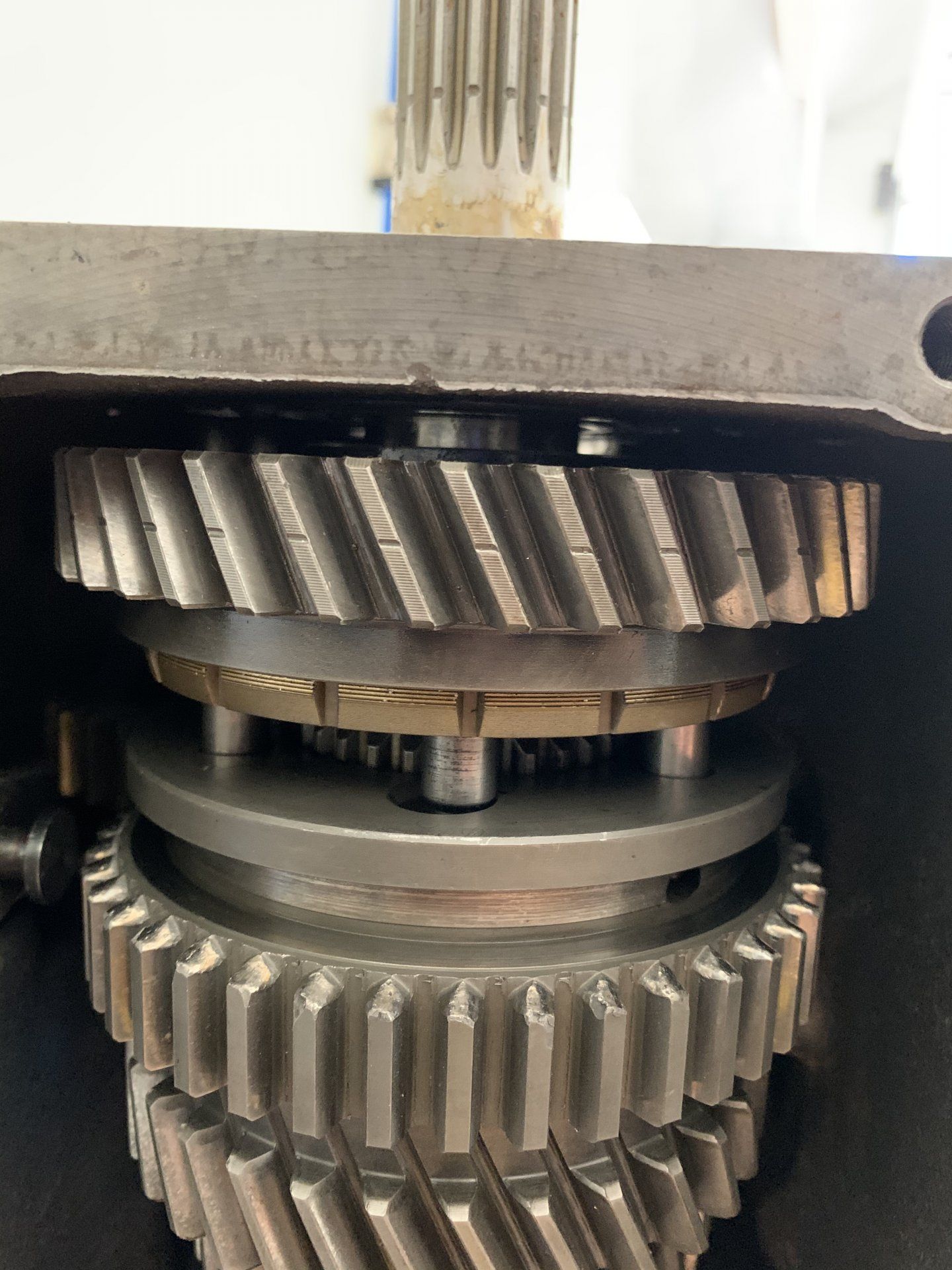

So now I have to finish pressing the shaft into the bearing, doing what I started yesterday. Here is the gap I have remaining.
Myproblem now that I am worried (as I have been all along) is that when I flip it over to press it, the spacer thrust washer will fall off the pin and become misaligned and no room now to grease. I think I’ll press the shaft out until there is enough room...
Nicely done. Is first gear binding? Go back and look at the pic of mine before disassemble, Post #44 I think. That might help.
Ah, now I see. You still need to finish. Yeah, this side is trouble isn't it.
What about a thin piece of card (cereal box) cut to slide in and duct tape to hold until you get it pressed in enough to remove?
Or just multiple card board wedged in and pulled out as you go?
Good idea on the cardboard! I don’t think I have far to go before it will stay in on its own. I’ll try that this afternoon when my son gets back.
Ok we actually just tried it. Cardboard trick worked great. I think I’m where I need to be. I didn’t know how far to press...it’s hard to feel when it starts hitting resistance and I was worried about going too hard. I’m hoping when I do the input shaft side, that it will press the tiny bit more if needed.
That looks really good. Great job. Compare well with the pic I had.

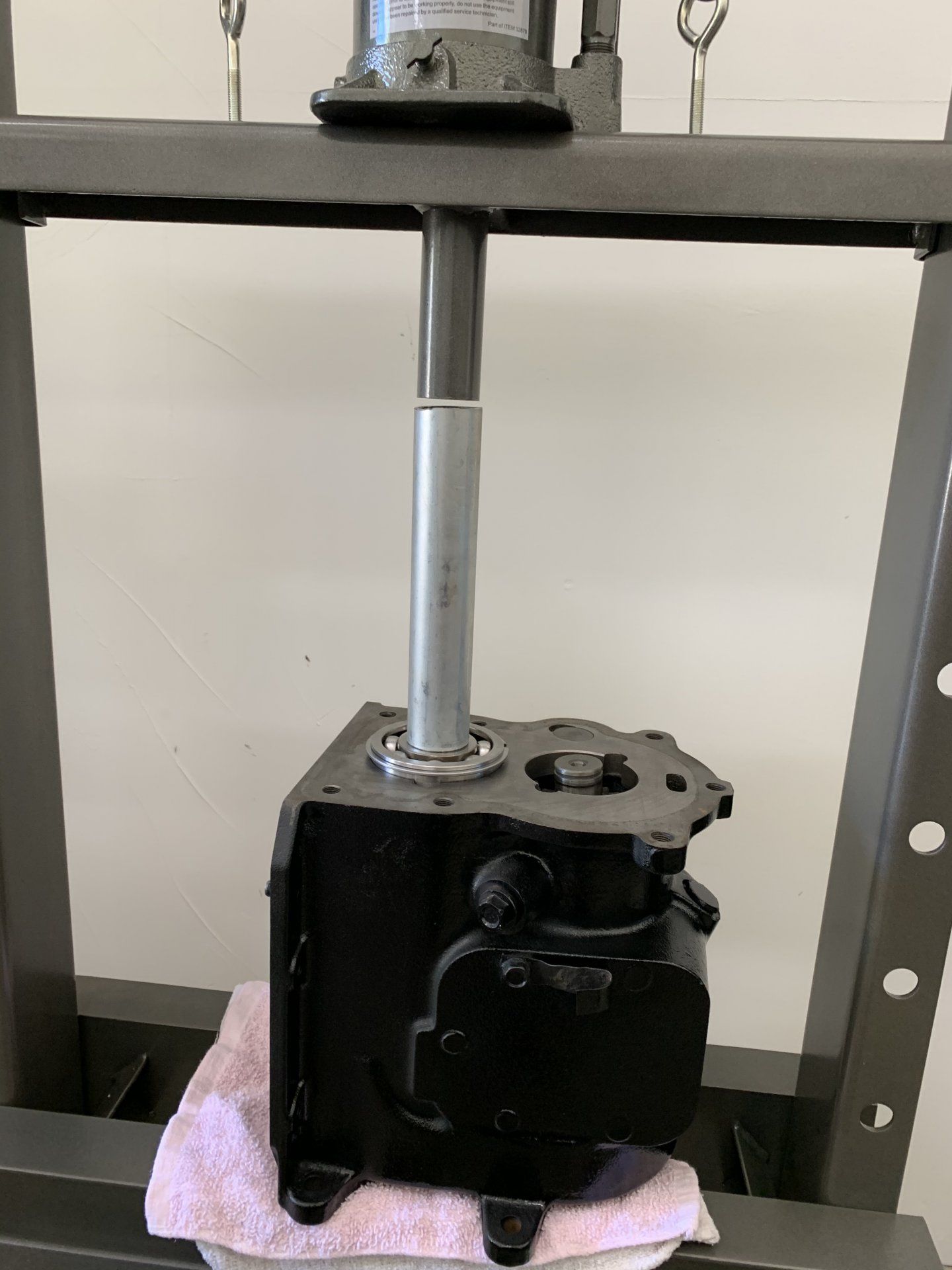

I also put in a pic of the press with the SWAG plates. Man those suckers are heavy. I can only handle one at a time. Actually, all of it's heavy... I'm doing this all by myself after church today. Three or four trips back and forth to the press and I've had my workout for the week. And no pinched fingers, yeah!

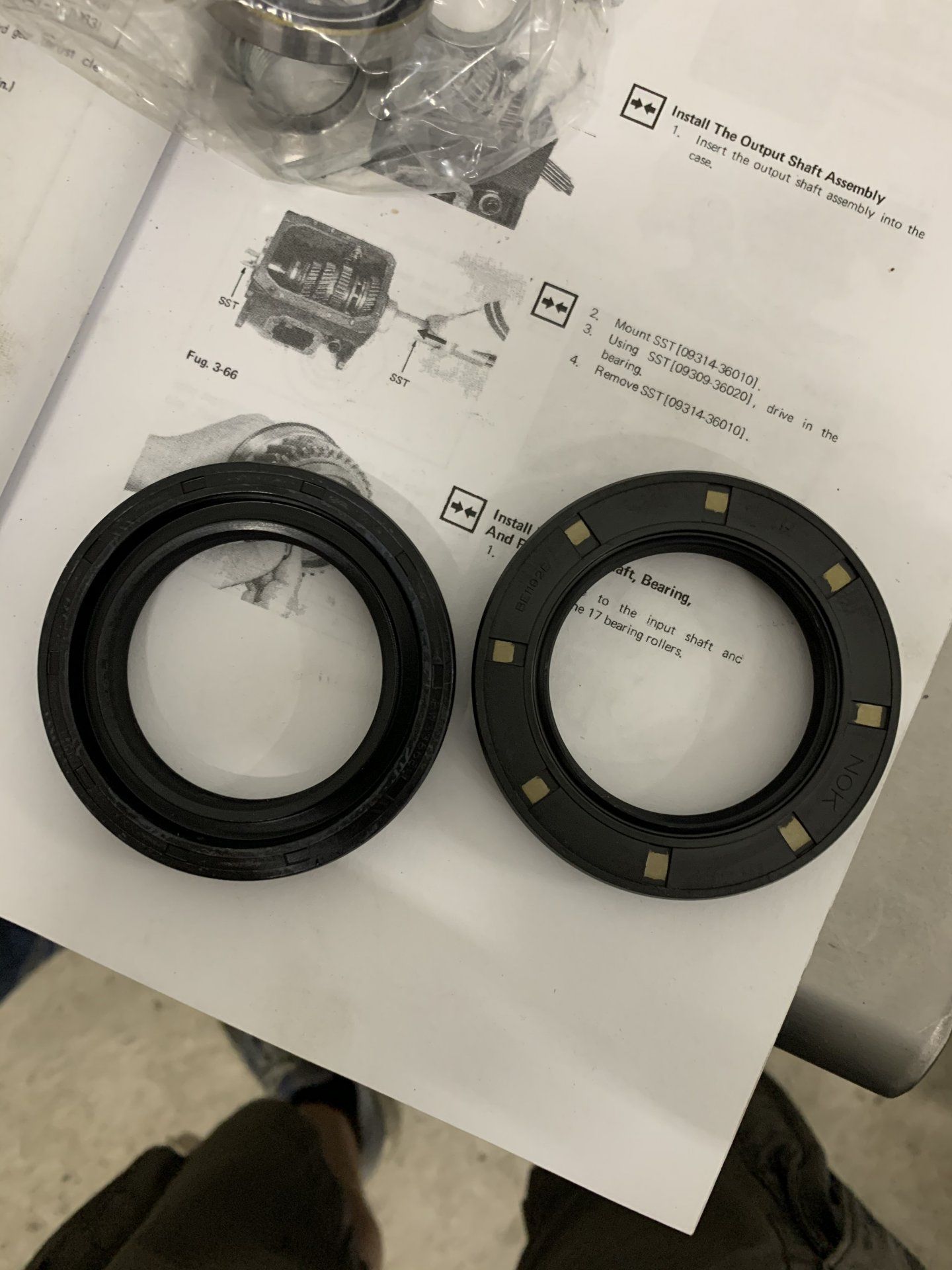

Also, my rebuild kit has these seals. Maybe dumb question...but I can’t figure out what they are for?
Mine did too - I believe they're transfer case seals for the output shaft.
