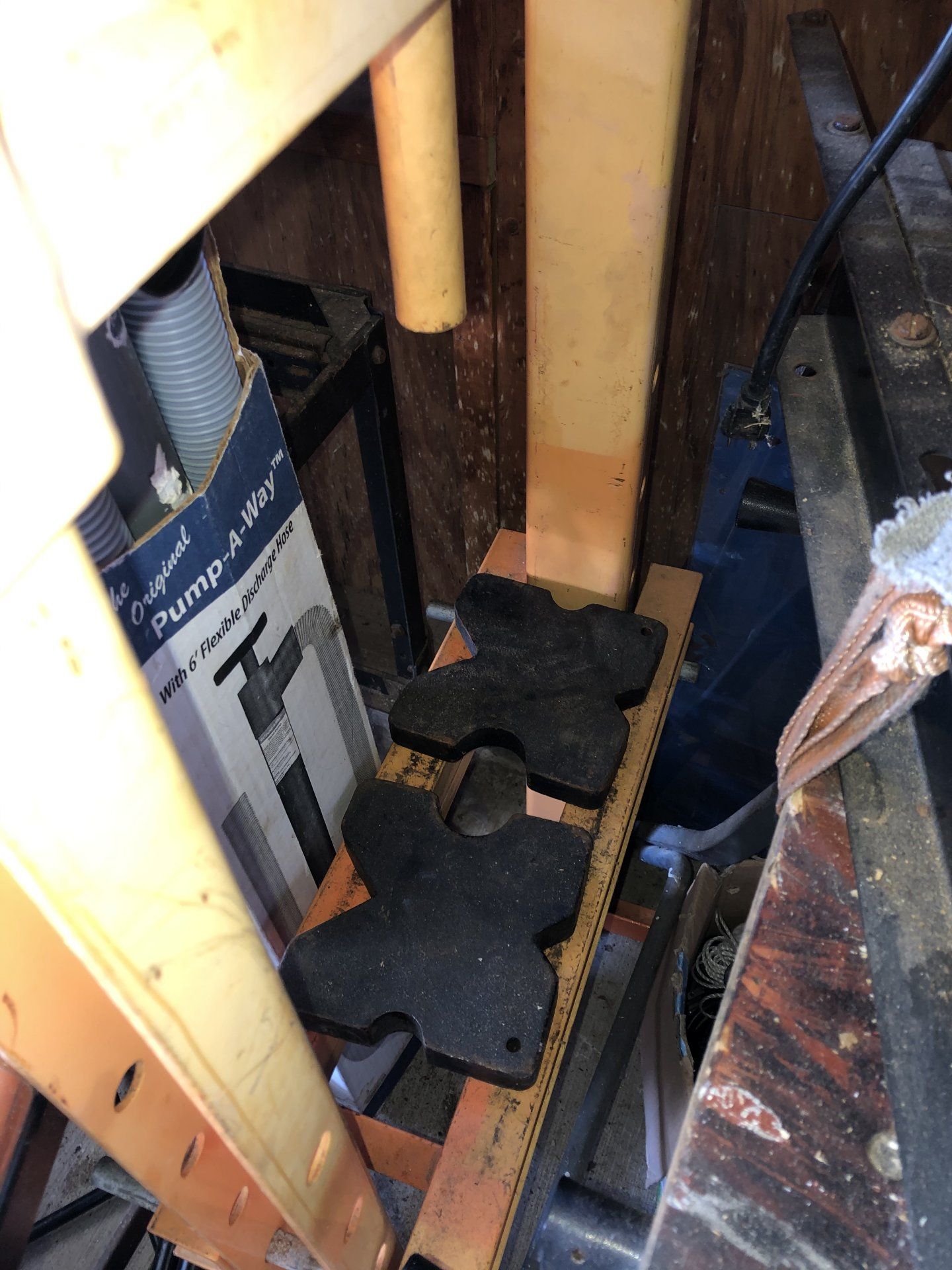

Thanks for the help guys. Do you have any pics or know of any videos that show how to use the press when dealing with the whole transmission case, shafts, and all the gears? I've been searching youtube, but haven't been able to find anything really. Would like to understand how I am supposed to do it before I go out and purchase. Just having a hard time envisioning it. All the videos just show installing bearings outside of a housing...how is it used to press the bearing into the housing?
It’s a bit of trial & error setting the height correctly to compensate for the reach for the ram. The input shaft end is facing downward. I can’t remember orientation of the press plates to support the input side/weight of the transmission. Maybe others can chime in.
Well, I am trying to drive the output shaft bearing onto the shaft, and into the housing at the same time. Thats probably one thing I'll need to change. I did it that way because I saw other rebuild threads do that (when we don't have a press or SST).
The counter shaft will need to be in there before you press it on too. While pressing the output bearing, I had the thickness gauge in place (1st & sleeve) to make sure I didn’t over do it.
I didn’t have the SST’s for the install. I found other things to substitute.
Thanks. I do have the counter shaft in.
So as I said, I have been driving the bearing into the housing and onto the output shaft at the same time. When I get a press, how does this work? Seems like I would still have to do it that way?

Now that I’m thinking about it some more. Each of the press plates will have a semicircle cut on one of the sides. Use both of them with the semicircular sections of the press plates providing clearance for the output shaft while supporting the bearing. The ram at the top of the press should be long enough to reach the input side of the stack through the transmission case.
I’ll take some pictures of my shop press with the press plates and upload it later today.
Thanks a bunch. I think that makes sense. Pictures would help a ton if you don’t mind.

Ok cool. So place the whole case, output shaft going down through the circular gap in those plates, but the bearing resting on the plates. Then drive the ram down to the input side?
That’s what I was thinking. The FSM has the input next in the reassembly sequence. So, be aware of what bits will need to be in place for steps later in the sequence.
