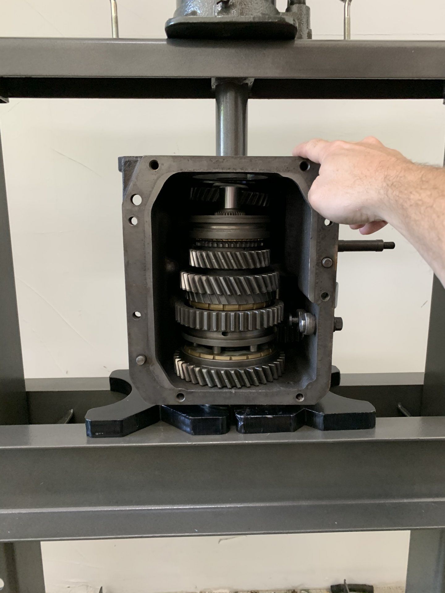

I'll try to "fake" a pic on my 20-ton tonight if I can. I'm still cleaning my case so its not as pretty as yours yet, but everything's installed and just about ready to go together.

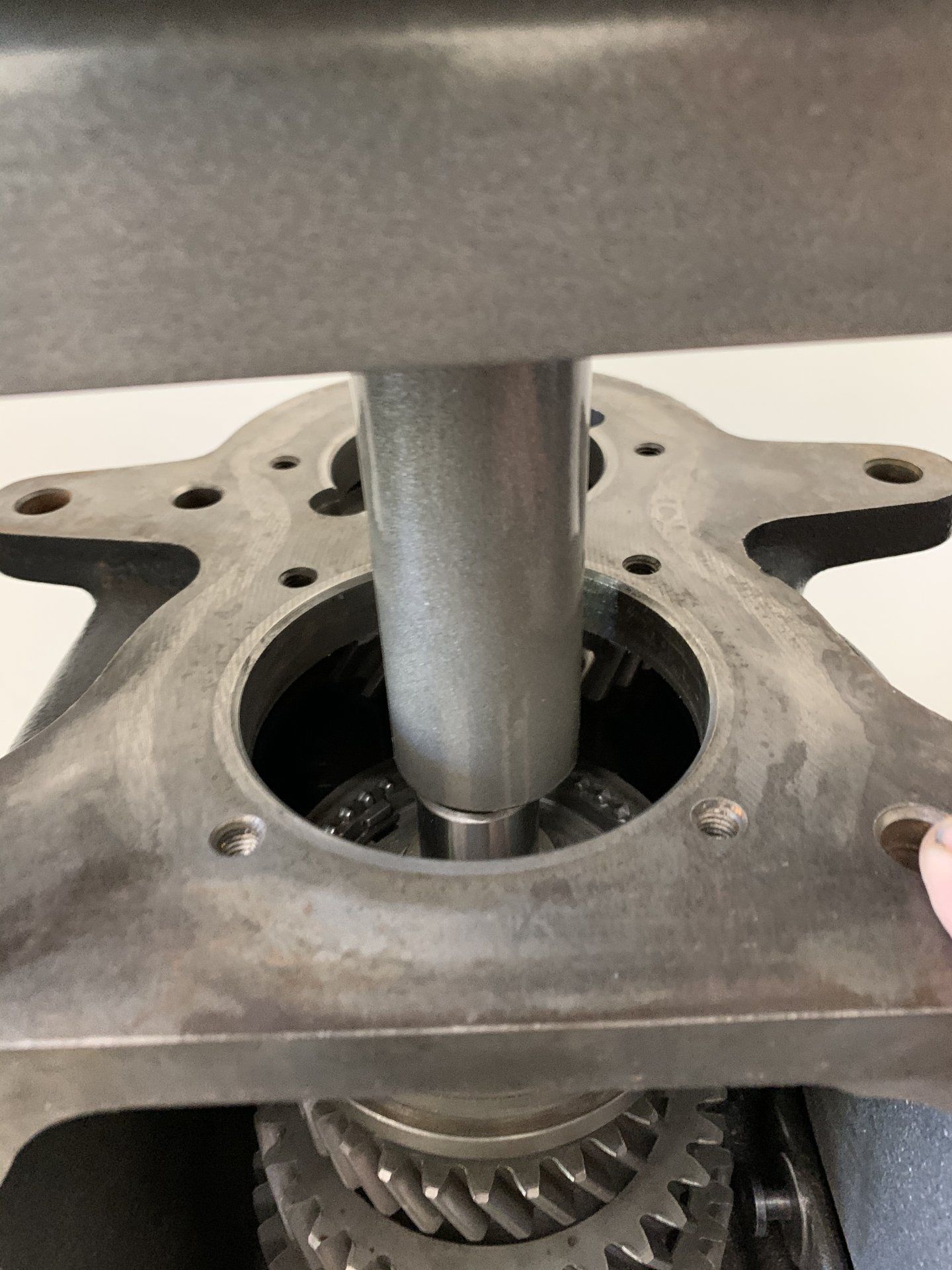

Ok. Got my press set up. Here are a few pictures of what I think I need to do. Note I’ve already partially driven the bearing in with a hammer
That setup is to drive the output shaft into the bearing. I slightly pressed and it worked, first gear started butting up against the case, which made me realize I probably need to finish pressing the bearing into the case first.
Any ideas on how to do this? I need a way to keep the case as it is, but drive the ram into the case, rather than into the shaft, as in my picture above.
I’m also worried that once I start this, first gear will start moving away from the case and that stupid thrust washer that is the bane of my existence will fall off of the pin and get screwed up.
What do you guys think? @rflegal have you had a chance to try yet?
Thanks yeah I thought of that. Would need to go get another one (I don’t have anything here at the moment that would work), but I think that is best...needs to be something strong enough to hold the pressure.

No mention of thickness gauge in the tm. If the output is secure in the inner race, you would flip the case, press the bearing in with a pipe over the shaft to the c-ring. That's why it's there - positive stop. Then flip again and press remaining of the output.
