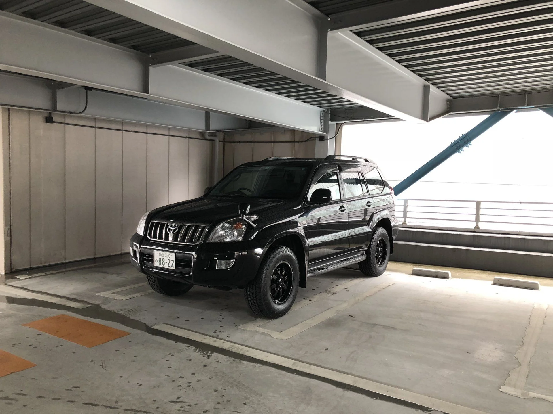

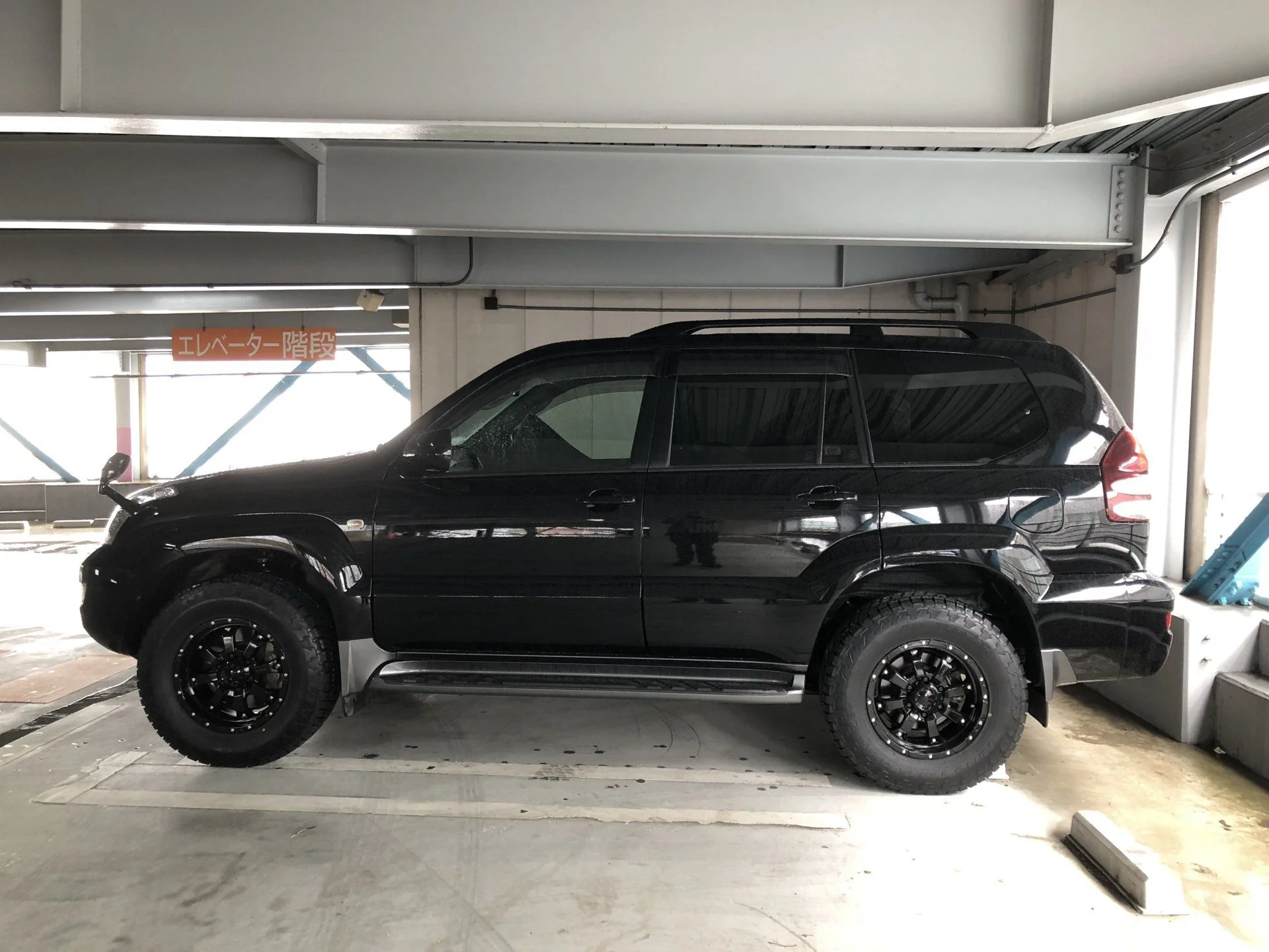

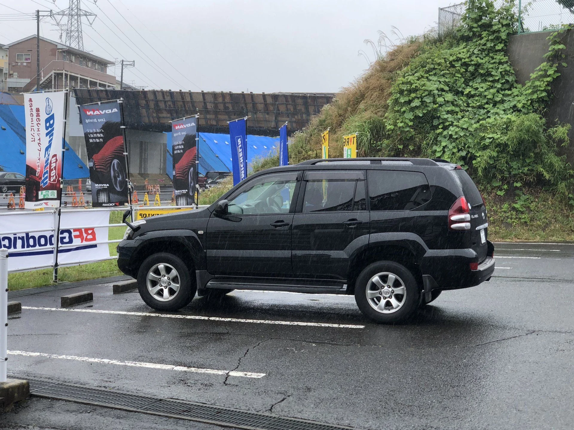

Just picked up my new to me Prado! Took it straight to the shop to have my new wheels/tires installed. And the immediately parked it to catch a bullet train to Tokyo for a gig...
Lift and custom audio to come very soon.
2008 Toyota Prado 42,000kilos (1 owner whom took super good care of it) Still has the plastic on the floor board area and dash!?

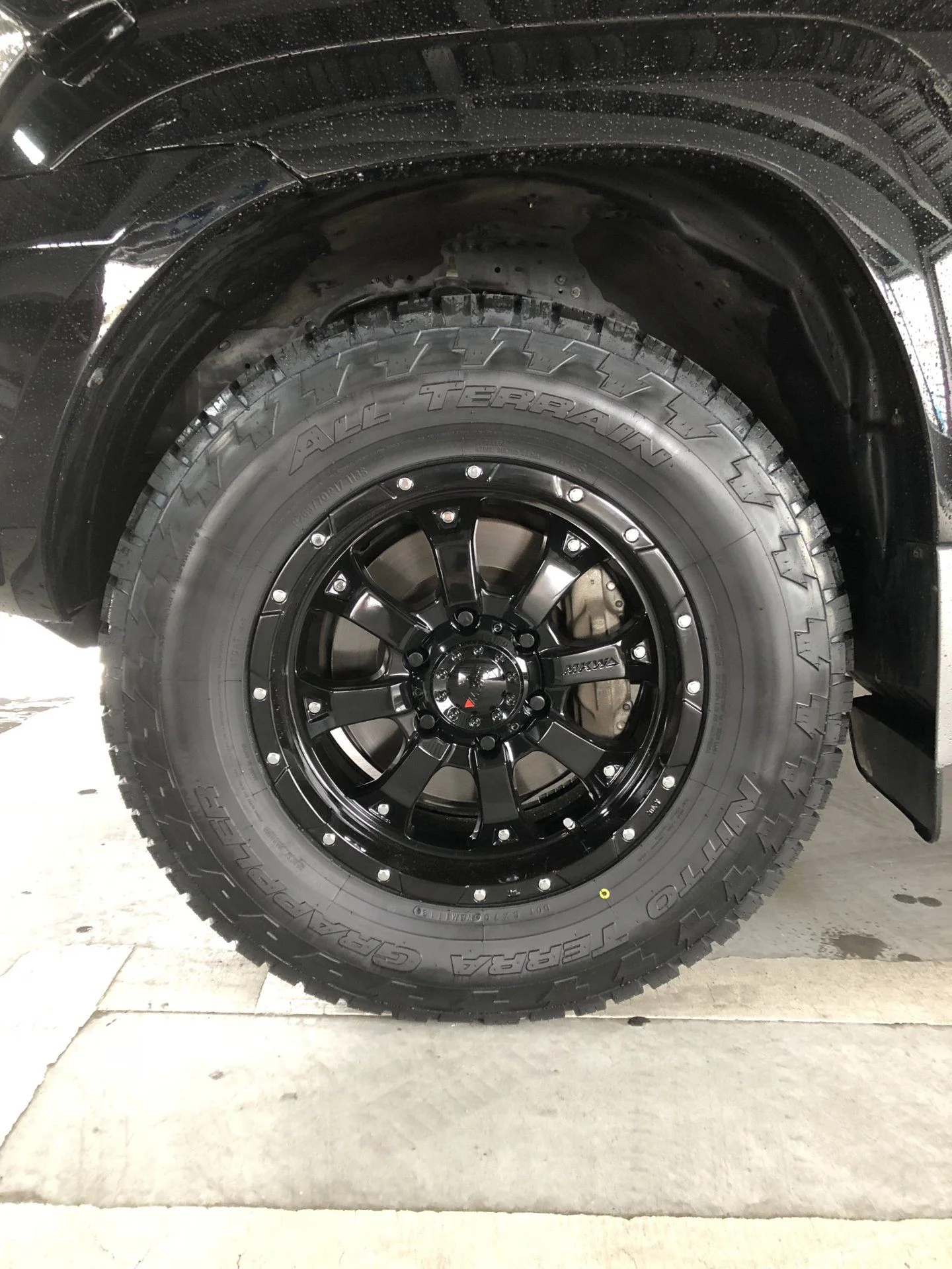

Wheels: MKW MK-46 Gloss Black
Tires: Nitto Terra Grappler 265/70/17
Lift: Coming soon
Cheers

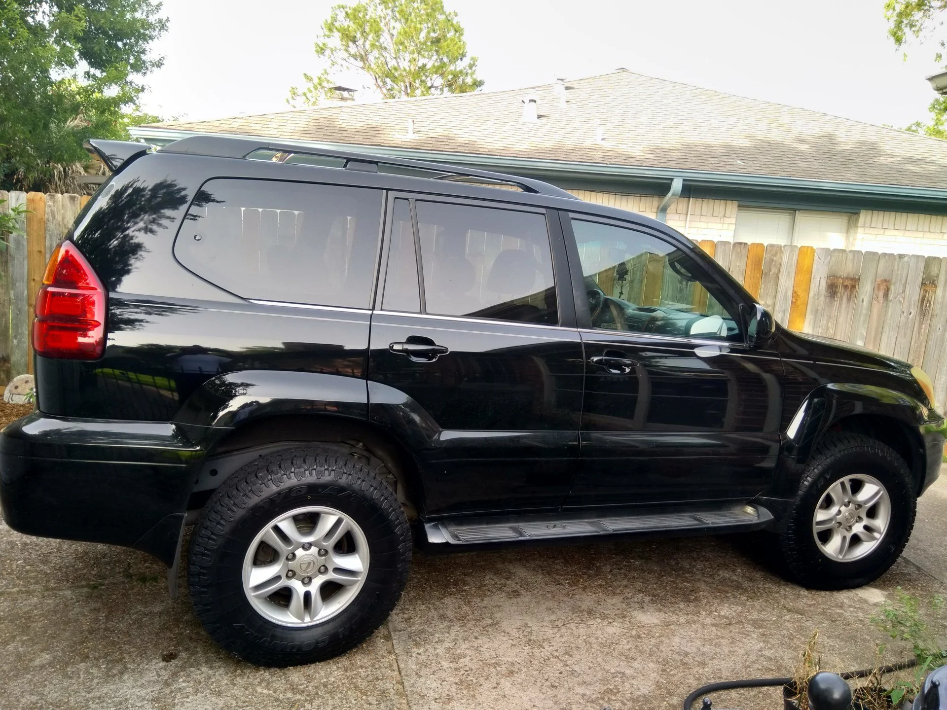

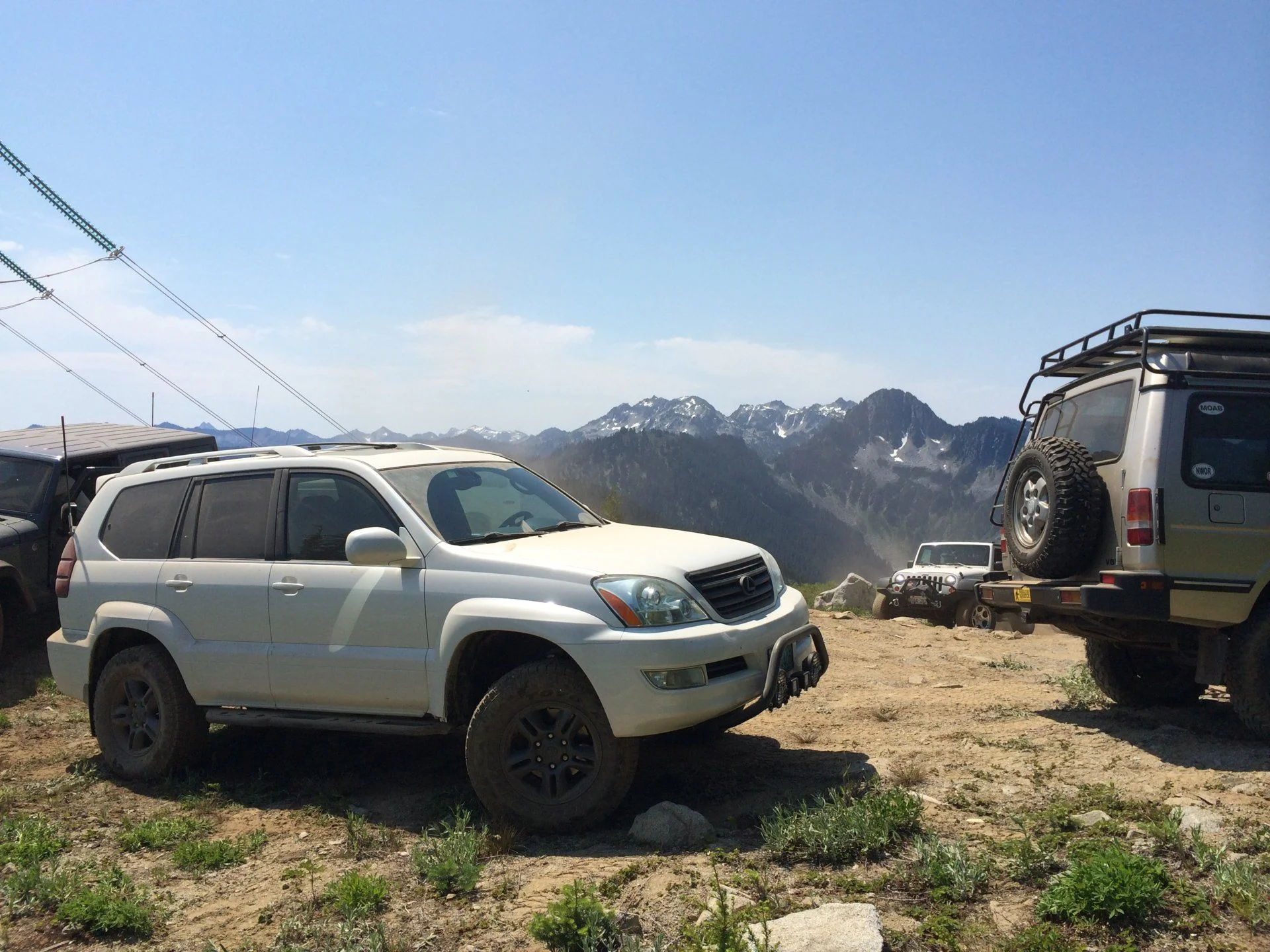

We just got new tires for our GX.
wheels: stock
tires: 255/80/17 Toyo Open Country AT II
spacers: none
Lift: TJM 2.5 lift with JBA upper control arms. lowest perch setting on front springs.
These fill the wheel wells so much better than the previous 265/70/17's . My biggest concern with going to load range E tires was a loss of ride quality. However, i think the extra sidewall retains a complaint ride. While turning, there is some slight rubbing on the plastic piece at the front end of the running board. Some trimming will be needed but running board can still be retained for convenience of my :princess: and kids.

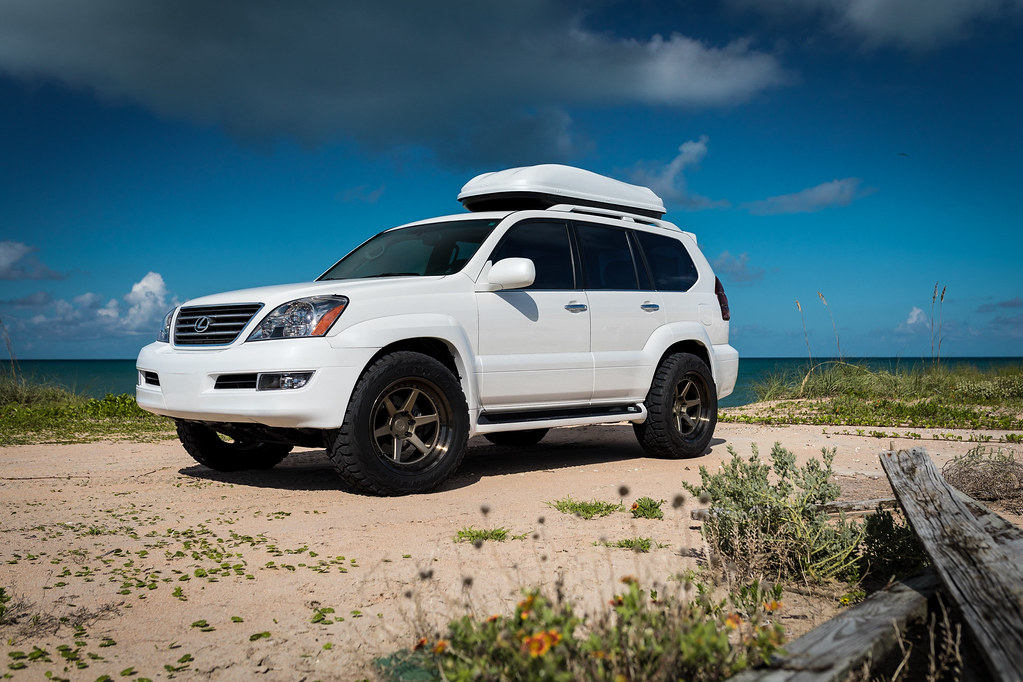

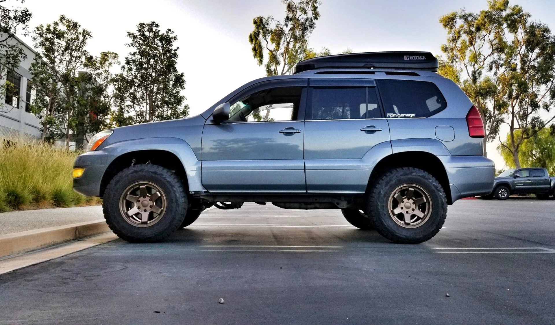

Metal Teck Rock Sliders, Radflo 2.5 Coilovers, Metal Tech Rear coil conversion, TOYO AT2s 265/70/17 on Stock wheels (Dark Grey) and Spider Trax spacers Very light rub when wheel is full lock turning /backup - Considering 285s now :)

Looks great, and thanks for mentioning the ride with the load range E...that's been a concern for me regarding that tire size.

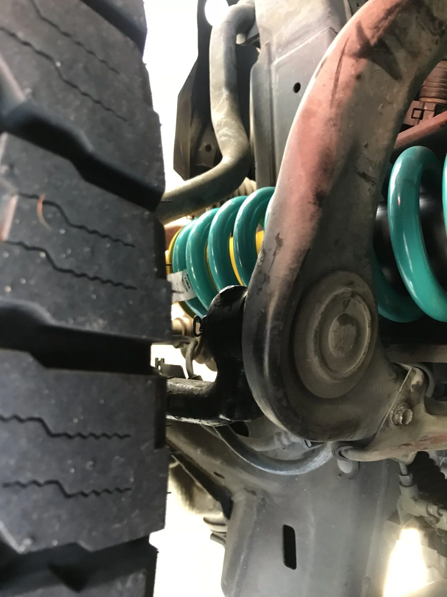

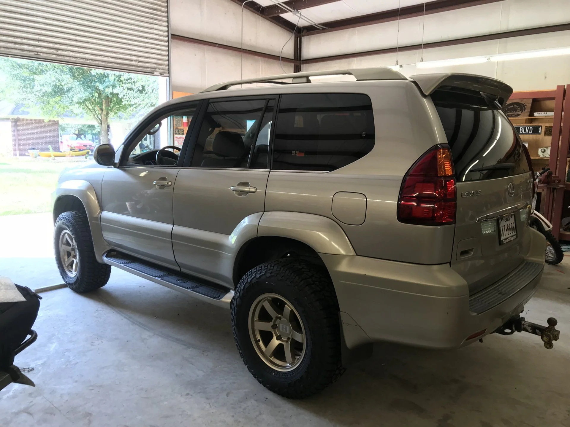

I also have a very small amount of rubbing, but it’s so little I am not going to worry about it.

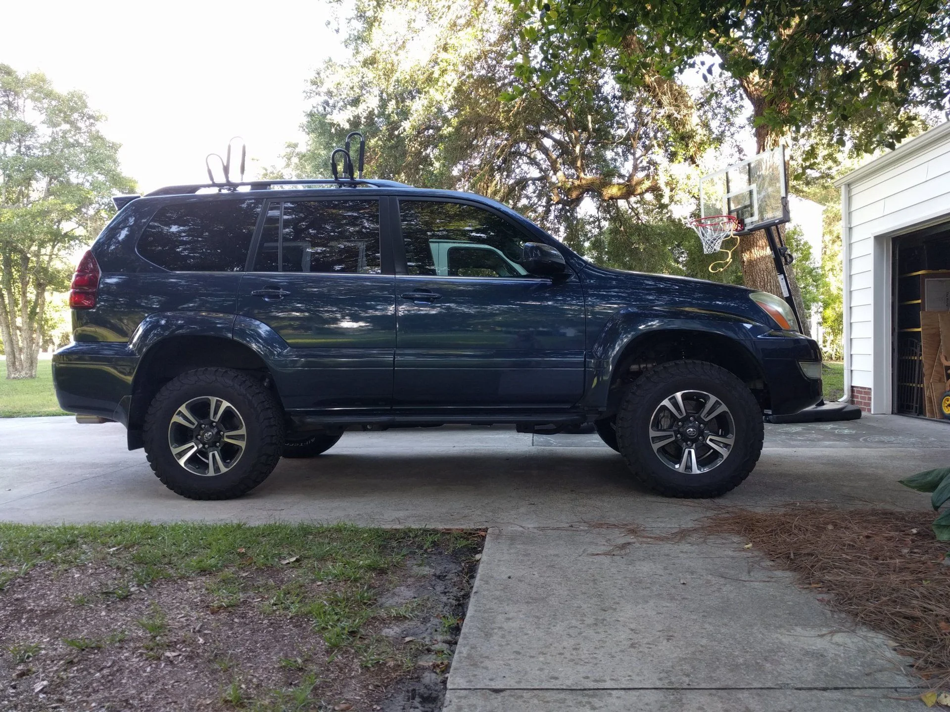

wheels: 2016 Tacoma TRD Sport (Had to grind calipers to fit. Not ideal.)
tires: 265/70-17 BFG K/O2 E-rated
spacers: none
Lift: Dobinsons 302 on Blistien 5100 lowest setting. Airbag trick rear on Blistien 5100
Driven 1500 miles or so. Ride is good accept for the E-rated tires. Definitely feel the weight of the tires braking and accelerating. Front sway bar is making noise now and PS link is leaking. Time for quick disconnects. Might make spacers for rear airbags. Ride is decent, but I think they would relieve stress on the over-inflated bags.

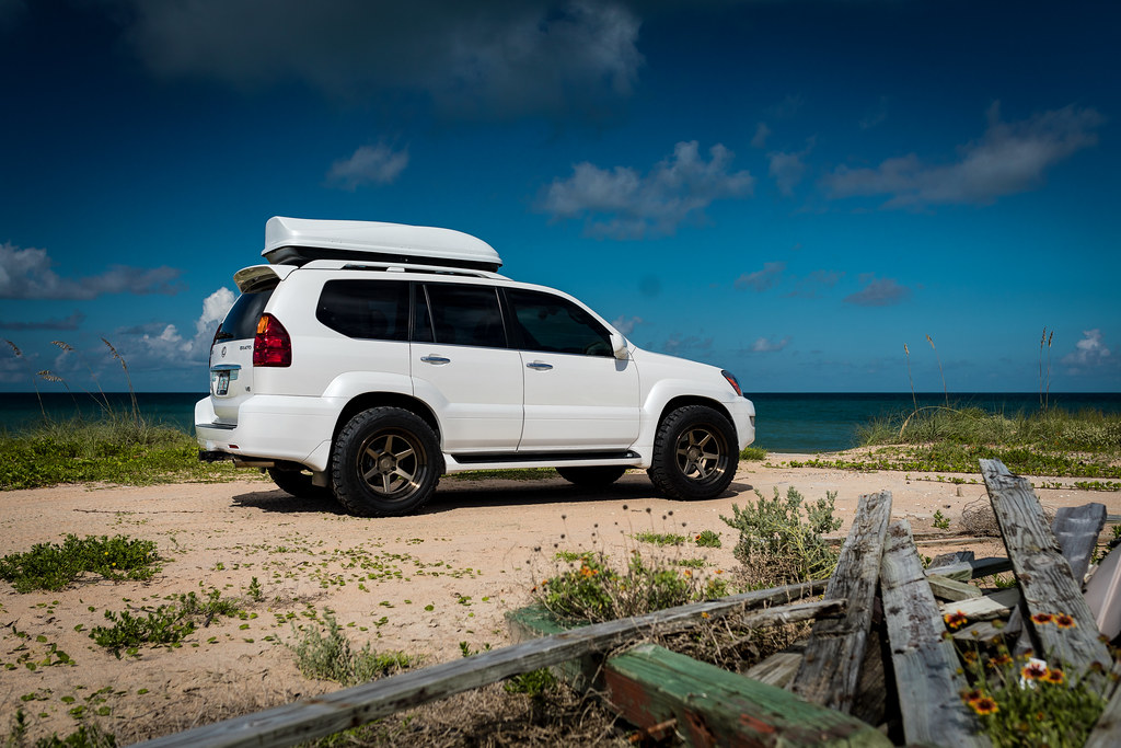

Not the first to pull off this combo, but switched to 20" 4Runner Limited wheels with 275/55r20 tires (getting rid of the god awful 17" OEM chrome wheels). No rubbing and the ride is only slightly firmer than with the 17" tires, which is more than worth it for how much more stable & secure the ride is now.
Now to find Lexus logo'd center caps that'll fit to replace the Toyota logo'd center caps ...

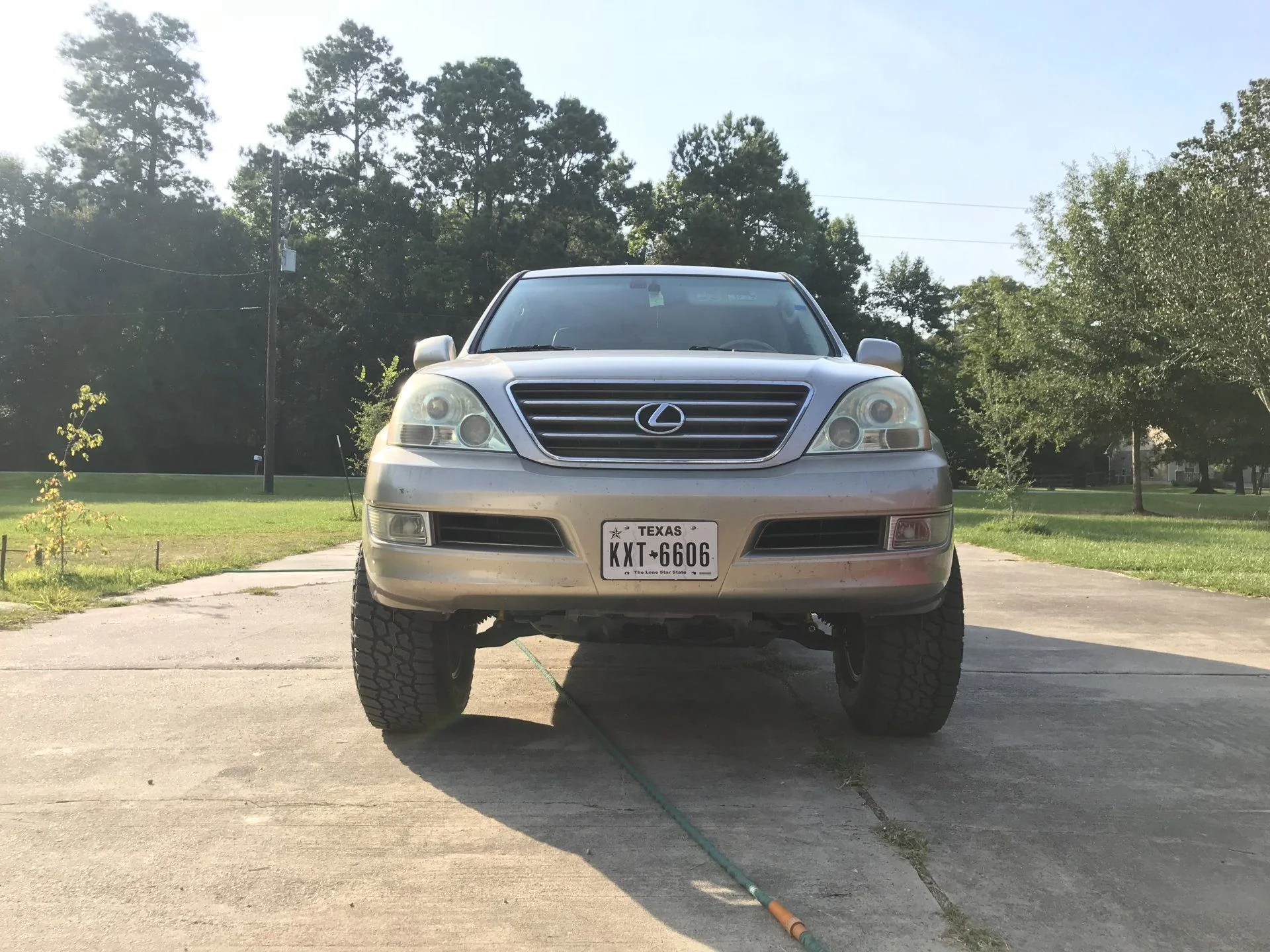

295/70/17 Toyo RTs on 17" Black Rhino Roku +12 offset with Icon 2.5" lift
I like the look, but it seems like a lot of tire with minimal suspension work.
How much does it rub?
What are the specs on the wheels, tires, and suspension?
Ah you can never have too much tire and not enough lift granted it clears. You can however have too much lift and not enough tire :-) At the moment everything perfect and I get no rubbing at all however I did modify several things to get it on 33's to clear that way. The trucks on a full set of coilovers so I can adjust it wherever but personally I don't care for the GX high as I do a 4 runner or Tacoma there tall themselves so it just amplifies the awkward shape.
