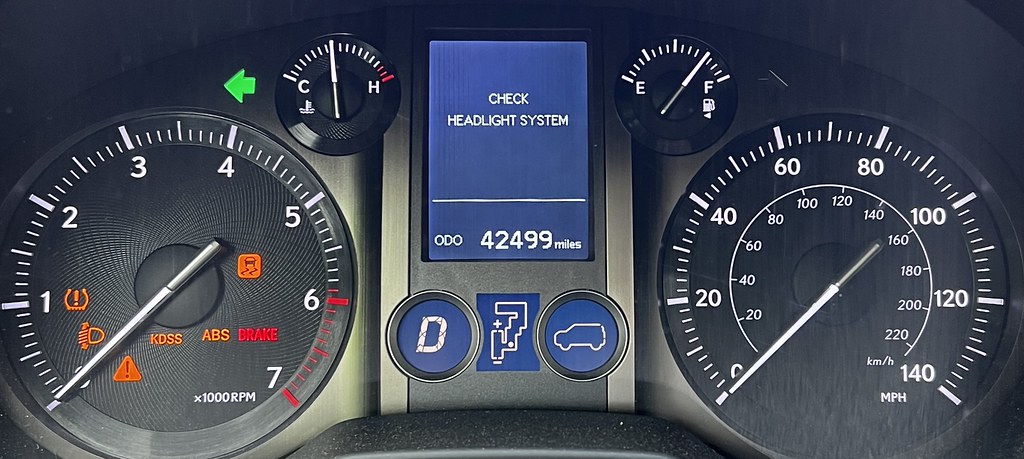

Drove the GX yesterday to do a quick local hike. Was braking from speed and suddenly got all of these warnings, plus the tach and speedometer sweeping from "off" to max RPM/speed. I've gotten the traction and ABS lights in the past (as I posted about on here recently) but this was the first headlight warning notification.
Scanned the codes and got like 7 pages worth-- Engine and ECT, KDSS, ABS/VSC/TRAC, Main Body, Combination Meter, etc.
This truck is really starting to piss me off.

That's my suspicion as well. That or a bad ABS/speed sensor that's just intermittent and getting worse.

You probably haven't filled the dashboard with mud but I wouldn't be surprised if a wire/connector was knocked loose or there was some fault in the head unit that triggered all those codes.
That certainly seems plausible. You can also damage the speed sensor wire by stretching it to much, although the actual sensor itself should last forever (all of mine are still OEM at 19 years of age). Have you done any wheel/axle/suspension work on the GX recently? It's not hard to stretch a speed sensor wire when working on the rig. Or the connector could have an issue - might be worth unplugging all of them and putting some dielectric grease in the connectors.

Loose connection seems likely
No, I haven't done any work. But the issues have only been as of late. Last wheeling trip was back in January (February?), though no issues for a few months after that.
Doing some reading. This seems possibly relevant: Dash lights, trouble codes issue 2013 GX #ABS - ClubLexus - Lexus Forum Discussion - https://www.clublexus.com/forums/gx-2nd-gen-2010-2023/894540-dash-lights-trouble-codes-issue-2013-gx-abs.html
Yeah I had that headlight warning one time when I forgot to plug the wheel sensor back in after some suspension work.
