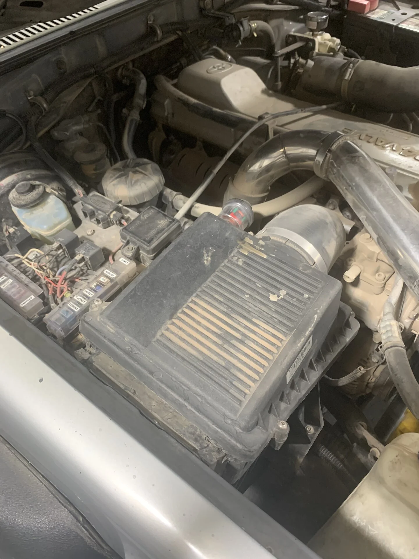

Look into a less restrictive airbox, it is your limiting component now. Rig up a vacuum gauge on the turbo inlet, mine was pulling vacuum at full boost, upgrading the airbox made a huge difference.

That is really interesting. I never thought about the airbox being the choke point. Which box did you end up with? I'm going to order one.
When I was doing it, there were not many options, torfab had one, and this place: Stainless Air Boxes - https://moonlight4wd.com.au/collections/stainless-air-boxes
They were very proud of them and wanted a hefty price, either way some kind of modifications would have been necessary to make it work. So I ended up doing a custom jobber using an airbox from a chevy truck.
Torfab (@NookShneer) has a high flow box on their site
I don't know if it fits or if they have brackets for the 70 series, but might be worth looking into.

I had seen the PDI version also- looks good. I'll be very interested in what you find out. I have a LHD 24v truck so there is a battery in that general area. I guess the deciding factor for me would be if any of the above air boxes fit in the same real-estate as the stock air box and do not interfere with the battery.

If you have or plan to install a snorkel, it actually makes it easier to make one of these work. The stock inlet routing(as you know) uses a bunch of fittings to route behind the fender to the front, which is where a lot of the restriction is happening. With a snorkel its a direct shot into the air box, with a lot less elbows. I have the run of the mill plastic safari, thinking about changing it out to the stainless steel pipe that the aussies run.

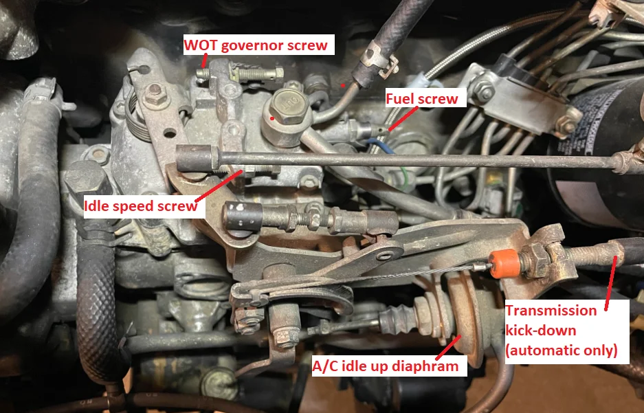

The 1HZ injection pump only came with one quick adjustment - the fuel screw. This screw increases or decreases the fuel across the board (i.e. at idle, at WOT, off boost, and on boost, etc.). This single screw does not offer enough adjustment when a turbocharger is added.
The solution is to add a device called a Boost Compensator. This allows the fuel to ramp up or ramp down as boost changes. This article explains this much better than I can.

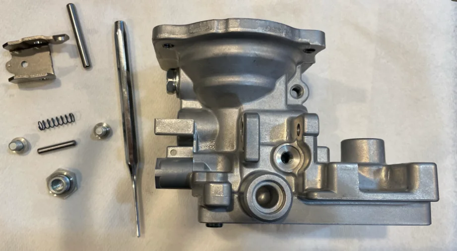

Toyota made several different Boost Compensators, and all fit. Here is a thread discussing the various Boost Compensator options.
' HZ/HD Boost compensator question/confusion - https://forum.ih8mud.com/threads/hz-hd-boost-compensator-question-confusion.1128520/
By the time I started this project, only one compensator was still readily available (22540-17260). I also grabbed a new gasket (22774-54270)

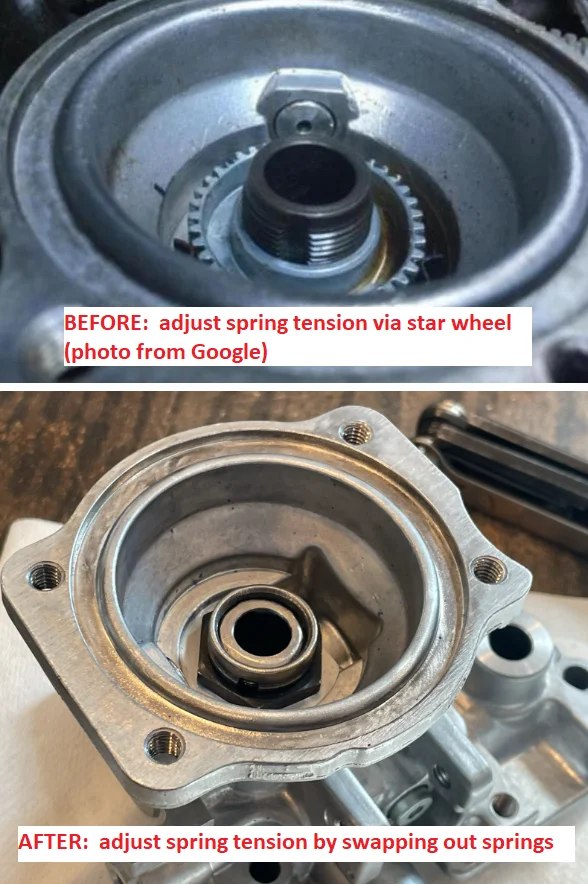

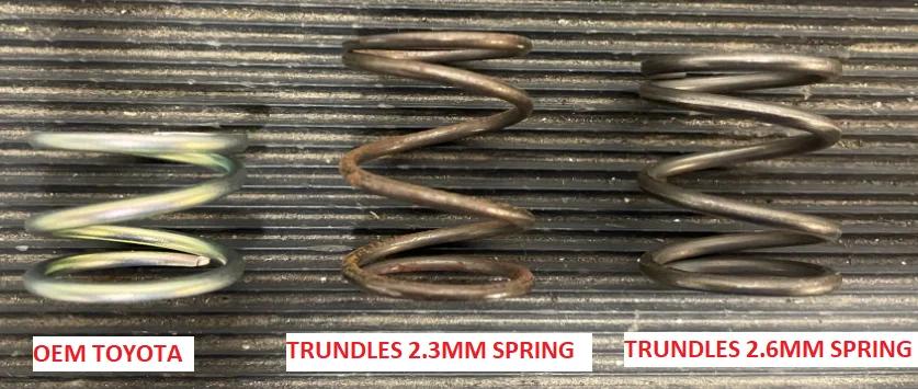

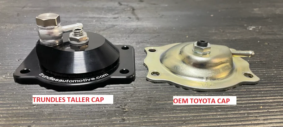

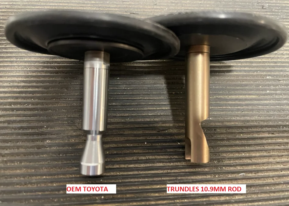

I also ordered the Trundles Automotive taller cap, pin, and spring. Here is a comparison of all.
The support from Trundles Automotive in New Zealand was absolutely outstanding. They answered questions via email quickly and concisely.
With that said, I do believe the Trundles setup to be overkill on this 1HZ engine. It requires removing the star wheel and adjusting via different springs. Also, the threaded rod must be cut down, which I did. If I had to do it all over again, I would stick with the stock setup. The Trundles system is more geared toward HD engines making big power.
Again, all of this is unnecessary on the 1HZ engine. Keep the original cap and star wheel setup and save the Trundles system for the big boys running big power.

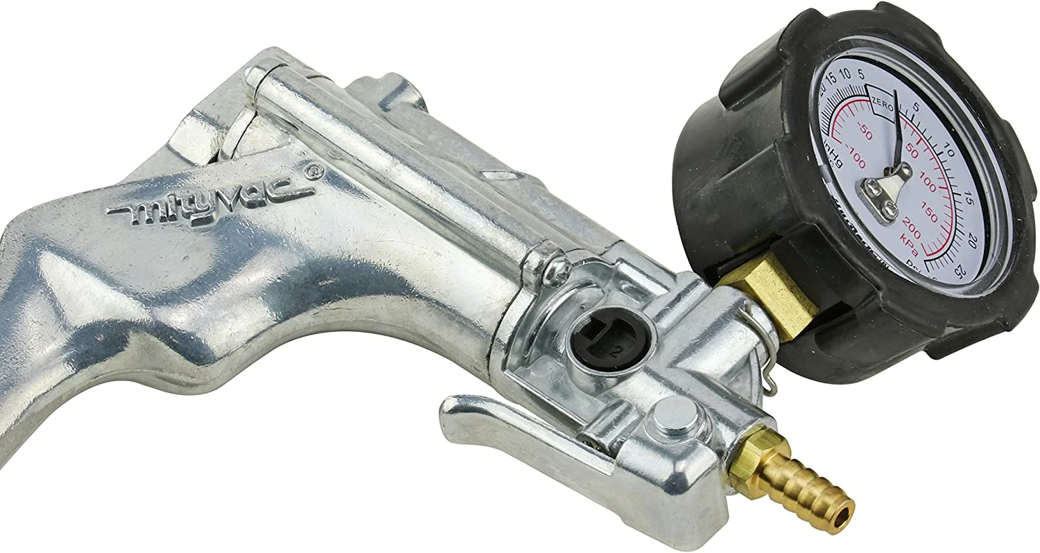

The spring tension must be adjusted to match the max boost, in this case 15psi. There are two methods to do this. First, buy a MityVac MV8510.
METHOD 1 (from the top) - this is the only option if the boost compensator is already installed on the pump. This video explains it pretty clearly.
METHOD 2 (from the bottom) - if the Boost Compensator is off, this method is far easier. Watch the video above and then apply the principle from the bottom. No paint pen required.

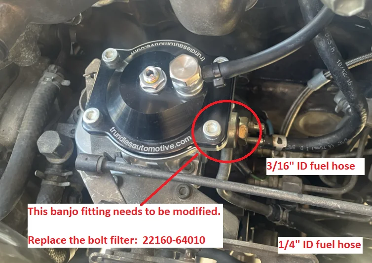

Once the spring tension had been properly calibrated, I installed it on the truck and modified the banjo fitting following this thread.
' Builds - 1985 BJ70 Story and Modifications - https://forum.ih8mud.com/threads/1985-bj70-story-and-modifications.608045/post-11016865

Grrrrrr I totally missed ordering the VE springs when I ordered from Trundles i plan to be running anywhere between 18-25psi of boost I'm wondering if i really need the 2.6mm spring or if I'm just fine with the factory spring?
thanks for sharing the details!!!
According to Gturbo, you don’t need it. They have a tuning guide all for the stock compensator for their turbos
