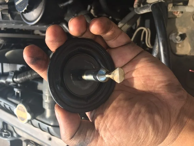

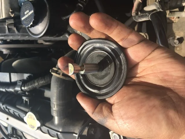

I ain’t grinding my pin as it was already done by previous owner. And wasn’t done good as half the pin is gone. so I went with trundles pin.
I ain’t grinding my pin as it was already done by previous owner. And wasn’t done good as half the pin is gone. so I went with trundles pin.View attachment 3362444View attachment 3362446
That bottom half grind is just to get it in easier, no harm done. Just rotate is 180 degrees after inserting it to get on the normal ramp area.
Anyways, not saying you need to re grind it, just trying to share that an extra tall pin isn’t needed for full utilization based on how it works/ Gturbos instructions.

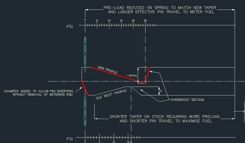

This pic has been getting around on here for years but it shows very clearly what needs to be done to get more fueling on stock aneroid. The follower pin with the stock profile only moves about 4mm in depth but it can actually move slightly more than 6mm giving a bigger range of compensation and more fuel.
