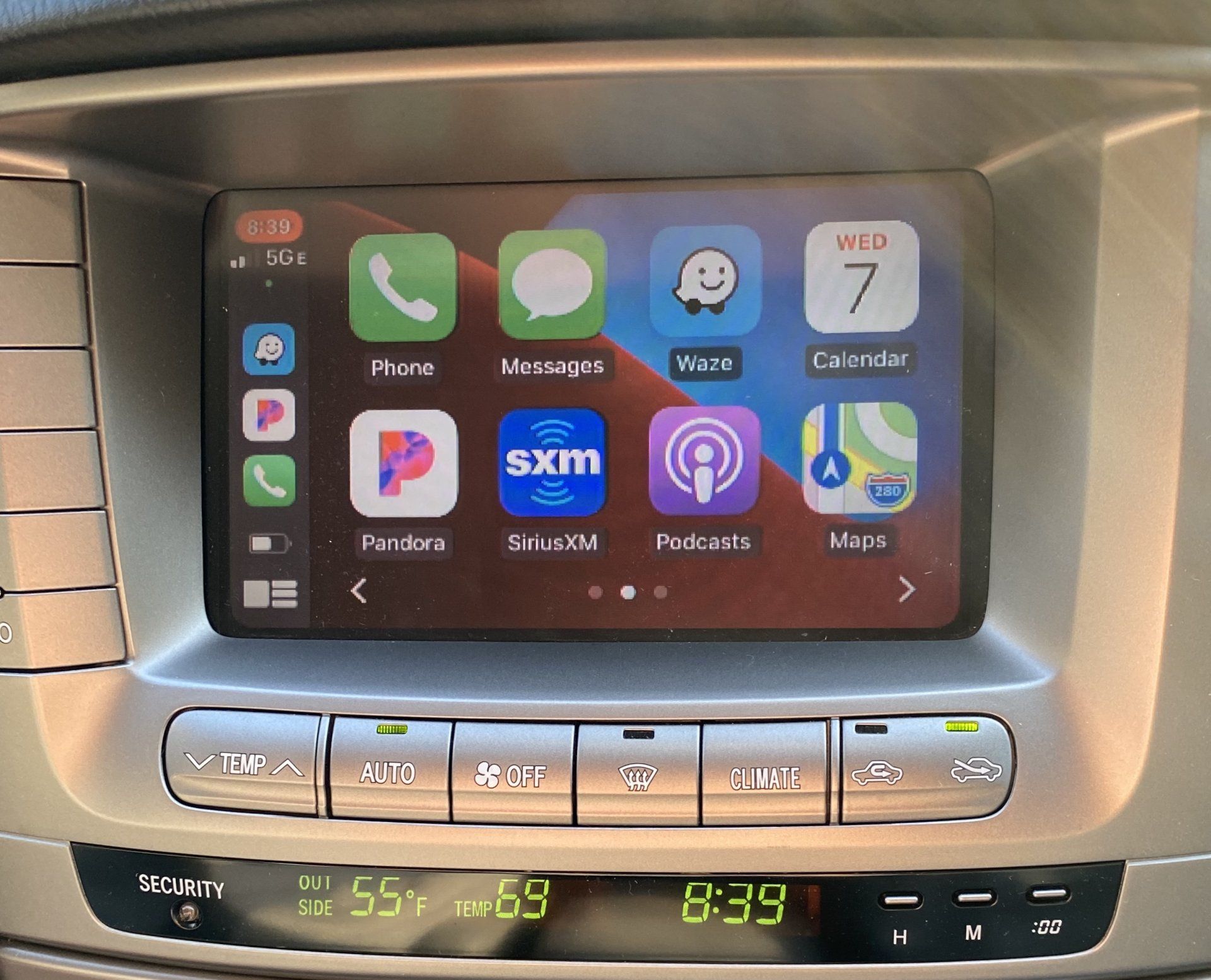

Mine dropped back to wired... and occasionally a blacked-out screen. The newest firmware won't install. GROM tech said to pull the power cable from the unit... you know, the unit that's installed behind the dash. I think pulling a fuse will do same thing - a hard reset... I'll post an update.
Update: ^That^ worked. The issue I was having was with the Bluetooth - it would no longer recognize or pair with my phone. Then, plugging the flash drive into the port in the dash wasn't loading the updated firmware that would (hopefully) fix the issues. But pulling the fuse - GROM tech's recommendation - was the kick in the ass it needed to digest the update.

I’m on team BT TOY for the simplicity but that photo makes me interested in the GROM unit for CarPlay. But don’t you have to open the android screen and then select CarPlay? Or can you default to CarPlay?
GROM has nailed simple. This is the startup of the system - from ignition ON to apps. Wireless and touchless.
Sometimes, the old Toyota nav caution prompt - "I Agree" page/button - pops up. That might be 1/2 the time? Then I click Agree on the screen, then Audio on the left side - the physical button, then the app page appears. So, still no other menus.
