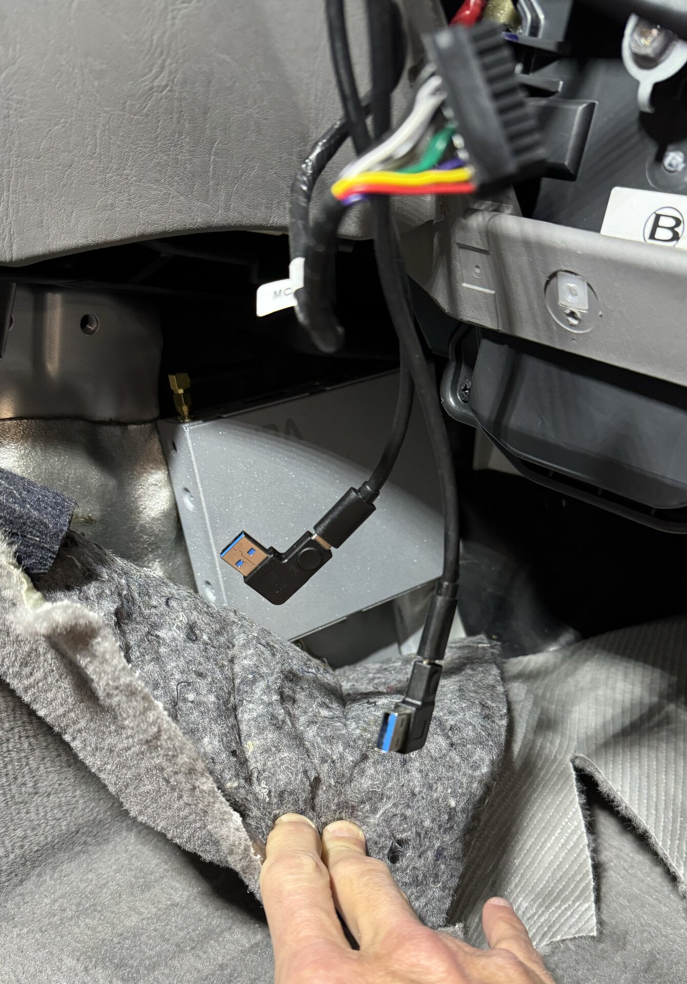

I put mine under the carpet - just under the air vent that blows onto the front passengers feet. Kind of up on that side wall area to the left there.

Ended up rotating the unit 90deg clockwise but this location fits perfectly, can barely tell it’s there. Weathertech fits.

That’s a great location. Looking forward to putting mine there when i get it back.

Just to follow up. I completed the installation today. Went pretty smoothly, definitely took longer than I had planned.
I ended up putting the unit behind the carpet on the left side of the passenger side footwell. This seemed to work really well. There is plenty of room there. I snaked all of the wires into the glove compartment area and then down as I found this easier then trying to go straight down.
I put the USB in the factory cigarette lighter area. I thought I had seen people remove the trim surround there without removing the shifter trim but on my 07 this is not possible. I used a cigarette lighter removal tool to release the clips and then disconnect harness and then put a bunch of tape around Grom USB and then tucked it into the white shroud that the cigarette lighter was in, looks pretty much factory.
I put the microphone in the overhead console on the right side. I have a 2007 with factory Bluetooth and the OEM microphone is installed on the left side of the overhead console where there are slats but the right side (where there are also slats) empty so I just taped the microphone to the standoff where the clip is and then ran the wire down the passenger a pillar behind the glove box and down to the unit. Had to crank up the gain but recorded audio quality / phone calls / voice recognition all seem excellent.
