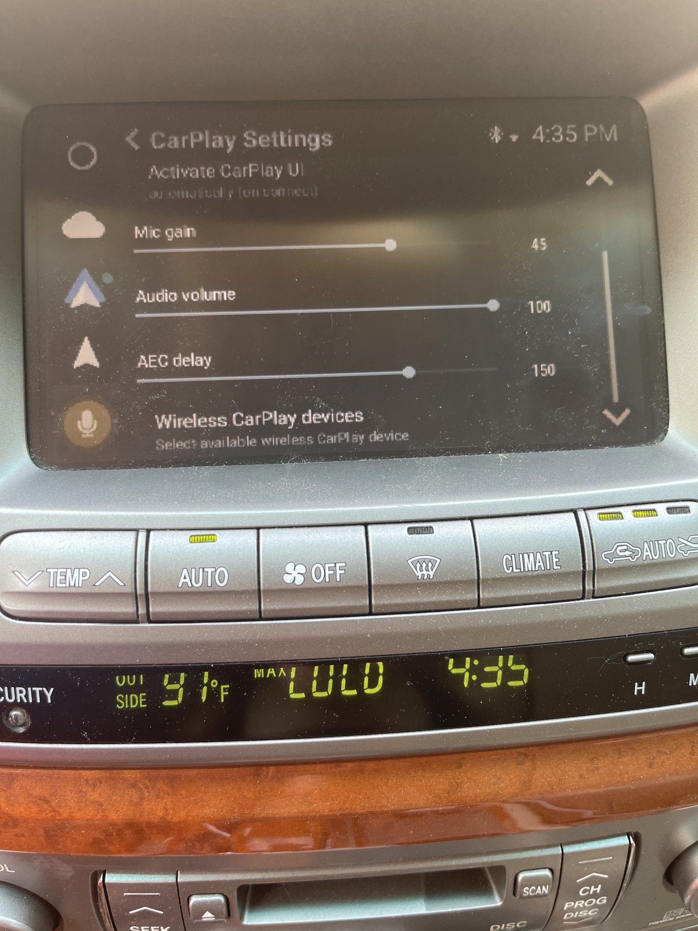

Looking for some help here with Carplay. I connected my phone via bluetooth to the grom. shows its connected. When I go into the setting to turn on wireless carplay, it doesnt give me that option. Can someone give me a little help?

On that screen, scroll down and you should be able to see your phone and click on it to pair. It should then connect to airplay. I believe if you also click, automically start, at the top of the screen after pairing, it will automatically connect going forward.

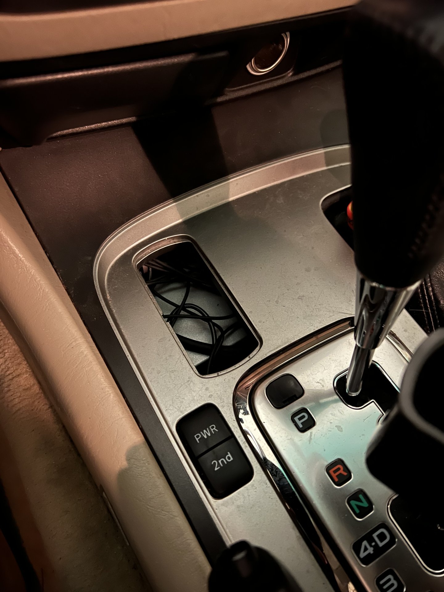

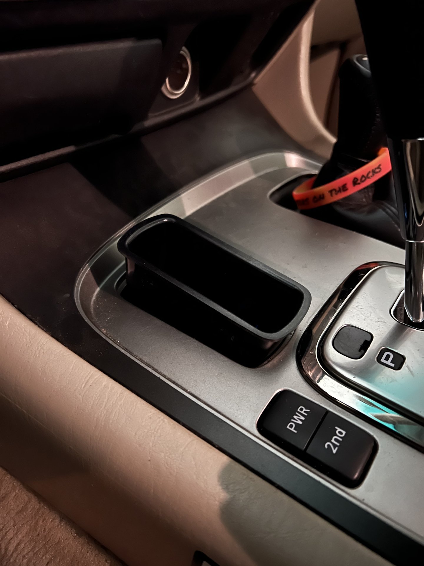

I ended up putting it in front of the gearshift. It fits well in that place minus the little storage bin (non-AHC version). Does anyone have any solutions for what to do with this little area? Or maybe a different spot for the VLine? I met someone that said they put it to the left of the head unit, or maybe down by their right knee, but I can’t quite figure out where that space is. I prefer this to losing my glove box I think, but still not ideal.
