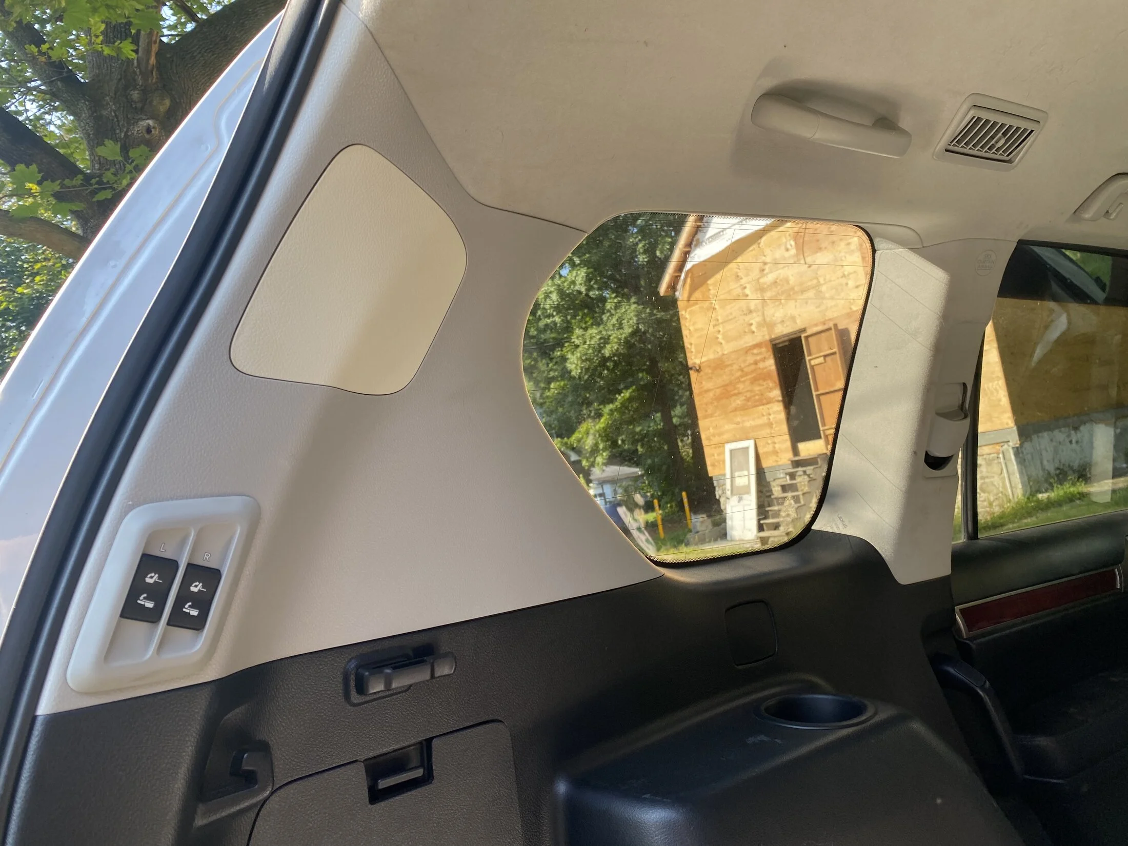

Looks like we have the same color interior, and miss matched lighter beige caps?
Looks like we have the same color interior, and miss matched lighter beige caps?View attachment 3742331
100%. I'll scour Partsouq for the right garnish caps to see if I can locate the proper part # for whatever the hell this color is we have. Also, what is that part # for the 3rd row seatbelt clip on the driver's side? Mine is missing. Panel looks weird with holes. LOL

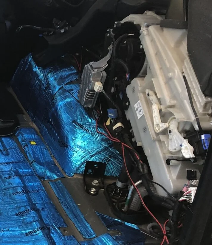

Do you have 3rd row HVAC? If so how did you get the 3rd row seatbelt out on the passenger side?
To add, I only see three colors. Light Grey, Ecru, and Black. I ordered the light grey ones from Japan and the Ecru ones from Bell Lexus. I need to try and locate the grey ones to actually see if that's the same color. One day I do want to convert the two tone grey/black over to an all black interior if that's possible.
Ecru:
62476-60011-A1
62477-60011-A1
Light Grey:
62476-60011-B0
62477-60011-B0
Black:
62476-60011-C0
62477-60011-C0
I pulled the panel, also did put siless sound dampening back there while it was open. I took all the vertical plastics for the back off. I still need to do 1st and 2nd row, but thr revos are so quiet it's been un-needed.
My problem is I'm trying to find a way to remove the least amount of bolts/clips to pull out the HVAC unit to get to the 14mm seatbelt bolt.
Oh yeah, I may have left those, i can check.
I abandoned that bracket in place, it's not affected anything. I keep.my paper towels.over there so that the intake is next to something clean.
Oh, sorry, I didn't explain. I'm talking about the entire HVAC unit up against the wall there. You cannot reach the 3rd row passenger side seatbelt bolts with it in place. So I'm talking about the large white thing with vent tubes coming out of it. LOL
My bad i misunderstood. I did it so long ago I don't remember how I got them out, I guess.
Haven't removed the passenger side yet, glad to hear it’s going to be a PITA. Does the hvac not have identifiable mounting bolts to remove? I too have the rear hvac
I didn't look too deep at it but a casual look I didn't see an easy way to get to the seatbelt without removing all of it. I forgot to take a closeup picture of it.
I’m 99% sure I removed the belts without removing any rear HVAC stuff. I feel like I would recall that. That is interesting about the what I’d assume are ecru third row block off parts. I’ve been scouring for some on various sources and seemed like everything I got was NLA but Bell Lexus can source them?
Do you need Ecru? Clearly @JDUB fab and I have a set we don't need. LOL I wish you could definitively remember about possibly getting the 3rd row seatbelt off without removing the HVAC unit.

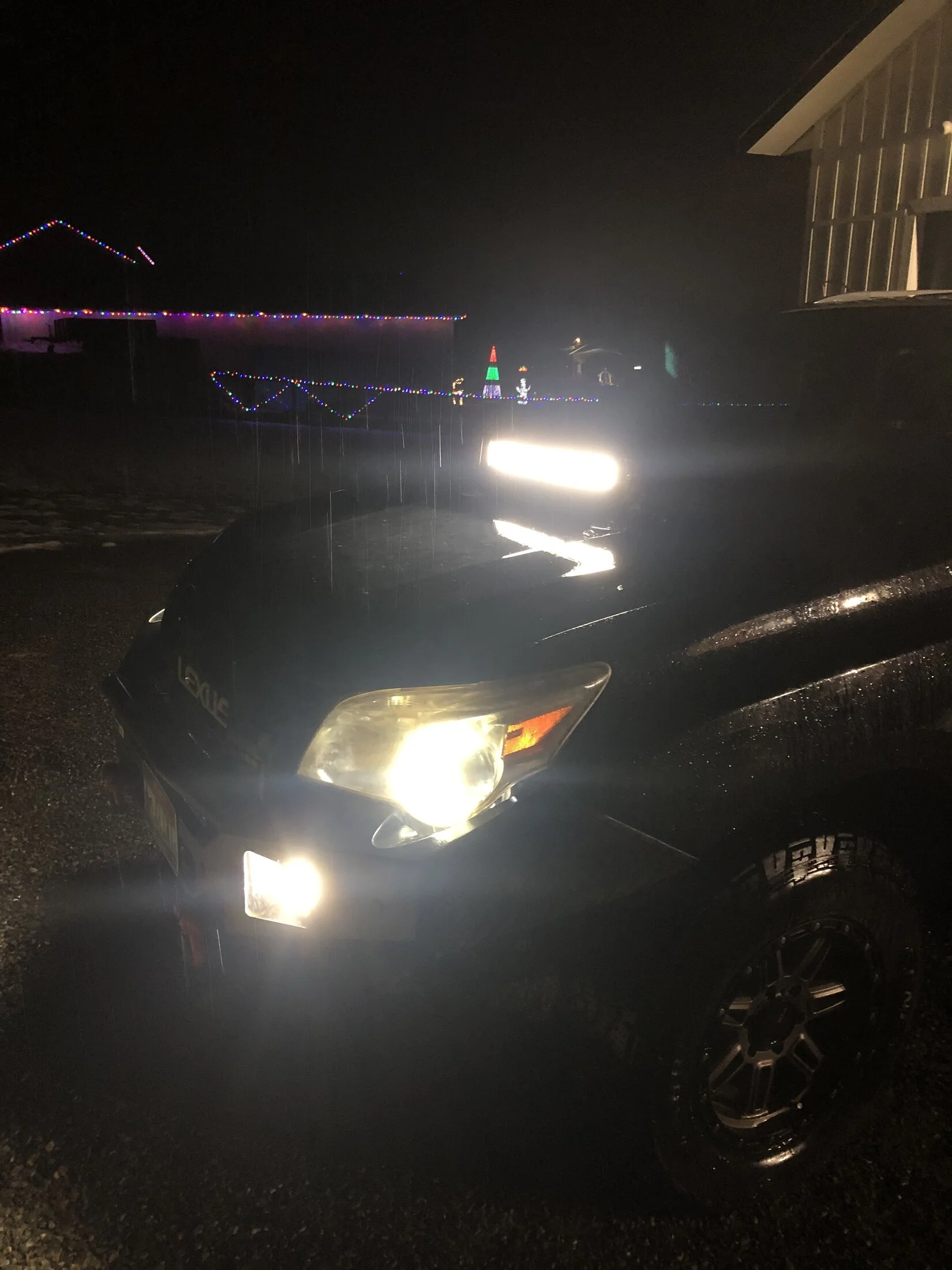

Bah humbug, the sun went down while I was installing the new light bar to one of those switches. This time I got a light bar I can adjust the height so now it's much better. The wildlife is no joke up here so I gotta get more light. Next up are my ditch lights.
Only light bar, no headlights.
Just looking over your links for the LED headlights to Amazon. They're gone. Can you give the name and part numbers from your order?
Yea, they're gone. I cannot find the original invoice so here's a couple of the newer versions. These I have are ~3yrs old and still going strong. They have brighter ones but these are doing just fine for me. Oh and they do not flicker.
Low beam:
High beam:
Just plug 'n play? Pull out the factory and plug these in?
I've never messed with the GX headlights, or any of the lights yet.
•• Just a reminder.. not simple swap out from HID to LED if your 10-13 has AFS HIDs
