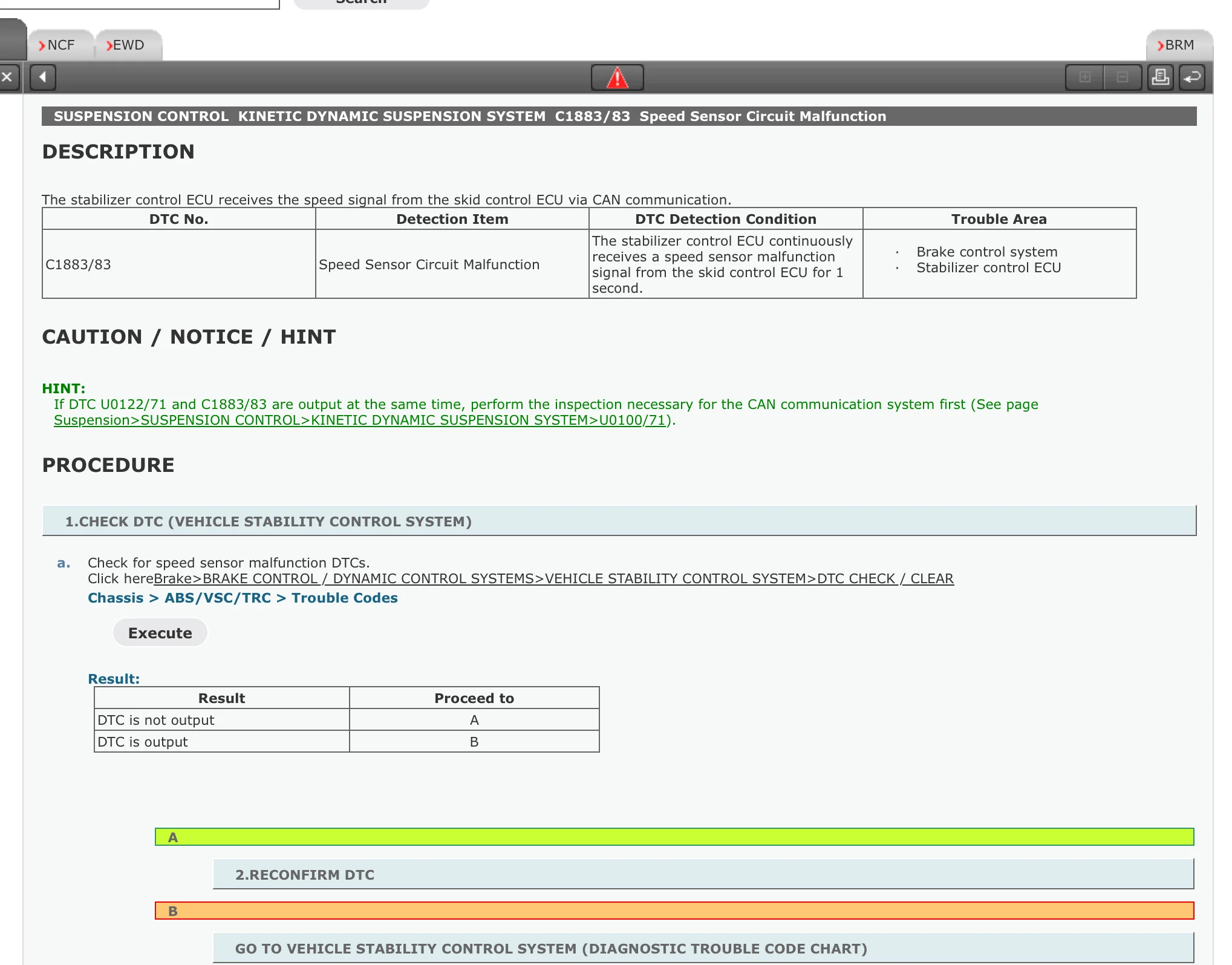

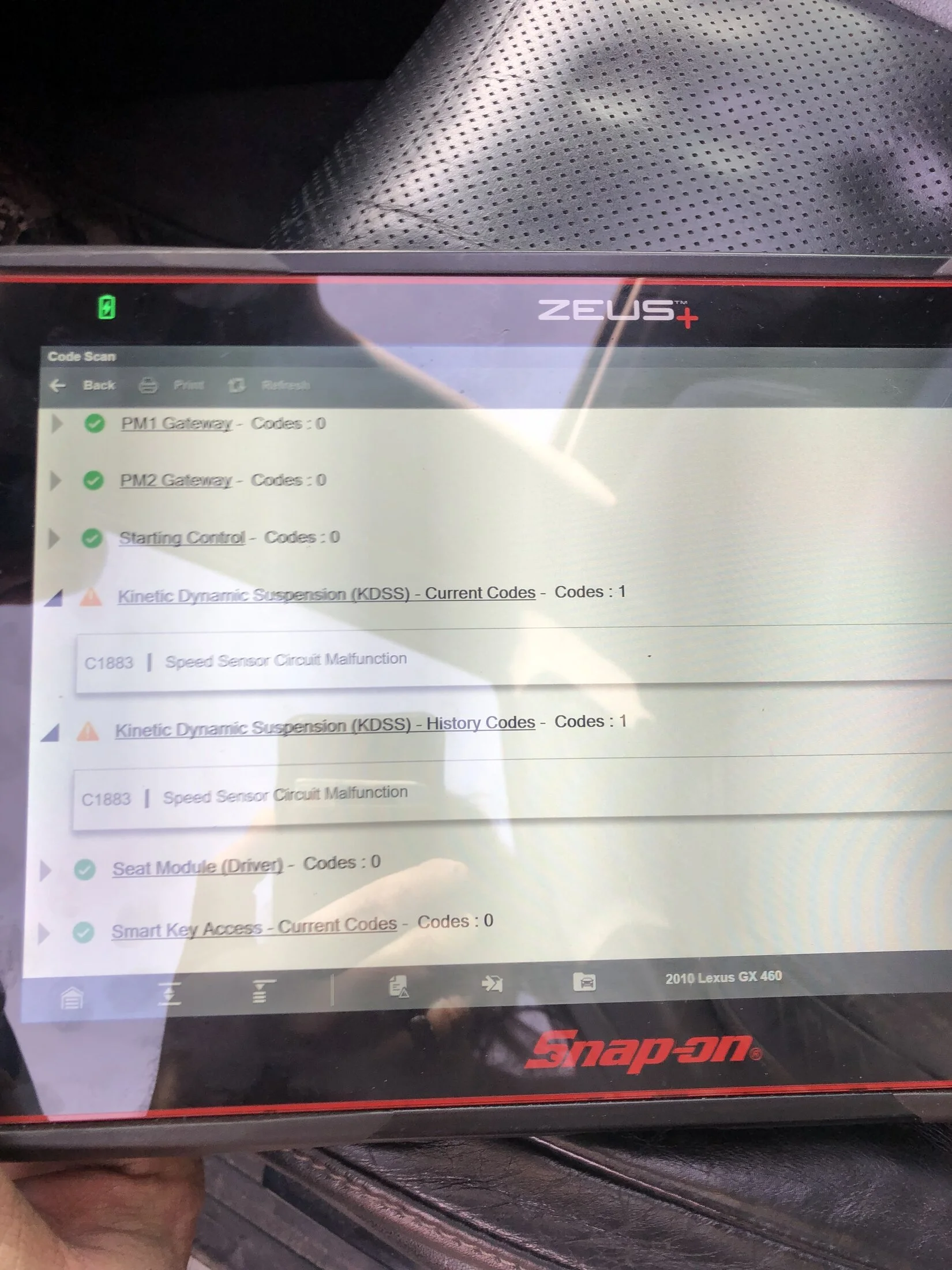

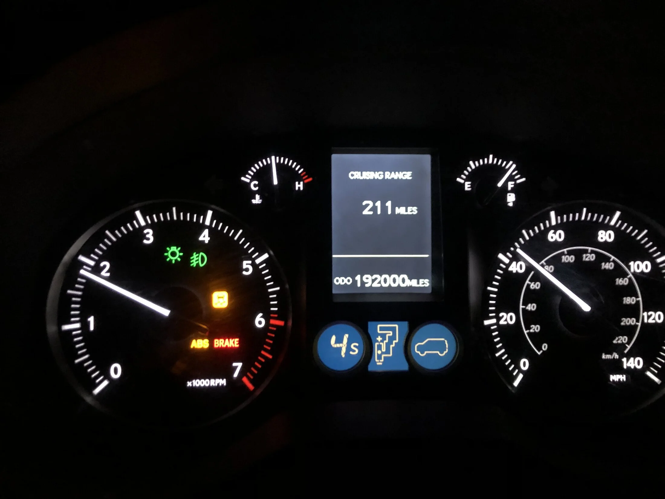

As I expected, left rear wheel speed sensor is what we think. I doubt it's the stability control ECU.
Cleared the code but immediately came back on so I'll be having that replaced along with the idler pulley. Next up after that are finally getting to changing out my original factory spark plugs and as a preventative measure later in the year my water pump and thermostat.
192k.
It might be a harness as well. Moderator “Jacket” here on Mud had that on his ‘13
Did you also get a C1404 for the rear left speed sensor?
I reached back out to my mechanic and he did see that other code, I just didn't see or get a picture of it. I'm going to buy that left rear wheel speed sensor and have him replace it. That should hopefully solve the issue. Thankfully the ABS wiring harness isn't that expensive so that'll be next. Saving the skid control ECU for last for obvious reasons...
Time to go hunt for the right part number.
