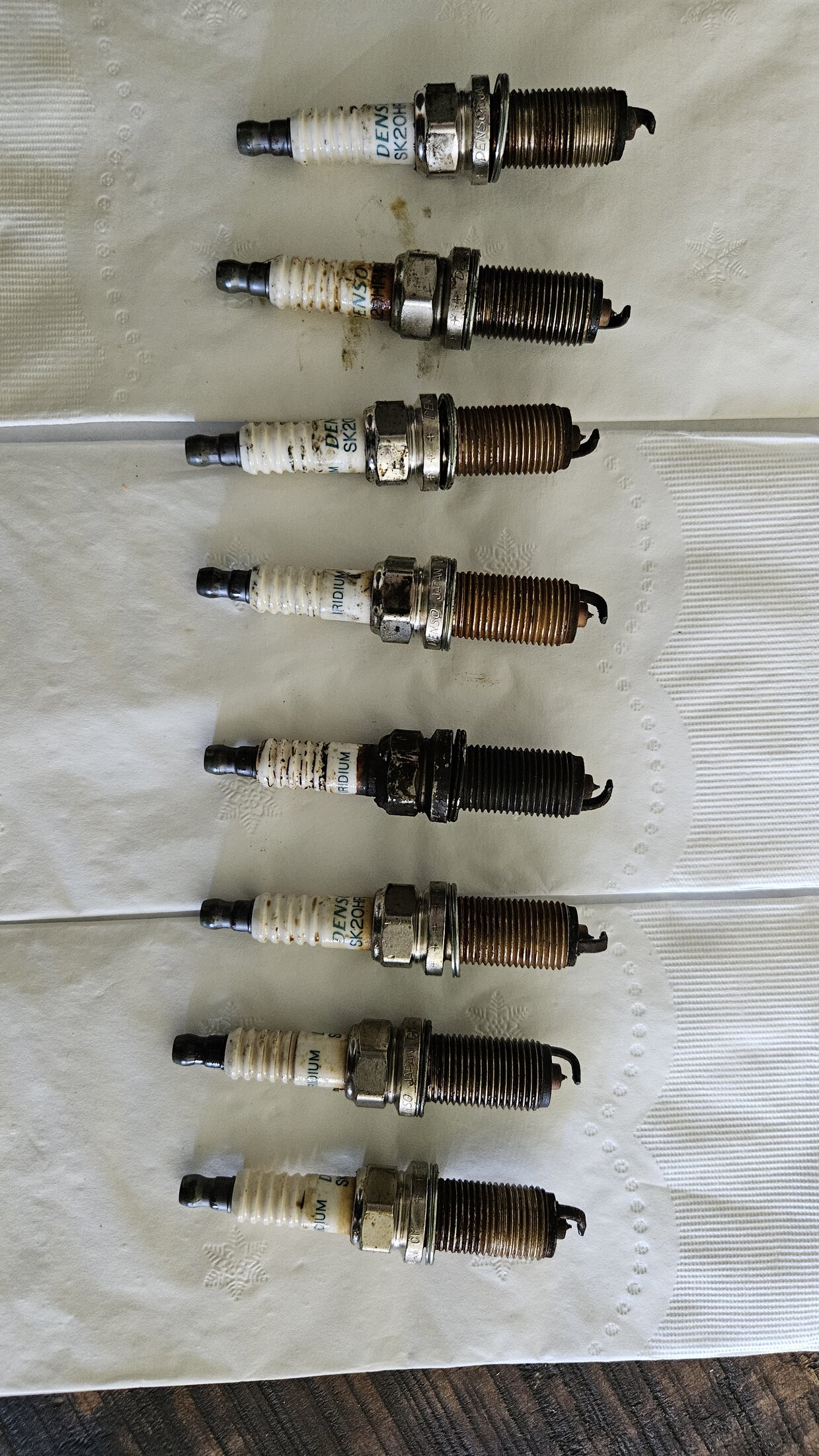

Finally changed out the original spark plugs that were installed during factory assembly. Picture of old plugs attached.
Had a compression test done and I'm at slight odds with the results. But, I think I know what's going on. Below are the #'s by cylinder. I think there is a lot of carbon build up thus not allowing a perfect seal on some cylinders. The truck runs flawlessly and doesn't burn any oil beyond a normal level and with the microscopic seep in a couple plugs tubes so I'm inclined to think it's carbon and my mechanic agrees. A carbon cleaning service is in order as well as new valve cover gaskets. There is a microscopic seep of oil in a few cylinders.
1 = 190
2 = 170
3 = 180
4 = 165
5 = 170
6 = 165
7 = 175
8 = 175
I'm going to attempt to clean the carbon and rerun a compression test and if the numbers don't improve to my satisfaction I'll likely sell and buy another GX460. But I'll cross that bridge when I get there and i may still just keep it anyway.
Thoughts?
