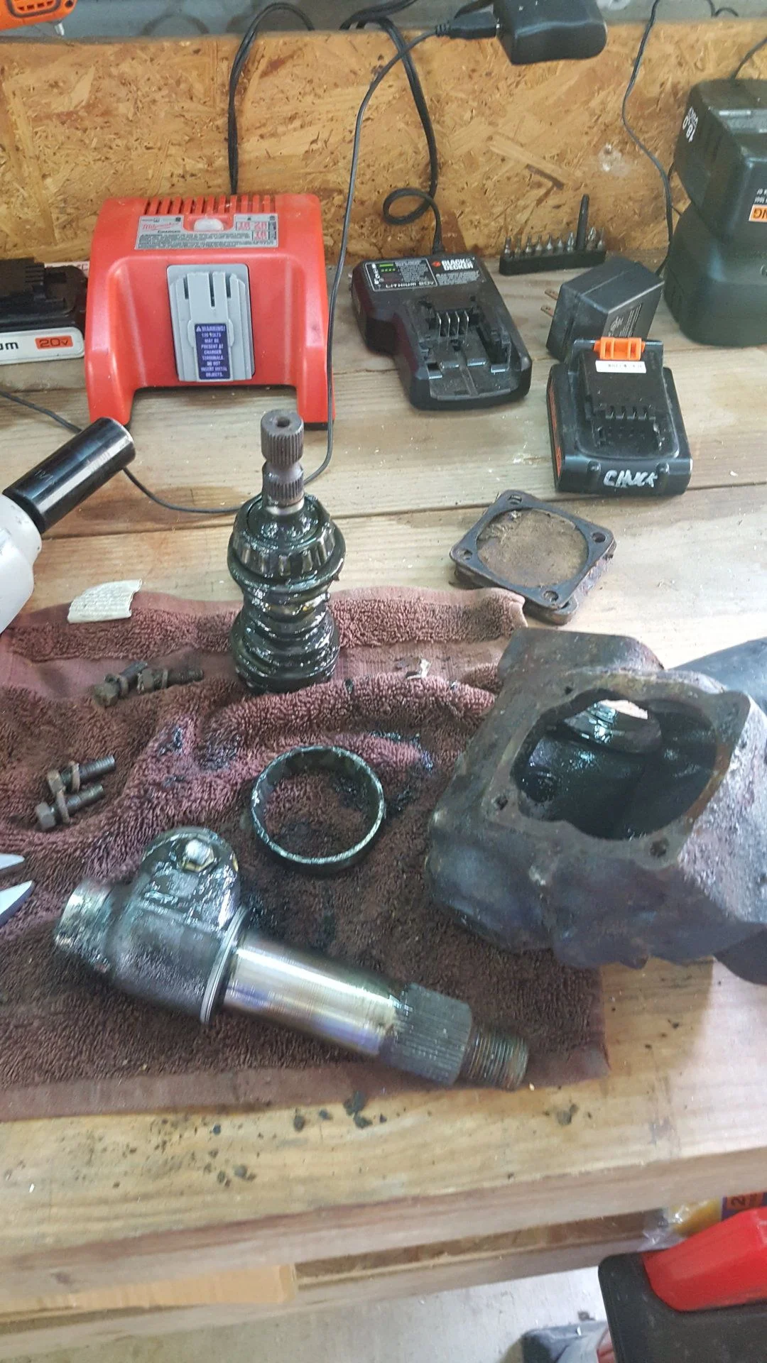

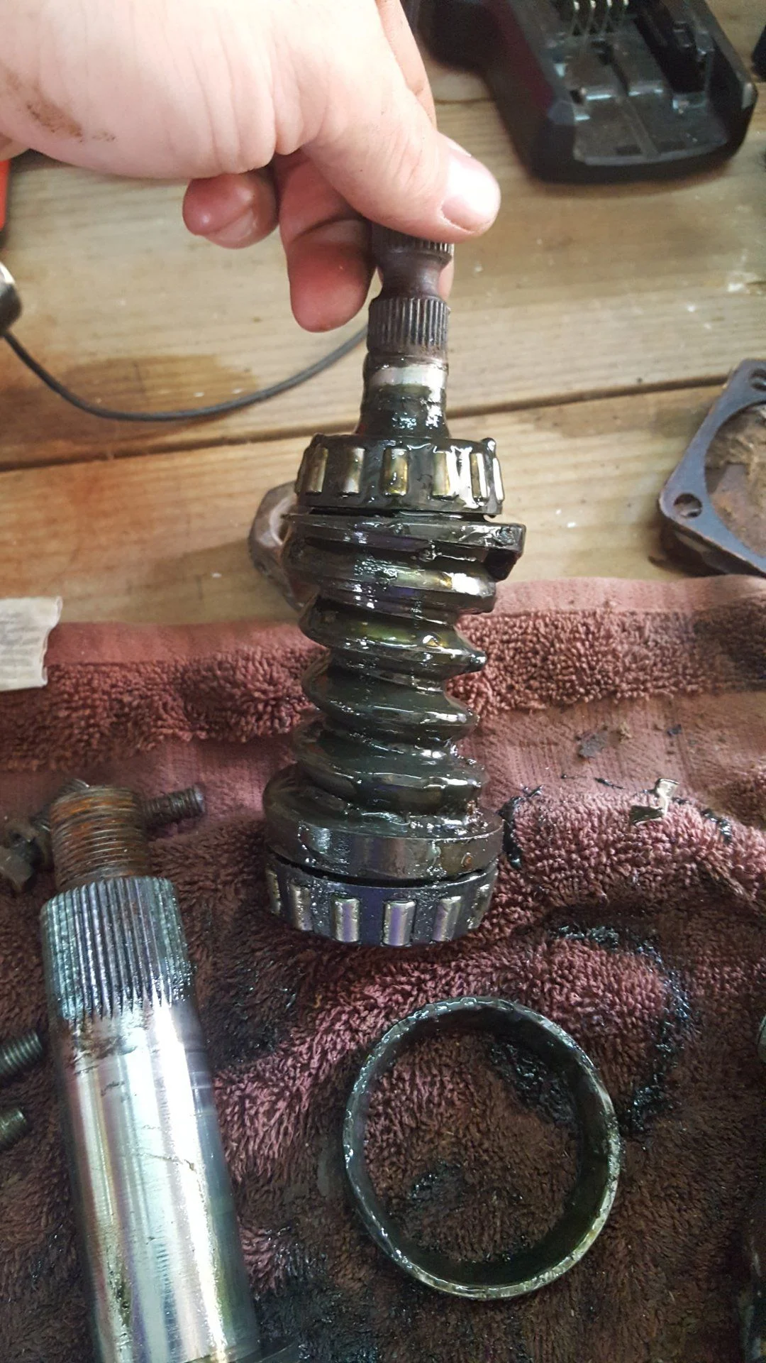

Ok, people need some help here on this one. Steering box
Never ever had one open...

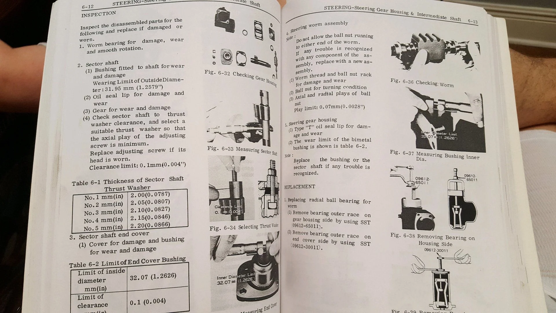

Yes needs cleaning looks simple, just not sure on the rebuild process? I read about large spacer and shims. Just curious about how to measure space between gear and shaft. Never rebuilt one. Out of my wheel house.
There ‘s group out in West texas that does the work- legit. SNR I think
I called West Texas off-road yesterday and also called Mark's Offroad and left a message with him. The lady at West Texas said his name is Matt I believe and he was out I will try to call again today.
