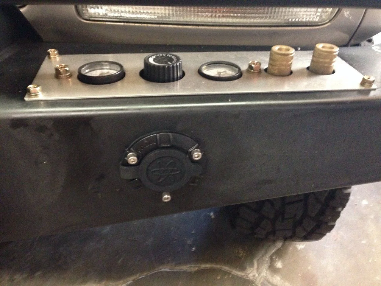

Added the next component. Just needed a new drill and 2" hole saw to add it. Trying to get everything ready for my trip.

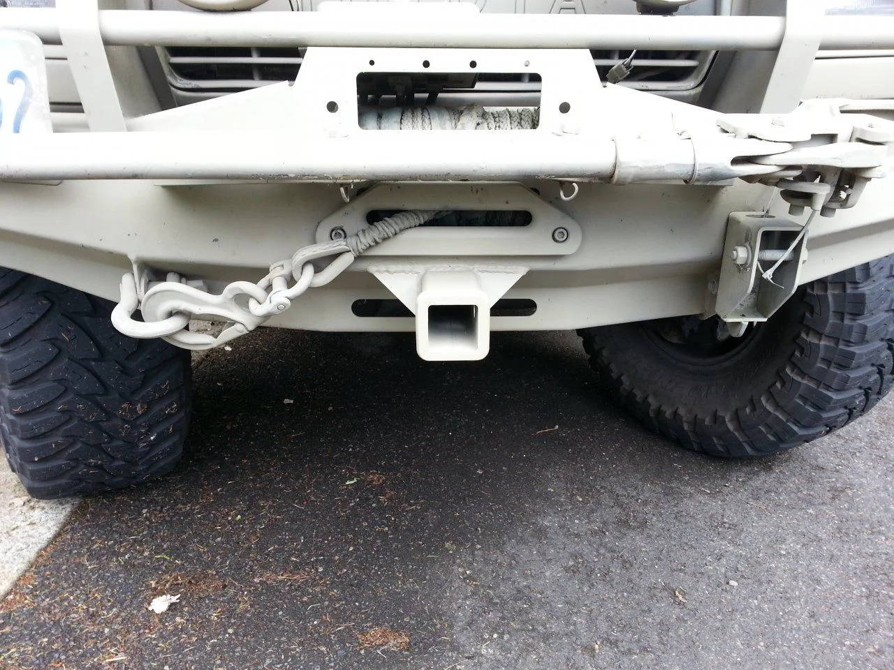

BTW, on the right side, is that a Hi-Lift attachment point? Looks familiar but not sure.
Looks like a homebrew version of the Slee Jack-off tool piece.
^ can't even imagine what I would use it for.
It makes pulling out our RV/trailer from its hole super easy. Launching my zodiac RIB is even easier since the launch area is super narrow! Its application is specific to my needs. Not for everyone! Also, I have got a bike carrier that goes in the front. Roger on the hi-lift attachment point.
We had a front receiver on our van growing up...made getting the camp trailer into a tight slot next to house easy. My parents used to get rather upset with each other during trailer backing before we had the front hitch capabilities.

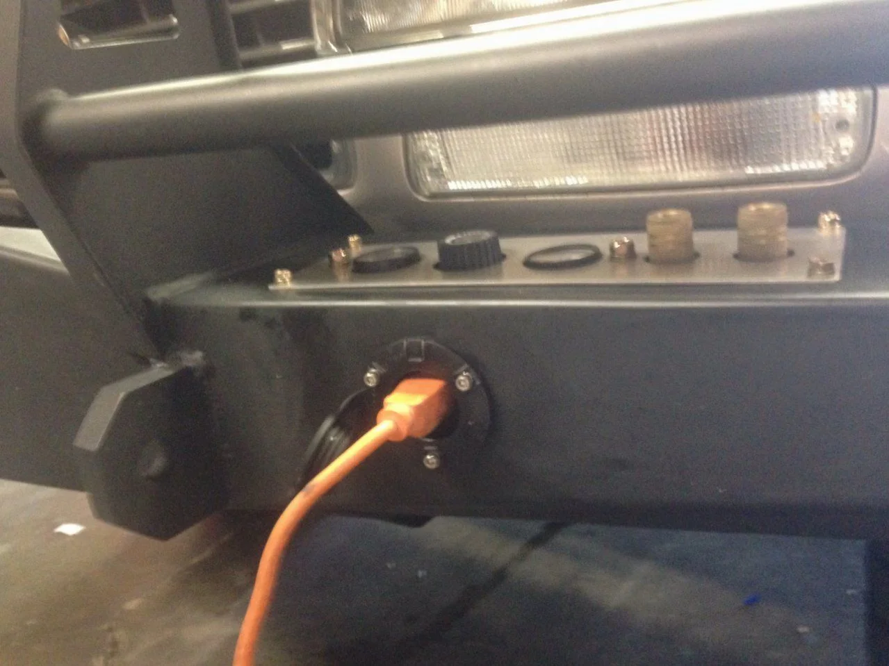

I dig the power plug.

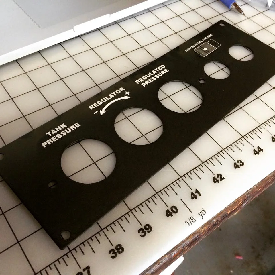

I updated one of my mods from last year on my ARB front bumper. The OBA manifold I'm using is fine was the plain old aluminum plate was boring me to tears and the whole thing has caused me to explain myself on too many occasions now. So I made another plate, had it powder coated and then laser etched it with the vector file I made for it. If anyone has a DeWalt Job Site compressor than the style is very familiar to you.
What it looked like this morning:
What the new plate looks like after powder and laser:

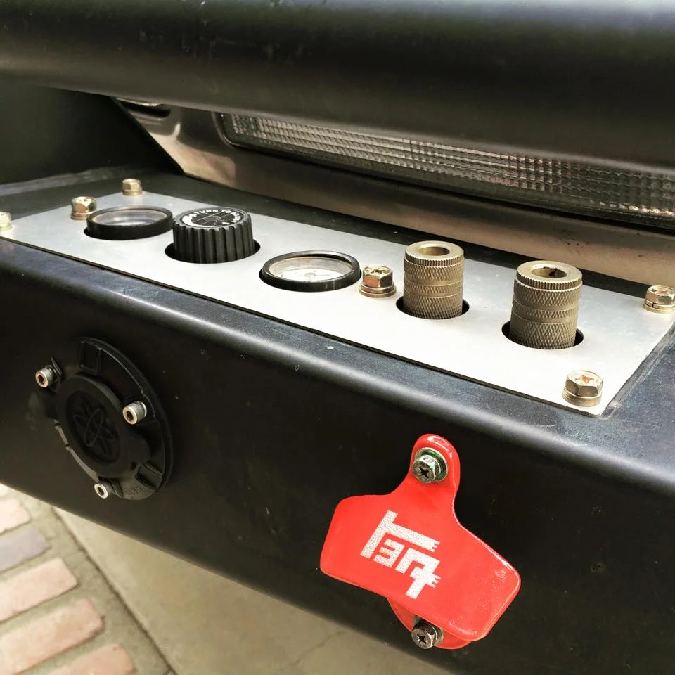

What the air manifold looks like:

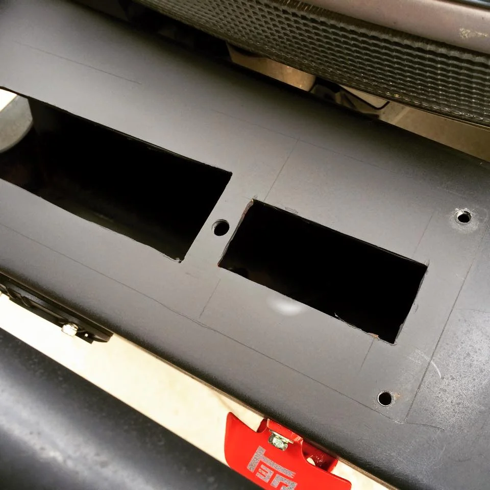

What the repainted matte black cut out holes in the ARB looks like:
And of course what the whole thing looks like now:

I like it with the exception of the quick connects. Facing up like that I see them getting filled with all kinds of crap causing leaks when used or even them seizing up. At least in a place other than So Cal.
I have mine mounted the same way, but it came with a rubber plug attached to a small chain. Never had an issue with it yet.
