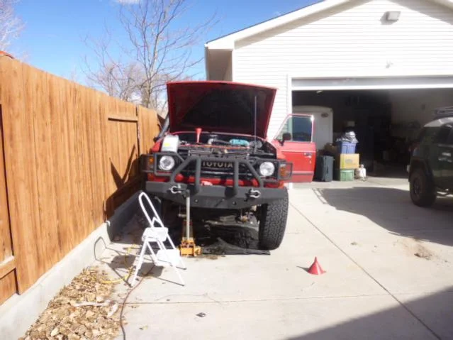

NEXT up...Heater..
Read and read last night and re-read PMs and posts.. Thanks for all the input... So, I decided to just pinch off the heater hoses and try and flush the core.. Water flowed pretty well so, I added some CLR just to make for sure I was getting everything I could. I didn't really see anything that threw up a flagfor concern.
Hooked the hoses back up, jacked the front up, ran the engine to 180F, AND ADDED ALMOST 2.5 GALLONS OF COOLANT..WTF.. It was at the filler neck last night..
So, either the 4BT had one HELL of a bubble or something broke loose during the flush.. I know I lost some coolant from the heater core flush, BUT NOT THAT MUCH!
Anyhow, topped it off and went for a drive. Heater warmed up pretty fair without the cardboard. Added the cardboard and it got pretty toasty inside. Ran Goss hard and never got over 220F on the gauge.
Played a little up at 13 mile hill and came home.. BEER THIRTY!
