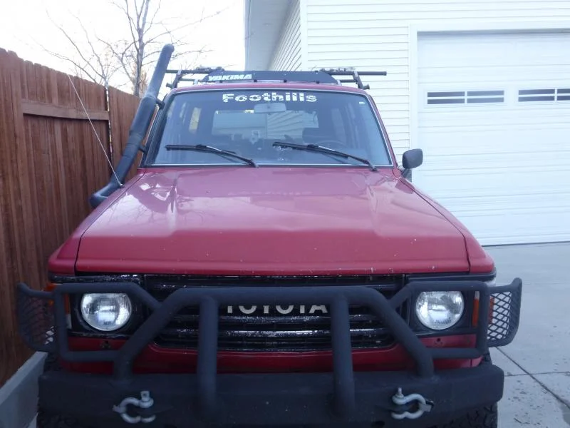

I’m back… couldn’t stay away… 63 days to be exact :rolleyes:

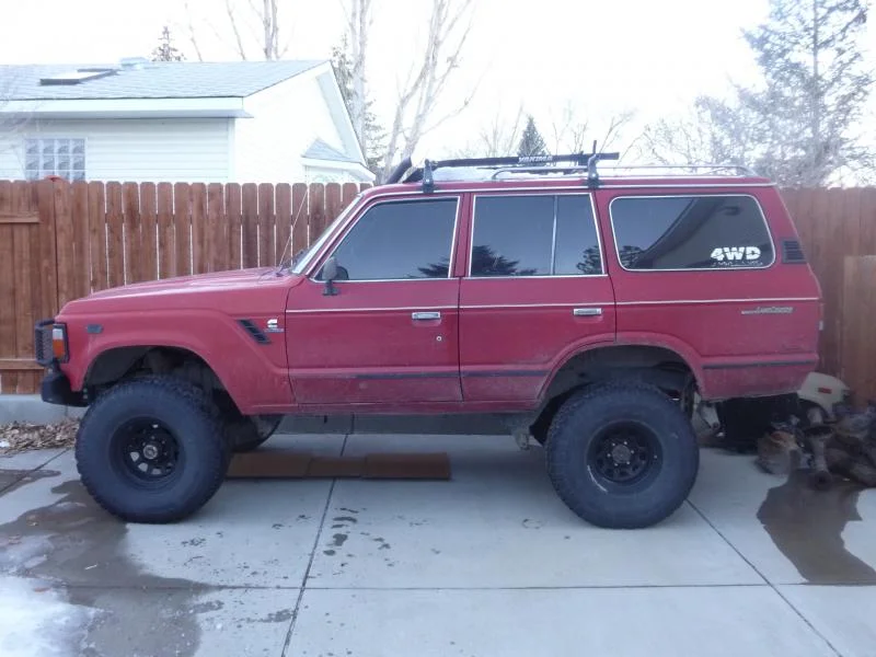

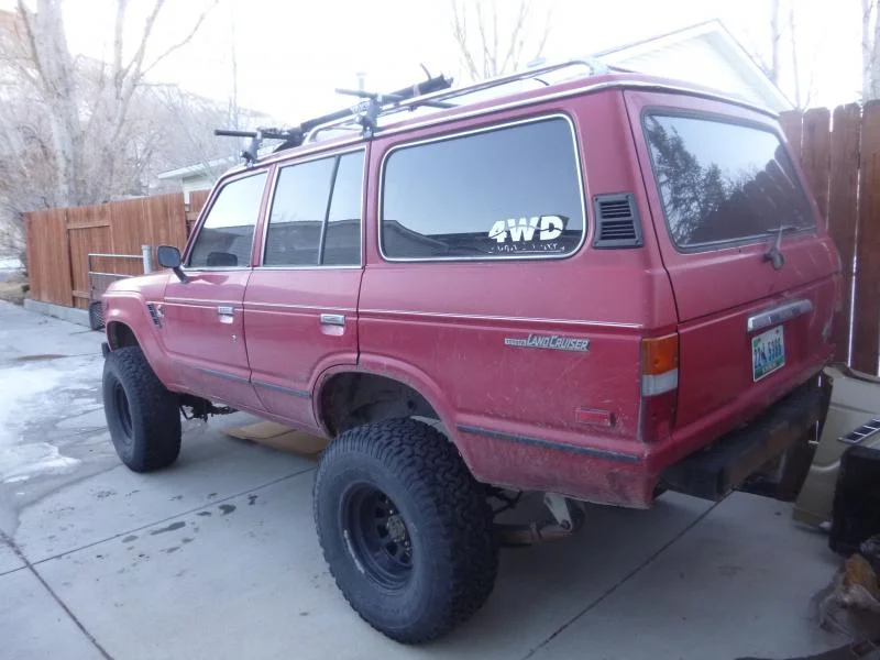

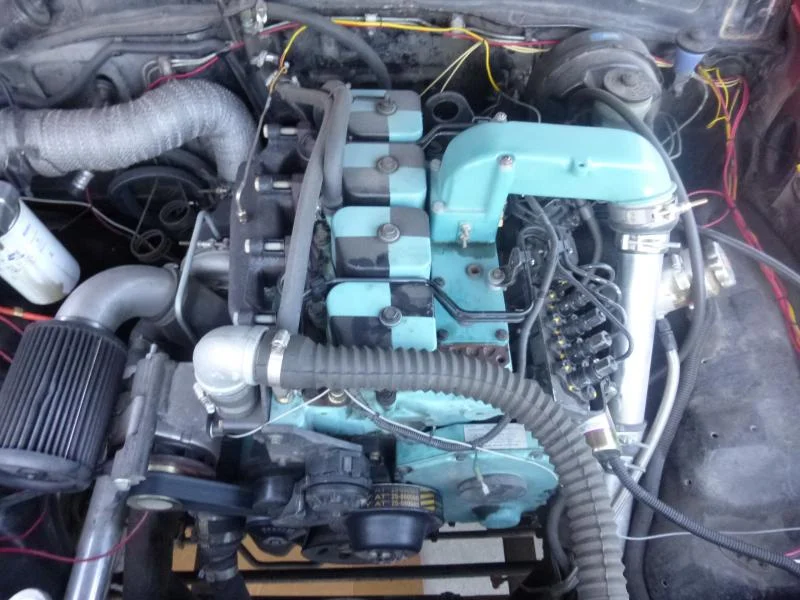

I recently bought Wyoming’s rig and picked it up today and drove it home… It is a ’87 FJ60 w/ Cummins 4BT, Ranger splitter, H55F and 4.56 gears. There is some work that needs done ASAP and I will address it as soon as possible. Once my shop is available again that is…. Still repairing all the flood damage in the house. So… my shop has ALL our belongings in it right now…. (STATE FARM IS A POS INSURANCE COMPANY BTW for house issues and our adjuster… well… GET A ROPE!!)
The 218 mile trip home yielded these numbers
1) 108miles , 4.74 gallons = 22.8mpg (mountain passes, 55-70 mph)
2) 110miles , 4.56 gallons = 24.1mpg (flat run, rolling hills 65-93… mph..) Yes, I had an open strip and opened it up... I backed off, Goss had more in the pedal.. Ran it in double OD the entire trip..

ANYHOW, without further ado… Please meet Gossamer.. “ The Red Monster”.

I like it J! It is a great start and a much better start than Marley was. 4BTs get a bad rap for the sound, but they are good engines. When I had mine, there was a lot of sound deadening which is critical in these. I could actually have a normal conversation without yelling inside. Ping Dave on his air cooler, that brings down the EGTs a lot faster. Dont forget some gauges too. You ARE going to paint that engine right , HAHA. 93? wow, I cant imagine.

It has an intercooler and gauges already. On the trip back the motor temp never got over 180 and the EGT was between 500-900 (flat land) and 800-1100 (long mountain pass in double OD) the entire trip. I'm good with those numbers...:) I don't think its loud inside at all.. I will however add deadener and foil covered jute padding when I replace the carpet as I always do. The :princess: said it was much louder outside than in... and we held a conversation without yelling.
I backed off of the pedal... I would have easily run over 100mph... once I get different gears/tires to lower the RPM at high MPH and a rear sway bar in there... AND SHOCKS... rig is leaf spring ONLY .....

What kind of highway RPMs did you see in double lock down overdrive, or whatever it is you truckers call it? ;) :cheers: :beer:
Congrats J, good to have you back sir! Awesome starting point man :subscribed with a :popcorn: thrown in:
Thanks Danny, good to be back. At 75mph I was running around 2300rpm.. that's with a .62:1 final drive ratio in double OD with 4.56s and 35s.
