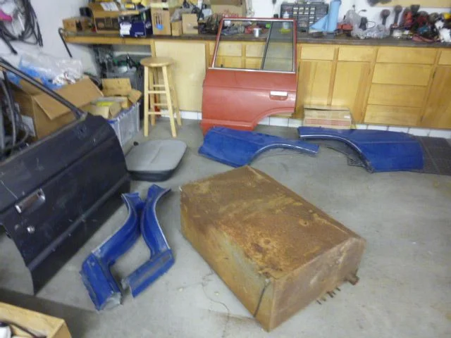

Picked up my pallet of doors, quarter, rocker and dog leg patch panels, long range tank (good re-work template, gonna have to open this up to investigate the inner maze of mayhem...;)) and a seat cushion for the PS to DS swap.

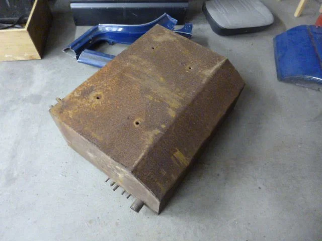

That's a big tank! I bet you could get nearly 1000 miles with that much fuel.
What are the holes in the bottom for?
I'll pull the measurements tomorrow and get a "gallons" quantity.. If it is indeed a 38 gallon @ my flatland MPG avg..... 942 miles to the tank... SO, (1) make it bigger to get to 1000 miles, (2) change gears, or (3) BOTH... I like (3) personally.. :meh:
Holes are "all the way" through pipes to run all thread through and then bolt to the floor.. LEAK WAITING TO HAPPEN IMO...Ill delete those and add angle iron for mounting.

Well couldn't wait... HOLY @#&!!!! this tank is 48.5 gallons....I checked the calculations twice..
48.5 gallons x 24.8mpg (best so far) = 1202 miles to a tank..... Even if I drop to my worst mpg yet (22.1) that's 1071 miles per tank.. :grinpimp:
AT just shy of $200.00 to fill up.. HA!
I may cut this down a couple inches, but I really don't need to. If I keep it as is, I will build a tank skid plate.

That's some serious range...no need for jerry's or rotopax I guess:steer::grinpimp:
with that much range, you need a bladder device :)
That's a huge tank! Full of diesel it would weigh around 350 pounds!!! Might need to beef up those rear springs too :)
I think Goss is gonna be a wee bit heavier than Marley was :D
Yeah, but I will build a rack on the rear bumper for my 3 cans and BBQ pit again.. :grinpimp:
Funnel with a hose run through the floor board!:lol:
Not sure, I plan on thinner metal for the armor this time around ( 1/4" and 5/16" was a tad overkill, but its what I had laying around.. Rear springs are heavy plus already. I'll hold off on those until I have the rig completely outfitted with Charlie the cruiser dog in back.

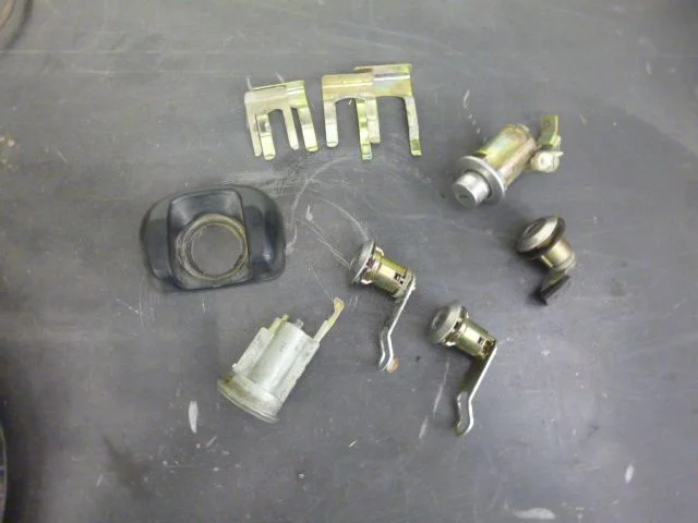

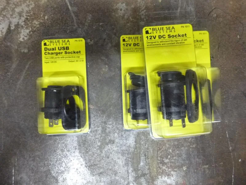

Got a new set of locks that are in like new operating condition and my Blue Sea accessories are starting to show up...

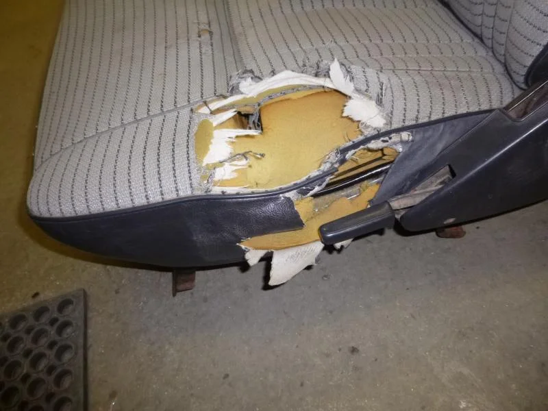

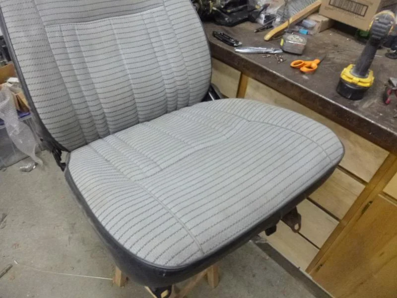

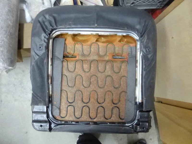

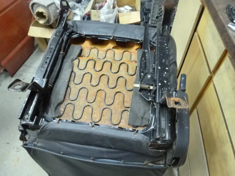

Woohoo, they actually had hog ring pliers and the rings..

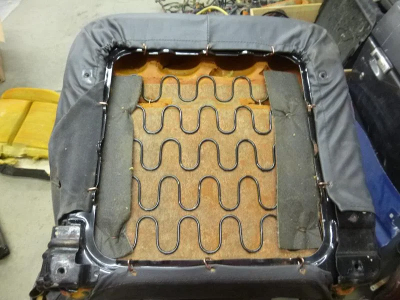

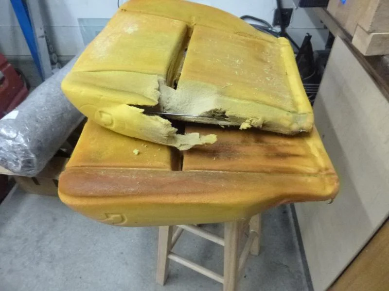

The old DS seat cushion was destroyed. This was a quick 1.5 hour project. I added some of the jute padding underneath to help pad my big ole butt..
Here are a few pics..
Old cushion

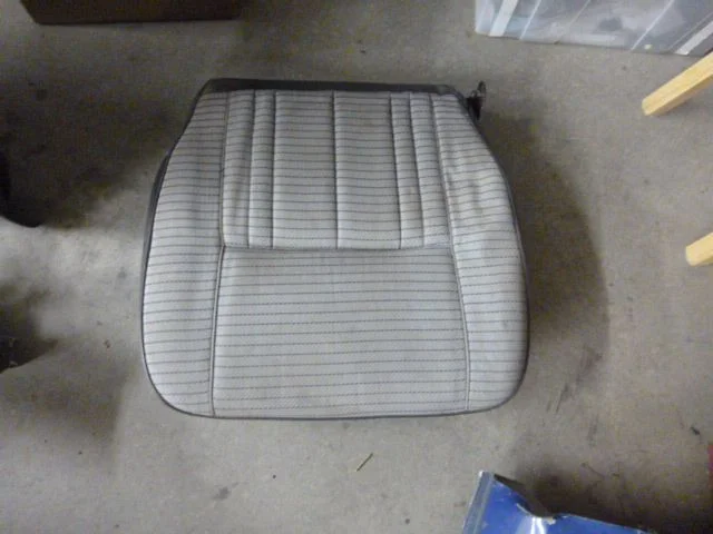

Donor seat cushion and pad
Old vs donor

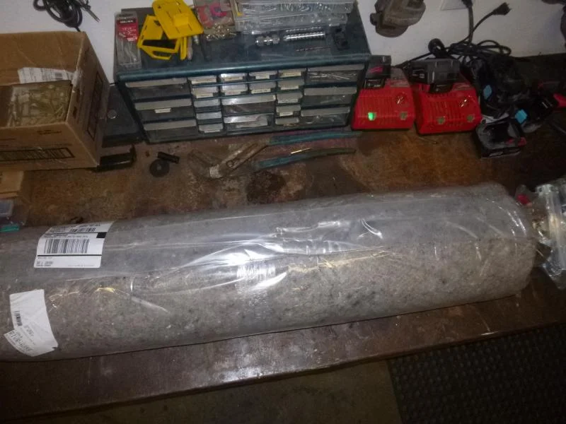

1/2" (400z) jute pad cut (about 1/2" overlap around the perimeter)
J
