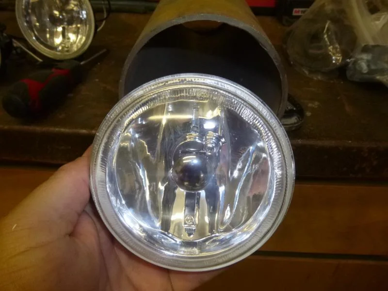

Got the 4" lights and they are going to work perfect with some 4" sch 10 pipe. I'll french the pipe into the front and rear bumpers to house the lights. These are lexan lenses with metal housings. The Philips diamond bulbs will go in these too.
