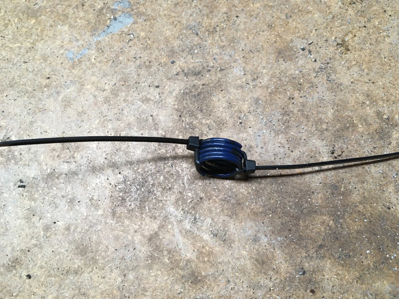

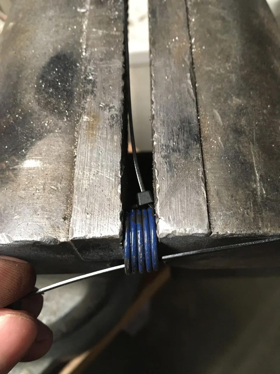

Those parking brakes can be quite frustrating, but there are a couple of things you can do to lessen the pain of reassembly. Use small zip ties to keep the shoe hold-down springs compressed while you get the pins and spring cups in place. Also, if you don't have a decent hooked pick for reinstalling the tensioner springs I would highly recommend buying one before proceeding. Makes the job so much easier.

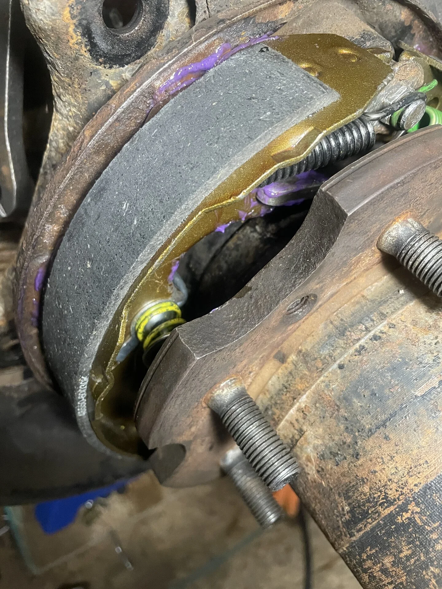

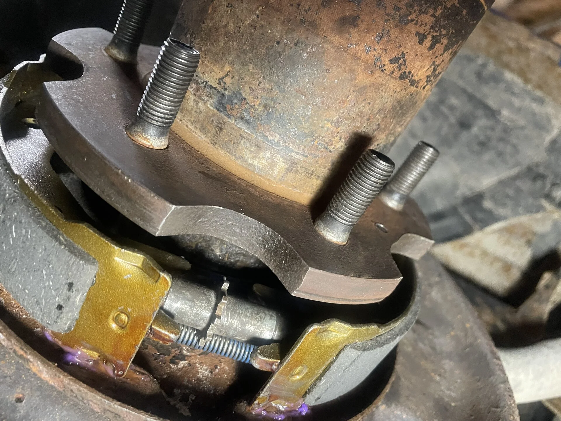

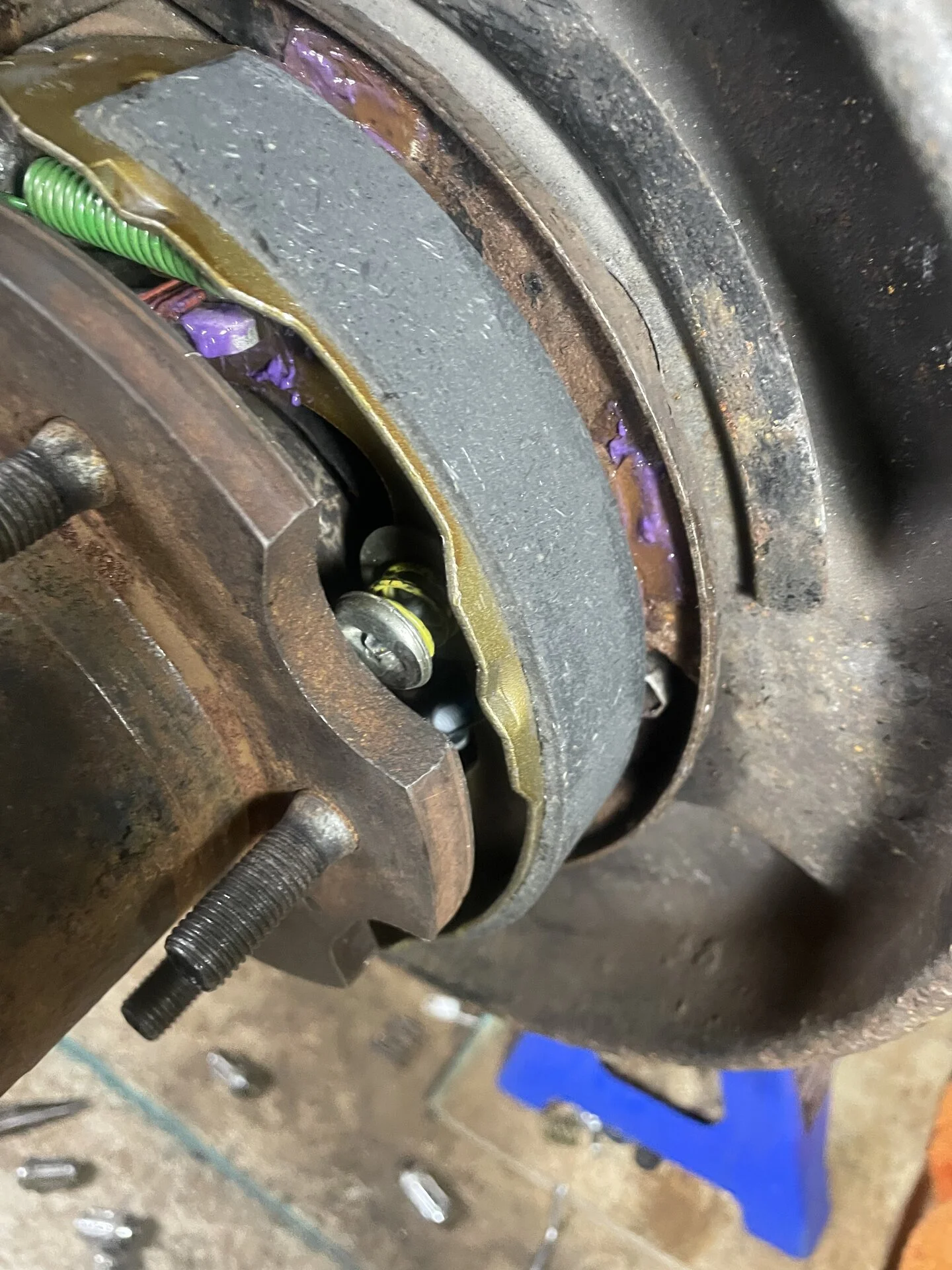

I finished reassembly of the parking brake for the second time 😳
It only took two hours to reinstall the front facing shoes and hardware on both sides. I did not need to do the rears as they are ok. The drivers side went pretty good but passenger side was a little more problematic as I’m working “left handed”. Only two screams of frustration. I’m obviously getting better at it as I did not shred my fingers up this time.
Front shoes with the crooked pin:
All assembled and ready to go!
I did a quick adjustment and test and everything seems in good order. Will do a more thorough test today.
For the parking brake hardware kit, I used both the Raybestos H17394 and the Carlson 17394. Both are the same, so it’s dealers choice
I didn’t have any luck with after market break shoes
Put OEM on and bingo the parking brake works now.

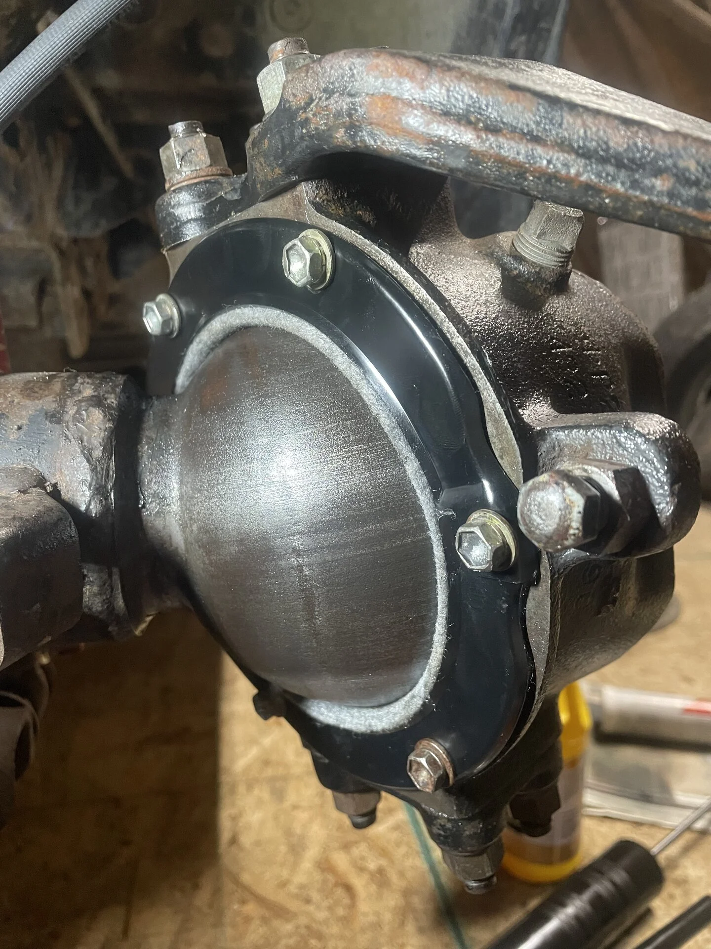

Passenger side knuckle is in.
Things are coming along!!! Just need to install the hubs, rotors and brakes!!! …. And the whole drivers side 😀
That felt gasket looks dry ? it should be coated in grease before installed.

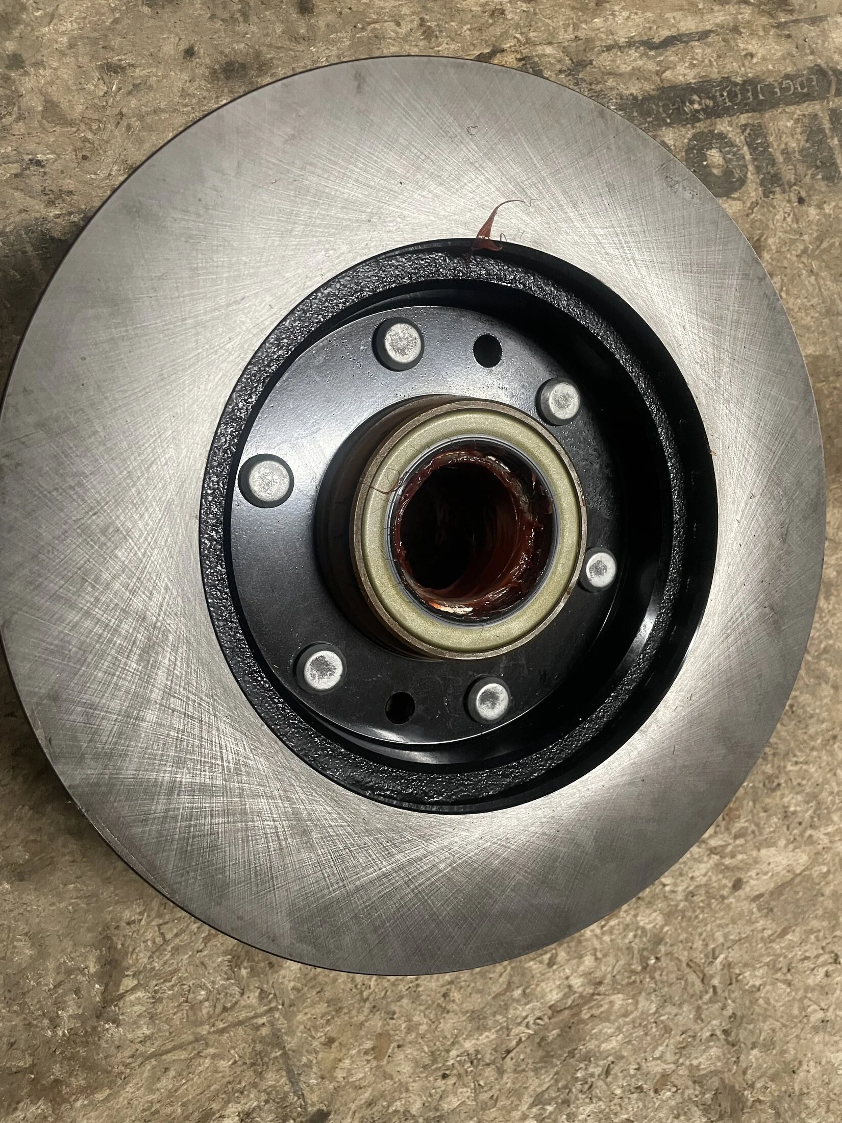

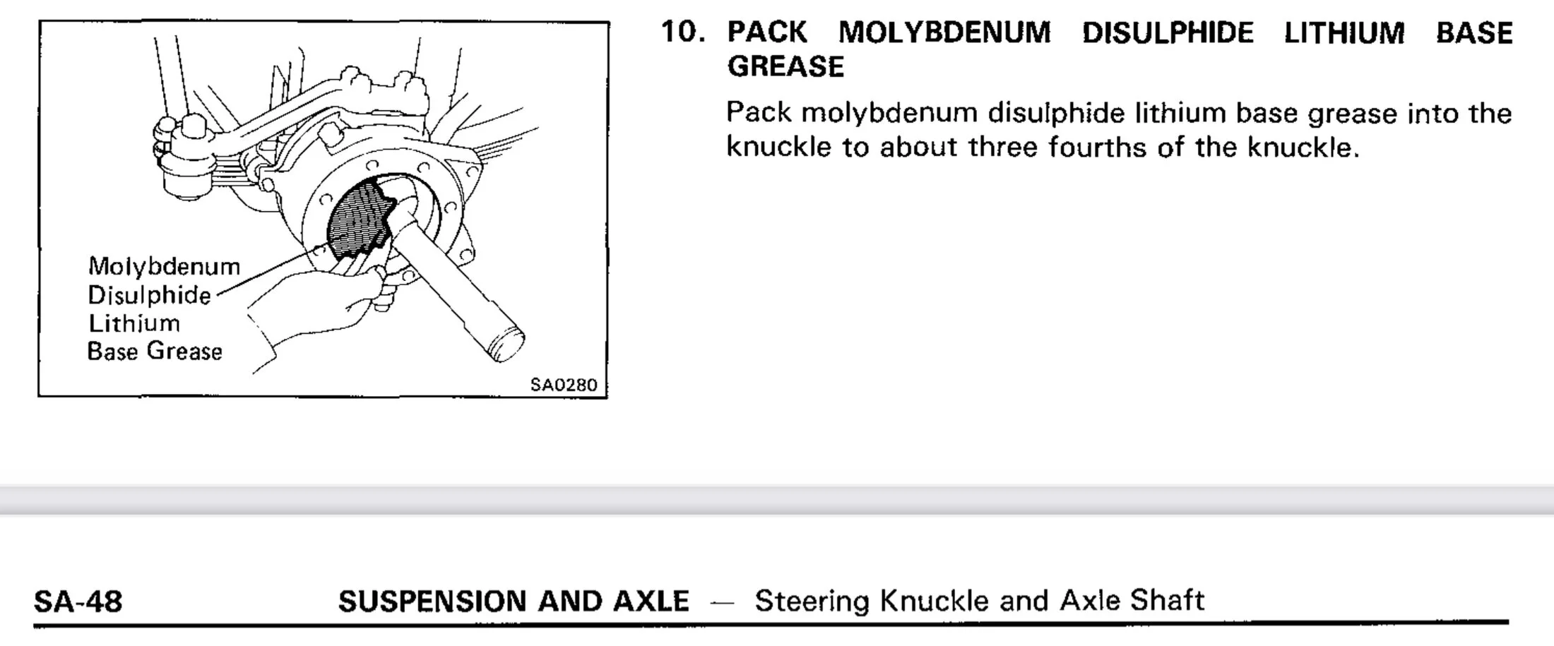

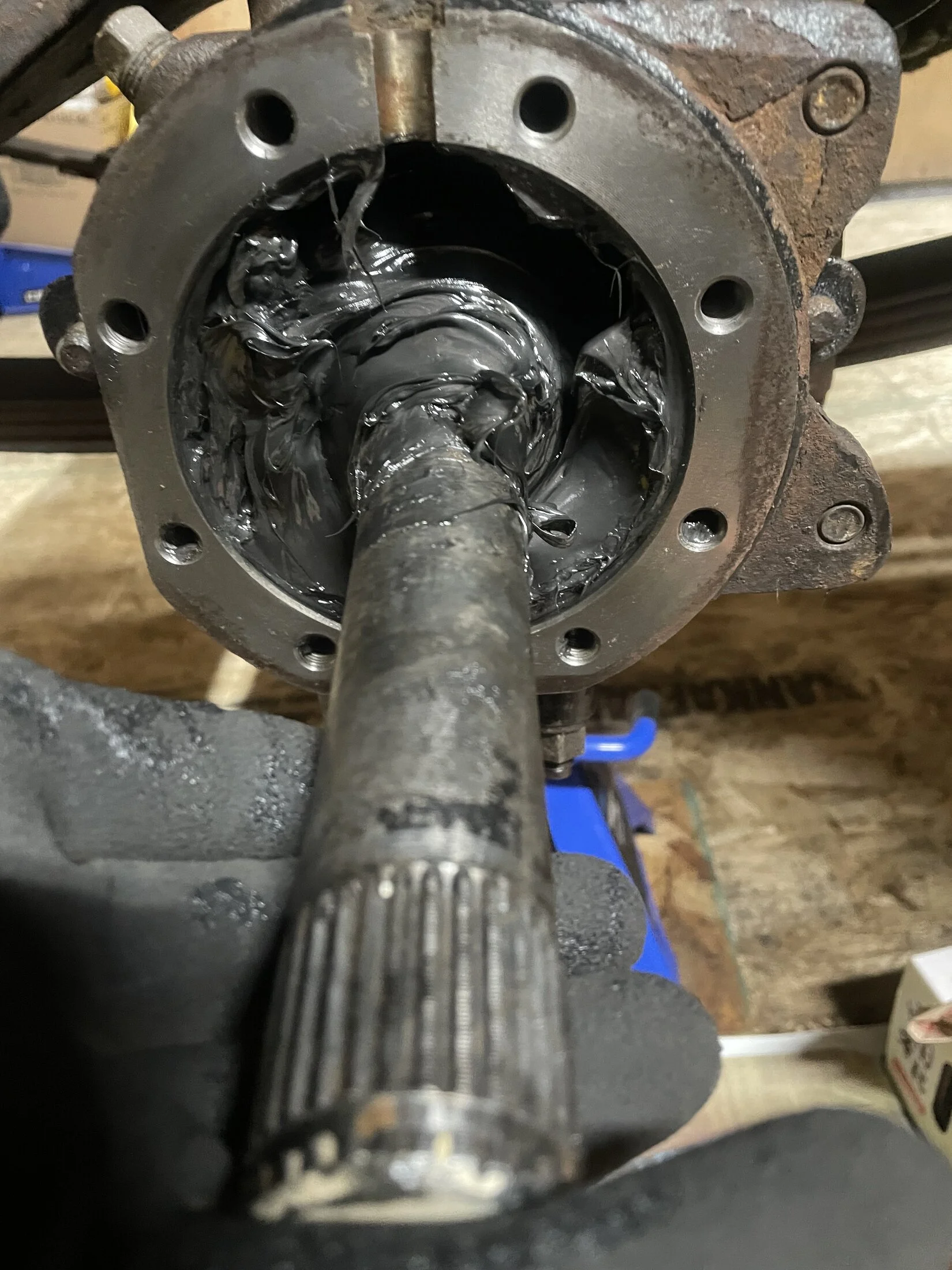

Greasing the hub is fun. I used Shell Rotella SD Moly grease to match the engine oil.
Fill 3/4 full!
A very precise eyeball measurement! About this much …

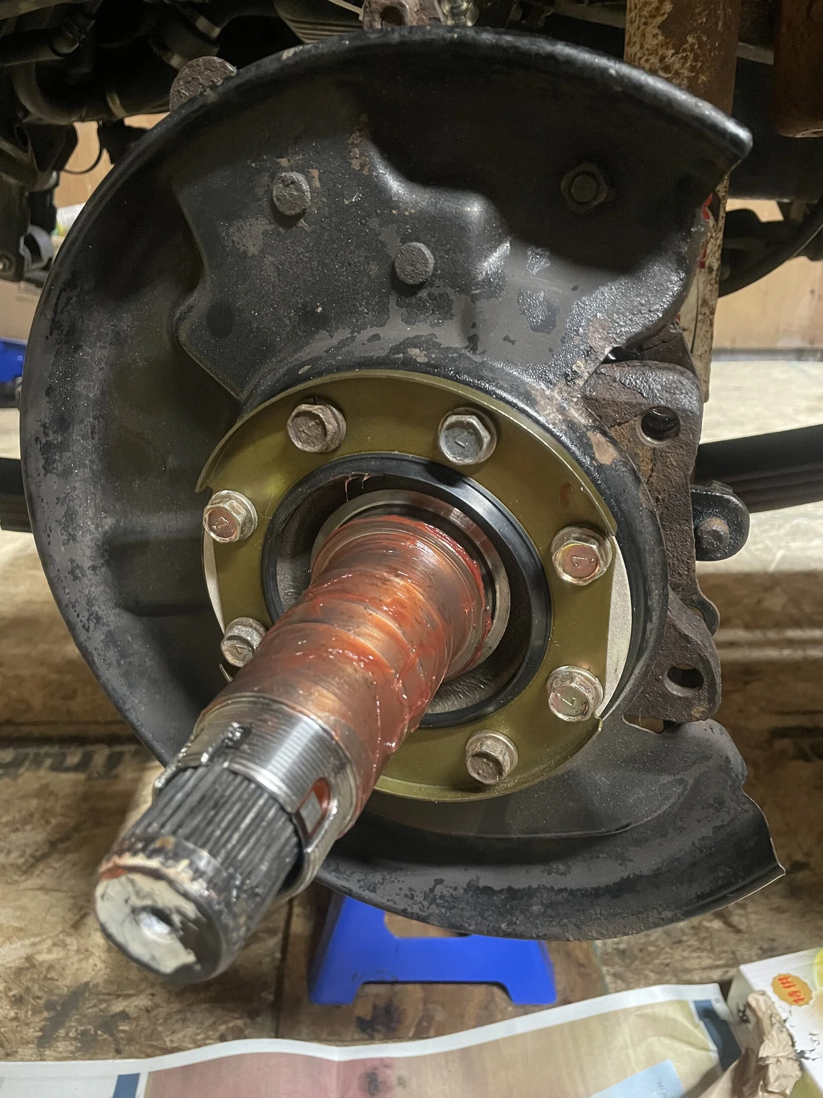

On with the backing plate and spindle.
I’m continuing the matching Shell Rotella theme with the HD wheel bearing grease for the spindle and wheel bearings.

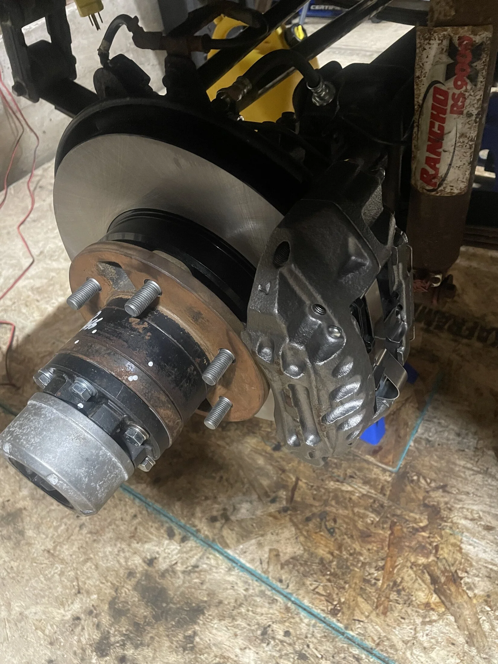

I started the hub assembly with new rotors (), wheel studs (90942-02053), bearings (I’ll fill the missing part numbers in later) and seals (outer hub seals: 90311-62003).
I started the new studs by pounding them in with a punch, then finished running them tight using the stud nuts and the electric impact gun.
The hub is on and locked and pre-loaded.

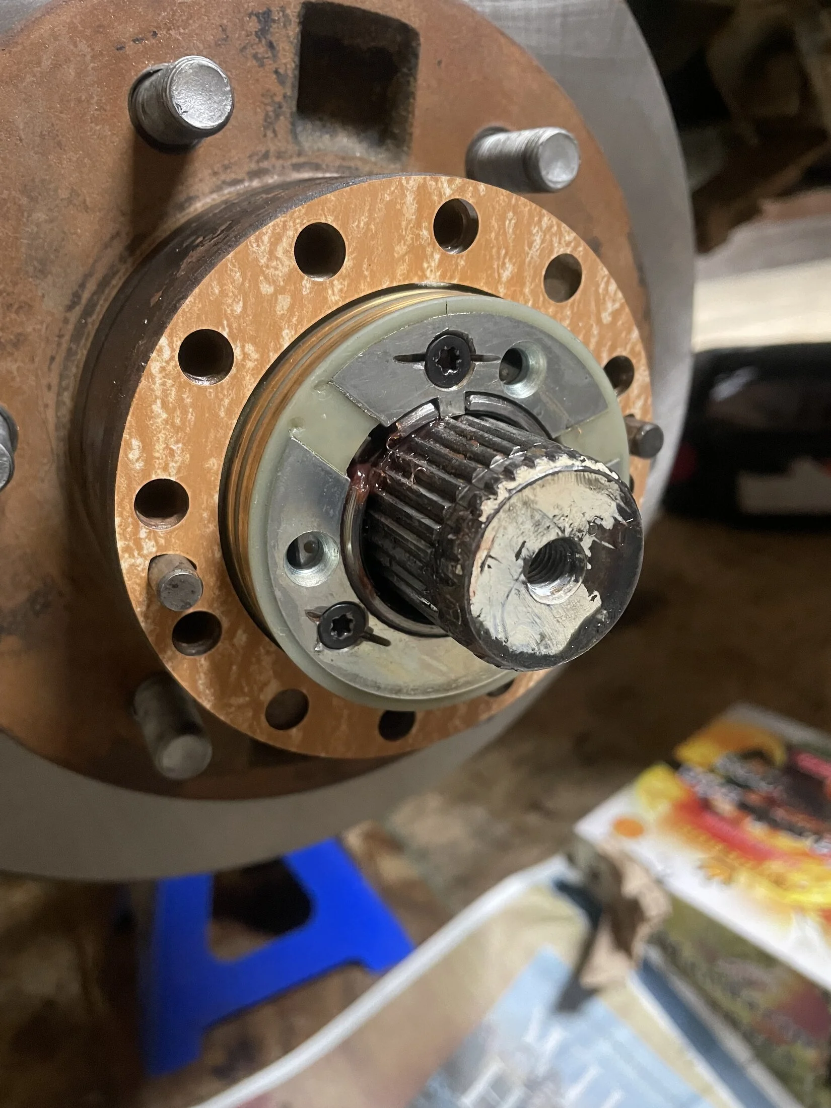

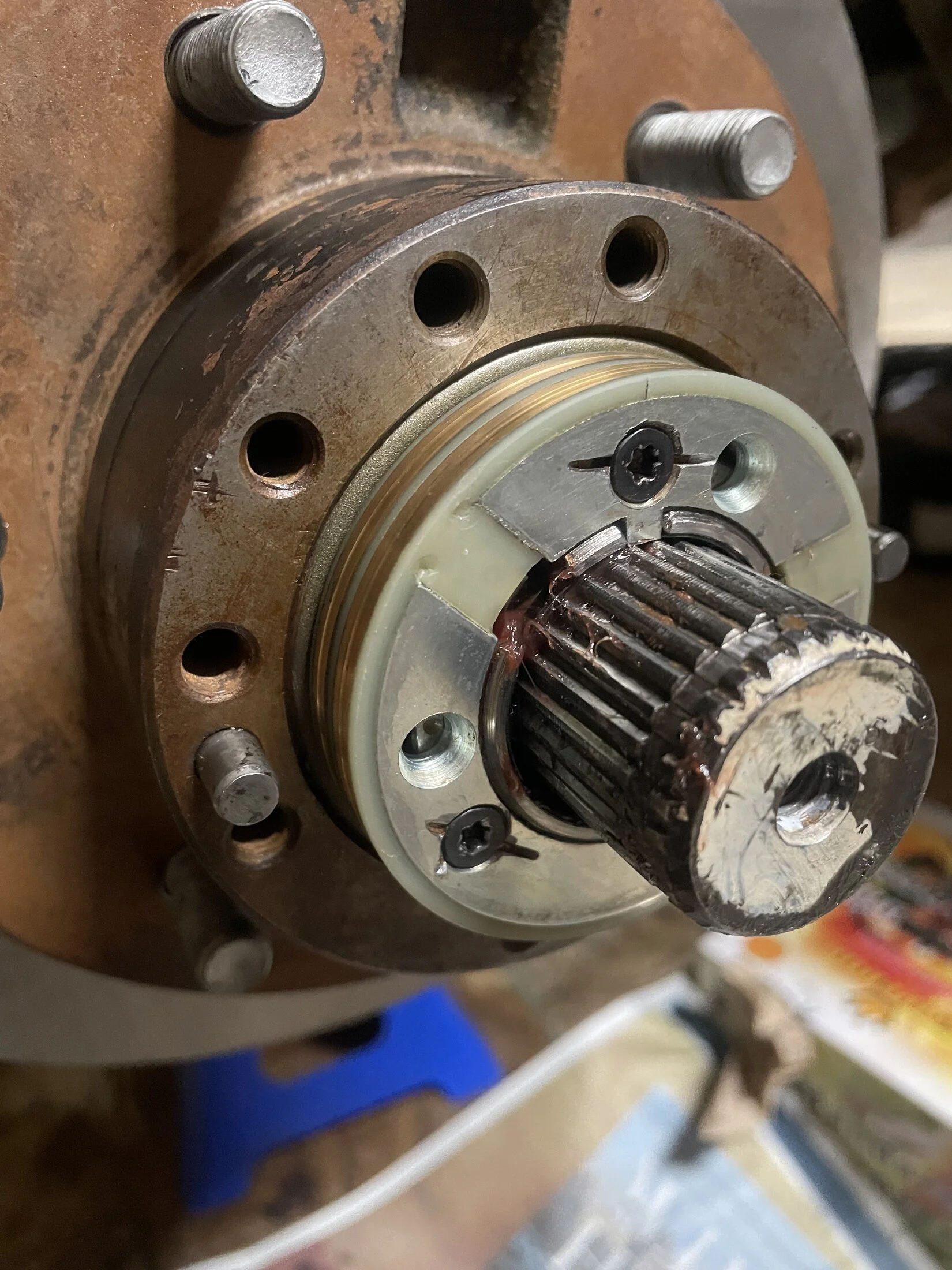

New T20 Torx screws (90149-50055)
New hub gasket ()

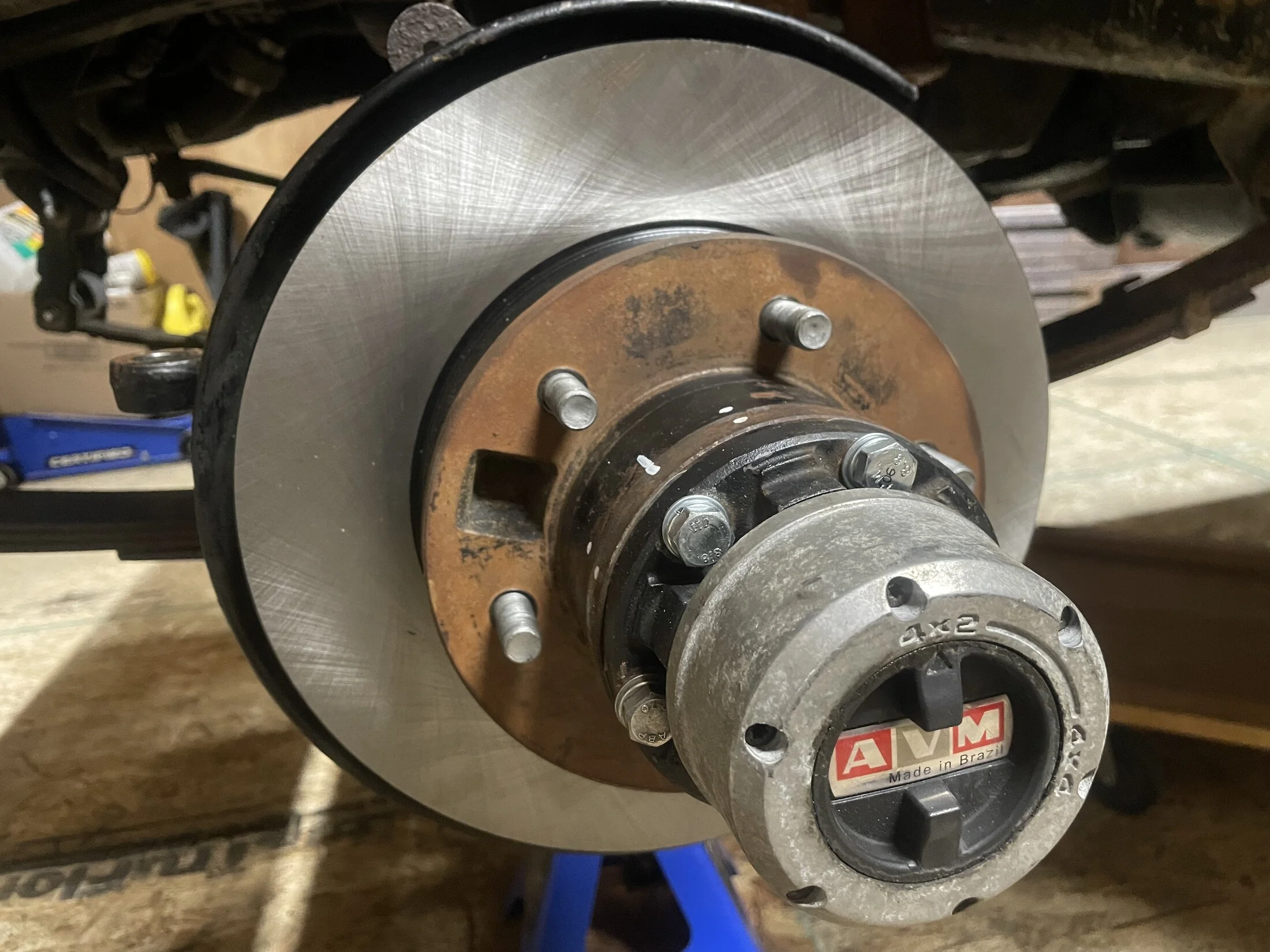

Install the spacer,as I don’t have the electronic locking hubs, and the locking hub gasket ().
Then on with the AVM locking hub.
The spacer uses 4 Allen bolts to attach it. Then the locking hub flange uses 4 M8 - 1.25 x 40mm for the deep holes and 2 M8 - 1.25 x 30mm for shallow holes. The long bolts go through the spacer into the hub. The short ones go into the spacer. The short holes are not quite 30mm deep, and since I could not get 25mm bolts I had to grind off a few threads to prevent the two bolts from bottoming out in the spacer. The current hardware are standard zinc plated bolts, washers and lock washers; I’m going to replace them with all stainless once I get to the fastener shop.

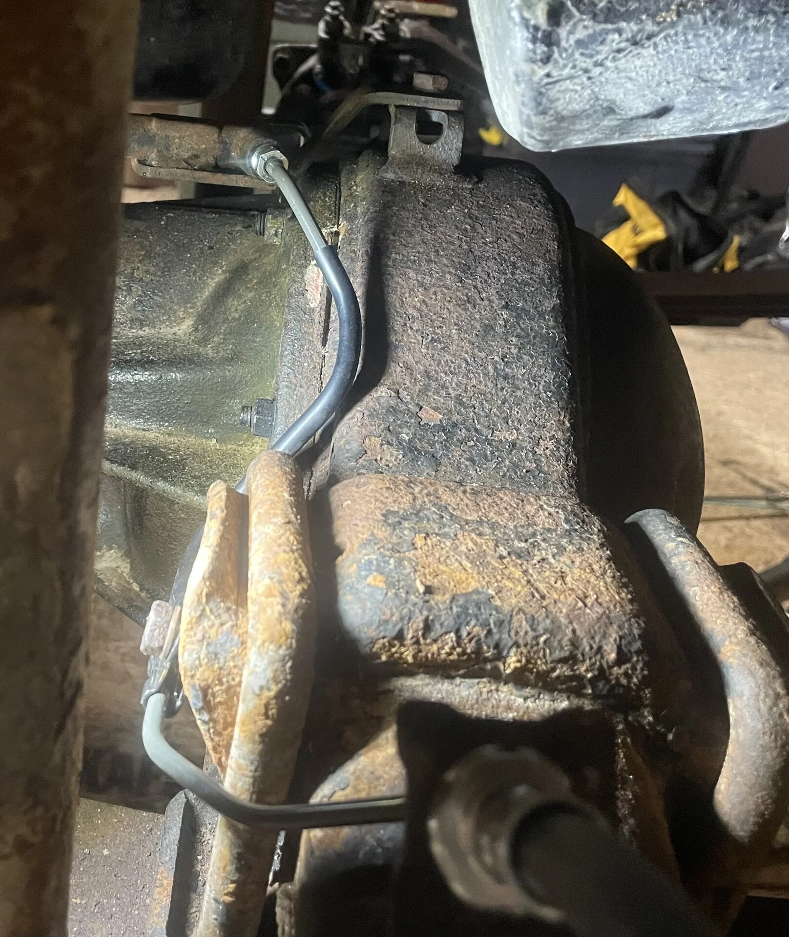

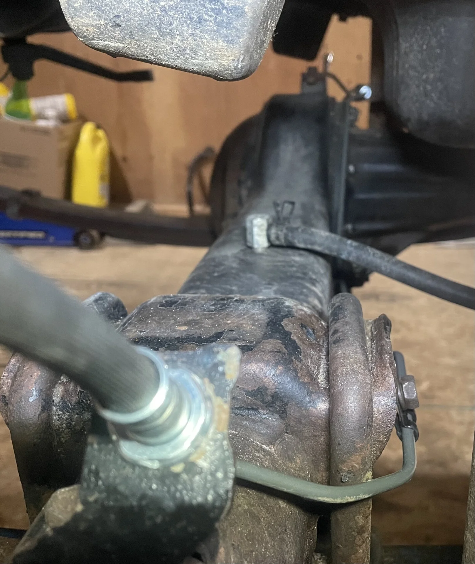

New calipers (cross referenced with ‘95 v6 4Runner. Nugeon 97-01560A and 97-01560B) pads (Advics - ‘95 v6 4Runner) and hard brake lines to the calliper (47343-60021 left, 47341-60031 right). Plus new brake bleeder screw caps (31478-30010).

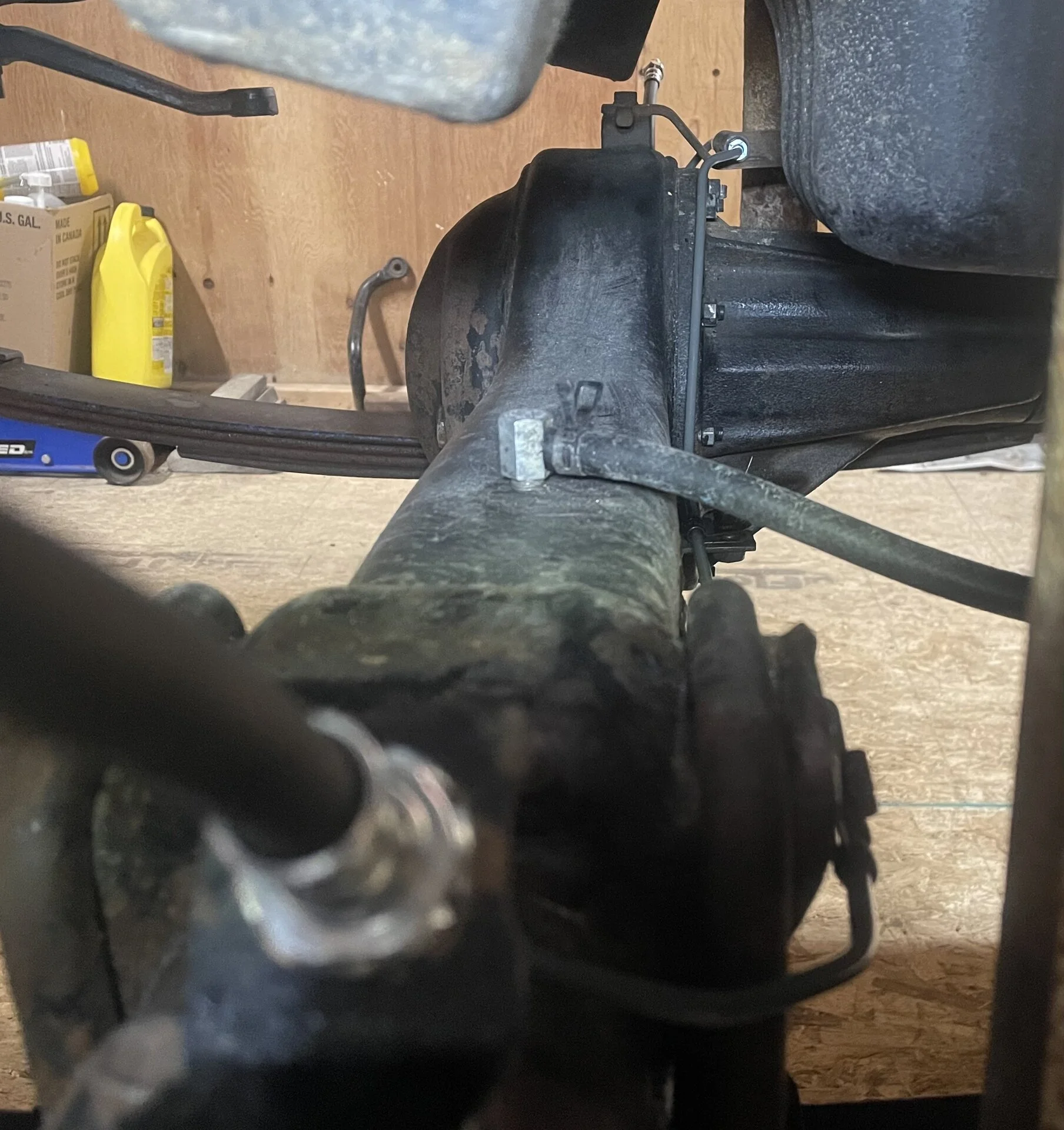

Change the fuel filter. I had to remove the fuel lines and take the entire assembly off as my strap wrench would not budge it. I used my huge water pump pliers on the bench to get it filter unscrewed from the housing. I filled the filter with fuel before assembly and pumped the primer. It started leaking fuel out of the drain petcock. FAK! Remove, check petcock and o-ring. Everything looks good, so reassemble and try again. Reprime and no leaks! YAY! Must have been a little dirt or something that was letting the fuel by. It fires right up, and the “Check Filter” light goes out. Double YAY!

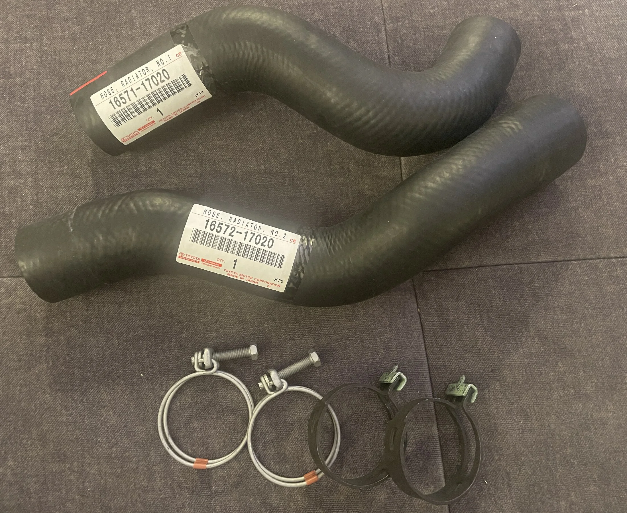

Also, a bunch of misc items for the cooling system, since it's gonna get new coolant:
Upper Rad Hose (Inlet): 16571-17020
Upper Rad Hose Clamps: 90467-42001 (on the right)
Lower Rad Hose (Outlet): 16572-17020
Lower Hose Clamps: 96111-10490 (on the left)
