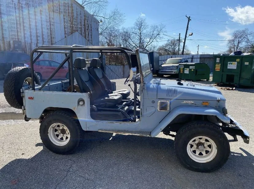

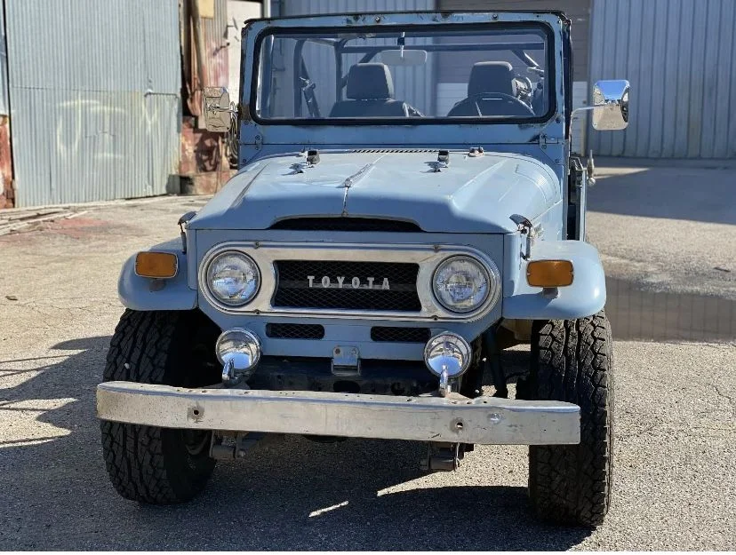

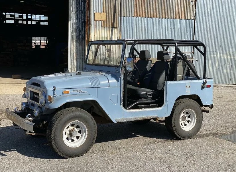

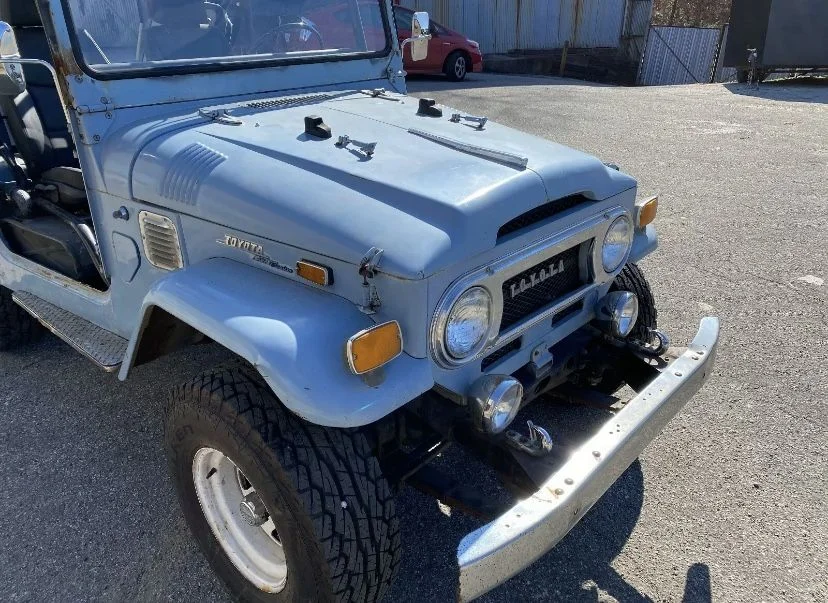

Meet Good Dog, the FJ40 or GD40 for short. I bought this sight unseen off eBay from a gentlemen in Birmingham Al, where it was last titled. I think the guy just buys/sells cars as he only owned it for a month or two.
Photos below are from the eBay ad.

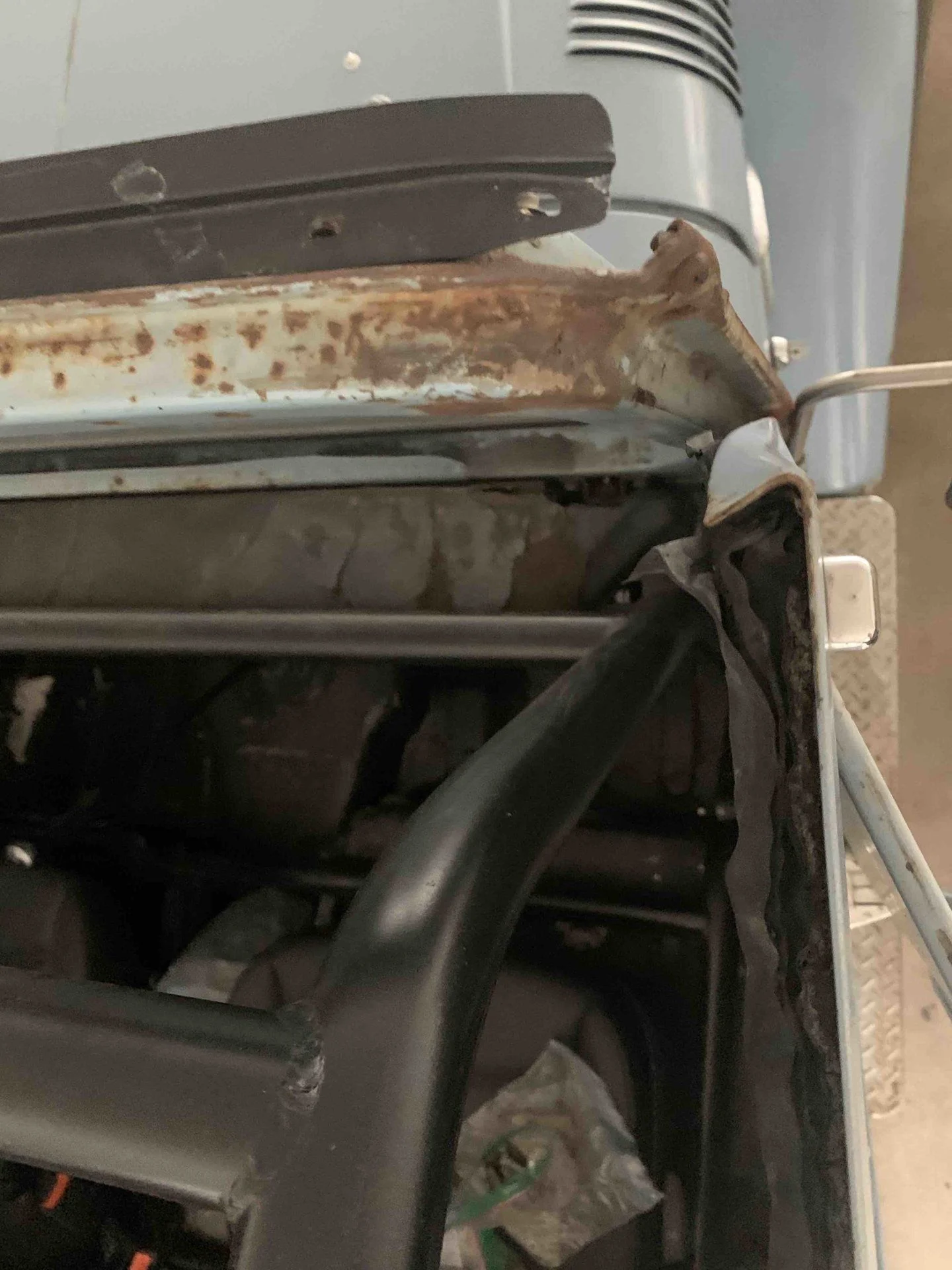

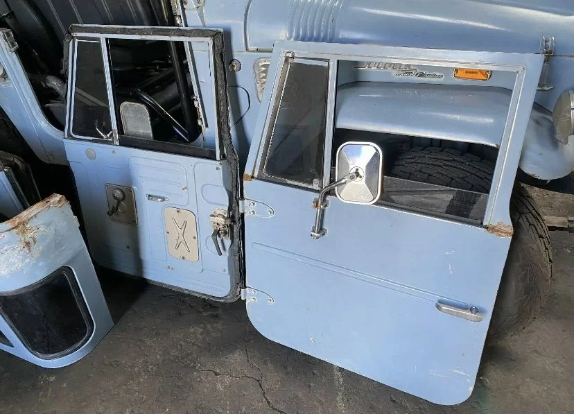

After I got the rig, I soon realized that the line "the top fell off the truck" that the previous owner fed me, was BS. During the initial walk around I started noticing dents in certain locations, cracks on the doors, one of the doors has been bent into the cabin, cracks in the rear end where the side-to-bottom bolts were ripped out, and the missing fiberglass top. Clearly this thing was rolled and apparently it freaked the previous owner out as there is a pretty nice roll cage that was installed and welded to the frame.
So, since this FJ40 knows how to roll over, it must be a...Good Dog!

Nice rig! Where in Houston are you located? I’m on the SE side near 45 and the Beltway. Also, if you’re not interested in keeping the cage let me know as I’m in the market.
It’s one with the truck now. Seats and frame all all tied together! Never seen a frame tied cage on these.
I know the MetalTech cages (which yours appears to be) can be attached to the frame. My soon to be finished rig will never be wheeled that hard though so I’m looking for a cage that attaches in the normal locations.

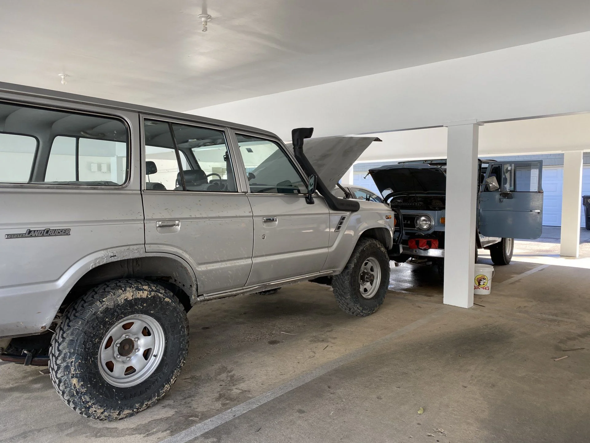

1. Weather proof it. GD is currently taking my wife parking spot and I won't get hear the end until she can use her spot again.

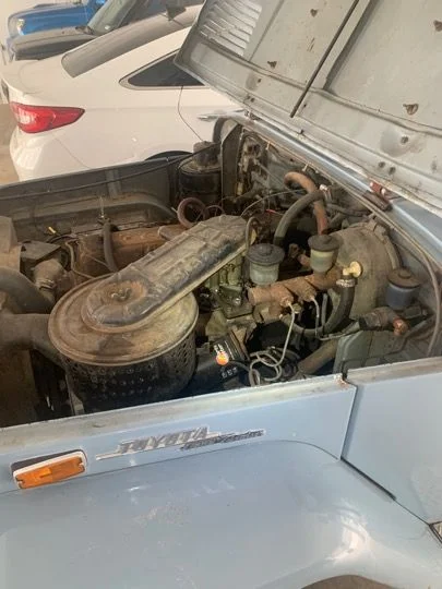

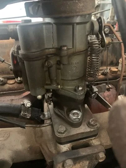

- What's going on with my carb?
- Need to replace pretty much all the rubber...everywhere.
- Does anyone make a gas peddle spring? Couldn't find one on sor.com
- Engine valve adjustment (listen to the videos) and new gasket. Tapping noise lessens when engine gets to temperature.

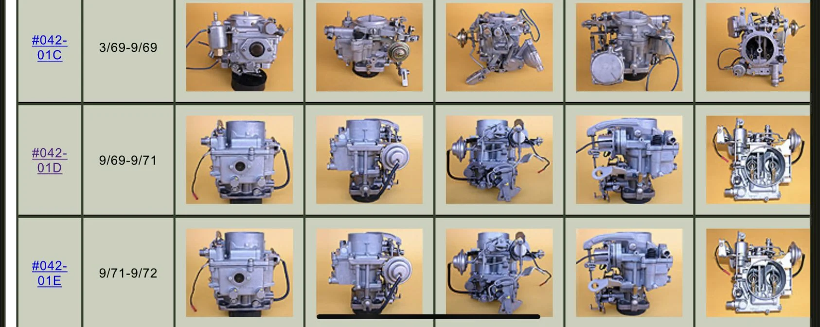

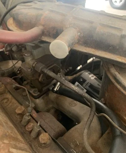

Did I read correctly CCOT has new fiberglass lids? That carb as you probably figured is an older smaller CFM and it looks cracked.
Mark's Off Road in Burbank, CA will have a two barrel Aisan 71 carb if you want to stick with OEM. He mods 71 carbs so you can run a vacuum advance distributor and ditch the VSV. Mark's also can help with an electronic distributor if you don't want to mess with points.

Hammered out the bent up door with my wife hair dryer. Unfortunately, I didn't get it hot enough (or the paint was just too old) and the paint cracked. But the door is straight now.
