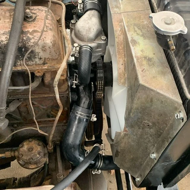

Cleaned up the thermostate housing, corrosion really didn’t look that bad so I’m going to run with it. New thermostat, water pump, gaskets, hoses and plastic fan. Man those OME hose clamps are beautiful. Fan (and most components) was a replacement from @Racer65. As near as I can tell, I have had no issues with the fan in my ~69 block and 71 chassis. Replaced fasteners with that shines new bling. Reused the old fan spacers.
I’ll direct your attention to theground below the fan shroud in the image above.
That moment I realized what I have done:
Time to take it all apart...again...

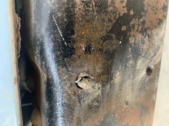

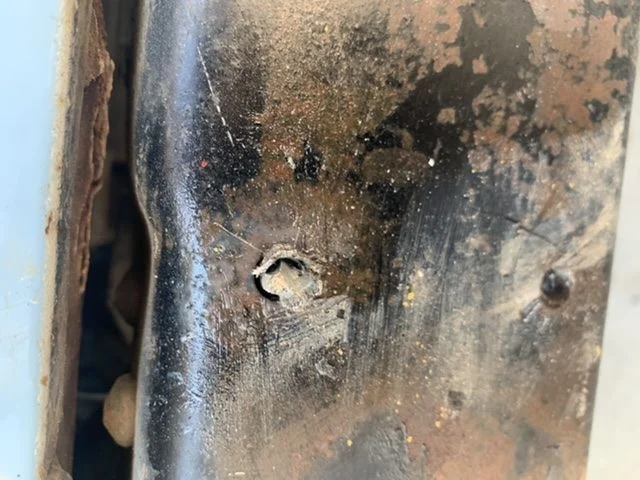

1. I figured out why my thread tapping handle failed. It was to prevent what happened. Ended up breaking the thread tap bit in the the back bumper. Still stuck, and haven't figured out how to get it out. Sprayed it with wool wax to prevent it from rusting in, and will figure it out later.

I’ll give you one guess why that tap broke. Because the metal is so hard it’s brittle. So take a hammer and a punch and hit it from different angles and chip it out of there. Got it all out? Tap it again. Carefully.

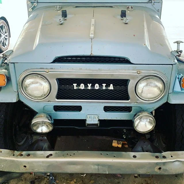

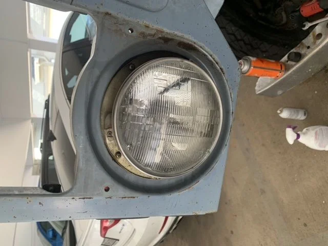

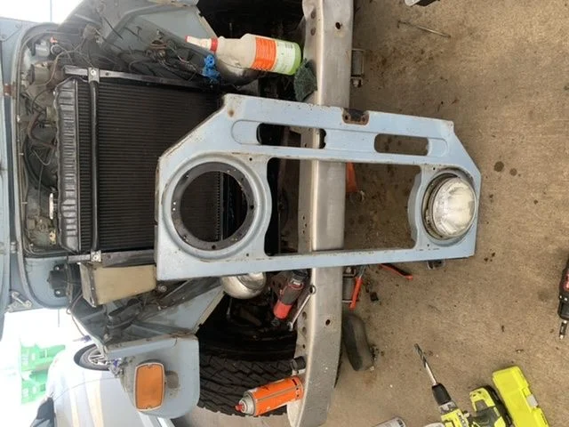

Everything is slower when you have to clean and remove rust as you go. At least I’m not painting everything. Cleaned up the front grill, lights, and bezel, then woolwaxed the interior.
I can’t stress this enough, clean your bolts before you try to take things apart. And use penetrating o
Buttoned everything up. With the fog light as it is, it looks a big special... probably have to take it apart again.
@fjc-man I had successfully blocked the broken bolt saga from my mind.
I got it out eventually. Tore up some vice grips and the tap didn’t even move. After 10-12 hours of work with no progress, I was about to give up and get a welder, Then I end up taking a drywall drill bit to it. If you walk the drill side to side and lean on it hard, it will go through just about anything it turns out. Went through enough of the tap in about 10 minutes for it to fall out.

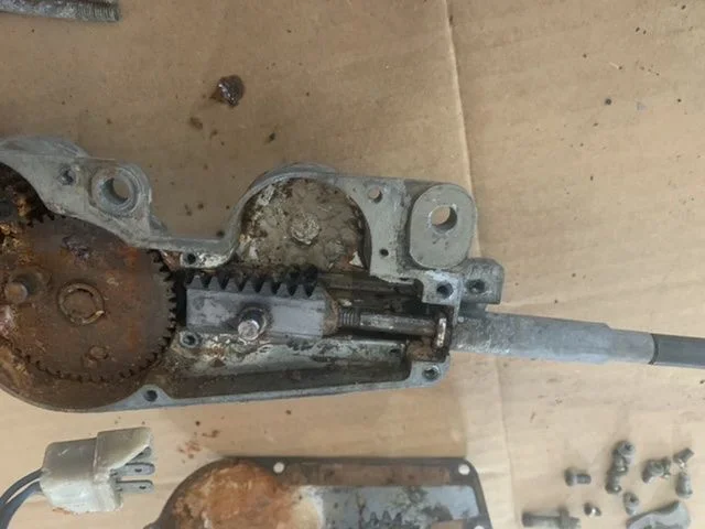

Just realized I didn’t post the wiper motor rebuild. The grease and gears had seized up with rust and age. @40channel’s YouTube videos were super helpful. Forgot to take photos of it cleaned up (doh!). But clr, brake cleaner, and new grease got things moving again. Need to find a new 4pin electrical connection and redo the wires, but that’s for another day.

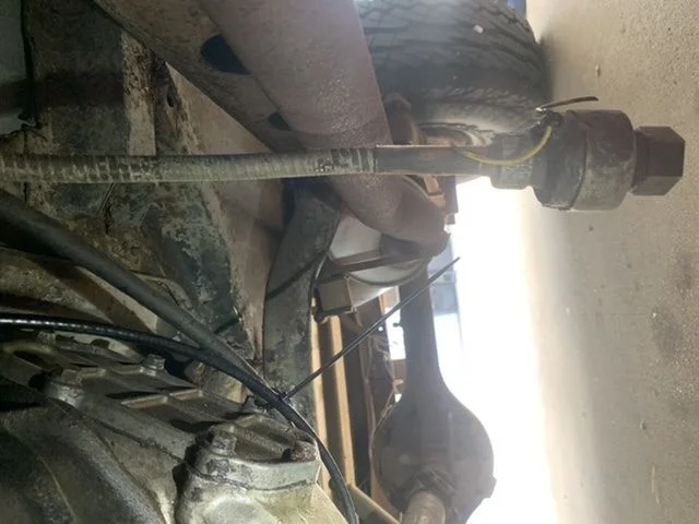

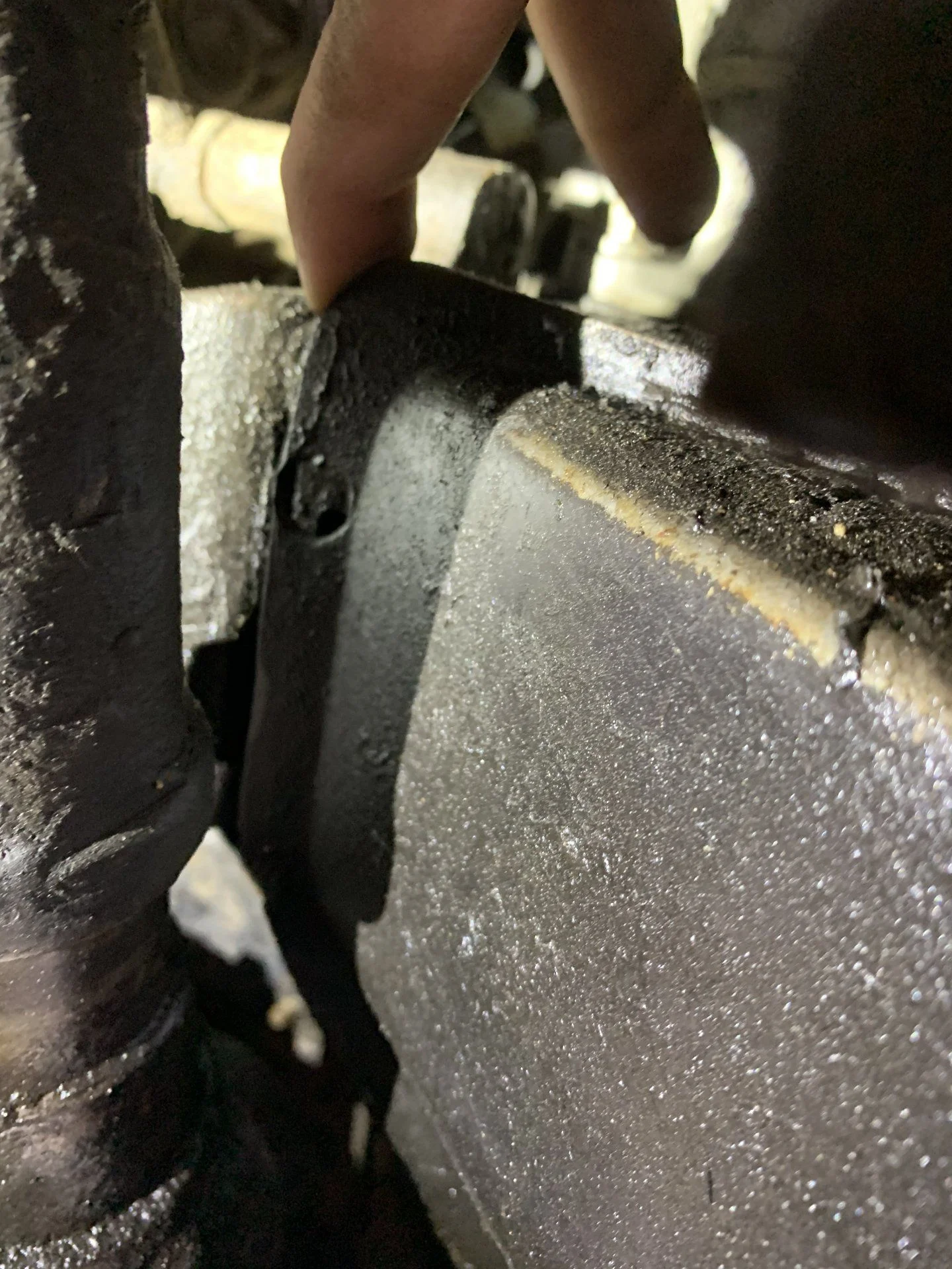

Did a little spelunking the other day and realized the speedomarker to transfer case unit that I thought I was missing had been jammed up into the frame, so that was sweet!
Also had a quick panic attack when I saw missing bolts and a gap.Thankfully it was just a dust cover and not a big deal.

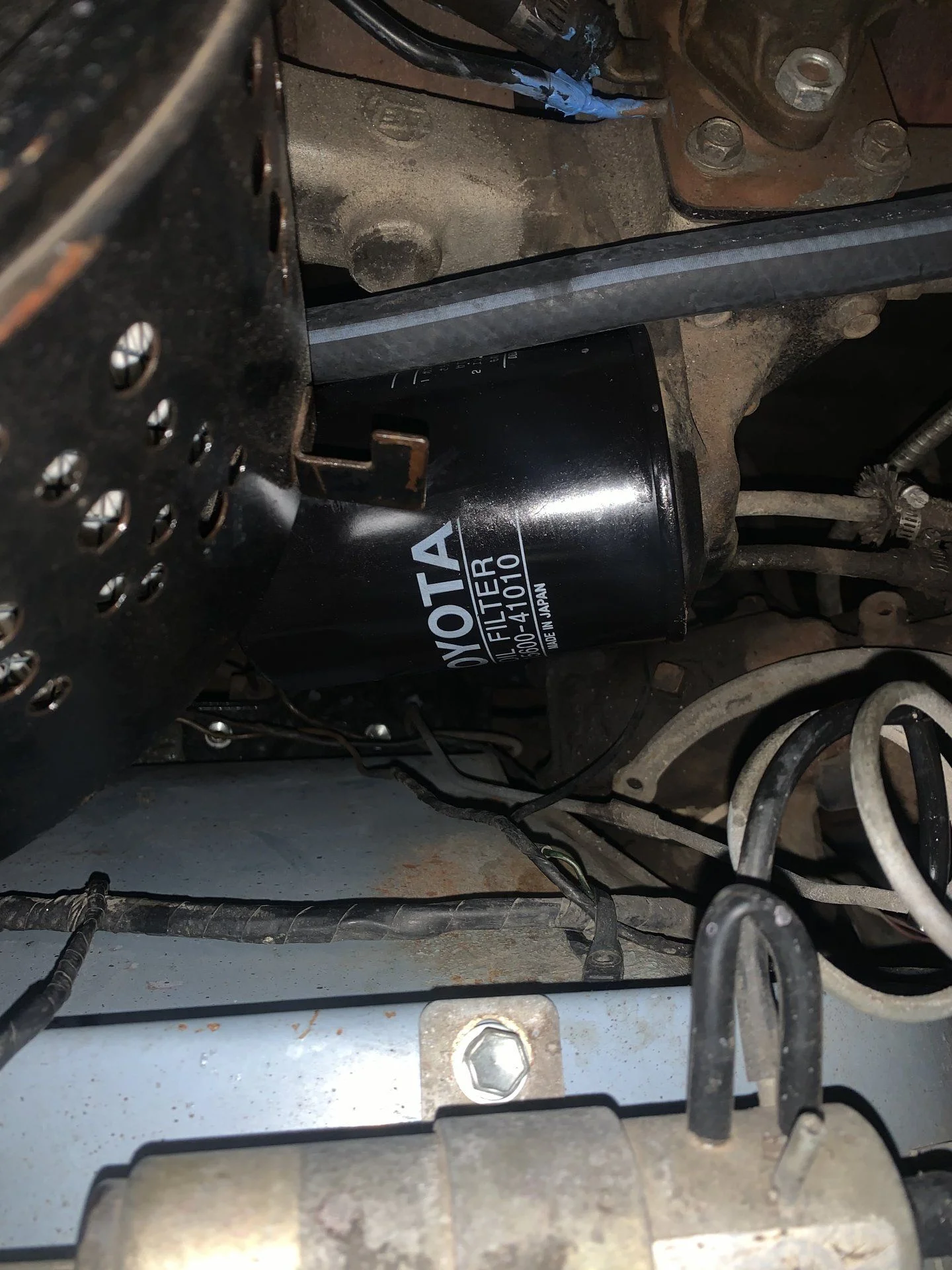

Re-tubed the heater tubing to bypass the cab heater for a couple reasons. First, it was easy. Next is I Haven’t gone through the heater and don’t trust it not to spew radiator coolant all over. And lastly, I am thinking about vintage air, which would make the heater redundant. New 1-inch tubing goes in front of the engine, under the air filter, and between the oil filter and air intake manifold. Tube ended up a little cleaner that the picture, as I zip tied it to the 1/4” hardline ( fuel pump hardline maybe?).
Added a rubber shoe between the upper radiator hose, which was contacting fan shroud.
Also, changed the radiator fluid,oils filter With some of that oem goodness (👌 thanks @HemiAlex for the hookup), and oil. Used 7quarts of valvolien zr1 20w-50. Only problem is I realize I still haven’tput the thermostat back into the thermostat housing and replaced the hardware. Dumb*ss PO has 1/2inch bolts all over the place! 😡😡😡 O well, another day.

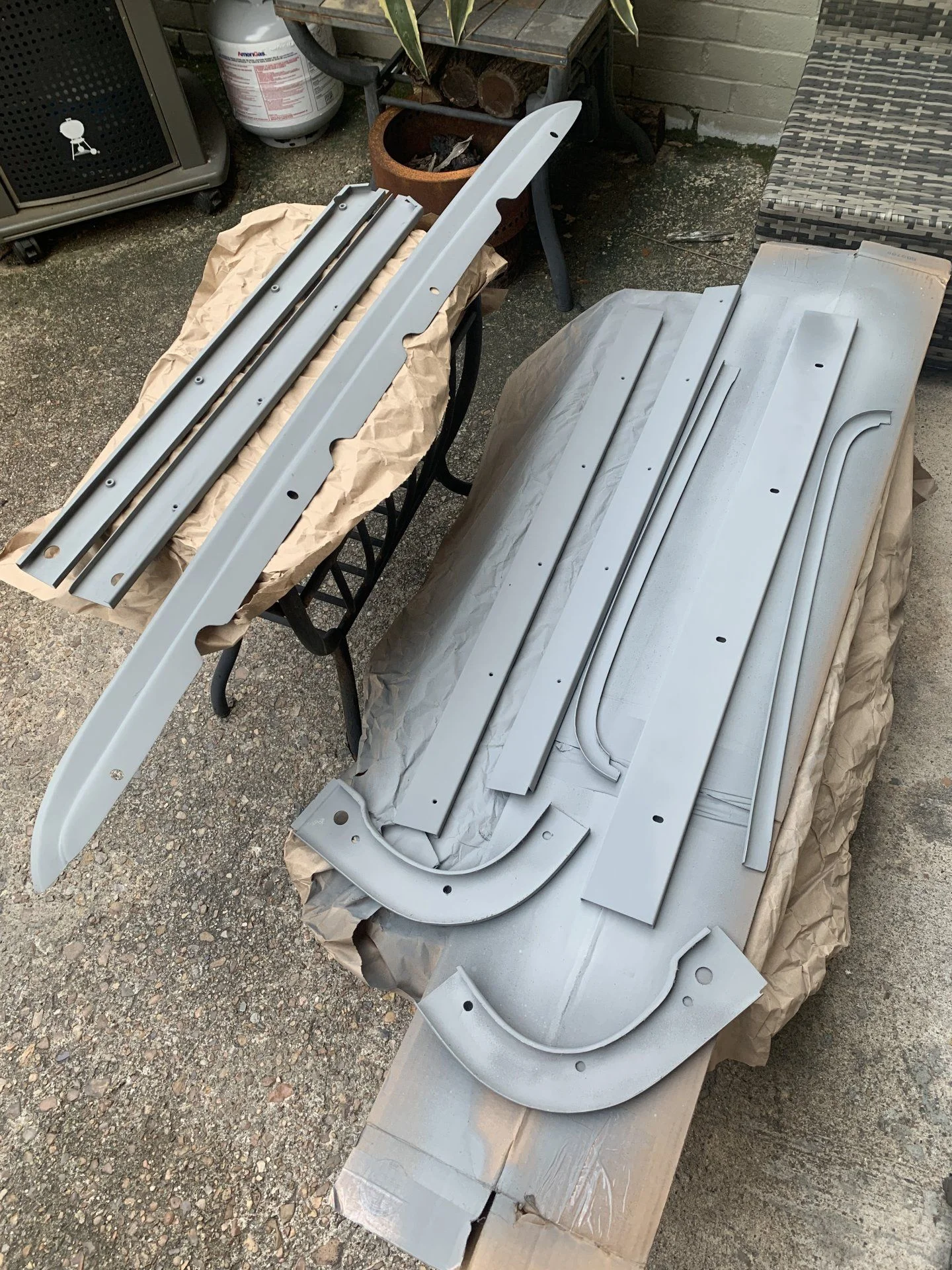

Painted the roof gutters and front roof cap gray primer to prevent rusting. This most importantly, at least for my wife, allows for storage somewhere other than my guest bedroom. Hope to mock up the gutters this weekend.

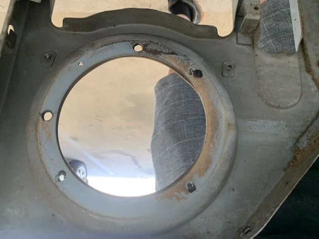

So, GD came with 2 mirrors, one on the door and one in the door pin. Got some new pins and another side mirror and installed them. Not sure which side mirror I will go with in the end, but it definitely won't be the ones in the door pins. Door pin side mirrors had threaded ends, that the PO ground down to mostly fit the door hinges. Trashed./QUOTE]
Never seen that before. Mirrors in the door hinges - what the hell.

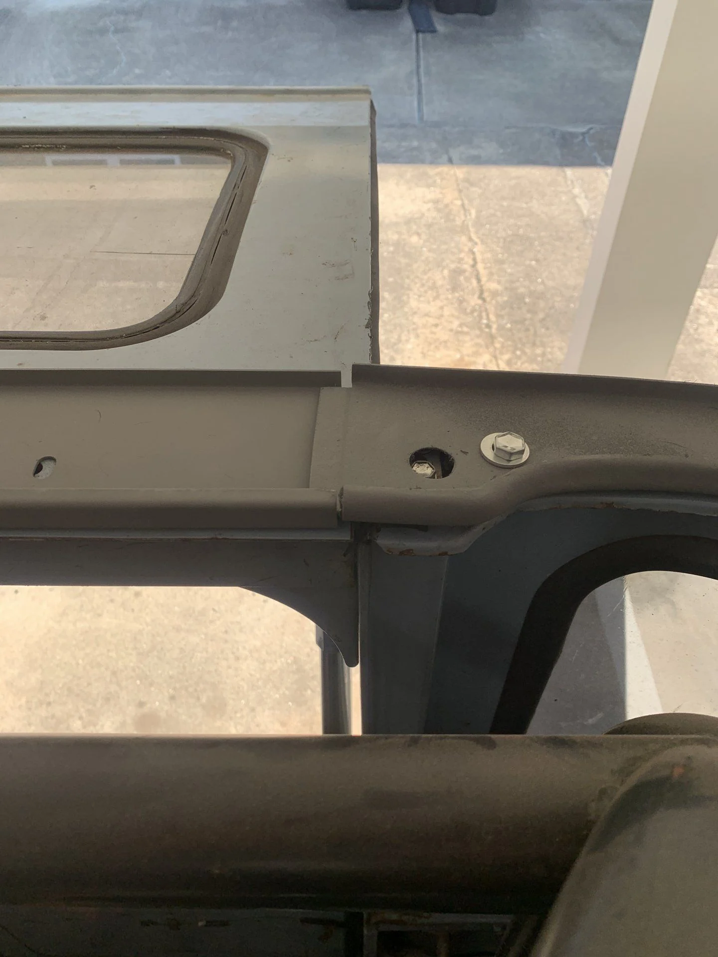

Got the rails mocked up this morning.
First thing was to clean up the tops. PO had installed a sun shade over top using self tapping sheet metal screws. :bang: Whyyyyy? So many small holes in the top of the windshield now.
Owell. I think they should work for the most part. I will have to make another hole in the rear corners, as the top most screws that hold the rear hatch cross member are obscured.

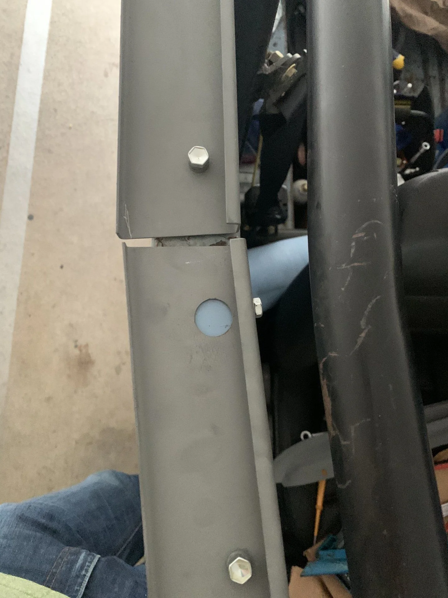

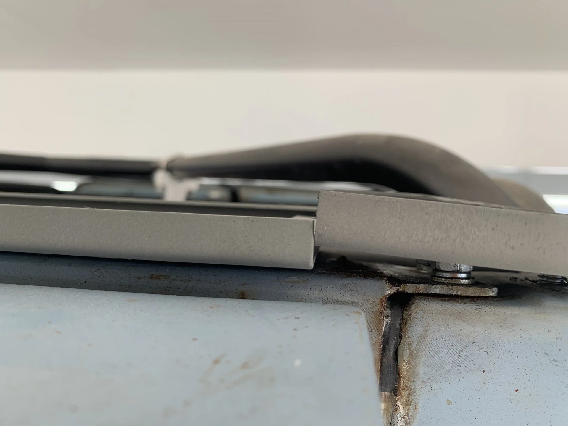

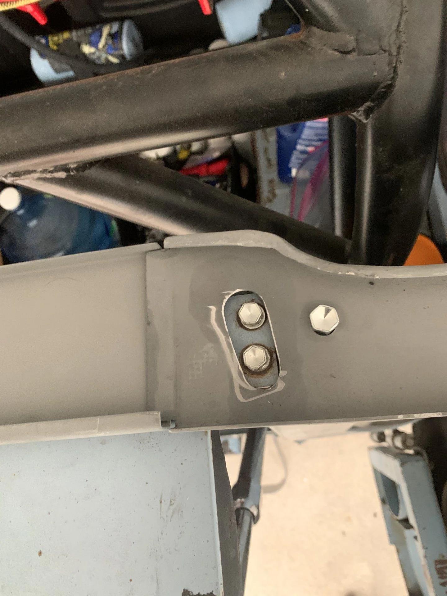

Layout was intuitive, without instruction from ccot, and easy. All except the front. Not exactly sure how to fought the front most rails.
This is the piece I am talking about. Where it connects with the side, does it lay on top or on bottom? Does it matter? Am I too paranoid?
Or

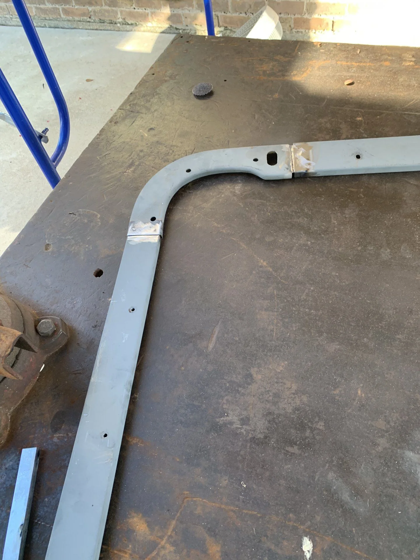

Turns out that spray can sucks to weld through. Had to grind it off. Don’t waste your money @middlecalf
made a trip to the holy land in UT.

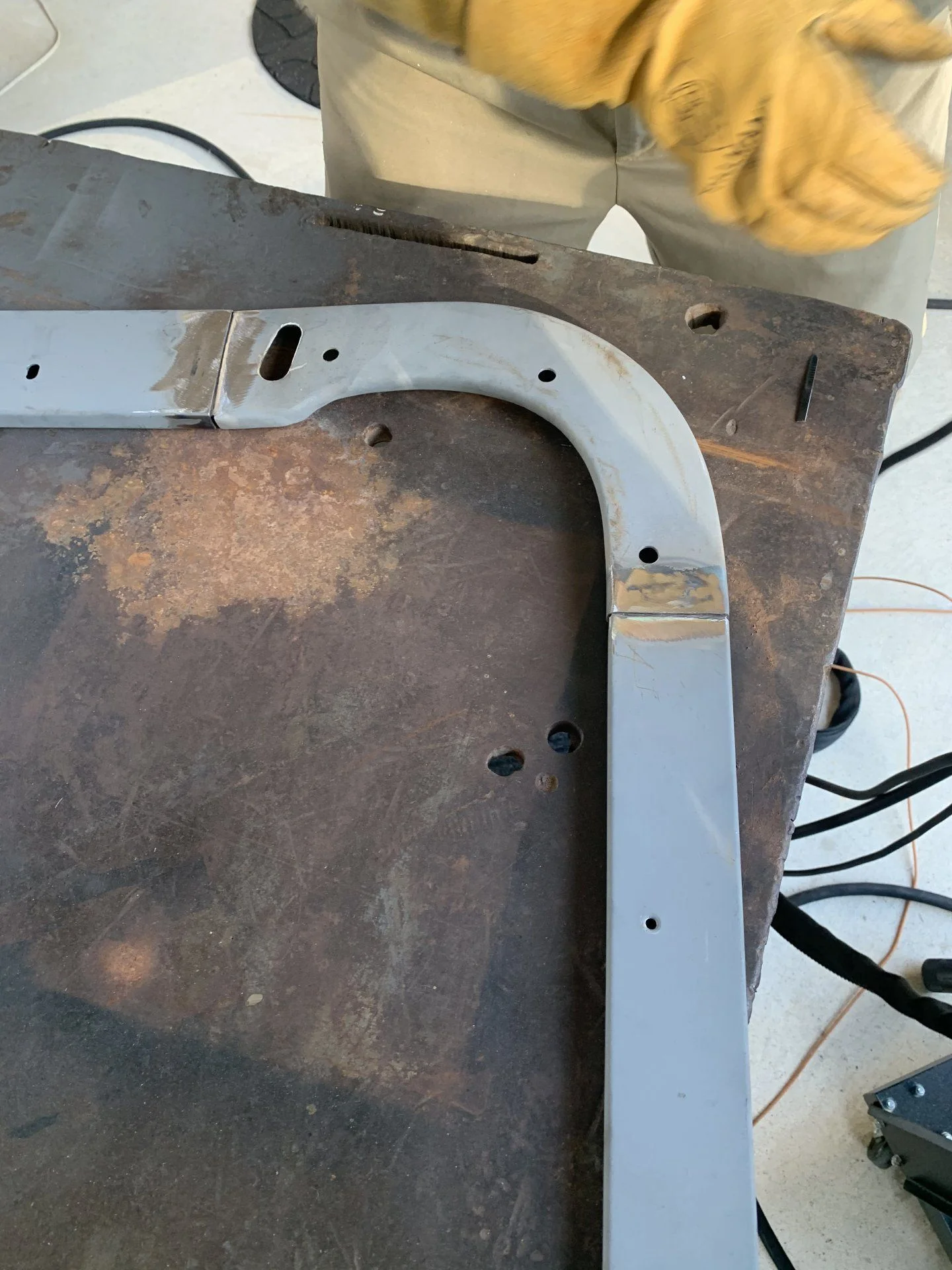

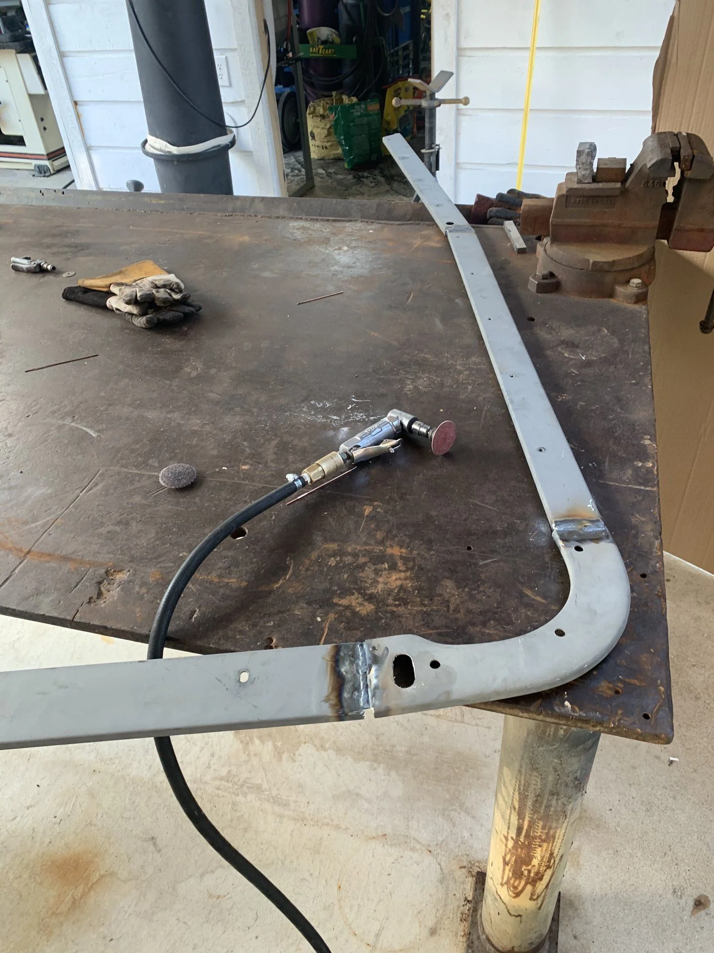

Got the rear “U” section welded. Tack welded it on while loosely bolted on. then used pipe rack to hold up the “U” and finished the welding off the top. Thing is so flexible it takes at least 2 people to force the thing on to bolt it down.
