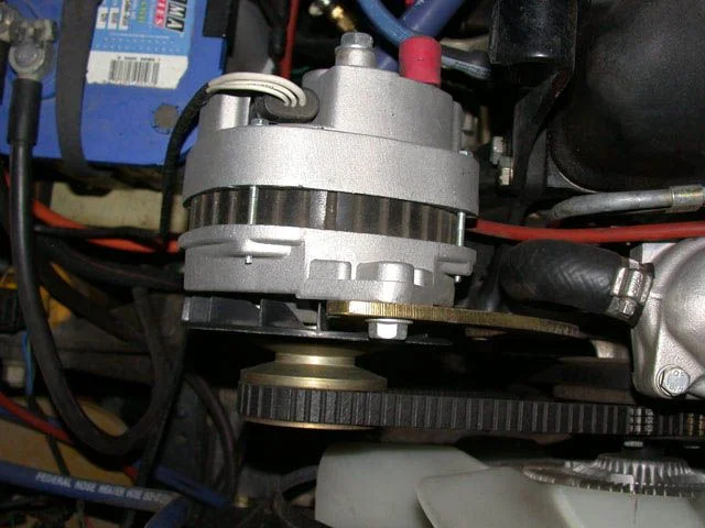

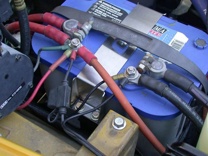

This is my setup, a Mean Green 200 amp GM Delco. I bypassed the ammeter and ran new wire from the battery to the fuse panel and ignition switch. The wire from the alternator to the battery is either 2 or 4 gauge Vu-Tron UL Listed cable. It is the orange cable in the third photo. The first photo is the alternator with the GM replacement harness that uses Teflon insulation. The second photo shows the spacer required to keep the alternator in the correct position to align with the other pulleys. Notice that the dual pulley is meant to run the toyota belts.
