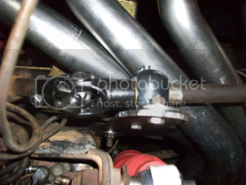

Any suggestions to how to fix the steering shaft? special u-joint ? any thoughts on why nv4500 wont shift? and on colors Im thinking the pyrite mica or the new fj cruiser blue...stock red fades to pink, pink truck is not so cool.
You can space the steering shaft out with a carrier bearing or rod end appropriately sized.
Like this
