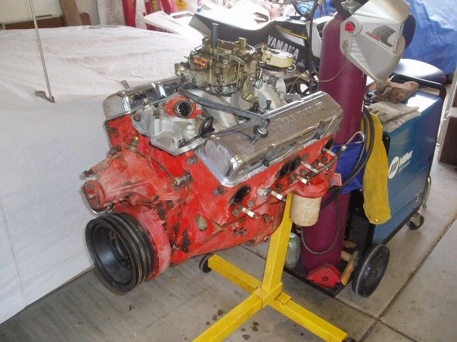

Got a little more done this week, but nothing exiting. Just more grime work.:frown: And a lot of Mud research on things in the plans. :) Most of the weekend was spent preparing other junk to go to the sand dunes next week. :bounce:
So with the pressure washer at hand, I began to reveal what was once a nice looking engine. 21 yr old 383 build with 43k miles, now ready for some new gaskets. Also, Gunk Engine Bright still sucks. I gave it another chance "new formula!", but it still does little more than stink up the place. My generic purple power did better. Amazing what still clings on though.

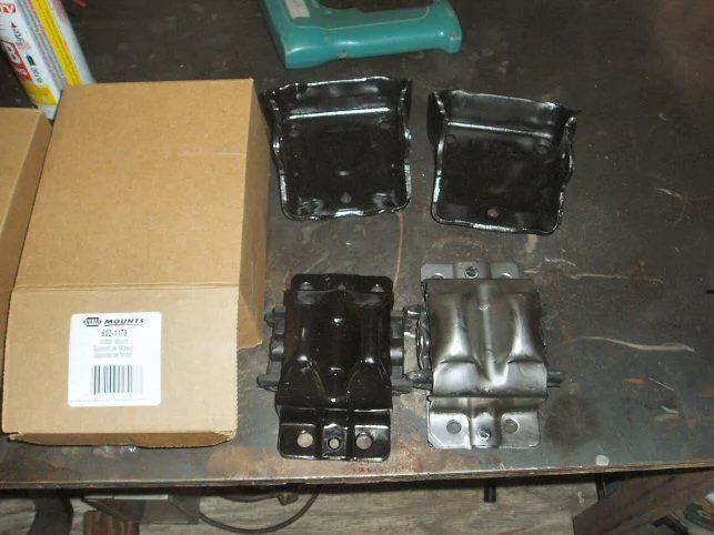

Got my evilbay stock motor mount brackets this week.:bounce: And a pair of NAPA mounts to go with 'em. Funny thing, I opened one box at the NAPA store and was pleasantly surprised to find made in the USA stamped on the mount. But wait, I open the other one at home and it says China! :doh:
I may go and see if my pal at the parts counter can stir up another USA one. Or maybe we'll install them and see if China fails 1st.:p
Bet it will, even if I put it on the passenger side.:D
