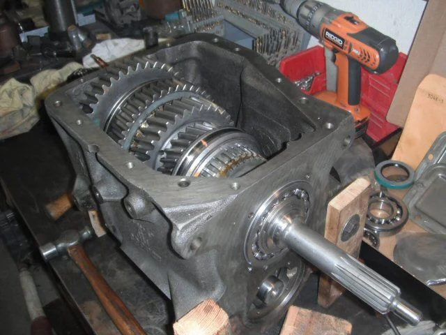

So I got my trans parts kit and set out to put it together...........
Stalled now because they sent me the wrong springs/keys for one of my synchros. :frown:

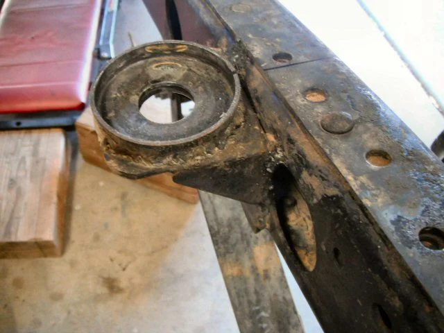

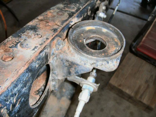

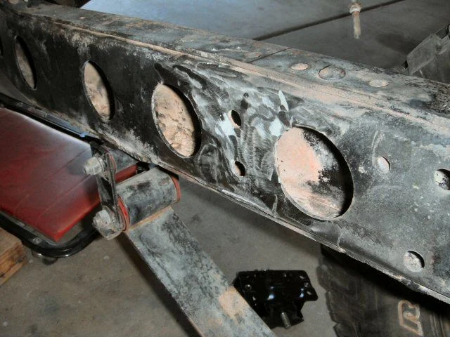

Not to let a below 90 weekend in AZ pass without some progress, I jumped into reworking engine mounts.
Old mounts gots to go. No laughing at the booger welds by yours truly. It was long ago, low experience, with a flux core 110 welder, engine in place, upside down and no auto dark helmet.
Frankly I was surprised at how well they resisted being removed.
After much grinding and banging, the old junk is gone.
Frame is clean and I have shooken loose another pound or two of hidden ancient mud. And a muffler clamp.

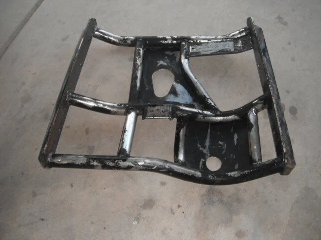

So a little more clean up........
Belly armor now degreased and de mortormudded. Ready to go in to make a reference point for motor mount fab.

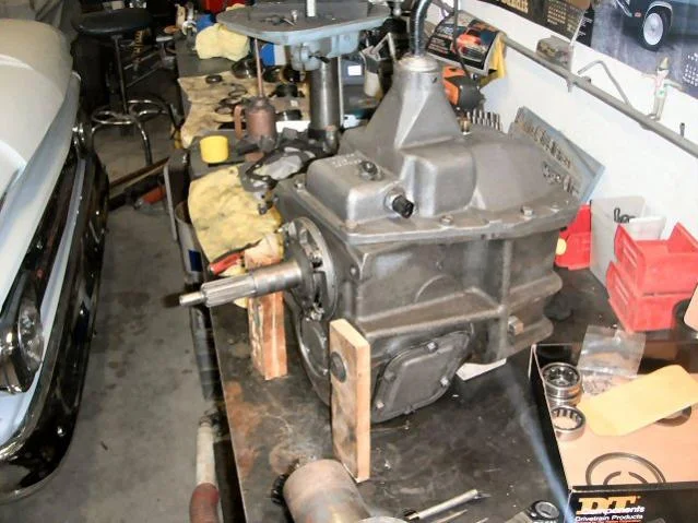

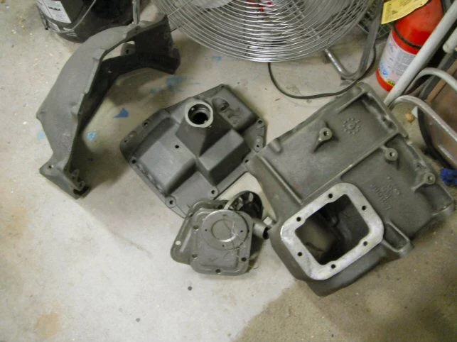

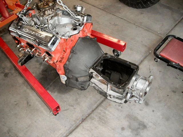

One hurdle down. Transmission is complete and ready for a little paint
Main shaft installed;
All buttoned up....

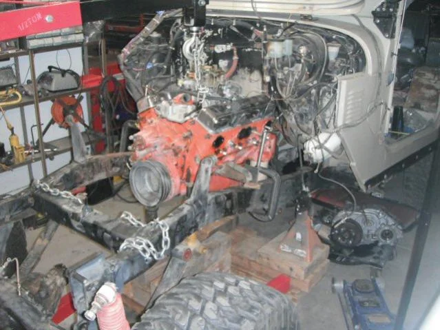

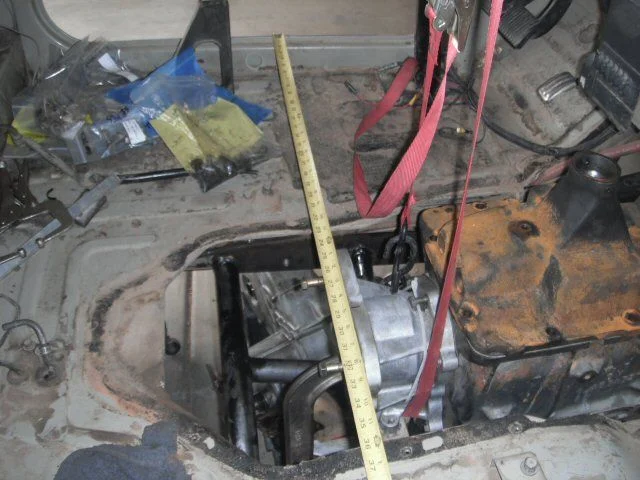

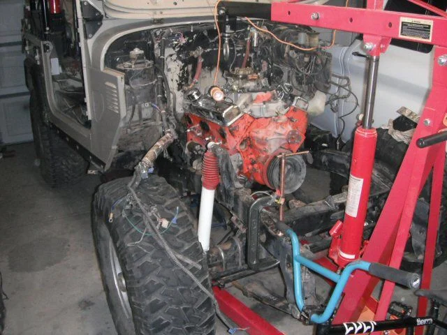

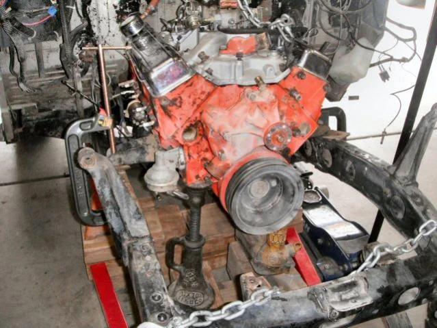

Got the engine placement nailed down, (I think). The measurement process has been quite tedious. :bang:
Shooting for drive train centerline on center and parallel with the center of the chassis.
Got the front axle loose and out of the way a little.
>Measuring up.......

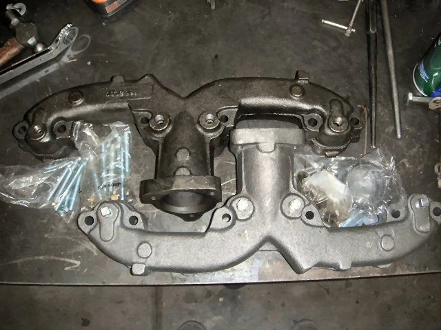

New goodies on the porch!
Replacement manifolds made by Dorman........only the finest Chinese products for me!:rolleyes:
A surprise to me.
I'm glad I found them on Amazon for $82.70 and free shipping instead of paying upward of $100 each at other places such as Summit.
Oh well, we see if they last.

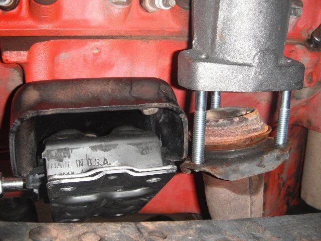

The pitfalls of mixing old and new GM designs.
Apparently rams horn manifolds don't exist peacefully with later model motor brackets on the driver side.
Problem....pic 1
Solution...pic 2
Sawzall=One of mans better inventions:hillbilly:

Are those the 2" or the 2.5" models? I just ordered a set of the Dorman manifolds off of Amazon as well. I ordered the 2.5" and they have the extra tabs on the ends for the alternator mount. I suspect I will cut them off, but they do look slightly different than what you got.
2"
674-501 is the part number. Later model Vette application.

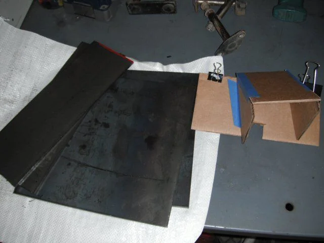

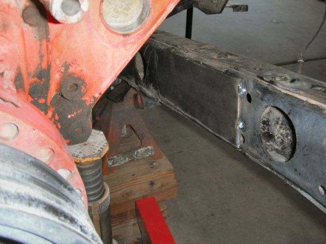

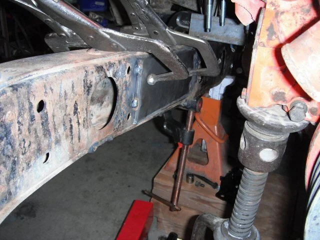

Turned some of that material into scab plates for the frame, and tacked in place
Plasma cutter=Another awesome invention:D:D:D:D
