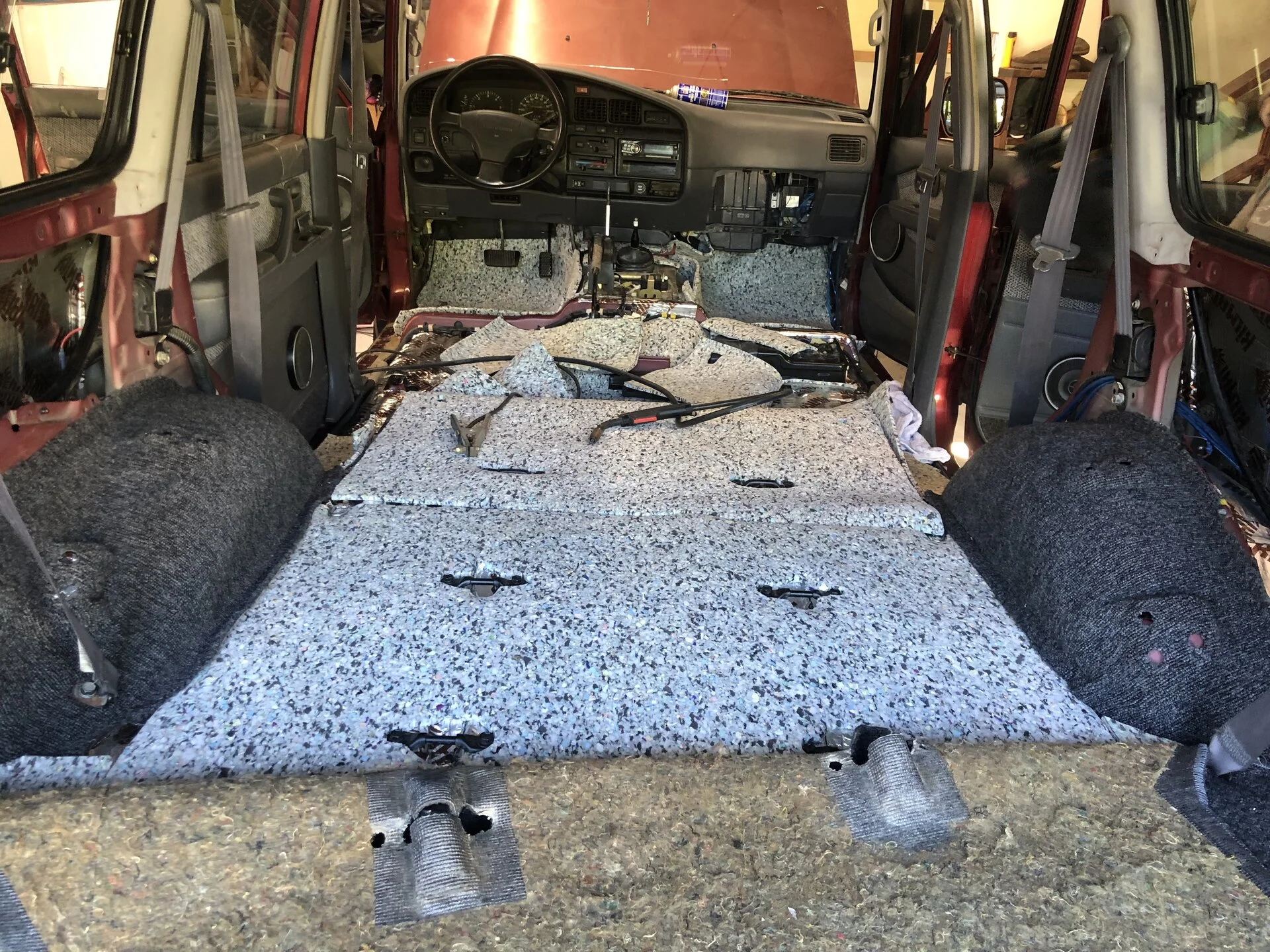

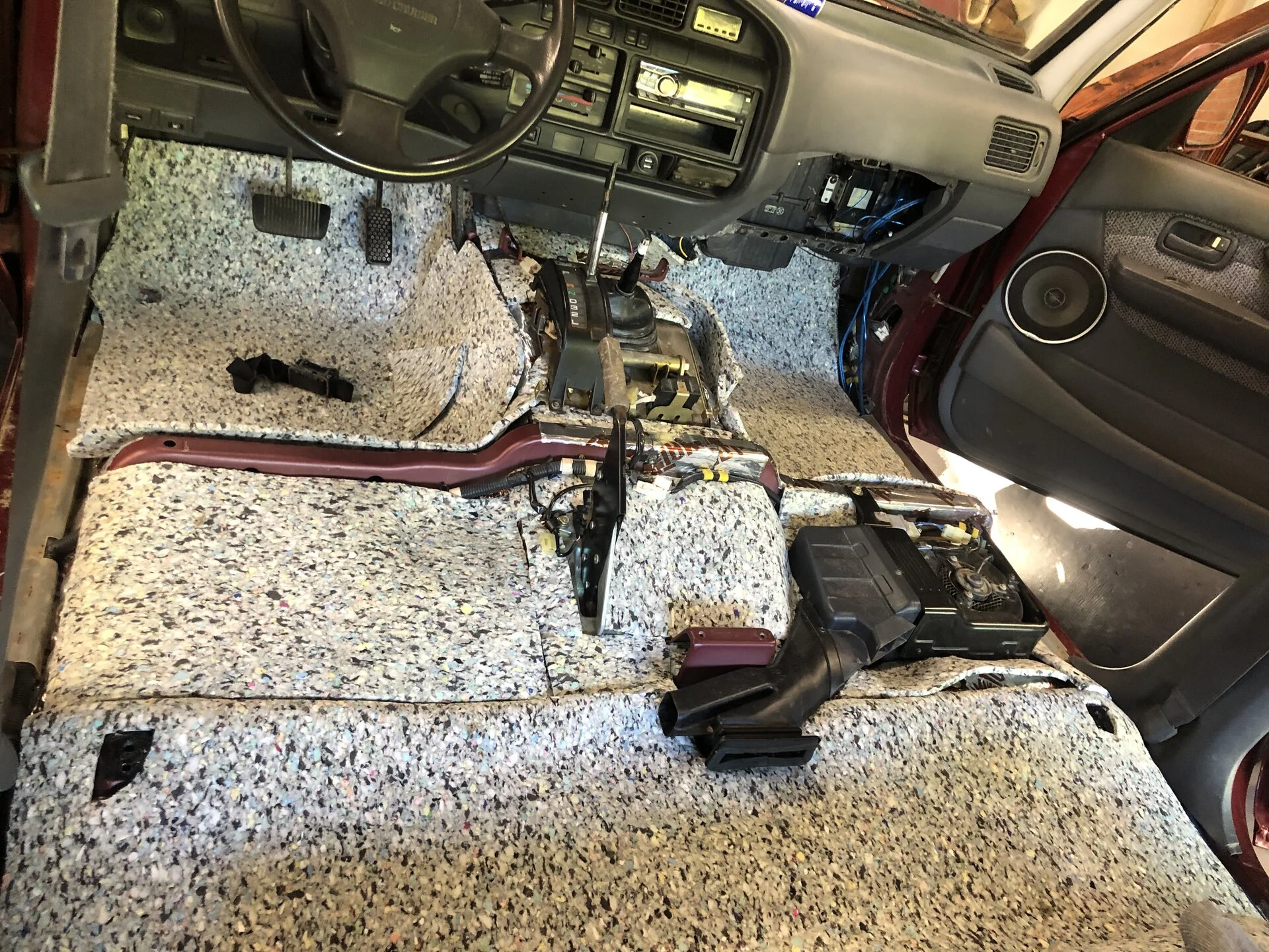

Installed new padding. The existing padding was pretty nasty and I want To eliminate any pet odors. I also ran stereo cable, and installed a subwoofer in the rear. I have a Bluetooth deck, and amp coming this week.

Is this a specific type of foam you're using over the killmat? Also, did you have any issues with thickness when reapplying the carpet?
I believe it’s 3/8”. Nothing specific, just the smallest roll HD had for sale. The only issues was me thinking I knew better than Toyota on foam placement. I put the insulation where the factory did not, some of the areas it was to thick for the push tabs. Where the passenger foot steps go, and where the cargo section meets the carpet section. Other than that foam everything.

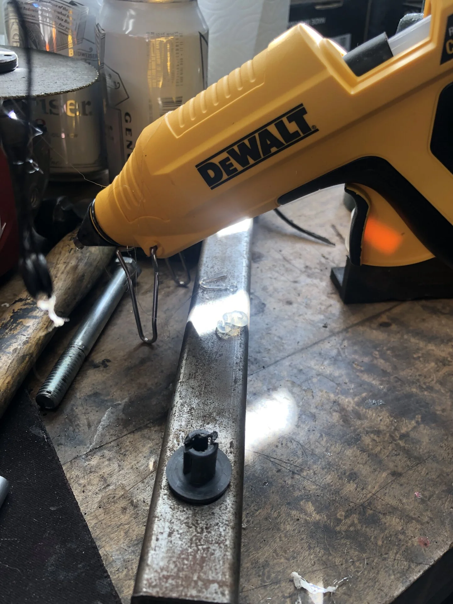

Hot glue for the W. Those tabs are solid as they have ever been.
